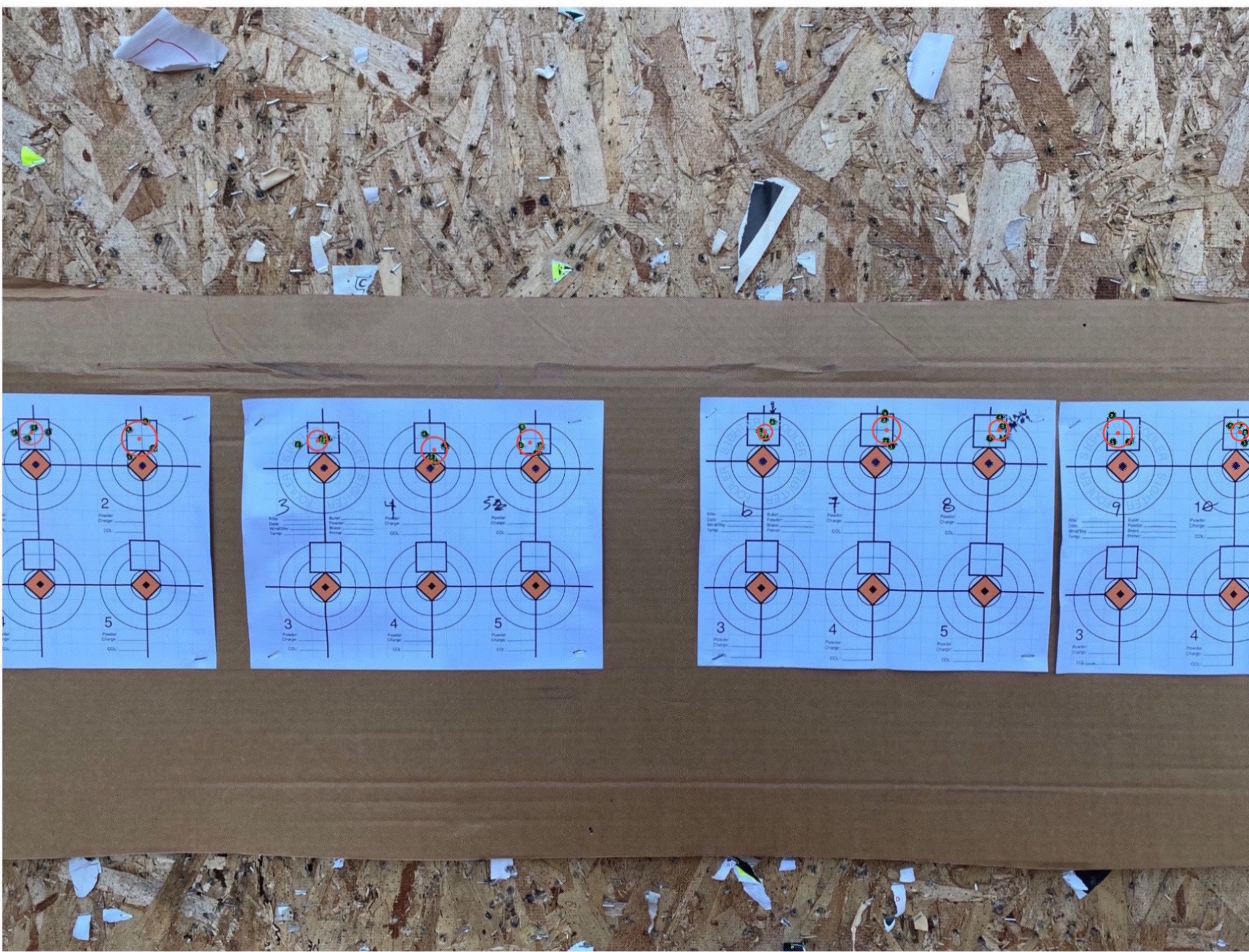

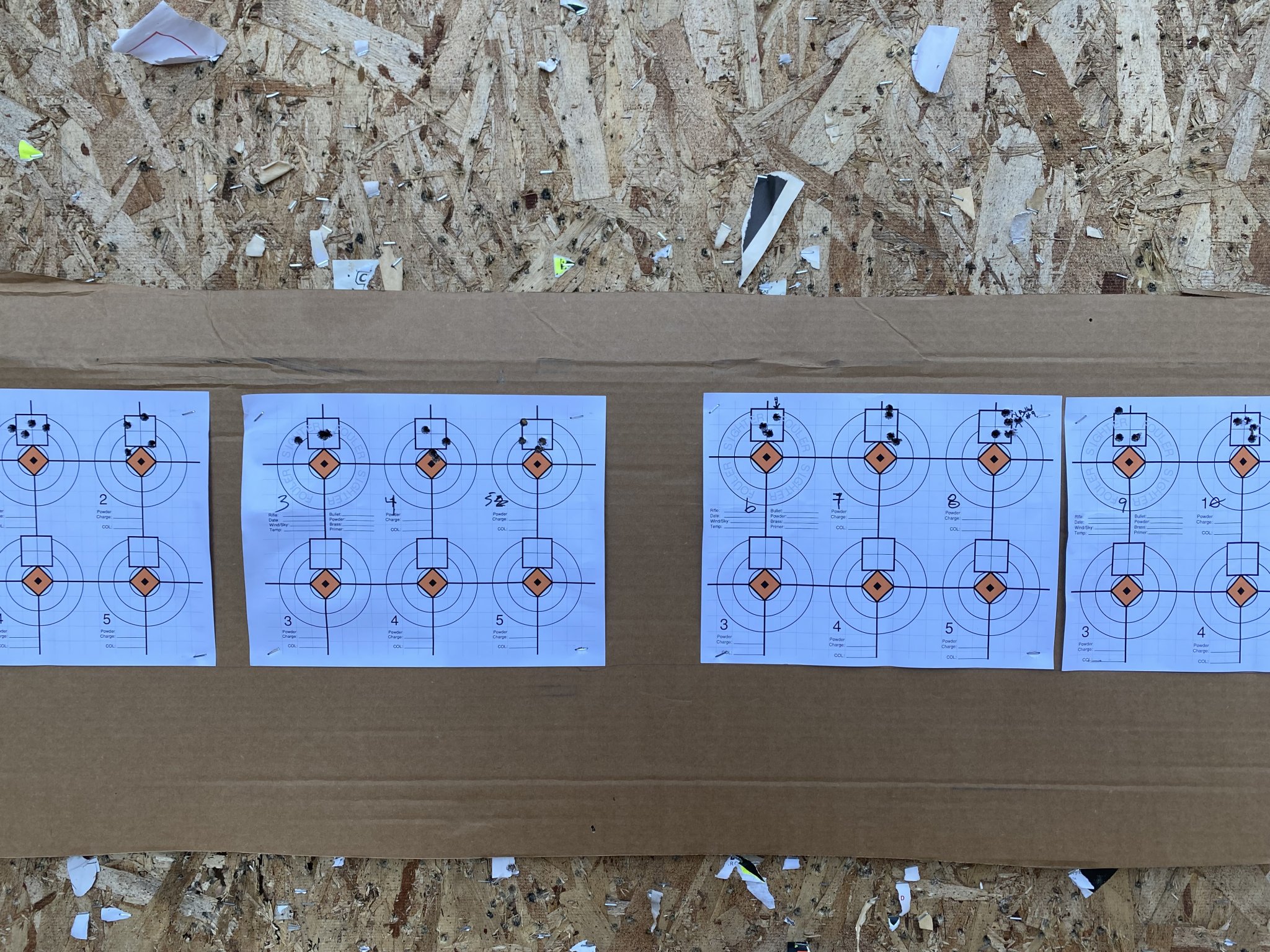

Not sure if this is the right place to post this. Shot an OCW test yesterday for my GAP crusader in 6.5CM. The results are pictured and I am not sure how to read it to see where the nodes are at.
6.5 Creedmoor
N555
140 Berger Elite Hunter
CCI Large Rifle
Minimum Charge: 40.1 gr
Maximum: 43.4 gr
Sighter #1: 37.3 gr
Sighter #2: 38.1 gr
Sighter #3: 38.9 gr
4 ROUNDS FOR EACH LOAD
Load #1: 40.1 gr
Load #2: 40.4 gr
Load #3: 40.8 gr
Load #4: 41.2 gr
Load #5: 41.6 gr
Load #6: 42.0 gr
Load #7: 42.4 gr
Load #8: 42.8 gr
Load #9: 43.4 gr
Load #10: 43.8 gr (No pressure signs)
Not sure if I pulled the left shot on #3 (that was either the first or second shot). Also, the top shot on #6-- I felt like it wasn't a perfect shot, but I was surprised it was that far off as well. The only other known "bad shot" is labeled-- shot target 8 with second shot from load 9.

Do you have Ballistic-X? I find its “Adjust to Zero” feature to be the easiest way to interpret an OCW test. Take the ATZ readings, put them in a spreadsheet, elevation vs charge weight and windage vs charge weight, and look for flat spots in both trends that correspond to the same weight range.

I’d say .4 gr between groups makes the result hard to read. For me to really validate an OCW I like to see the bullet moving between the groups. I can usually see a pattern of horizontal spread/vertical spread and the group coming back together in between. There’s some of that in yours but it’s less definitive. That makes sense bc a larger spread is going to make the result less refined. I’d be doing 5x 41.8- 42- 42.2. If all of those have similar POA go with 42.
When doing an OCW test I like to look for the adjacent groups being in approximately the same location. I'm having trouble picking that out from your testing.
Were you able to leave the rifle in it's rests in between groups?
Did you shoot one group at a time or do some "round robin" thing?

The last sentence is a very important part of the test and most ppl ignore it. Shooting round robin eliminates false results when the shooter is comfortable on some groups and not the others. RR doesn’t take the shooter out of the equation but it helps prevent false positive/negative results. If the shooter isn’t on point for a group or two it’s more likely that it will just garble the result vs making you think a certain charge is really good or really bad.

I shot round robin with 90-120 seconds between each shot.
Used Ballistic X to get the center
Frankly, I'm a little surprised at the size of all the groups (except for #3, where that could be something involving shooting mechanics) coming out of a Crusader. Maybe that's just me. I would have expected somewhat smaller groups all the way around. Makes me wonder if there's something going on with your reloading process???
Since an OCW test like this is only a start, where you need to verify some of the data, I'd take a closer look at loads from 40.6 to 41.0 in .02 gr increments.

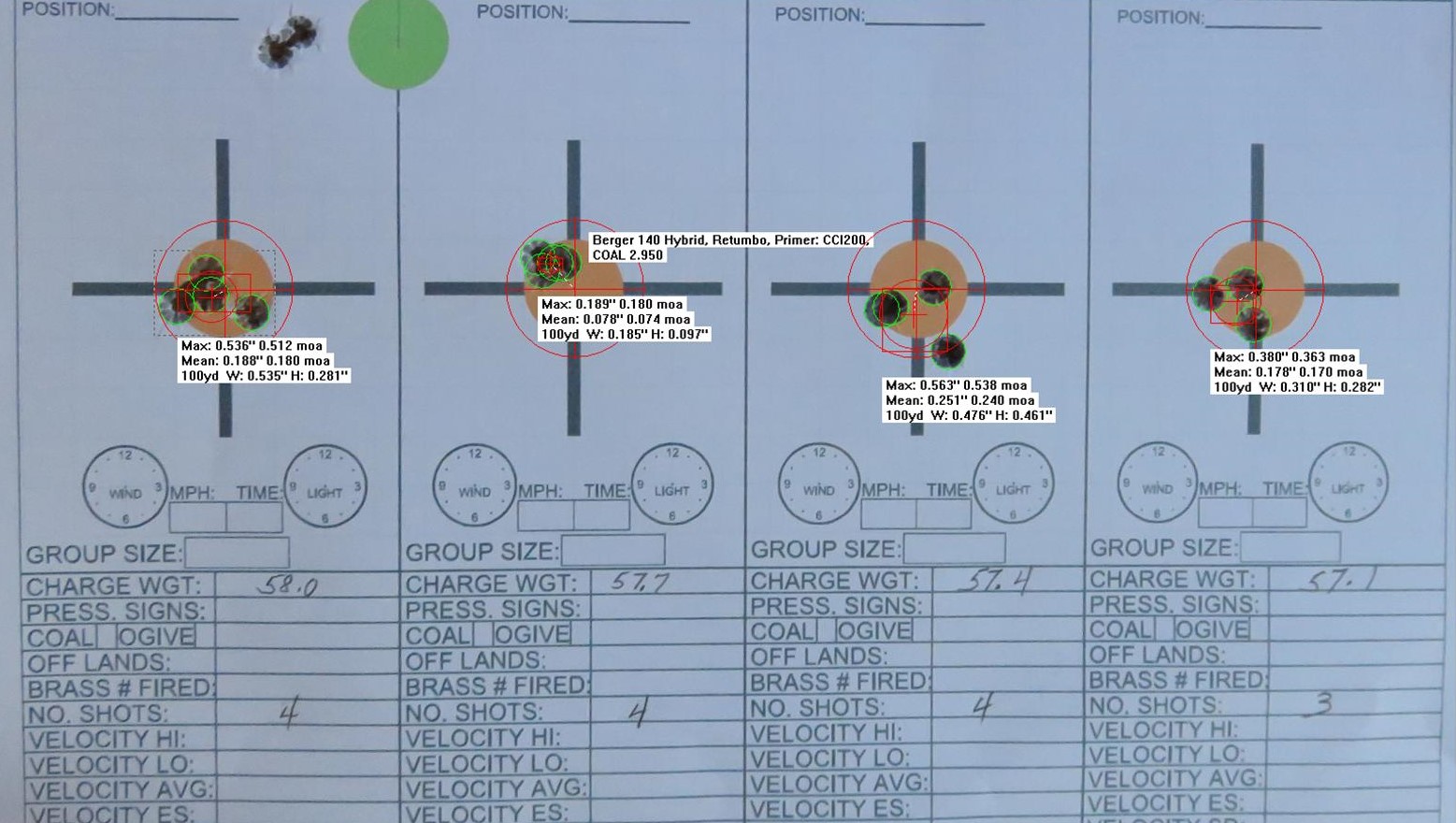

I'll be doing something similar after my OCW I did this last weekend.
Addendum: just to clarify what I did here . . . my barrel was thoroughly cleaned before this session and so I fired 2 fouler shots, which you see left of the green dot. Then I proceeded to shoot 3 shot groups. I typically load up 5 rounds for each powder load for my OCWs as I did here too. And because I wasn't sure it was me causing the shots for 58.0 and 57.4 to go low and right, I went back and shot one more at each of the first three (this is why I like to load up more than 3 for each charge to be able to follow up on shooter error). The 4th shot pretty much confirmed my suspicion. Now I just need to do some confirmation and try and see where the node begins and ends to see just what i want to use. I fired the left over rounds over my MagnetoSpeed to get more data on velocity and compare it to what I've already recorded in the past.

This is a good illustration of my earlier post. You’re running 57 gr and using .3gr increments. The OP was at 42gr with .4gr. That is likely a factor but the spreads look a bit shooter induced to me. When I see double grouping and a couple of random flyers I think shooter. But there’s no way to tell for sure. When doing an OCW, unless you can 100% call your shots, it’s a good idea to not put a lot of stock in flyers. If you see a pattern by omitting the flyers, go with it and shoot a smaller window in smaller increments.

I’m not sure about your experience level, but shooting groups small enough for load development is a learned skill that takes time. I’d be looking for a load that nets a velocity between 2700 and 2800 and seat 10 thou off or mag length to start with. The ocw test is about group location not size.
I did the test to find a stable node (I thought it was loads 7 and 8) because there was not much shift in location. I was going to play with seating depth to try and bring the groups together once I found the stable powder charge

Good point about location. But, for my OCW's I look for both size and group location, location being just a little more important.
Often, when I have shot two of my three shots that I do for OCW's, if those two shots are far apart, I don't even bother with the 3rd since it won't improve the size of the group. And the 2 shots does still give me a location reference.
And you're right, that if one can not shoot small groups, for whatever reason, be it shooting skill or issues with loading consistency or something to do with the rifle itself or front and rear rest issues, it's difficult to see and read what an OCW test can show.
6.5 Creedmoor
N555
CCI Large Rifle
Maximum: 43.4 gr
Sighter #1: 37.3 gr
Sighter #2: 38.1 gr
Sighter #3: 38.9 gr
Load #1: 40.1 gr
Load #2: 40.4 gr
Load #3: 40.8 gr
Load #4: 41.2 gr
Load #5: 41.6 gr
Load #6: 42.0 gr
Load #7: 42.4 gr
Load #8: 42.8 gr
Load #9: 43.4 gr
You have nodes at 3 and 6 which are 3% apart perfectly like they should be. Take load 6 and shoot a seating depth test .005, .010, .015, and .020 off. 3 shots each round robin. After that shoot 41.8, 42.0, and 42.2 and see which one shoots best. It would be best to shoot those three at distance if possible.
Reactions: drtony and ma smith
This. I thought I was the only one who used the scatter node and 3% spread to confirm….

I've used the OCW method for at least 10 years and found it to be a good, consistent method for developing a load.
Unfortunately, the OCW method does have a couple of fallacies. First and foremost to be a good test it needs to be shot round robin and that
requires the shooter to be consistent in his setup for each shot. This can often be a problem. The other stems from our desire for small groups and to be drawn to a single small group. Looking at the target I think I see a rifle that is not going to be picky about the load. It's not uncommon for an OCW derived load to shoot much more accurate then the actual load does during the test..
If I were to work from this test I would work with charge 7 +/-0.2 grains. Groups 6,7, and 8 form a very good group with a very similar POI.
As for charge increment, for 35 to 50 grain cartridges the usual increment is 0,3 grains. Normally its 3 shots per charge but shooting more doesn't usually hurt. It's usually said that three shots tests the load, 5 shots test the shooter.
