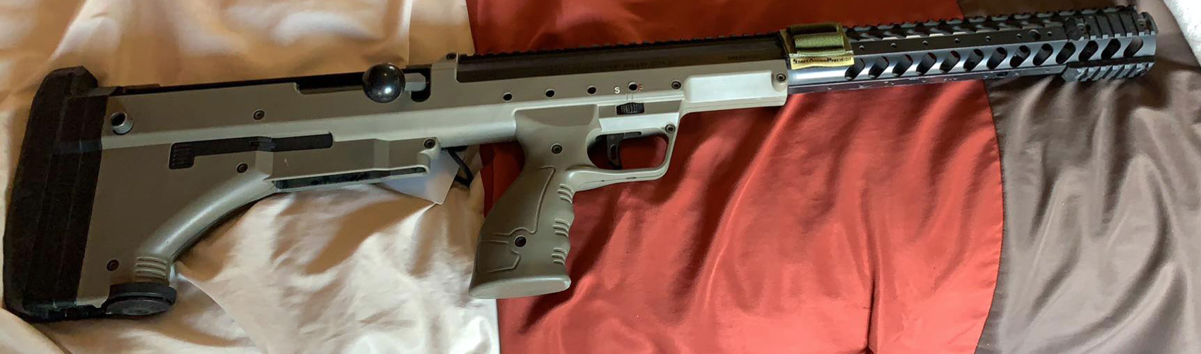

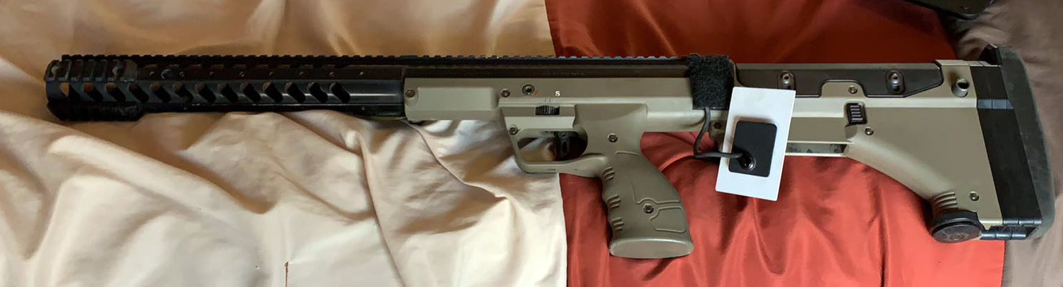

Which model is this chassis?

Can anyone give me a quick run down on the differences b/w the SRS-A1 and SRS Gen 2? I see references to both of these, but I cant seem to find an explanation of each - are they different or just different nomenclature to differentiate the SRS-A1 vs SRS?
Look at the top of the handguard where it meets the receiver, if there is a set screw it's a gen 2 not the A1.
The A1 has the adjustable cheek rest and thick rubber sissy pad on the back. The Gen 2 is like the gen 1 but has a different barrel extension. The gen 1 had a small roll pin to index the barrel but they got sheared off when people dropped their barrels into the receiver. The gen 2 fixed that by using the front of the mag well to index the barrel. The new barrel extensions have a big slot that straddles the magwell instead of a tiny slot that fits over a small roll pin. You can use a gen 2 barrel extension in a gen 1 rifle but not the other way around.
The A1 added the cheekrest riser and changed the way the front handguard attaches to the receiver. The early gen 1/gen2 receivers have external threads up front that the handguard screws on to. There is a key and lock screw on top to keep things from moving. The A1 went to an internal thread on the receiver with a threaded sleeve that goes into both the receiver and handguard. One end has a right hand thread the other is left. This allows you to tighten the parts together snugly instead of depending on the timing of the single thread and a key.
All the A1s use Gen 2 barrel extensions

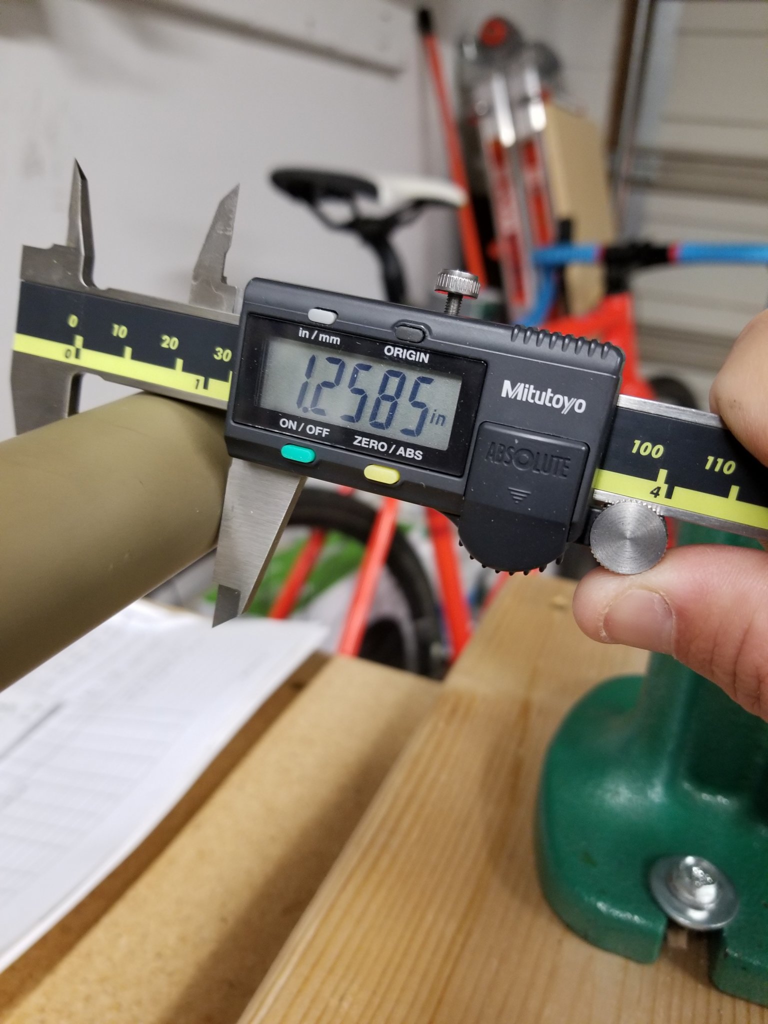

SAC calls the contour they use the DTA contour. I’m pulling from memory but the muzzle at 28” is around .930” in diameter. It’s a heavy contour for sure. I have an Insite Arms Heathen brake on my norma barrel and the recoil is not bad at all. Don’t get me wrong....you’ll know when you pull the trigger ?, but it’s very manageable.

Mine is a 9 twist, 29" and a straight 1.250 contour. Weighs ou ver 9.5lbs. Have a sidewinder brake on it, recoil is not bad at all.
