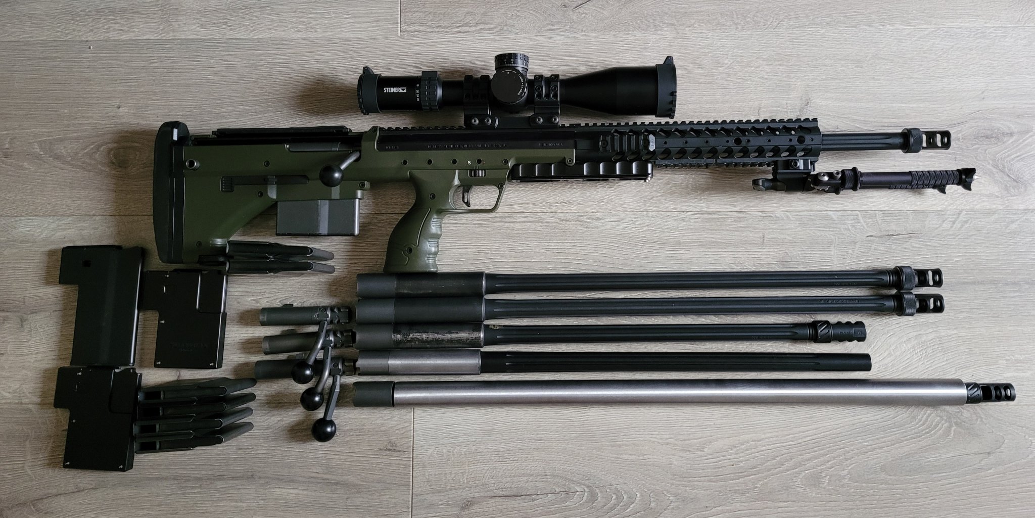

Over here in Aus ..the SAC 223 conversion is a pipe dream..
Thinking of going for an option in 22-250 using my existing mag , bolt and barrel extension. Just need to find a barrel blank with a Tenon of 1.250" and 6" long..
Anyone else ever gone down the 22-250 route with an SRS?

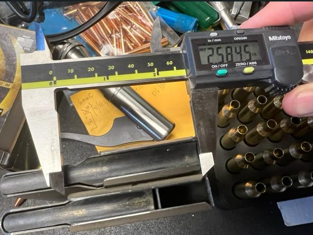

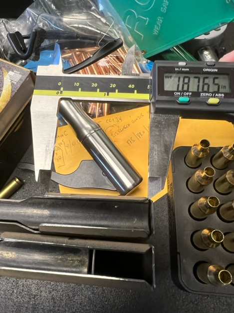

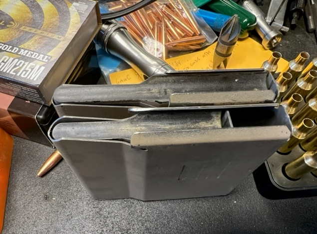

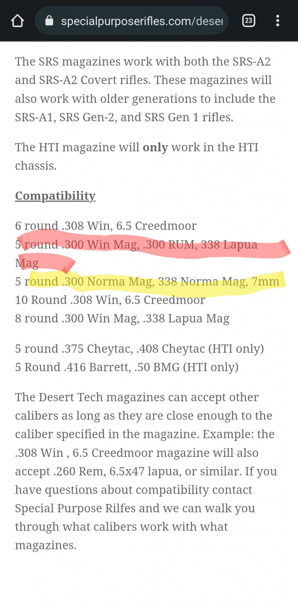

What is the difference between the 300 norma magazine and the 300 win mag magazine?
I shoot .300NM in an old fashioned SRS Long Action mag.
As long as I can remember there was just a Short Action mag for .308WIN-based cartridges, and a Long Action mag for .338LM-based cartridges. I don't remember there being an intermediate sized mag to go with the intermediate bolt. This was the reason a lot of people were having issues with SAUM and PRC cartridges, and why SAC made a mag upgrade to handle that. I think the .300WM fits in the LA mag, but I've been wrong a whole bunch of times...
Reactions: M77
I actually have issues with my saum out of that mag. The bullet hits the face of the barrel breech. Which I don't understand.
When you cycle the bolt, lift the bottom front of the mag and see if it feeds correctly. It’s not uncommon for the mags to sit loose and sometimes if the front dips down too much it won’t feed properly.
I believe that's what it was. I also flipped the spring around in the mag. That seemed to have helped alot. I just did a test feed with some 183s and they were fine. I'll have more to test this weekend.
I've owned my A1 for 8 years and the first barrel I got was a 300WM, I've been using those mags with zero issues and they are interchangeable with the 338NM.
My SRS A2 chassis is due in a couple of days..
It's not a pipe dream, I've got one and I imported it my self

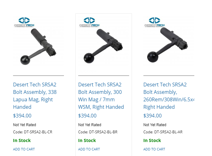

Been waiting forever to get a new bolt like I was? Midwest GW has some in stock it seems

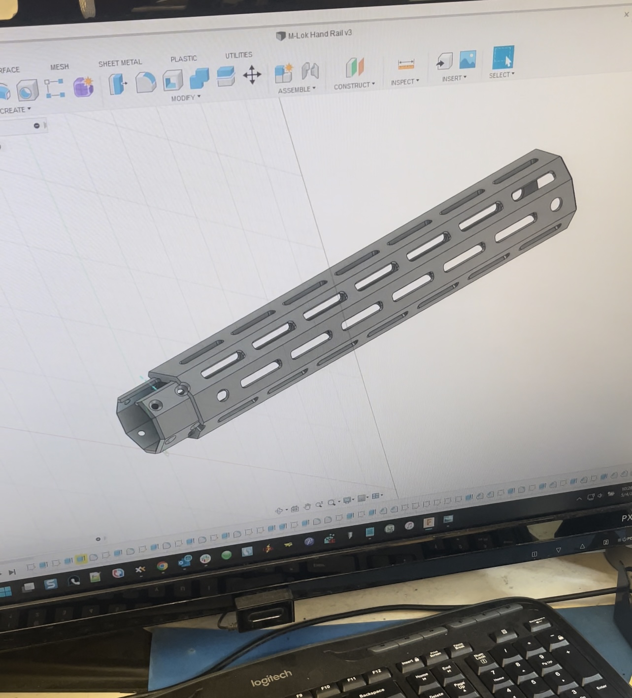

I have carbon fiber SRS-A2 12” over sized rails in production. They will have 1.89“ of inner diameter clearance. This should allow the rail to clear any 30 cal suppressor. They are only 3.5 Oz made of t700 carbon fiber (high quality). I will have a few samples in about 3 weeks and will post them up.
Price is $375.00 each.
If you want one feel free to DM me. I am looking to take pre orders once I get the samples to post up and show.
I want to see the new Nickel style bolts

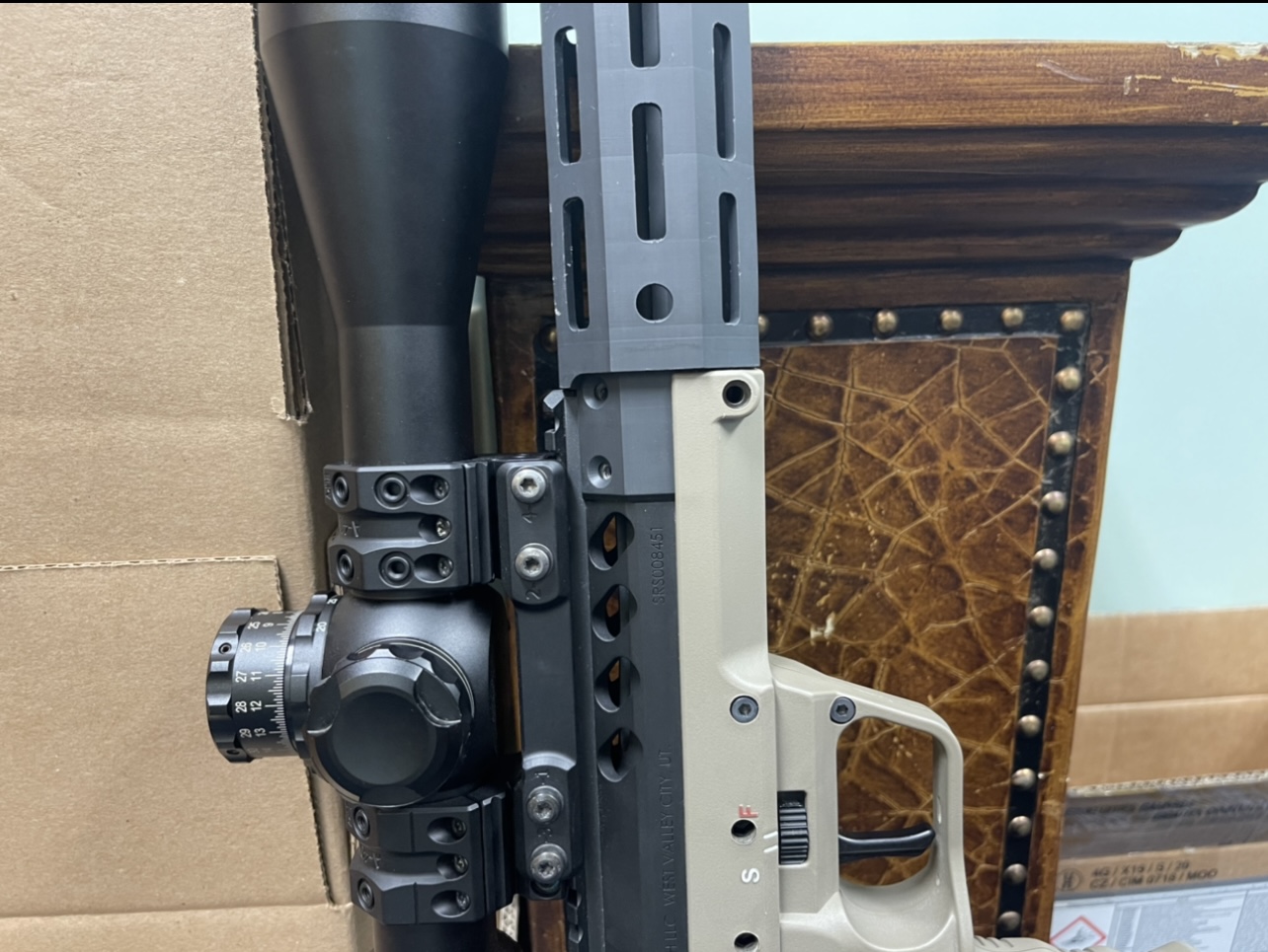

I have a 3d 1/2 printed one. Since our high quality 3d printer is for making small parts for mobile computers parts. But this is what it looks like mating up to the rail and end of the plastic on the Desert Tech. A short ARCA rail should attach to it just fine. But I will need to look into it a little more.
Reactions: wooferocau
If the handguard was flush with the bottom where the existing arca mount is build into the bottom of the chassis, then a flat arca plate that whole length would work. It looks like it’s very close to flush in your picture
Well that’s disheartening. I’ve got a new M2 sitting in the safe waiting on a trio of straight profile barrels :(
It will depend on the tolerances the barrels come in. I had to send mine back to ES Tactical because I couldn't seat my straight contour on an old Gen 2. After he turned it down, no issues. Just added to the wait, again
its damn close to flush, but off by a hair maybe two.
