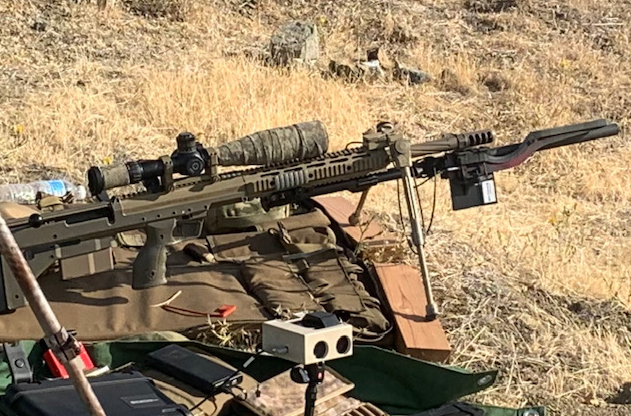

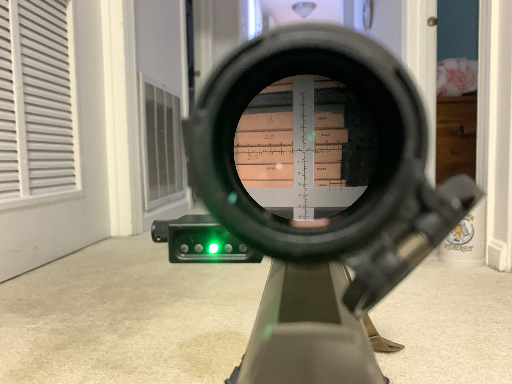

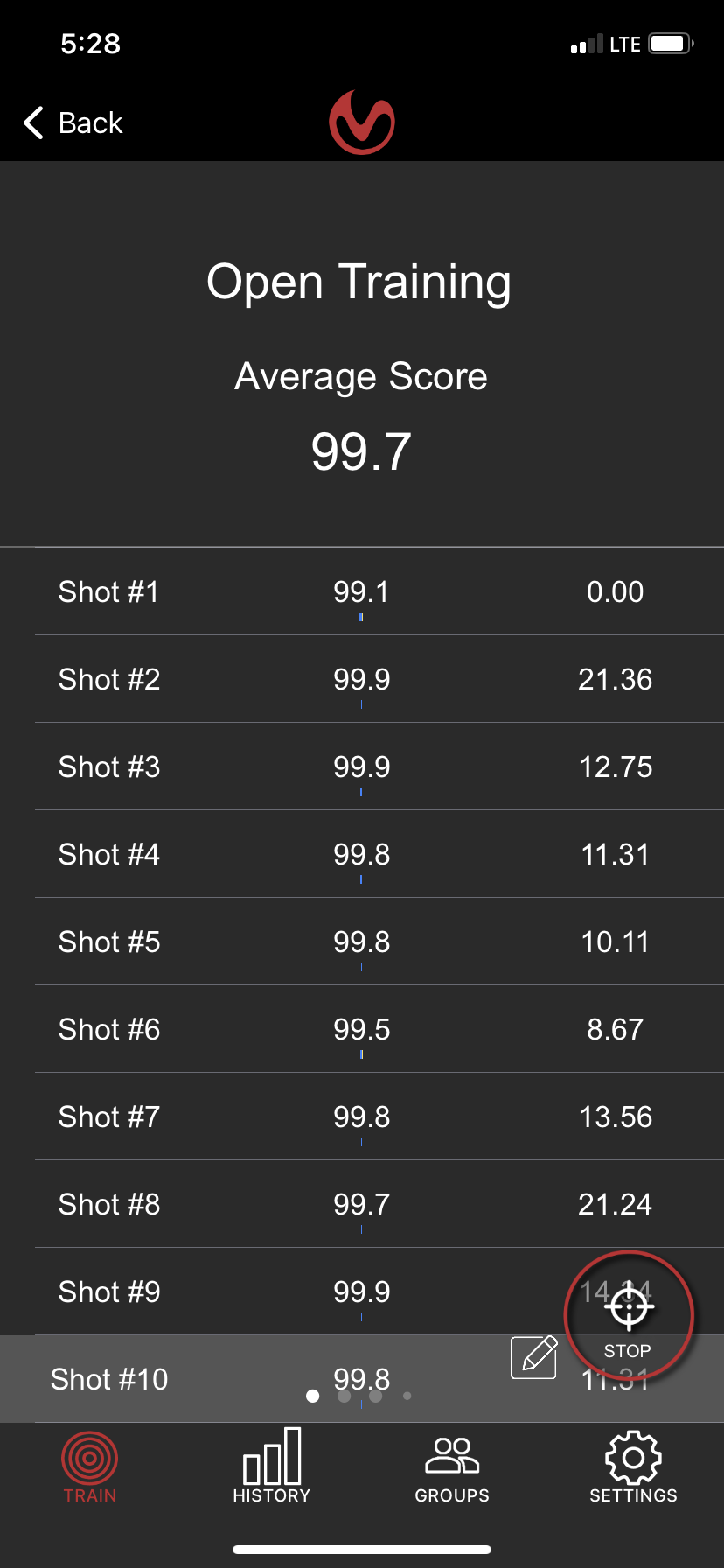

What app or device is this? I’d love to get something to improve my dry fire practice.Got some dry fire in on the SRS last night. Turns out the “0”s on the spines of the wife’s fashion magazines at about 15 m are close to a 1/10 mil point of aim. It’s remarkably clear if you would have missed after the trigger press.View attachment 7910492View attachment 7910490
Looks like mantis x and maybe a dfat?What app or device is this? I’d love to get something to improve my dry fire practice.

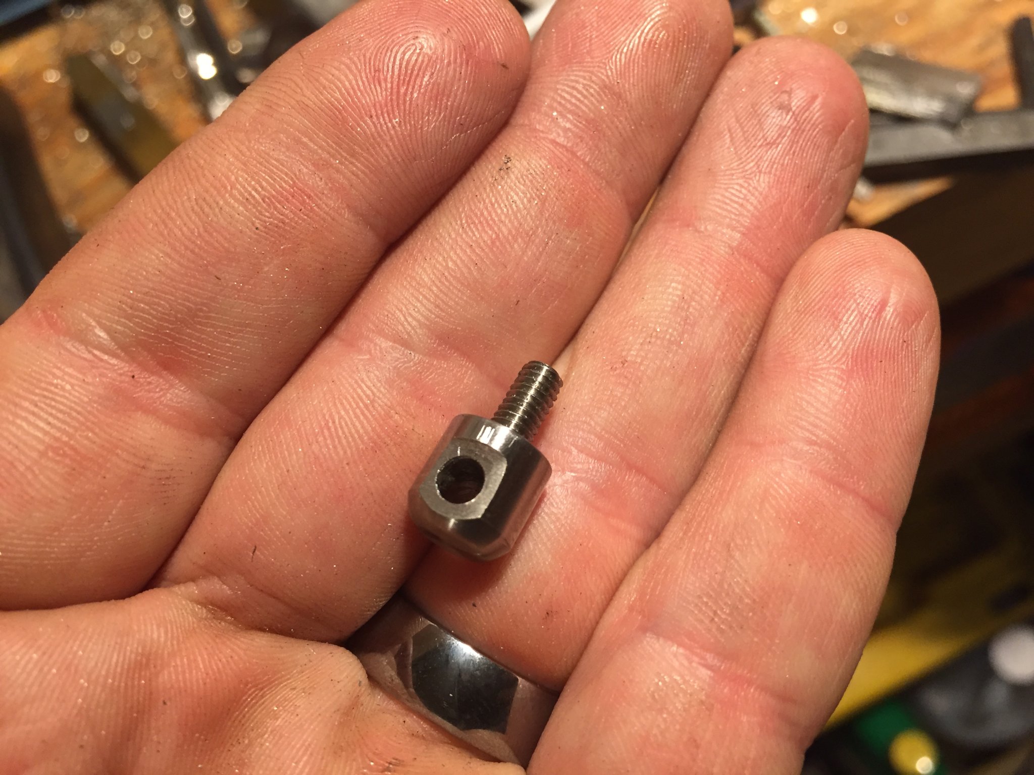

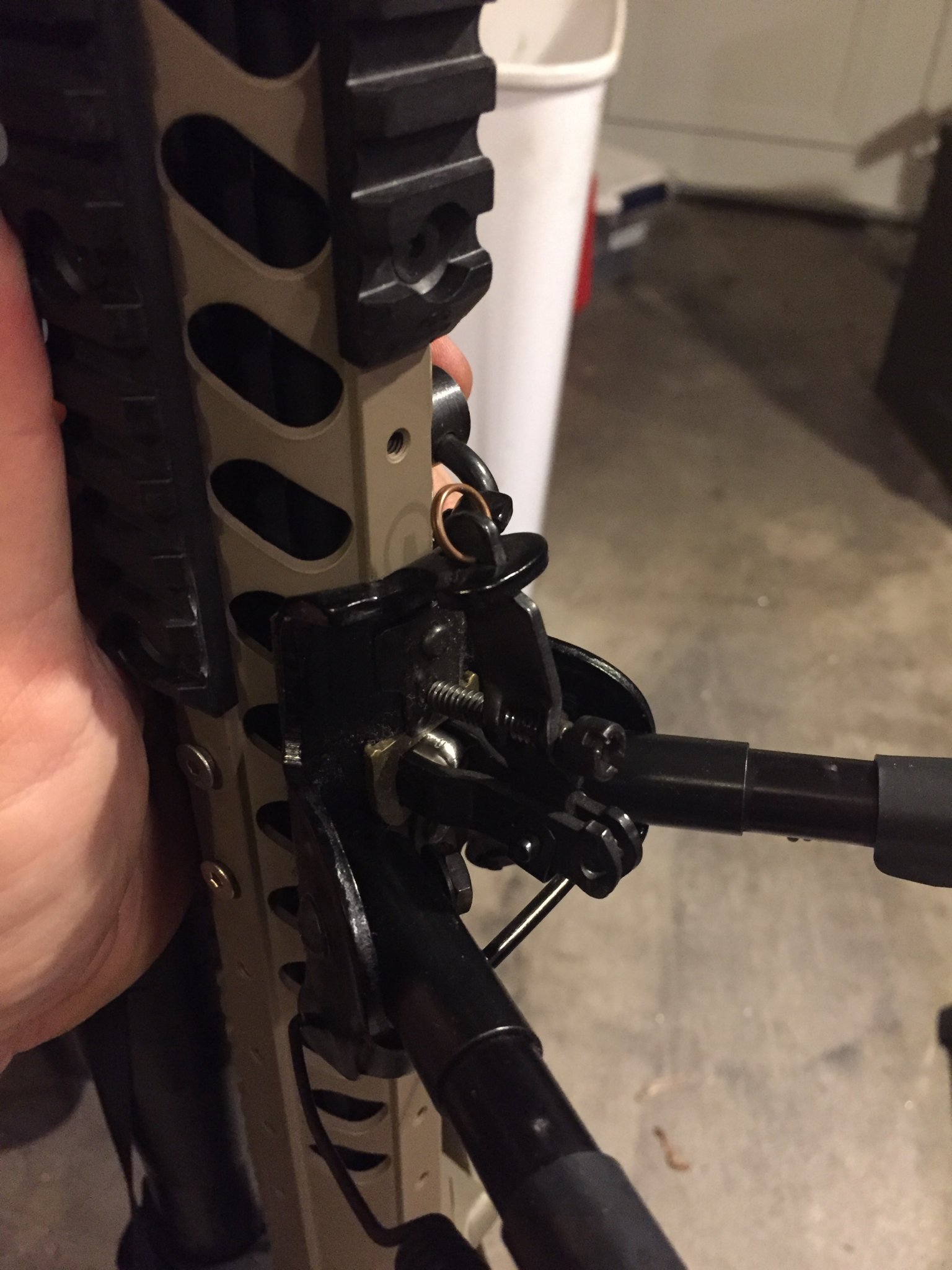

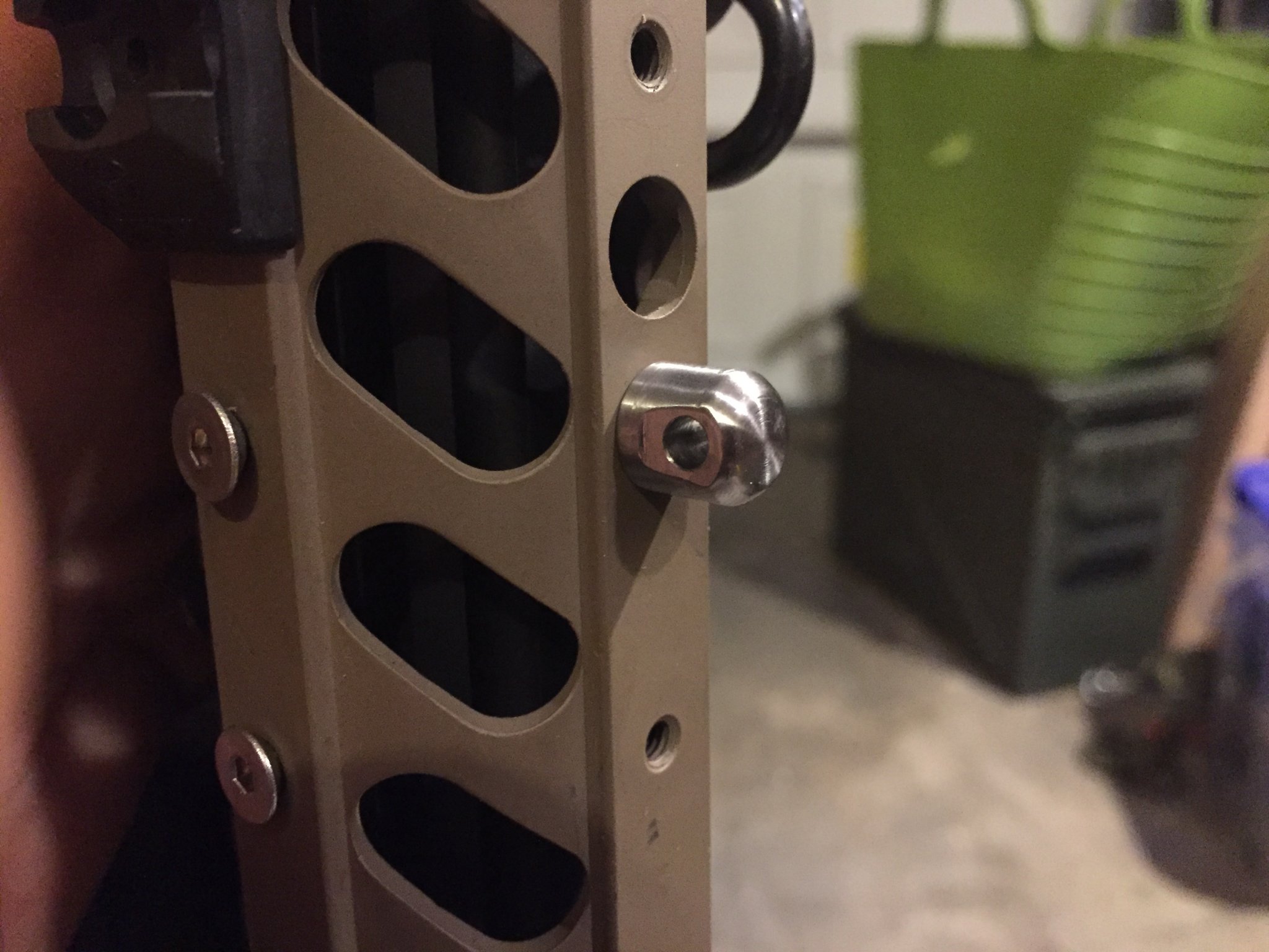

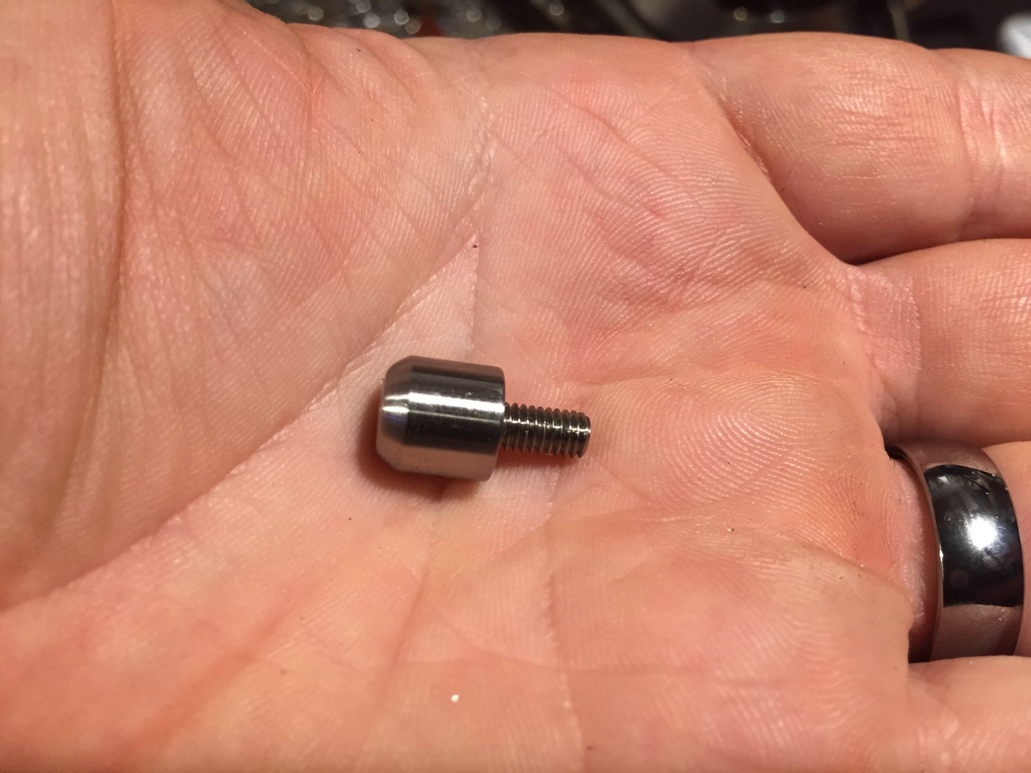

Can also use this for people who don't have the means to make thingsI whipped up this little guy for my A1 a while back and thought some might like to see it.
I dislike the bulky rail adaptors and this keeps my bore axis a little lower as well. Plus it was a fun project.
I turned some stainless round stock down to the appropriate diameter, made a shank and threaded it, then screwed it into the rail decently tight and marked the location of the flats. Remove, grind flats and drill the cross hole. Works fantastic.
Turned and threaded
Finished

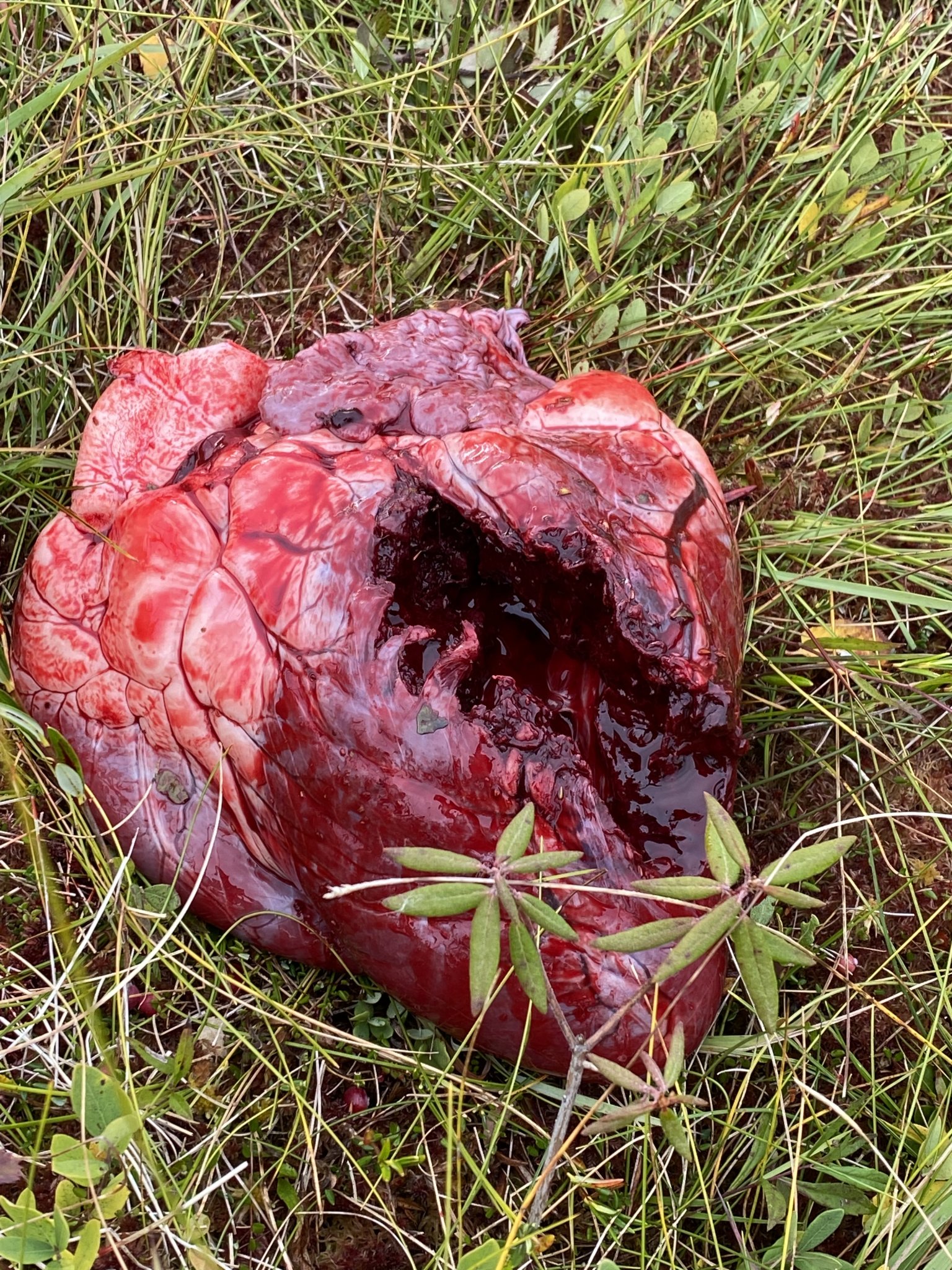

Came out the other side of the trees at 600 yds, Then started at a trot towards. I had a momentary window before he hit the woods again at 500yds and took a front quarter shot at 535 while he was trotting on in... not the ideal angle, but I could see vitals in my mental picture. Thought the bog would slow him down.
Took... 15 yds before he was down. Steps. We couldn't see the drop, and when I pulled the trigger it was literally under a second before he was in the woods and out of sight. Just a “now or never.”

It’s a Mantis. I like it a lot. Just wish there was a way to simulate recoil.Looks like mantis x and maybe a dfat?

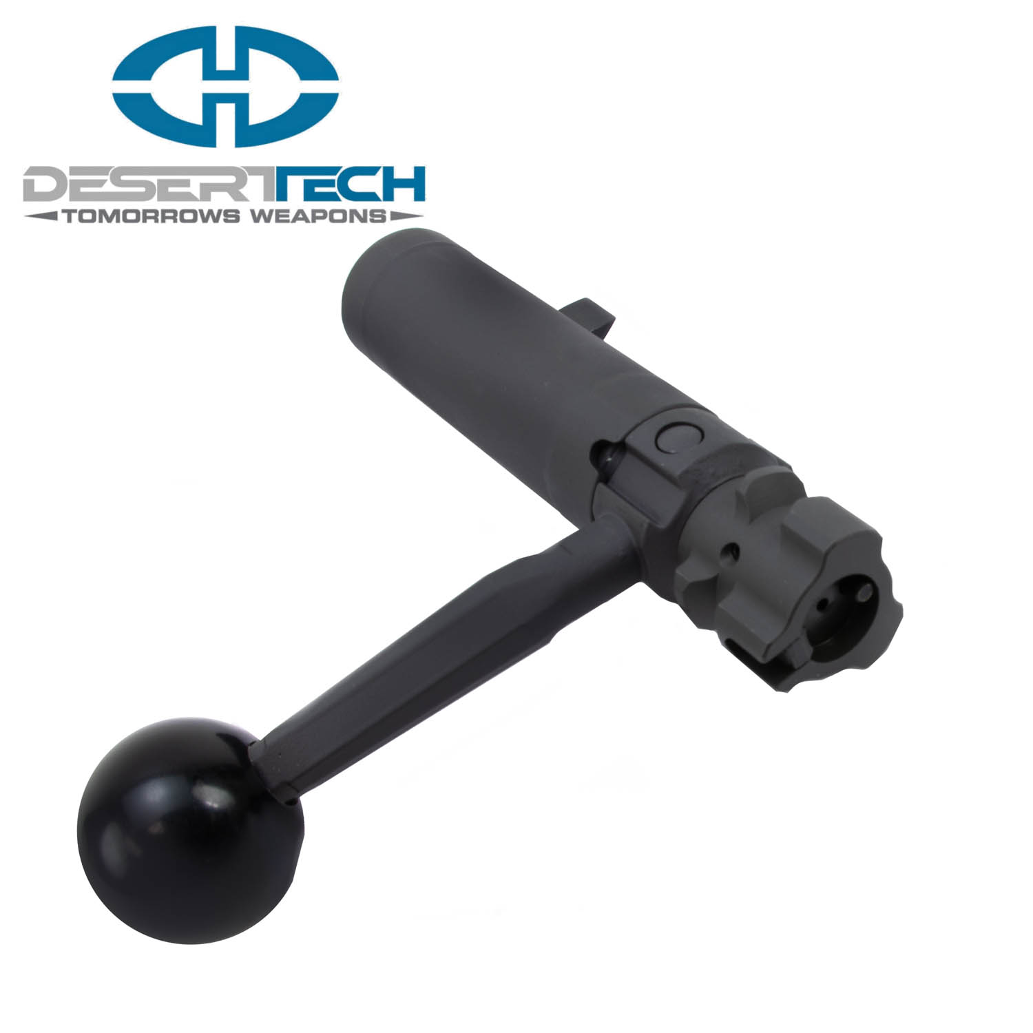

I’m hoping find one of the older swept ones. Will prob grab one of the new ones if I end up with a barrel and haven’t found one yet.Desert Tech SRSA2 Bolt Assembly, 260Rem/308Win/6.5x47, Right Handed
Check out the deal on Desert Tech SRSA2 Bolt Assembly, 260Rem/308Win/6.5x47, Right Handed at MGWwww.midwestgunworks.com
You're looking for an A1 bolt then. They do pop up from time to time. Maybe check with Orkan he may have a few leftI’m hoping find one of the older swept ones. Will prob grab one of the new ones if I end up with a barrel and haven’t found one yet.
