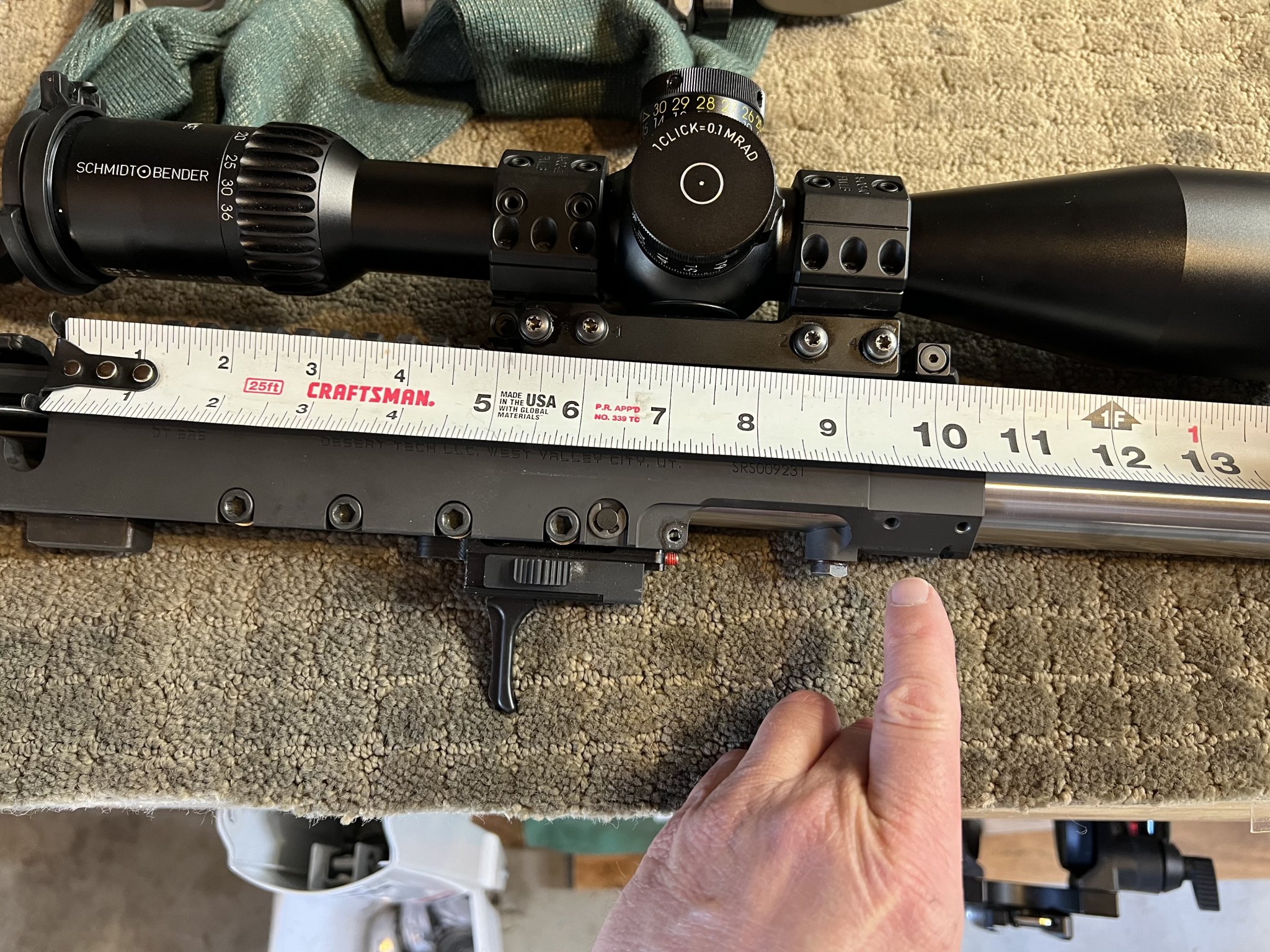

In continuation to my posts above about long shanks at 1.250" on an A2 - trust me: you're going to want that shank stepped down to 1.200" to give it 0.025" clearance on either side for the front of the chassis of where the handguard bolts on. I don’t think you want an interference fit in that area. If you like a long shank (haha) for possible set-back later, step it down to 1.200" by 8" rather than 6" but I would not go longer than that at 1.250" so that you clear the channel fore of the clamping area where the handguard bolts on.
For the A1's it doesn’t matter, and if your taper is aggressive enough and your barrel short enough, it won't matter. But if you're running a long barrel with a straight taper....

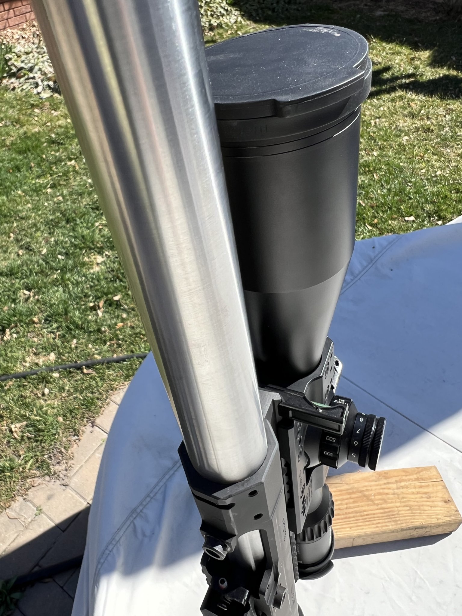

I just discovered the latest cluster fuck on my A2 rifle today, which has wasted quite a bit of time ammo effort, and expense
are you able to torque down the rail? What a pain!!!
Well, my zero has changed every day I have gone to the range in the last two weeks so it won’t hurt me to remove the scope which I have to do to get to the six screws for the top rail
So yes, the A2 has a bolted on rail to save in manufacturing costs for interchangeability of parts with the M2 chassis.
I slathered every square millimeter of mating surfaces with Loctite 271 including all six bolts and torque them down to 50 inch pounds

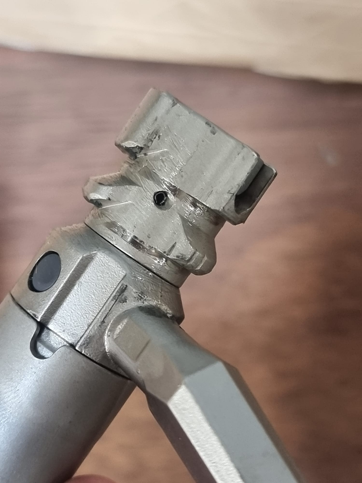

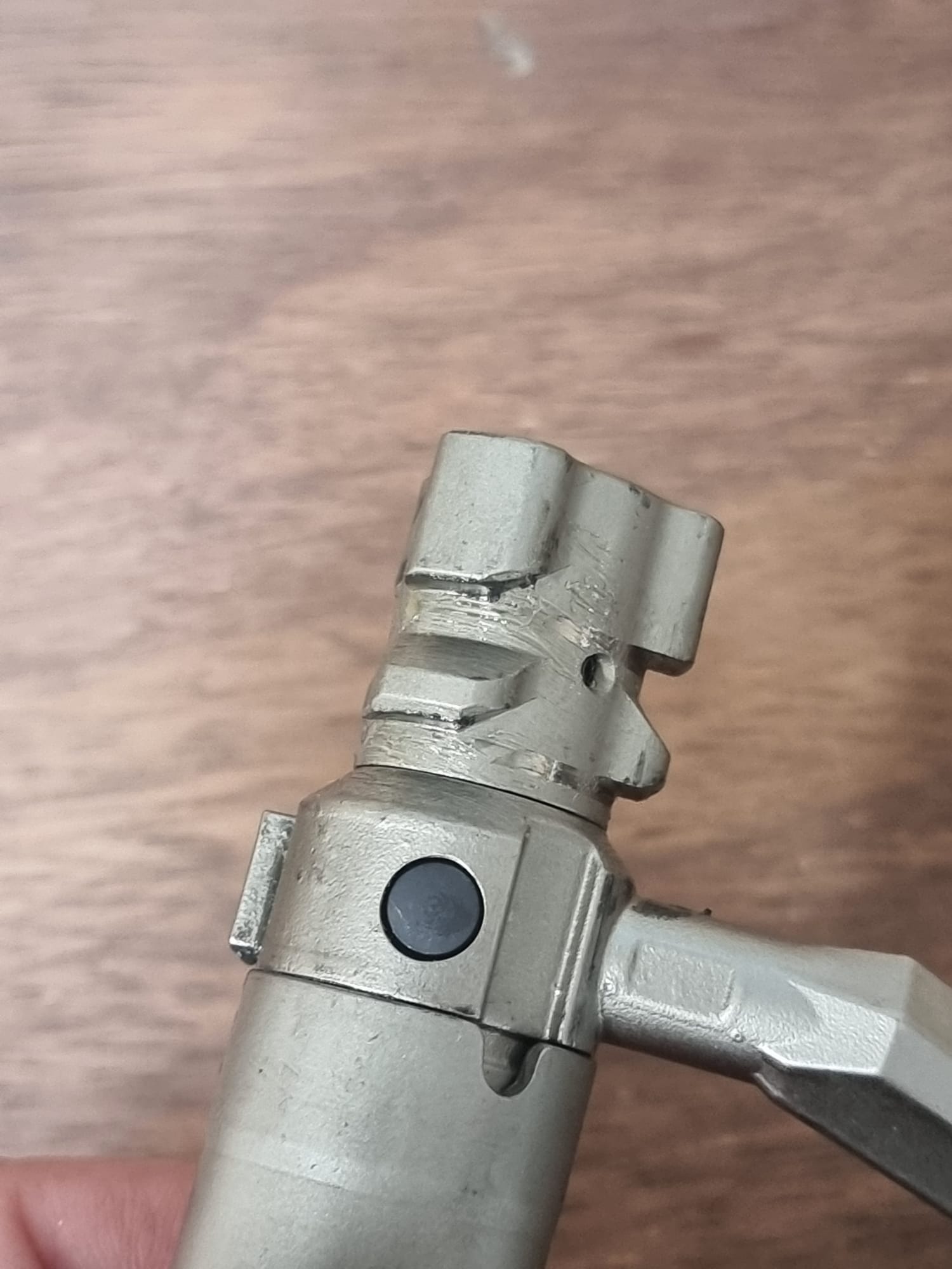

As much as i LOVE the Desert Tech product, i whole heartedly agree their QC has gone to Shit!!!
My dealer just got in a batch of new barrel conversions..
Most have bolt heads that look like complete "Rejects" !!! there is no way these should be shipping out. he has already had a VERY unhappy customer send back his newly acquired conversion.
This is a sample of some of the "better" looking bolt heads!!!

That's disgusting!
It is saddening that DT has messed up the SRS so badly!

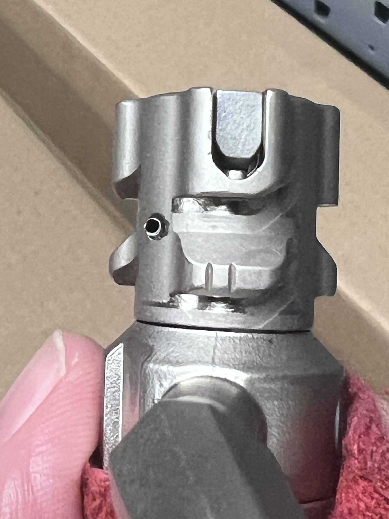

We have a lot of conversion kits and bolts coming through our shop. I’ve never seen bolts like that. I’ll pop open the kits I have received recently and will let you guys know if any look like that.
How did they look?
All of the bolts looked normal except for this one. This bolt looks like it was re-worked under two of the lugs. Doesn’t look bad, but there was obviously some machining done after the coating had been applied.
The picture is a little deceptive. The machining marks look smooth in person. The picture makes them look a little rough.

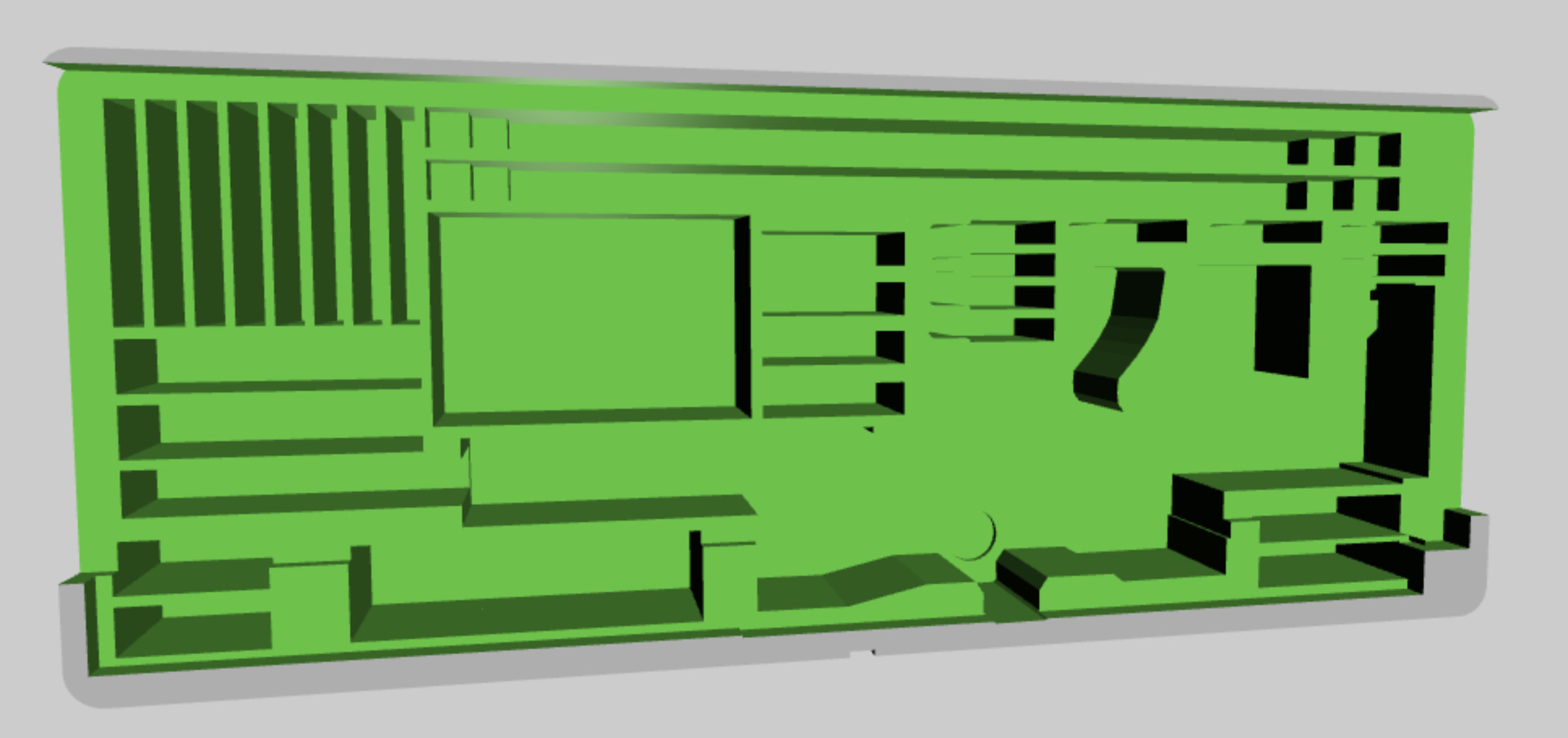

Do you have five, six or even seven barrels for your SRS? Do you have an unholy compulsion to make sure everything you own can be locked in a fitted transport case? Do you have entirely too much time and/or money on your hands? Have you ever wondered what it would take to make a rifle case weigh 120lbs or more? Does "unwieldy" even have a definition in your universe? These and many more questions will be answered on the next episode of, SOAP.
Keep in mind this is not really designed to be a transport case. I mean, I do occasionally drag that heavy bitch to the car and stab it into the back seat of a 2001 Mustang Cobra because it won't fit in the trunk but that's not what it's "for". It's a storage case meant to keep all the bits together. I have a smaller but extremely similar case that I also need to redesign the case foam for that is intended to be my travel/transport case that doesn't hold as much of or the same stuff as this one.
Room for: 1x Desert Tech SRS soft case w/ backpack straps, 1x SRS M2 (this one is cut out for a Steiner M7 mounted in 1.5" rings) including up to a 28" barrel + 2" brake with a bolt and 1x long or short mag installed in the chassis, 8x additional long mags, 8x additional short mags, 4x additional bolts, srs operator maintenance kit, 2x 10rd boxes of Lapua .338LM (or whatever you like such as: FTS camera bits, flip caps, batteries, condoms, soy supplements, personal wand massagers, etc...), PVS-30, almost any bipod you might want, 2x additional 26.5" OAL barrels, 2x additional 28.5" OAL barrels, 2x additional 30.5" OAL barrels, 2x cutouts for Surefire/Kiji weapon lights/heads/bodies (or flip caps/sundries/tampons/etc...), plus 2x of what I call "tevs" slots. Tevs slots can each take, well, whatever: 1 recoil pad + 3 recoil pad spacers, other combinations of spacers and pads or 1x 20rd box of literally anything up to and including .338LM.
No. I don't think I'll actually order this setup because I'm down to 5 barrels and likely going down to 4 barrels soon. If you wanted to be able to put 30 grand in a single box though, this might be just the ticket. I did find a few optimizations that I can do to my prior design though. The steps in the barrel cutouts in the last design were fine in the drawing but that didn't translate well for the machines that do the actual cutting so I rejiggered that. The PVS-30 almost never accompanies the rifle and it ended up easier to not have it mounted on the rifle before being put in the case when it was going to join us on the journey. The prior case was only cut 3.5" down leaving 2" of unused depth and I couldn't get the soft case in with everything else. Whoopsie! This configuration uses the soft case as additional topside padding. What I'll probably do for the one I end up ordering is knocking out one of the barrel cutout stacks, reorganizing the cutouts for the short mags and instead of using the soft case as top padding, I may chop the whole top far enough to let me put the soft case under the case foam. We'll see.
Previous layout:
The previous layout, as you can see, was not 100% optimal largely because I didn't have everything on-hand when setting it up and so I had to guesstimate quite a number of dimensions. My prior version also held only 4 spare barrels and a 2-fewer magazines and is near or at 100lbs depending on that day's particular load-out.

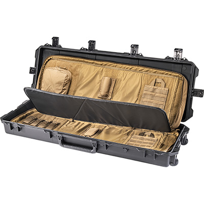

Does anyone sell something like this?
I've had very few issues with my A1. The only minor complaint is that the trigger adjustment screw came loose, likely from my own adjustments. Fit and finish have been good. Is it a custom rifle? No, but it is well built, accurate and does what I want it to. If DT's quality control has come down in the last few years, I think it'd be due to them trying to do too much at once. I will say though, it SUCKS trying to get replacement parts in Australia. DT, please please get stuff to Aus at a decent price and available!

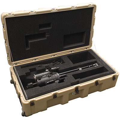

You might try here: https://www.pelican.com/us/en/product/mobile-military-cases/fieldpak/mobile-armory/472-pwc-dw3200
This is what I use, there are many different sizes of mil spec cases that can be used. I recommend one for the gun, an extra barrel and main accessories. Then a matching box of the desired size for barrels. I'm sure if you wanted to you can get what you need here to put everything you want in one case, but it will be heavy!
