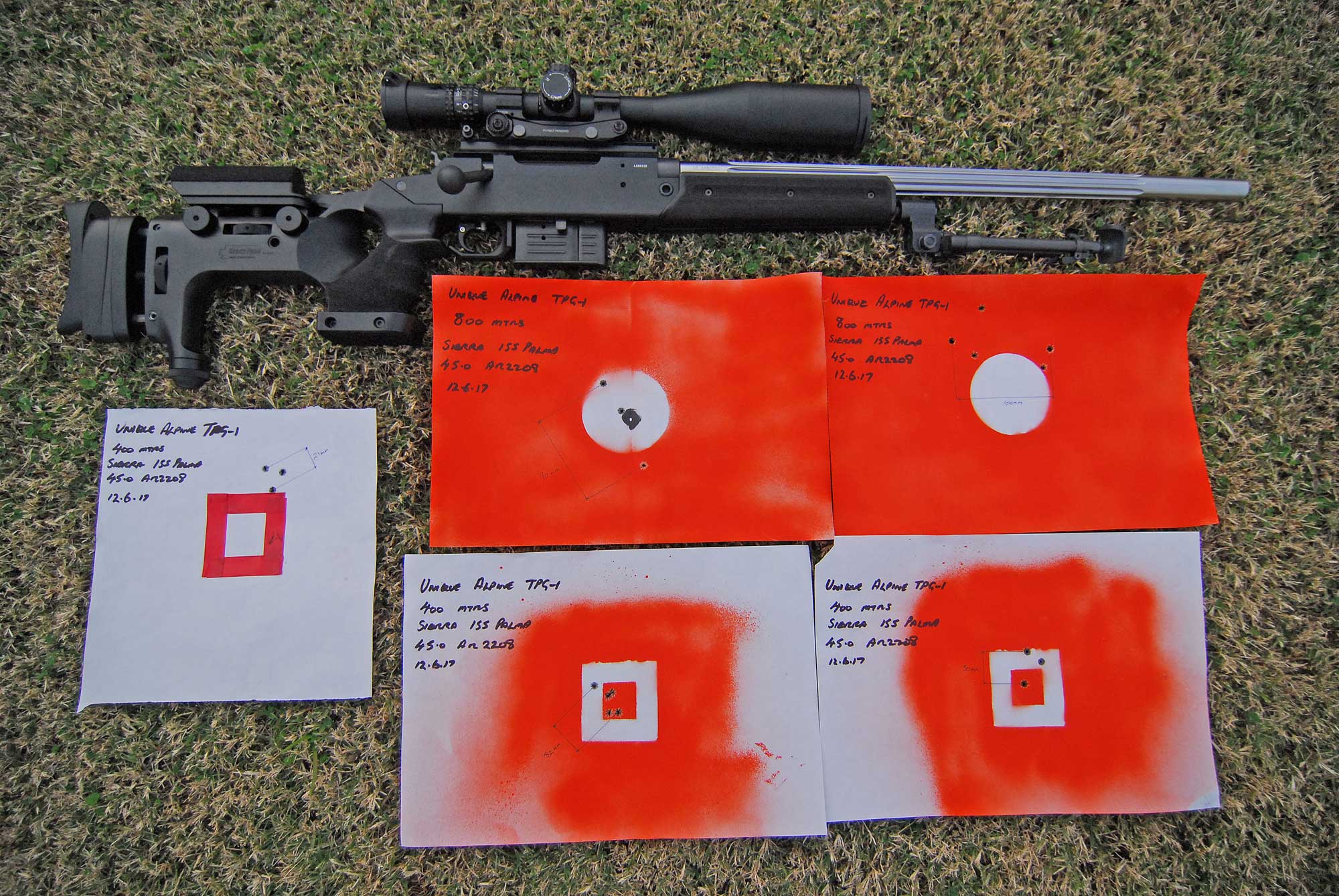

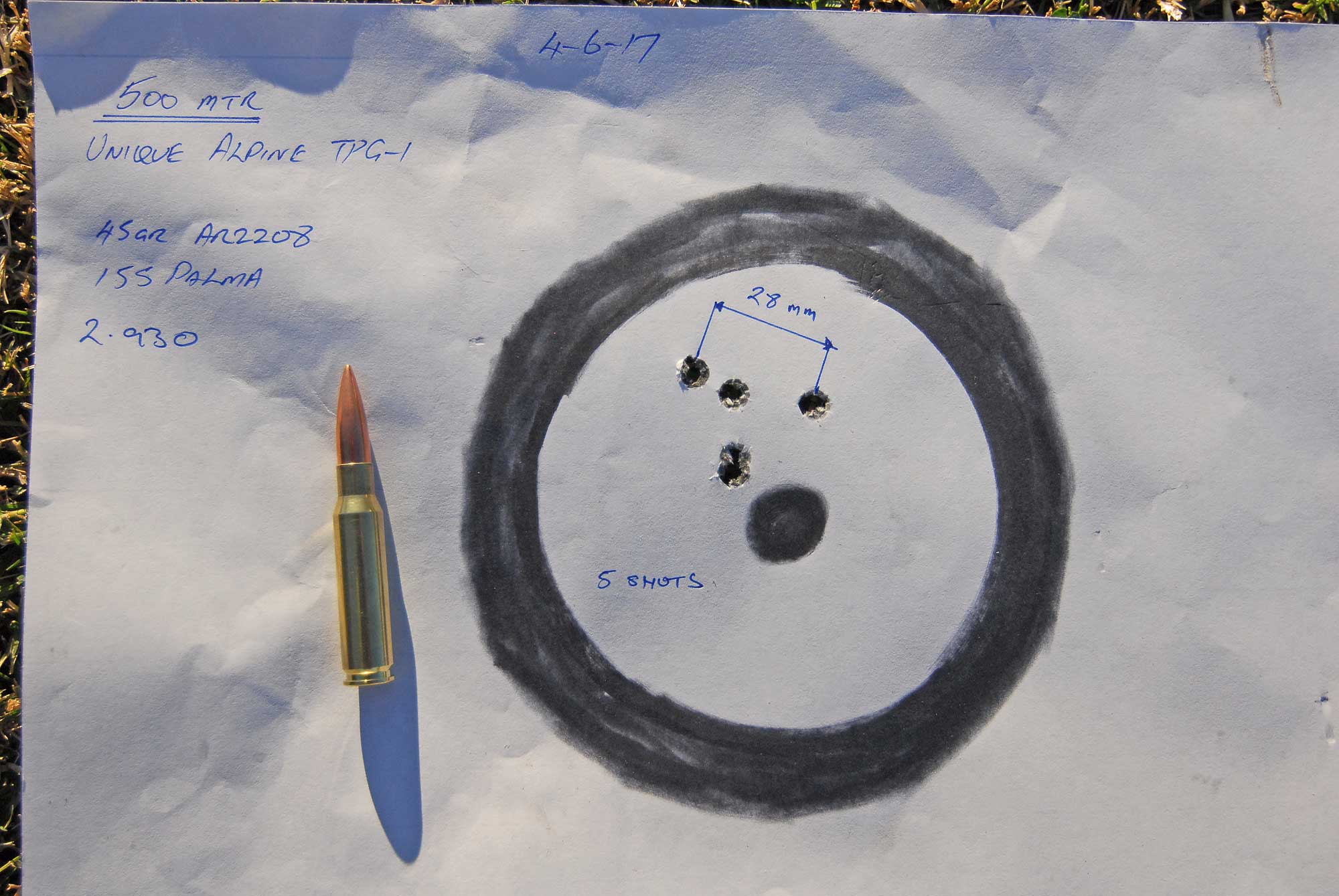

This is the only other rifle i put up there with the Desert Tech......
Unique Apline TPG-1..... A superbly accurate rifle!!

TPG-1 ..Superb action, built like a bank vault and super smooth!!
1 Inch Dia bolt on the 308..
I looked the Unique Alpine up and read about it. The first reaction I had when I saw your photo of one, was how comfortable it looked! Then the first article I read made a point of how comfortable it is! It truly is a very nice rifle. They said Unique Alpine worked with FN to do the APG3, or FN's Ballista. You have a great rifle!
