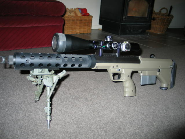

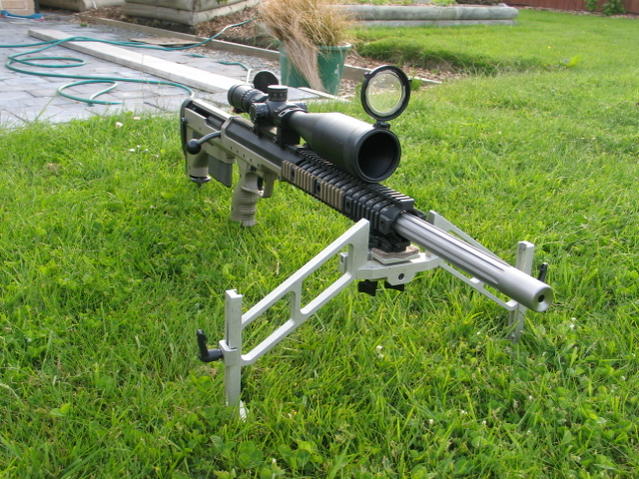

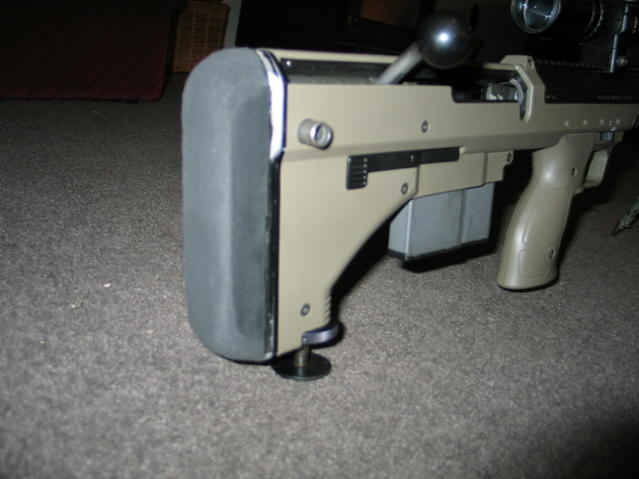

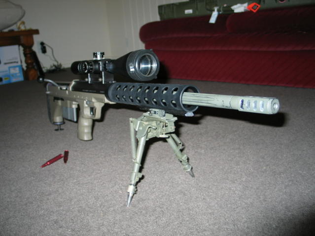

Hi from New Zealand , just a few pics of mods on SRS DIY butt pad , for-end tube made by a mate for , me I find the factory unit uncomfortable to hunt with and this tube provides a little more clearance for flip out lens caps
FTR 30" 1/10 barrel set up 308 win with 175/178 gr gen 1 sinclair bipod ,now replaced with gen 2 bi pod .
300win mag factory barrel DPT break 40 moa mount. shooting 208 gr amax 76.5 gr AR2217 (H1000) 16 th jump approx 2960fps
225 gr HRN BTPHP 75gr approx 2830fps shooting out to 1700m
Finding both loads go to sleep around 300-400m
I'm hoping pictures attach , I'm new to this blogging thing.

I used a product called Selleys windscreen fix , which is a silicon RTV product ,the trick is when you adhere the two together you must ensure you don't use to much pressure clamping them together , you need to leave a good 2-3 mm of the sealant in place to ensure they knit properly . I must have tried at least four recommended adhesives before I found something that works.
This was field tested on the range for around 100 rnds before I went to New Caledonia for two days PLR shooting , one day turned out to be a monsoon .
I'm pleased with the result . The rubber has the same texture and recoil absorption as my limb saver .
