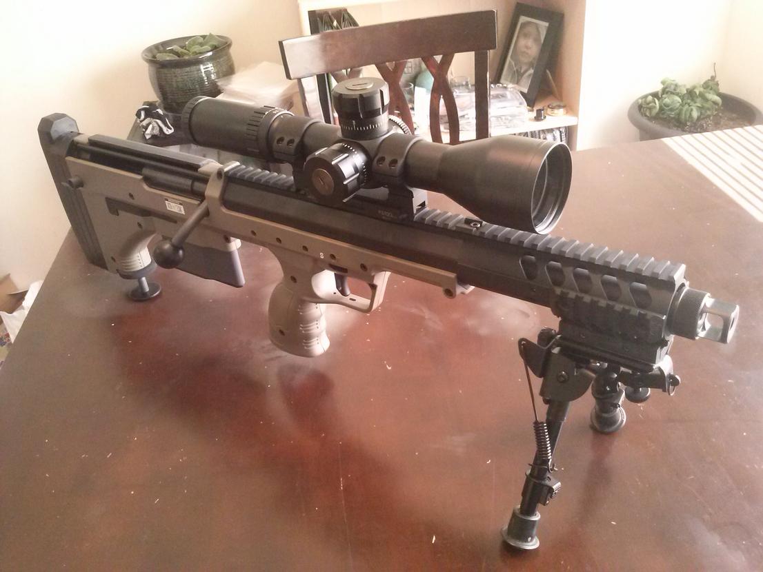

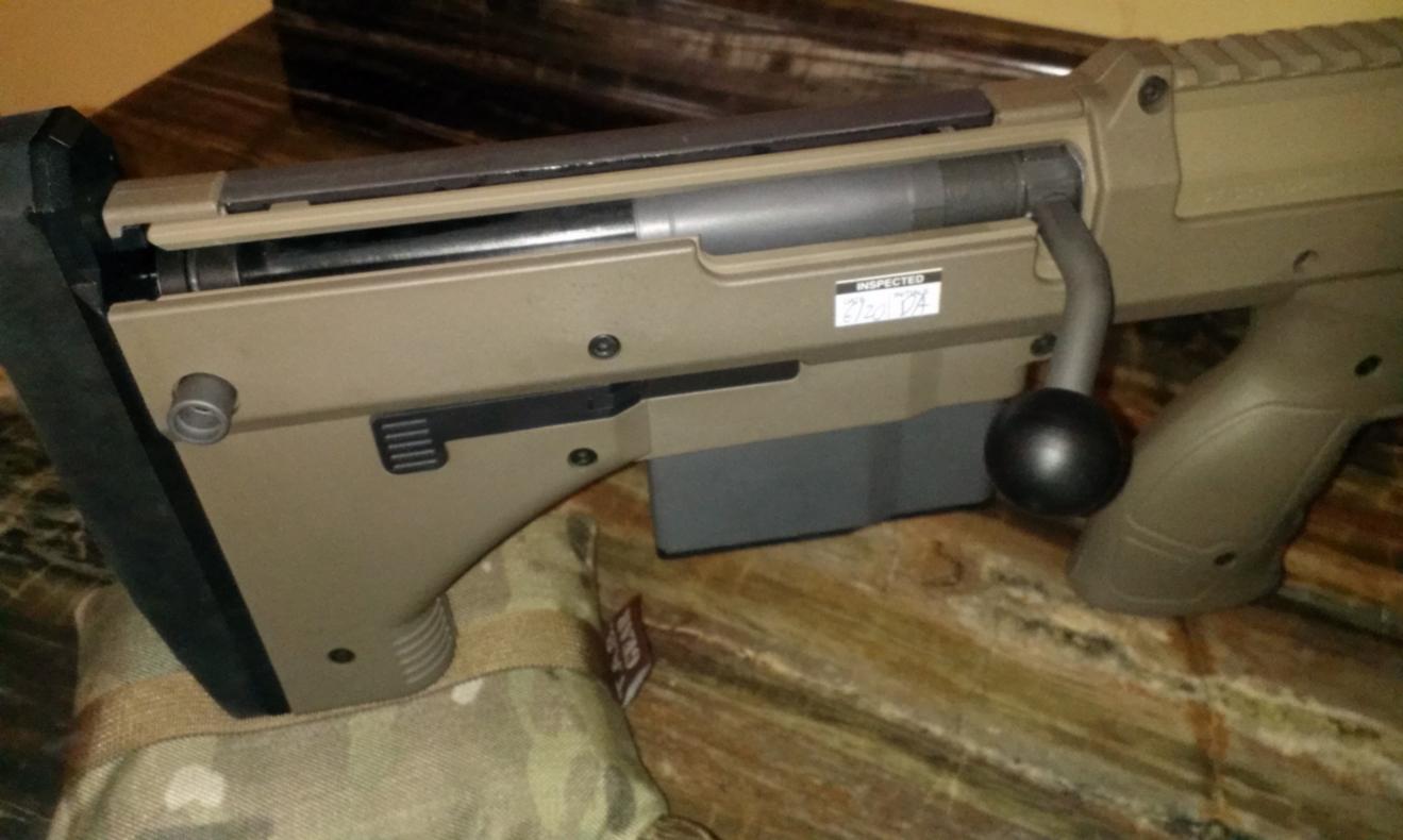

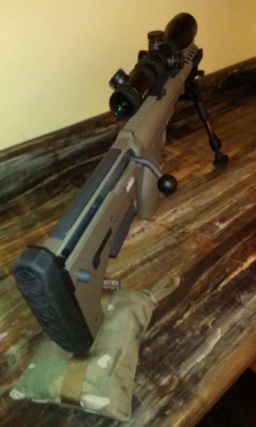

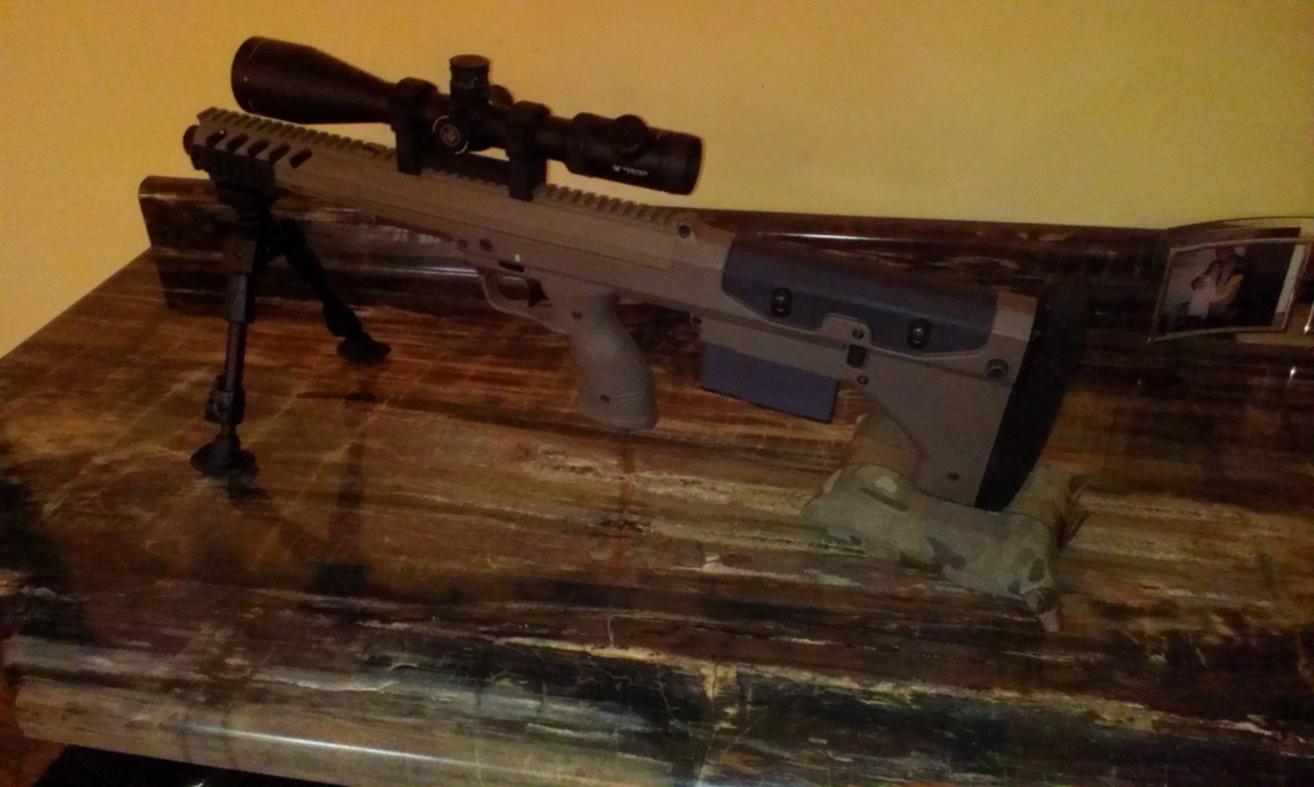

This one just went out to one of our customers. I snuck it up on the table for some pics before it got stuffed away for the shipper.
I like that! Looks like a shooter! Can't wait to take it for a spin this week!
Greg at Primal Rights was a great help getting this spec'd out for me... Just gotta find a monopod that's in stock somewhere...they are all gone.
Thx Greg, Matt

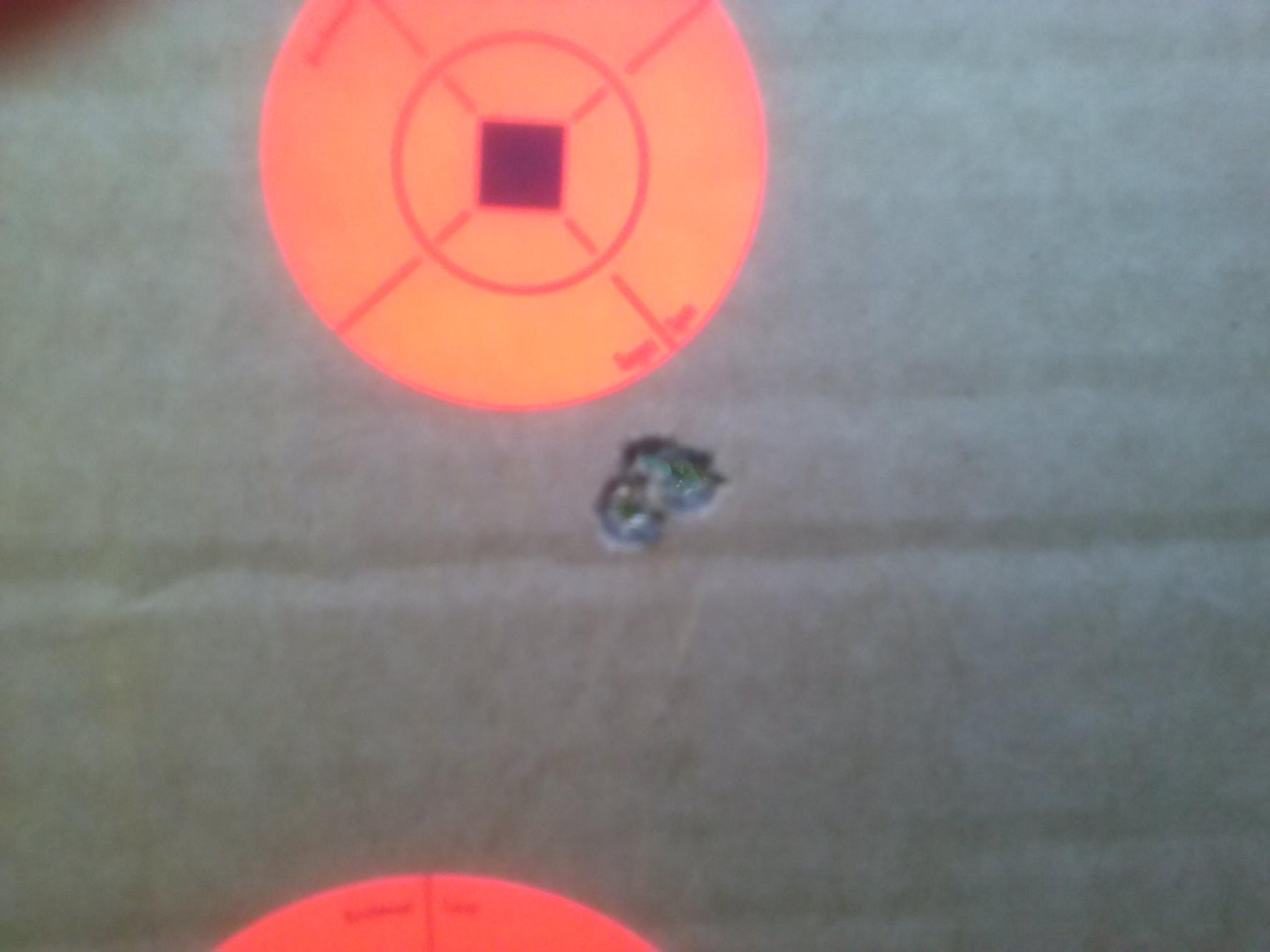

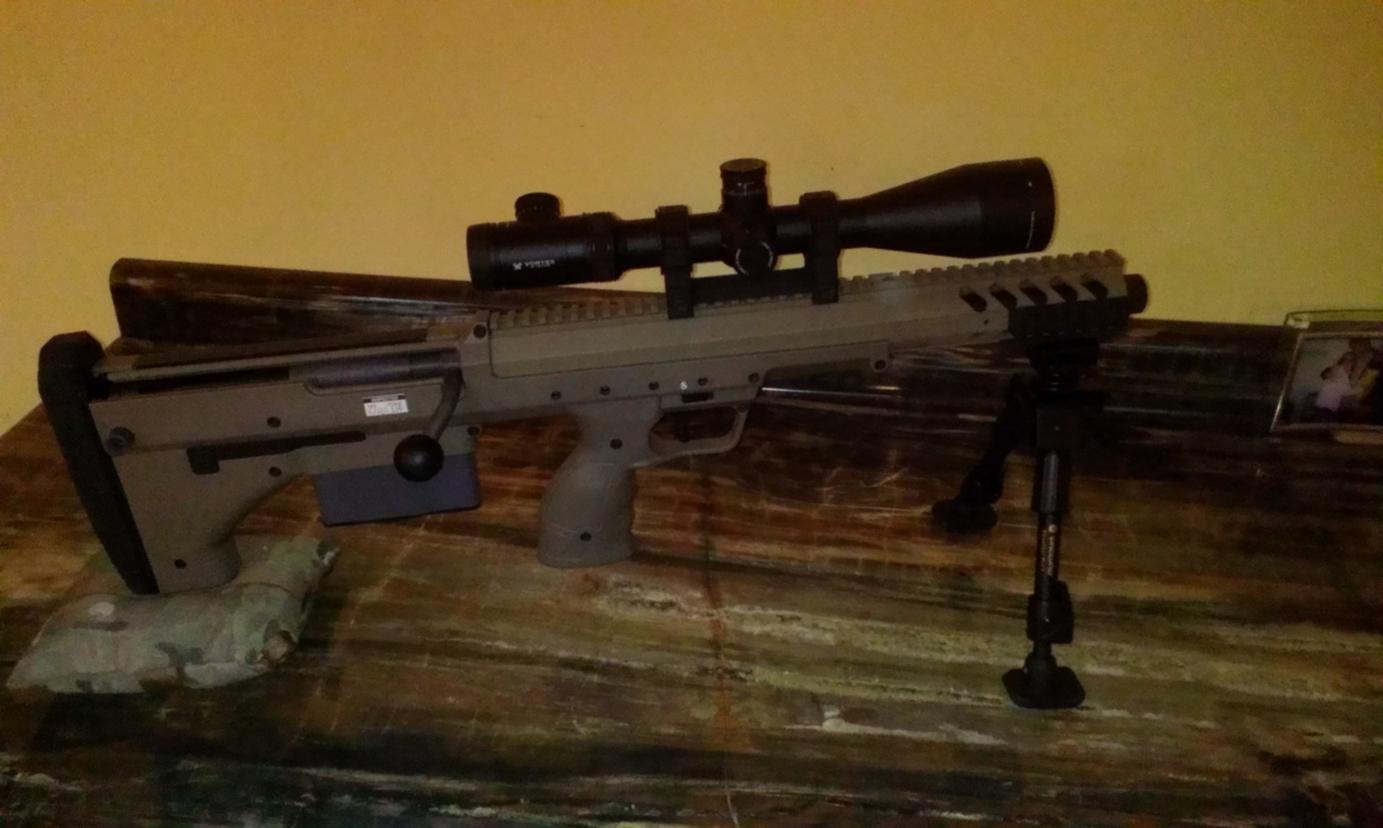

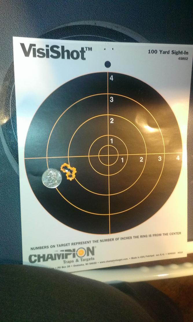

Here is a pic of my new Covert A1, and the first 3 shoot group with 168gr Fed GM Match. I know its only 3 shoots but not bad for factory ammo with only 20 rounds down the barrel. I can't wait to get some loads worked up for it, then I will get some 5 shoot groups posted. This is well worth the wait, a (BIG) Thanks to everyone at DTA for their hard work and commitment to making a quality product.

Thanks ofd343 it is an awesome system. Labanaktis, nice grouping I will go with the 168's as well. The guys at DTA said they tend to like the 168's better, but will shoot the 175 pretty good to.

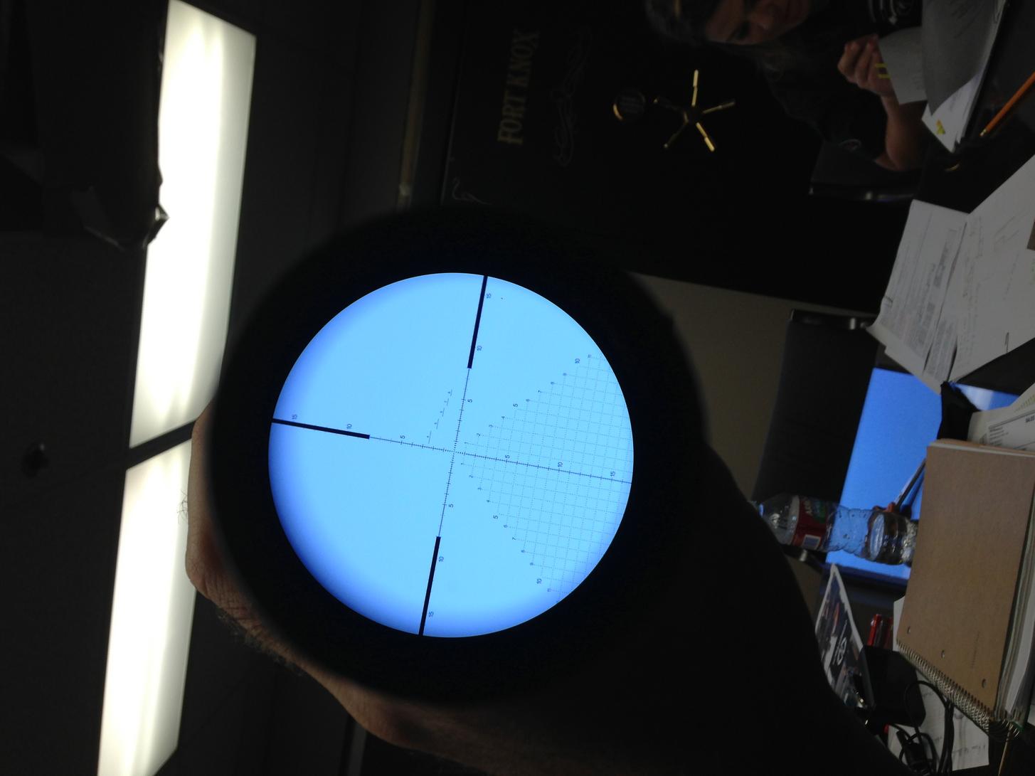

Guys we got the first production batch of AMR reticle scopes in two days ago. We will be posting range pictures and feedback on them very soon. Here are some quick pics of the reticle looking out my office window.

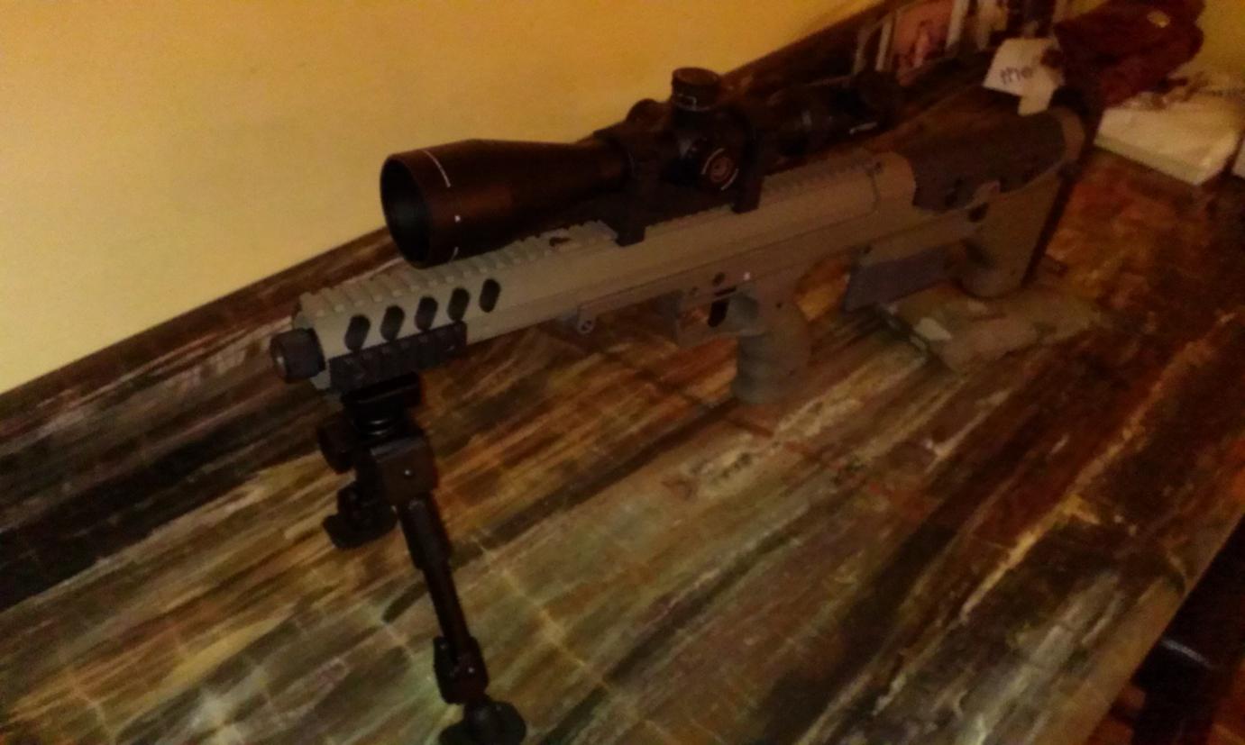

The DTA has a new warm bed thanks to Alex at EuroOptic. Ordered at 6pm on Monday and was at the shop by COB on Wed....wow! Biffj, you will notice the foam kicks ass compared to the foam you hate in your case.

That reticle is amazing!
I like to dial elevation and hold windage. The only problem is that with every other mil reticle the first hold off is at .5 mil. That is a ton of windage and so in comps I usually will dial windage as well on the closer shots.
The first time I saw DTA's with .2 mil holds I just smacked my palm on my face! I hate to say it boys, but its only a matter of time before every other scope manufacture creates similar designs. It is so brilliant, yet such an obvious solution after you see it.
