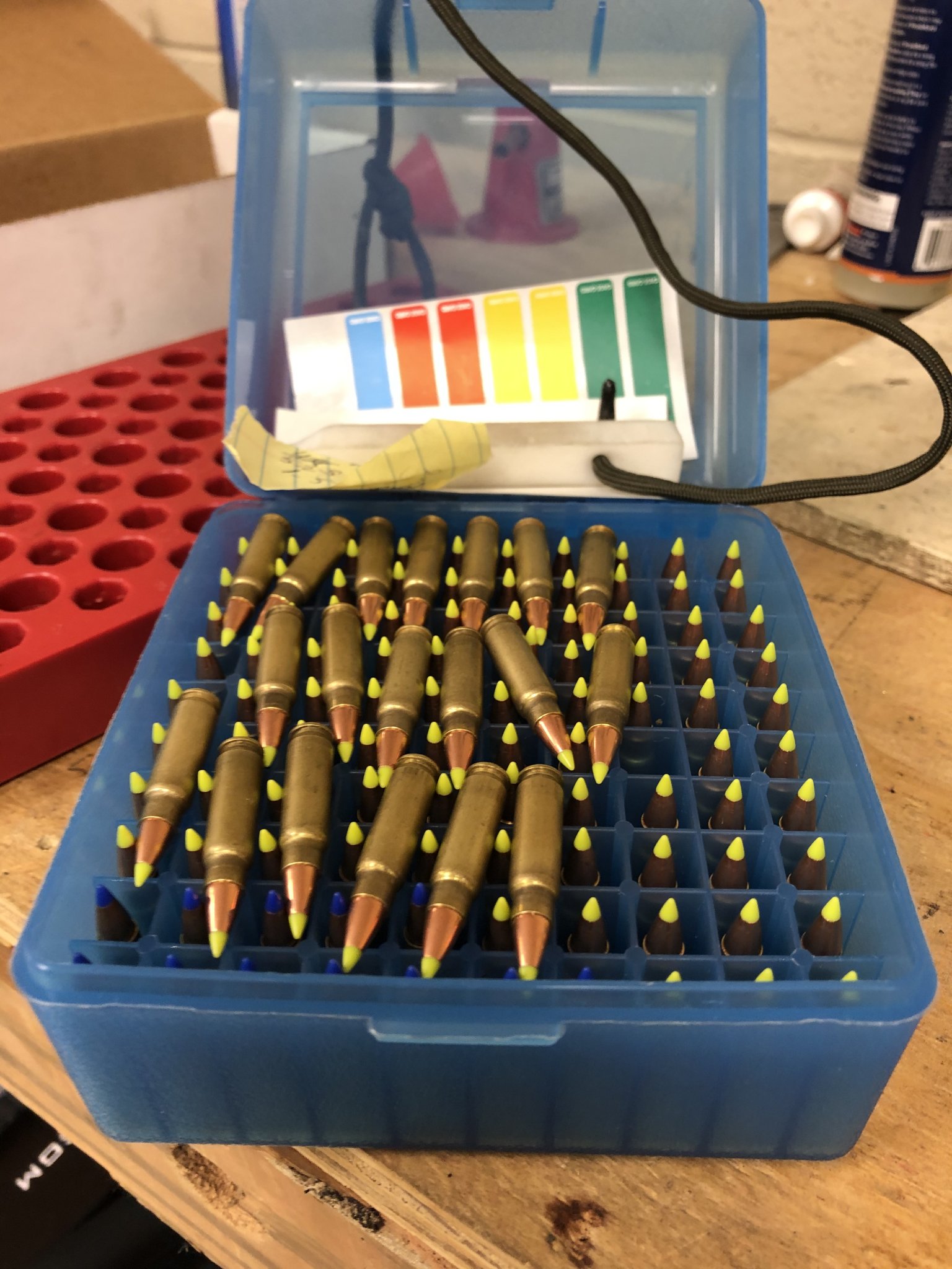

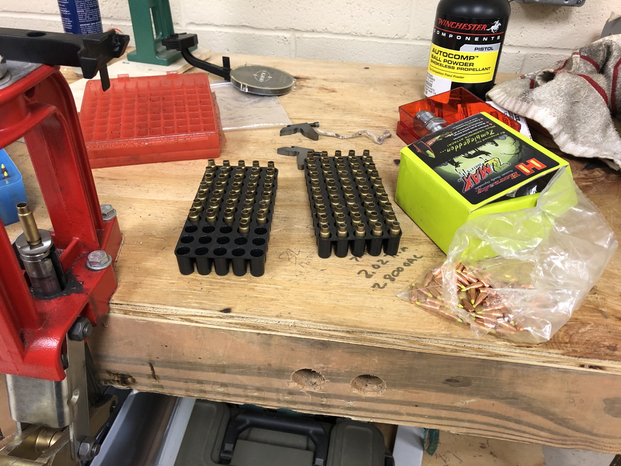

I don’t worry about the coating for my purpose. I played around with it when I first started reloading but never did more than burn a few cases. I tumble mine in crushed walnut now just like everything else I load.
