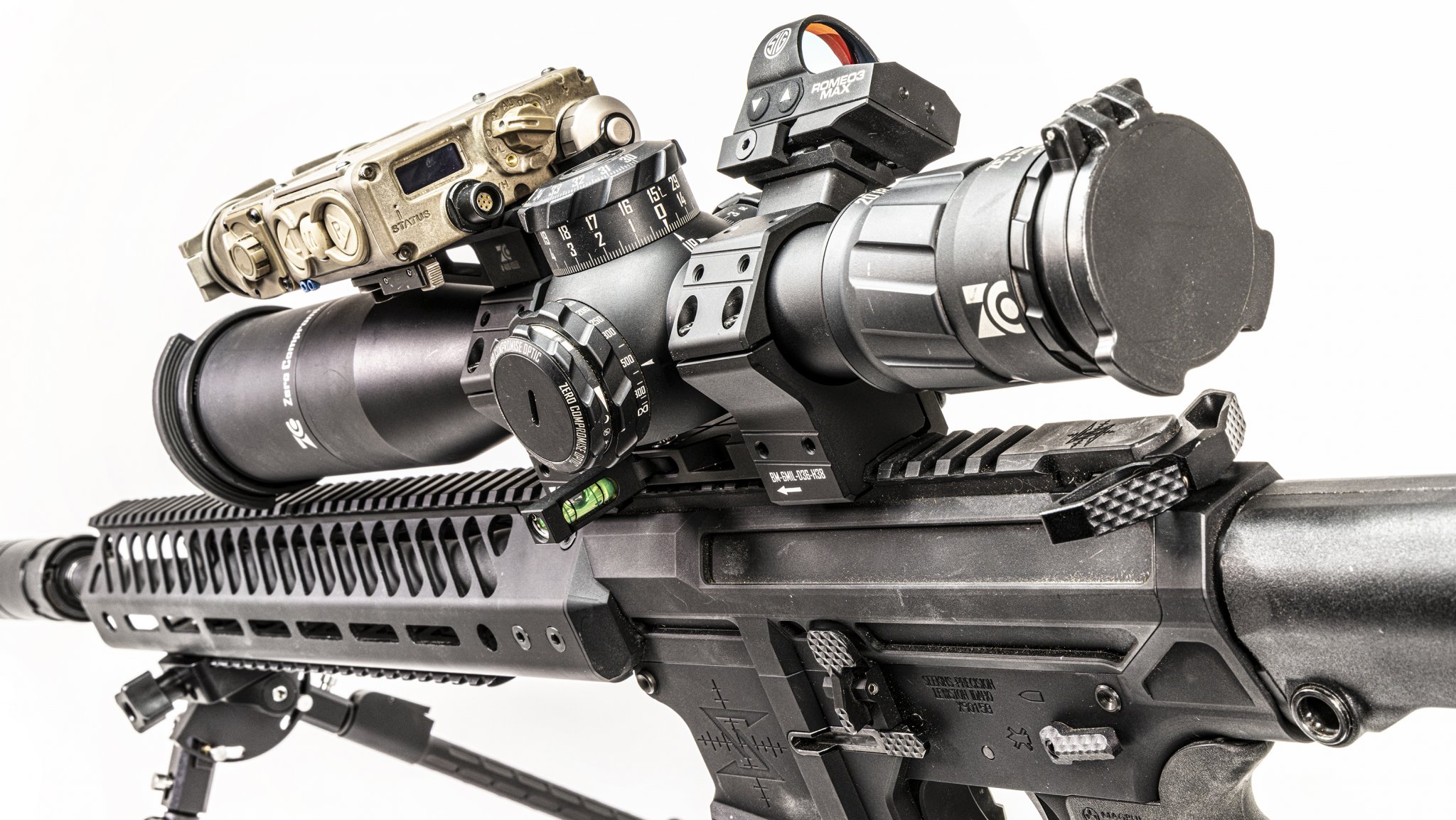

I was asked about setting up a ZCO Block mount with an offset and LRF. Unfortunately, the only pic mounted red dot I had available was a Romeo, and there isn't an offset option for a straight RMR, DPP, or Aimpoint attachment. Would anyone else be interested in seeing an offset with RMR, DPP, or Aimpoint footprints available?
I wouldn’t mind an Acro mount in the 12 o’clock position without needing the dive board.
Reactions: CSTactical

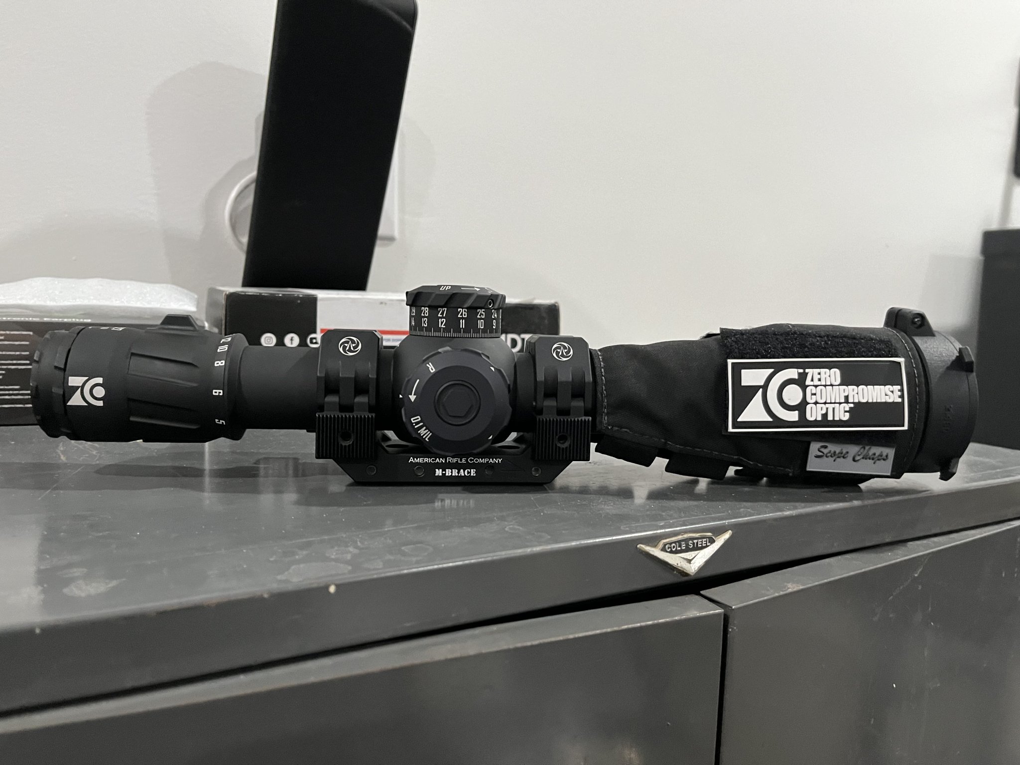

Love it! Mines on its way. What motivated you on the choice or rings/mount? I’m 90% leaning to the Spuhr 6002.
4 bolts vs 17. One single 55lb torque.
And I hate how shallow the star grooves are in the spuhr. You can literally change bit brands and go from working fine to stripped bolt heads. Even though you’re using the same size star bit.
Nothing against Spuhr at all. But ARC has been flawless for us for years and much easier on install or removal.
Like everything else I’m sure there are people who have had multiple failures with ARC. Always going to be outliers. Same with Spuhr.

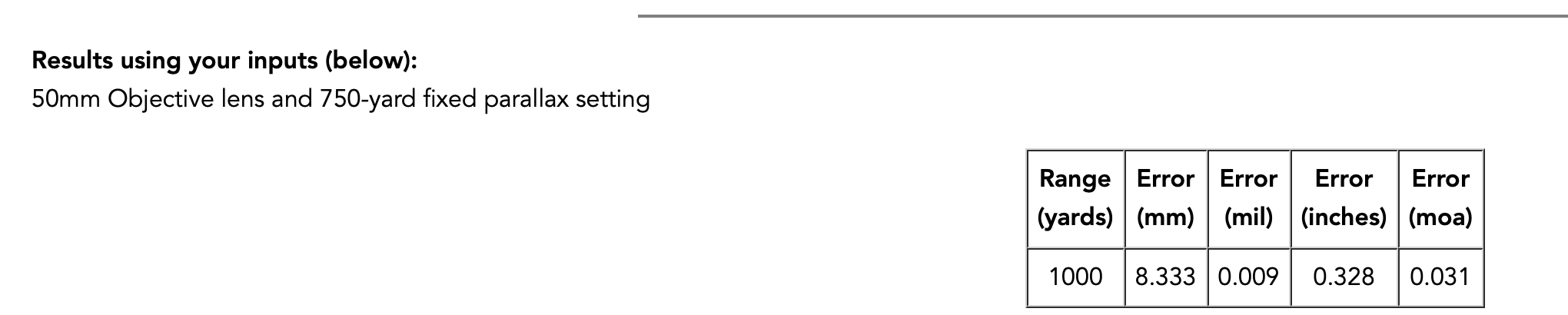

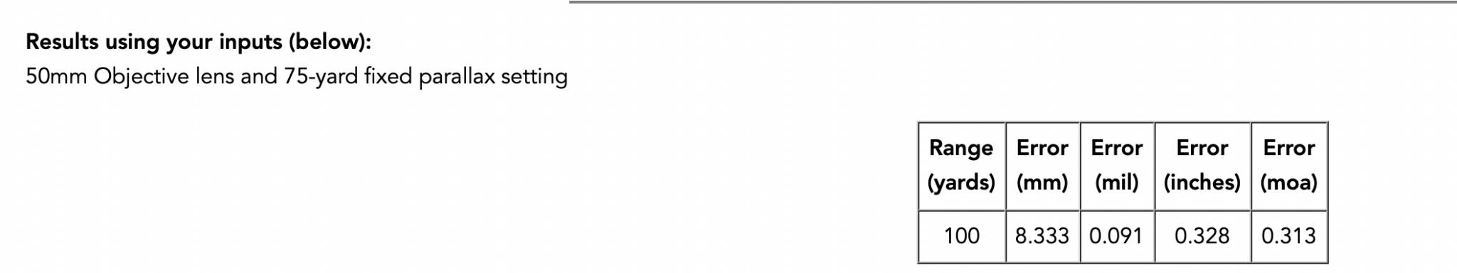

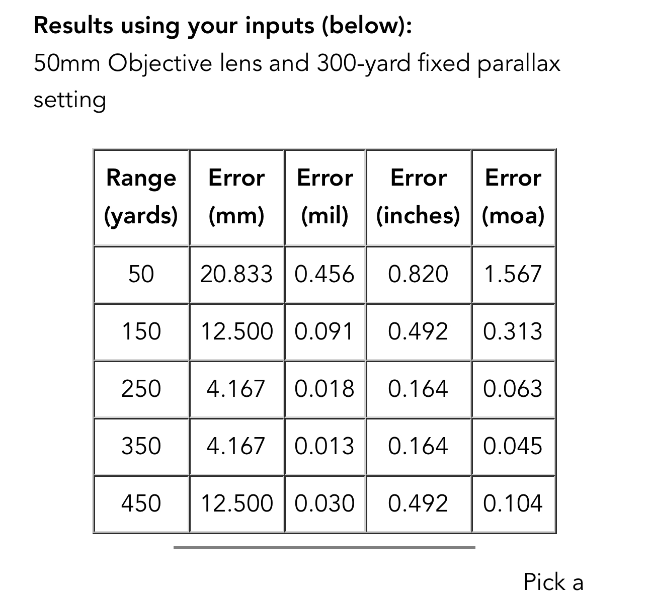

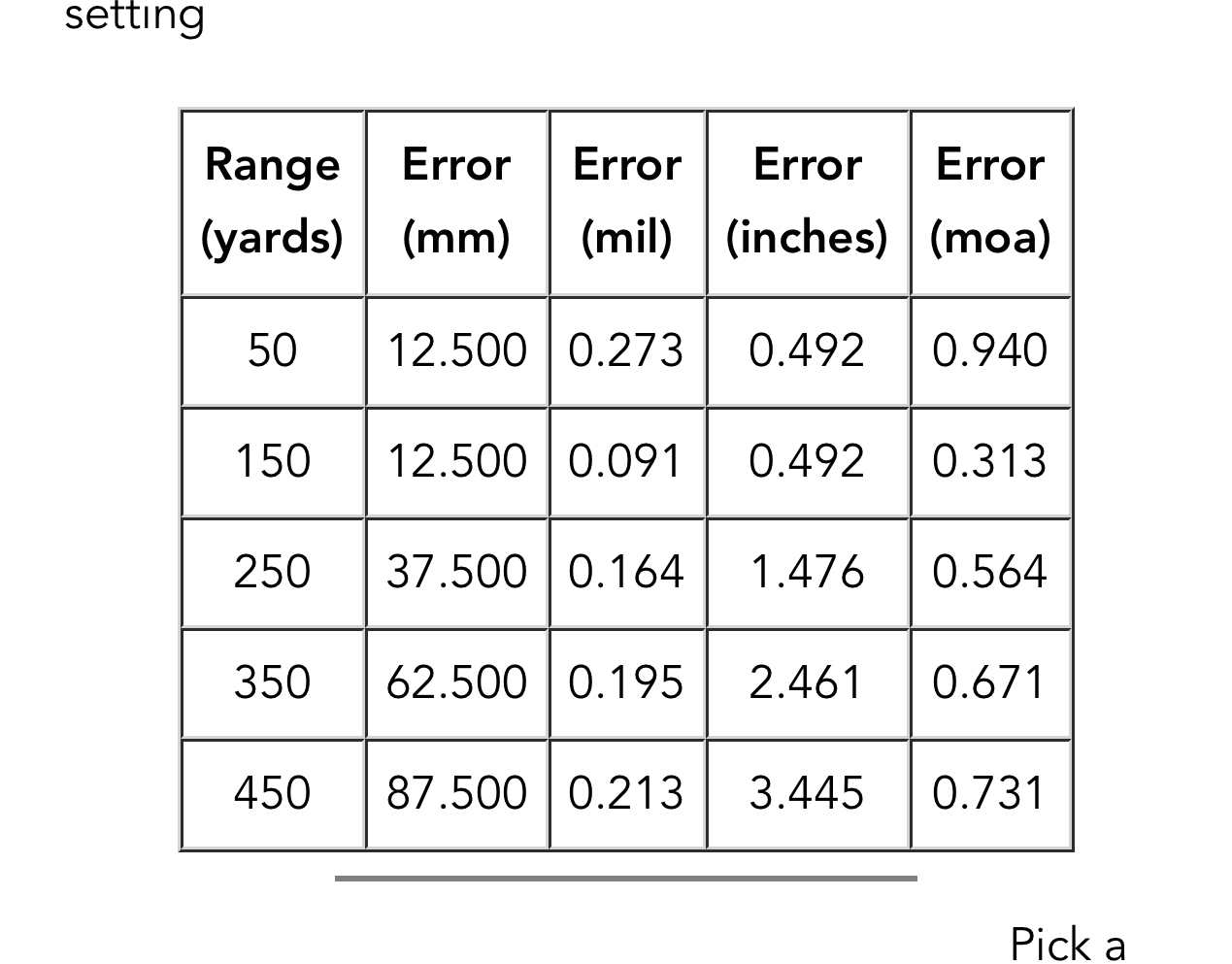

Likely because it doesn’t matter much. Below are charts with the maximum parallax error with a fixed 100 or 300yd parallax.
Meaning you’d have your head as far to one side and the reticle center would appear against the opposite side of your sight picture.
Parallax error is *not* angular like most other optic values.

No prob. Parallax is widely misunderstood. Generally speaking, with fully adjustable parallax, it's much more important at closer distances.
This is because parallax is directly related to the linear value of the objective lens' radius. So it becomes a linear value vs the usually angular values we deal with in optics.
Most shooters place a lot of value on parallax at distance, and not so much closer. When it's the exact opposite.
For example, let's say you thought you were parallax free at 100yds, but it was actually parallax free at 75yds. Then let's say you thought you were parallax free at 1000yds, but it was actually 750yds. The results will likely look pretty crazy to you. The parallax error is the *exact same* linear value. This is because it's linear. 75yds is 75% of 100yds and 750yds is 75% of 1000yds.
But, once we take that linear value and combine it with angular shot dispersion......if we have a 1moa precision standard, you can have a 0.33moa error at 100yds and only a 0.03moa error at 1000yds.
Kinda nutty eh?
This is why you'll hear some people say that after a few hundred yards, they just use their parallax as a "focus" wheel. Since if the target is in focus, that means the parallax is close enough, it doesn't matter that far out.
