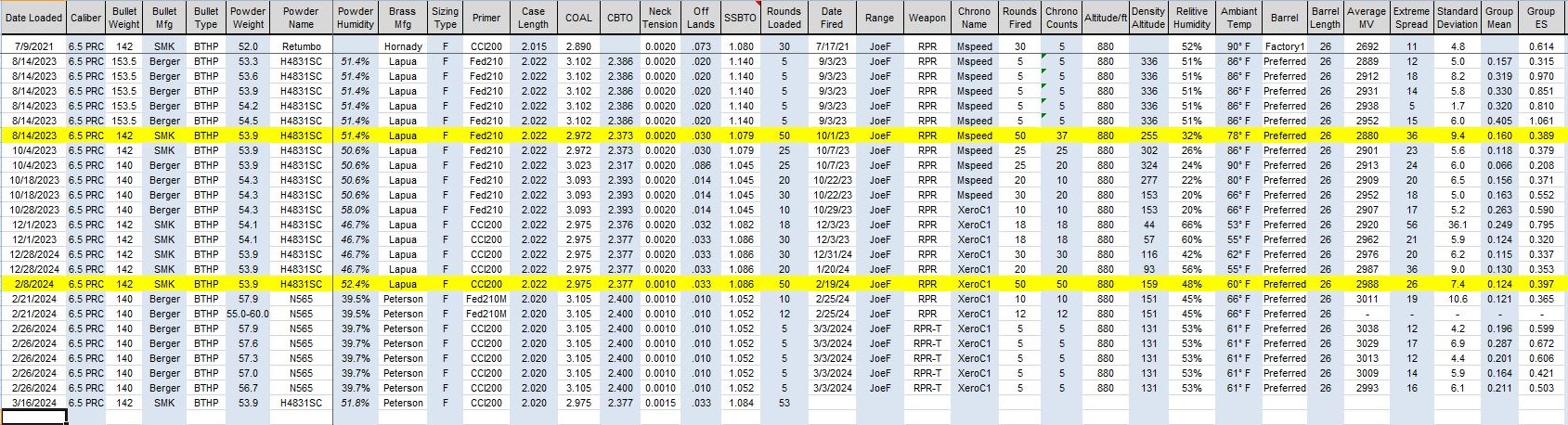

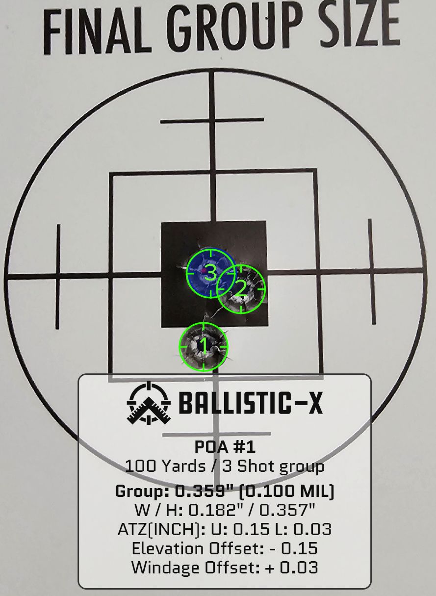

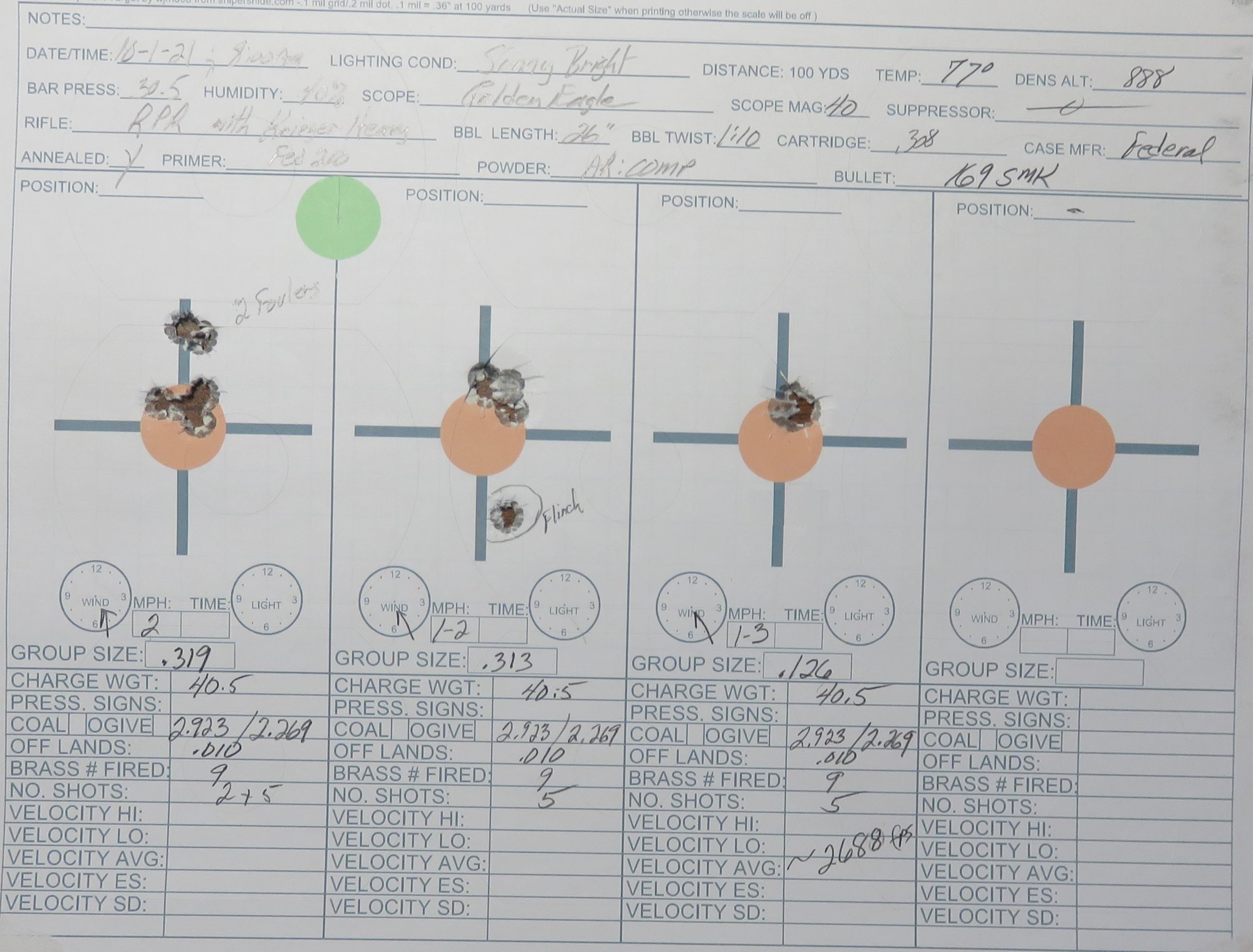

My approach to do in one day is typically like this:
Load 5 rounds for each powder charge from 39.2 to 42 in .3 increments at .010 off the lands. Fire only 3 rounds of each charge, except when the group is poor it's just 2 rounds as the group won't improve. Having gone through each charge weight, I'll look for the best group and how it relates to the groups on either side of it (am interested in least vertical change). I'll then fire the remaining 2 rounds of that charge as well as those for the groups on each side of it onto a separate target to see if I can verify and see if that charge is indeed repeatable. I don't bother with seating depth tuning until I find a good powder charge as the seating depth changes are best used for fine tuning the charge.
Well, this is how I approach it, and it seems to work well enough for me. :giggle:
So you base it off the group and not the SD from the velocity?

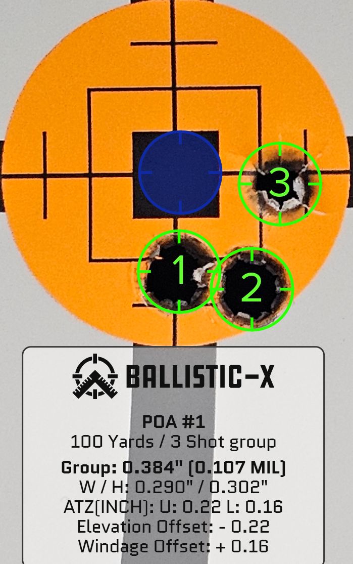

That's right. The thing I get out of velocity SD's is that they tell me how well I'm prepping and loading the cartridges. I can have good velocity SD's and still not have good groups. Poor velocity SD's tells me something is wrong with my reloading. . . and of course, that can show up on target as well. So, for an precision/accurate load, I don't look for the lowest SD's.

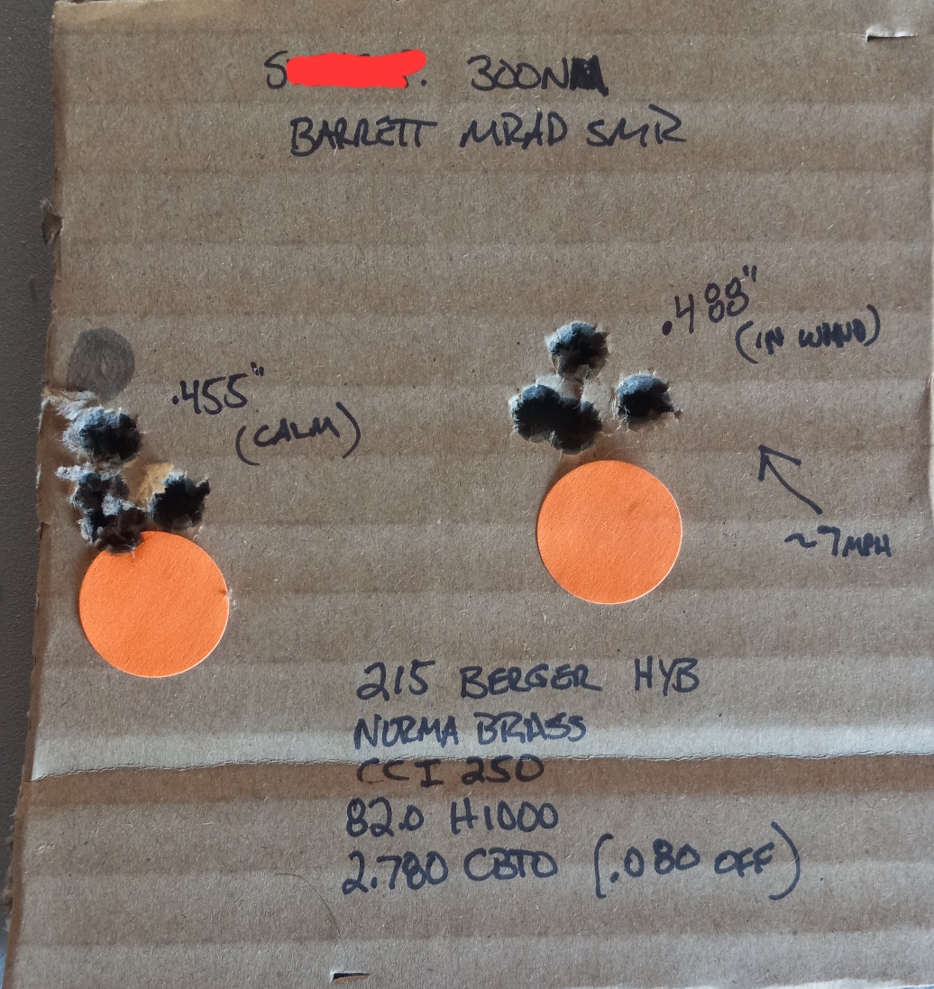

Here's a pic that I shared for another reason a while back that might give you some insight:

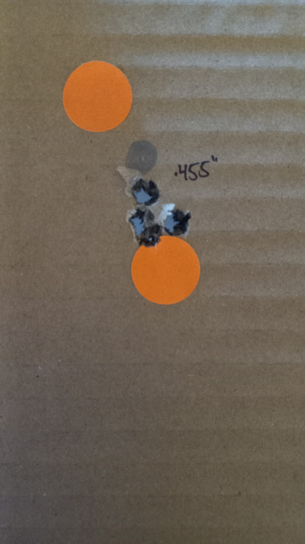

I've done it before (but probably more out of luck).
Picked a "safe" load that was near where I thought I wanted to be velocity-wise, and loaded in .010 increments (5x6, so 30 rounds total). Shot the shorter bullets first, and once I got a group I liked, I seated the longest down to that good load and tried it again.
You're at the mercy of your barrel liking the bullet and powder, but sometimes it falls into place. It is still a great way to end up with less optimal ES and SD though.
Last time I tried it was with my buddy's 300NM, but I only loaded 5x5. First two depths were ~.8" @ 100. 3rd attempt shot a .4", so I seated my longest back to #3 and shot another .4". Seated my 2nd longest down to #3 again and shot a .4 MOA @ 385. Seated the last 5 rounds, but was done for the day 20 rounds in.
First and second attempts with depth #3
Some barrels you get lucky, and some take you 3 bullets and powders before you find a winner.

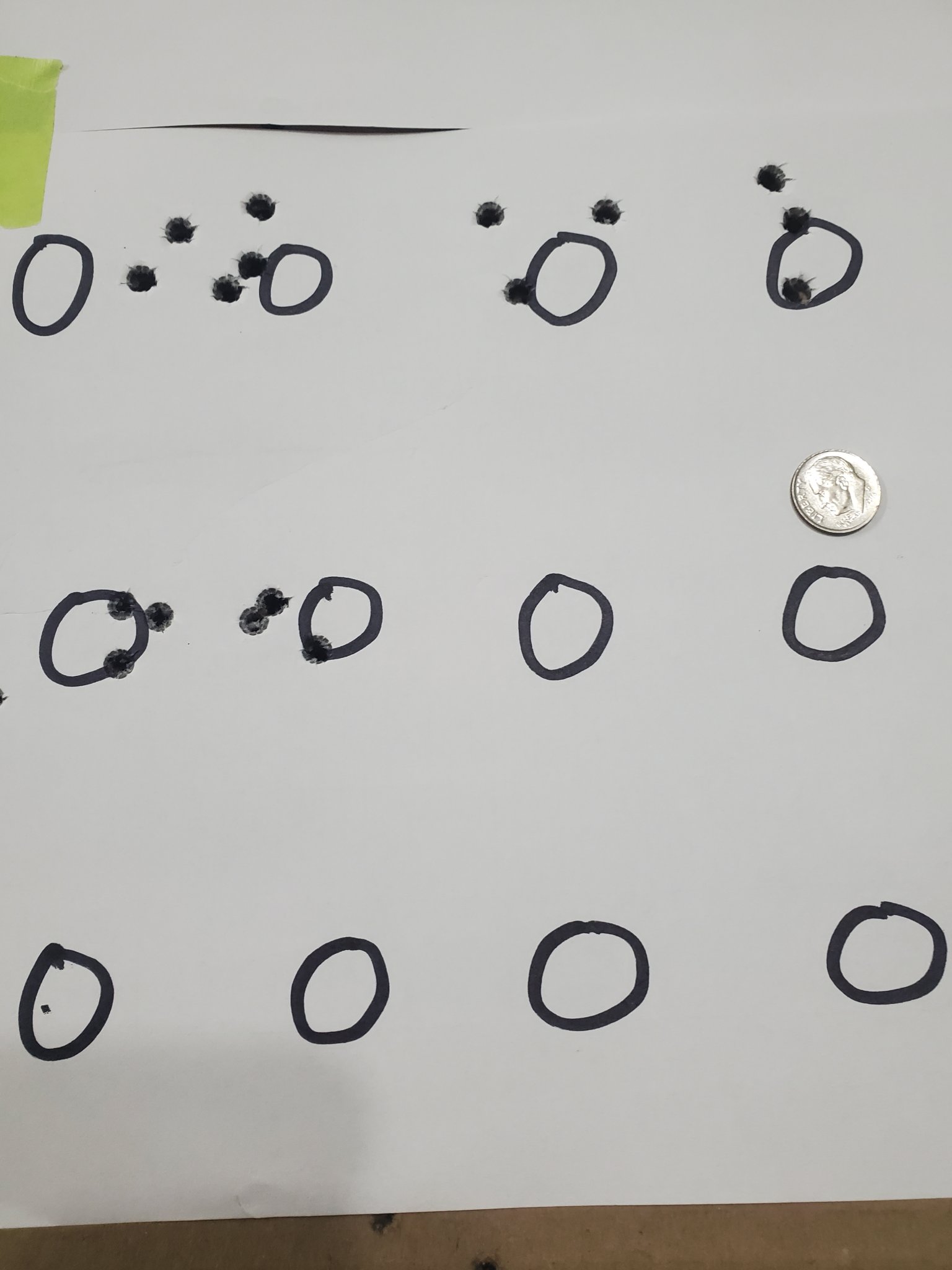

It's funny because I shot 80 rounds of 28.5 before I ran the test. And Started shooting 30.5 with a new zero which has been consistent for another 120 rounds.
More groups. Top is before I switched to a thermal fit receiver and glued the barrel into an upper reciver. Bottom is after. Tell me where you see the .2-.3 mil POI shift in group size. Circles are about 3/4" or the size of a dime. This is with a 2-10 scope without adjustable parallax.

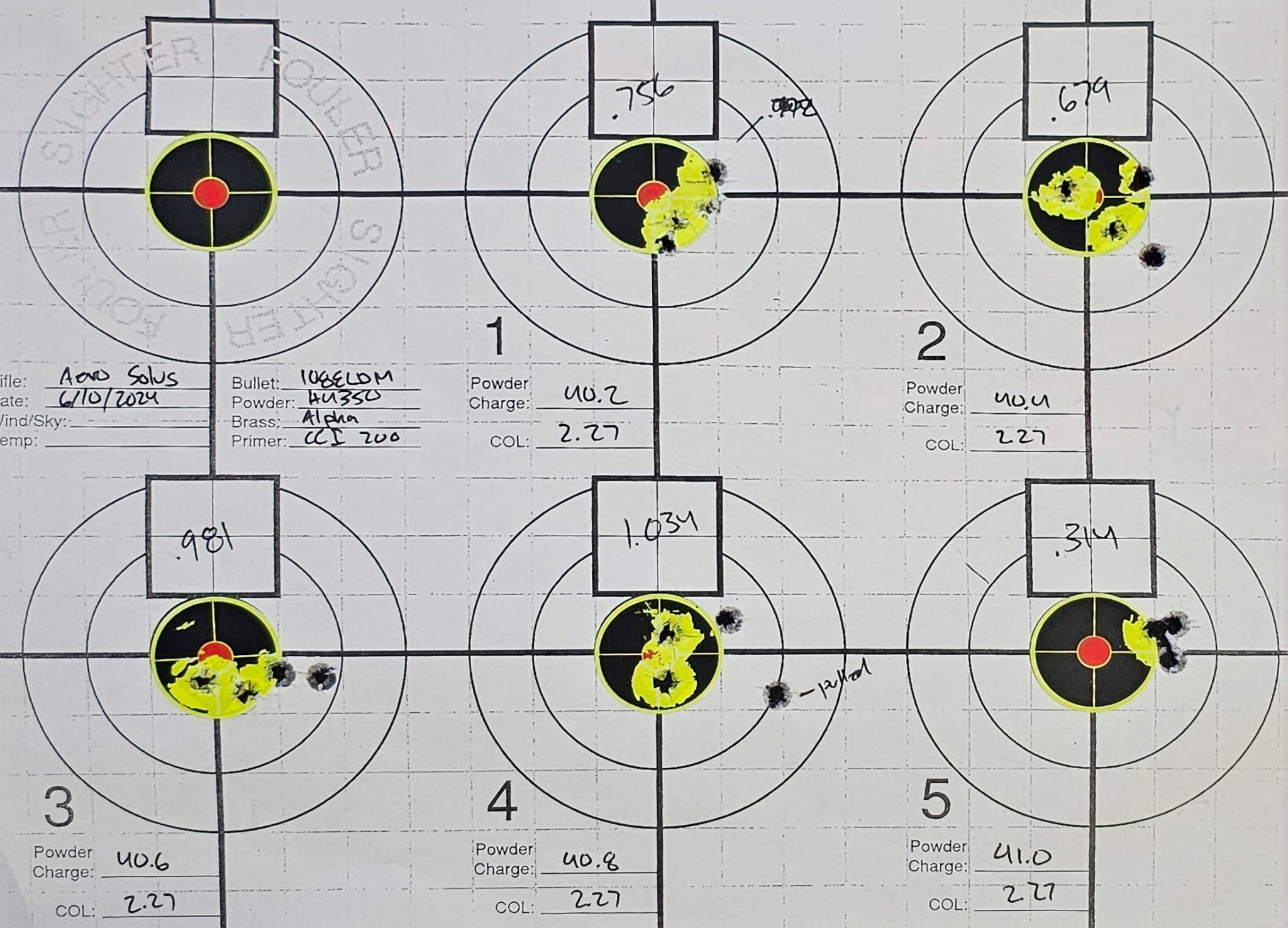

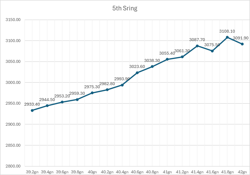

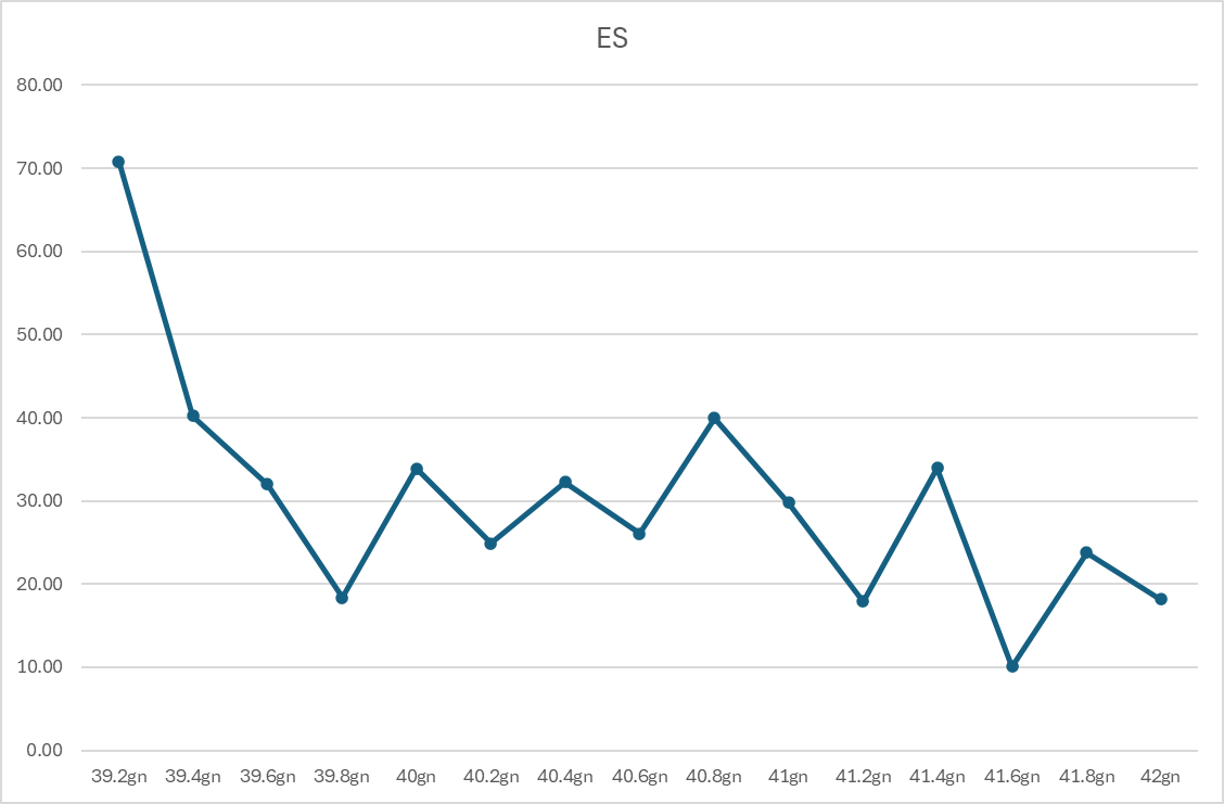

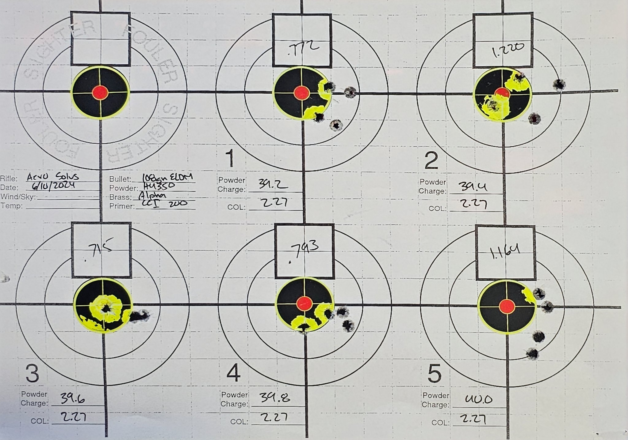

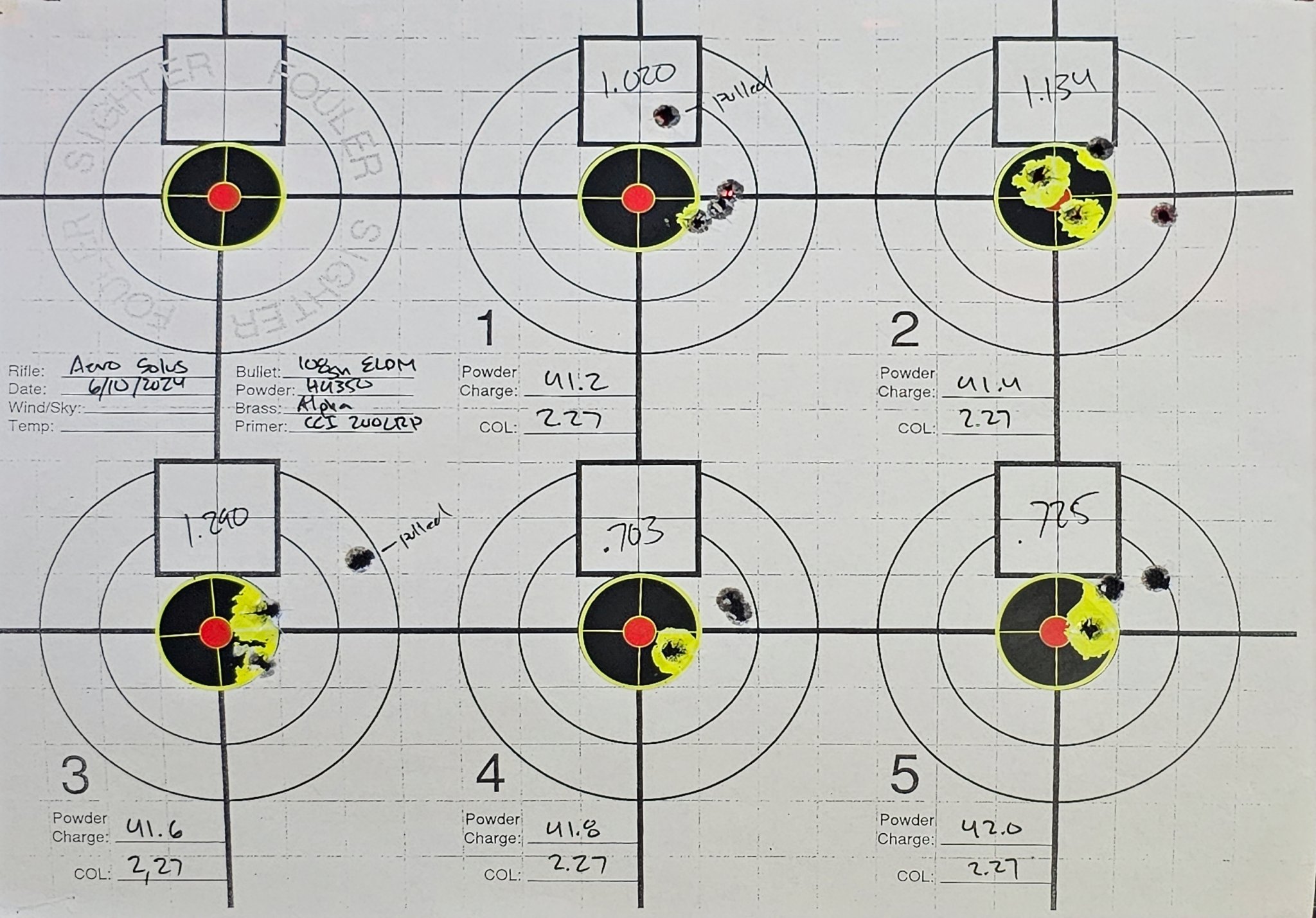

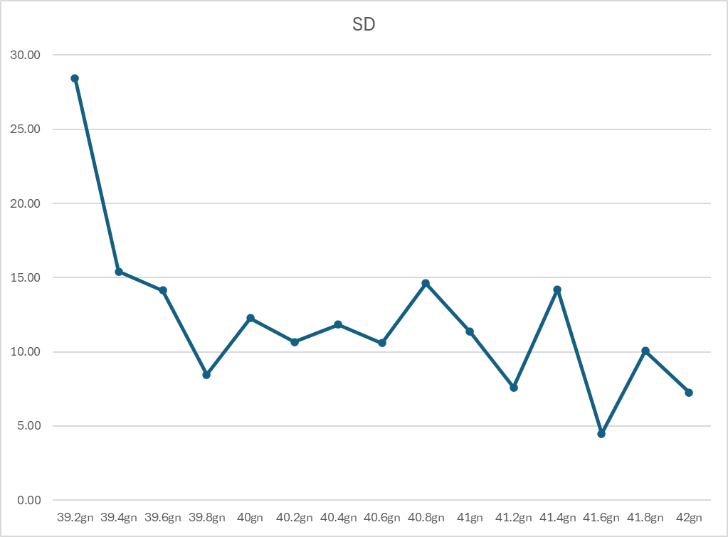

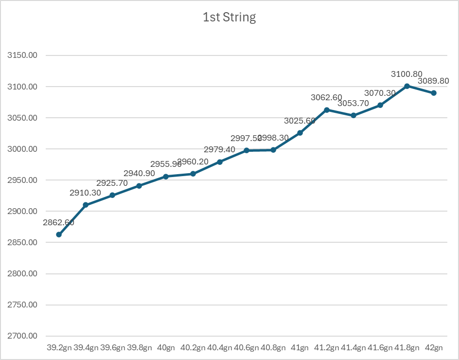

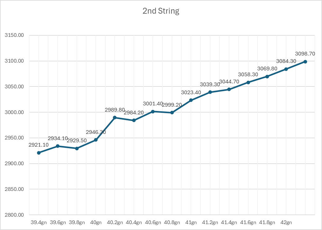

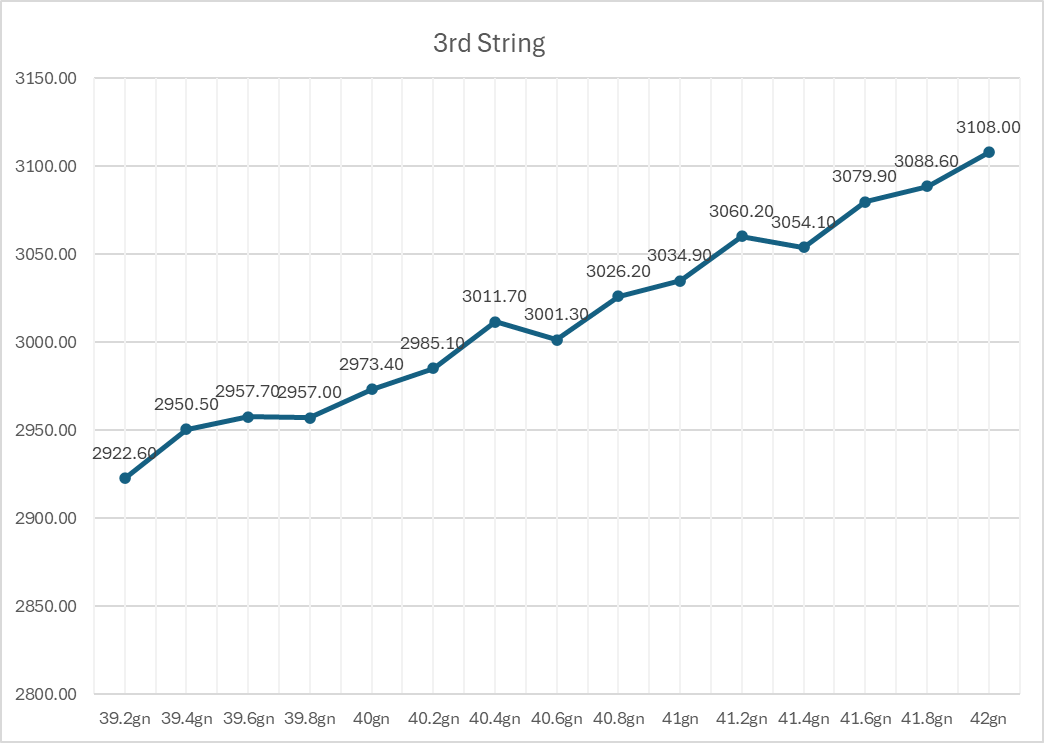

So at the end of the day i was over thinking this and felt like it was inpossible to do this so I just went ahead and did powder test and Ill do a seating test when I come back from leak
Jam=2.29"
Bullet seated depth = 2.27"
*Kind of need help with finding the node as I think their are multiple. Shots were shoting from 39.2gn to 42 and then 42 to 39.2 and giving it enought time to cool down.
39.4
39.6
40.2
40.4
40.6
40.8
All this shows you is that the very lowest charges may not behave, and that the very highest tended to show potential for decent velocity stats, but without the target data you could just pick any level in the top third of your run and it would just be guesswork without the targets.
Jam=2.29"
39.4
39.6
40.2
40.4
40.6
40.8

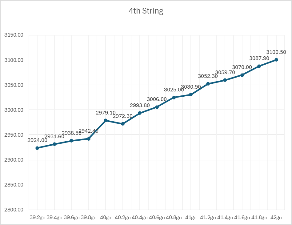

View attachment 8436067View attachment 8436068View attachment 8436069View attachment 8436070
I guess you were expecting to find accuracy "nodes" from velocity data??? As you can see with your 5 strings, there's no pattern that will do that. Combine the 5 strings onto on graph and you will see a simple linier trend with no real "flat spots" that some shooters suggest will identify an accuracy "node". As RegionRat says, without seeing what's on the targets, it's just guesswork.
Velocity SD's and ES's tends to do well at telling you how well you're loading your cartridges, which of course, helps with the precision you will see or not see on target. Though, like RegionRat, the SD graph does suggest to me those higher charges might be worth testing on target. Just keep in mind that the lowest SD's are not what always produce the best precision on target, though if you're shooting extreme long range, that can be a big deal.
If you were to shoot the 5 of each of those loads at a different dot along a horizontal line on a target where one can compare the groups to each other and interpret the changes in the groups, then you're most likely going to be able to identify the "node(s)".
ETA: Did you tell us what kind of shooting you want to do with this?
What are your goals?
For example, this is supposed to shoot less than XX MOA at YY Yards.
If you are happy just shooting with your chronograph, then we are happy too.
If you are not, tell us what would make you happy?

I'd load up 40.6 thru 41.2 and see how this compares to these target results as they seem pretty close to all being on the same plane and in a wide "node". IMHO

Okay, You are off to a decent start with decent hardware and fair components. You can learn a lot with this stuff as a starting point before you worry about upgrades. Nothing wrong with trying other bullets/powders, etc., but you can get rolling with what you have and learn plenty.
You will want to get the load performance down to below 0.5 MOA for 20 shot strings to be competitive in F-Class.
You won't need them that tight for some club level competitions in PRS, but you will not want surprises when weather shifts either.
I would shoot as many midrange club F-Class matches as you can while you also learn field position shooting as in PRS. F-Class club matches will give you practice at reading wind at a standard distance, and at learning load development in parallel with trying PRS club matches.
Keep working on your shooting skills while you also work on your loading technique, but pay more attention to concepts like the Audette Ladder and your targets than to your chronograph. Test your rig at 600 or more and see if there is any tendency for compensation (nodes), then test it again to see if it repeats on different days in different weather.
Try to get to a decent performance at 300 yards and to be consistent. When you are 95% or more at 300, then work on 600. The difference is how much of your horizontal score will be from wind. You will start to feel the wind at 300 and there is not much point to going too far unless you can master this distance.
If you can, join a club and get a mentor who shoots either F-Class or PRS. You will climb the learning curve faster by learning from them than you will on your own or from the internet.
Good Luck and in for the reports as you make progress.
Postpone making too many changes till you know you have a good idea of how the rig and recipe responds to charge weights crossed with weather and cleaning intervals, and your ability to reproduce the results with your loading and shooting skills.
Just getting to an understanding of the best charge weight, and how forgiving it is to fouling, weather, brass cycles, your own good/bad shooting days, etc., is a lot for a rookie.
Unless and until you know those issues are under control, you wouldn't be able to know if you are being fooled by seating depth changes and low sample testing. YMMV
Good Luck and in for the range reports on the charge weight targets.
Show me one of these 300 round ocw tests.
Three shot groups don’t tell us anything, especially not groups that large. I am not sure what you are trying to decipher from these photos.
What do you interpret them as telling you?
Exactly what I wrote in this thread they tell me.
What make 11 shots in 3rd groups diffrent than a 10 rd group?
It's only takes 2 shots for me to determine if that particular load is not the good one I'm looking for. :giggle: Like, any 2 shots over 1/2 MOA, there's no need to shoot more into that group; it's not going to get better. However, it takes quite a few more shots to determine the smallest group that's consistently the smallest.
