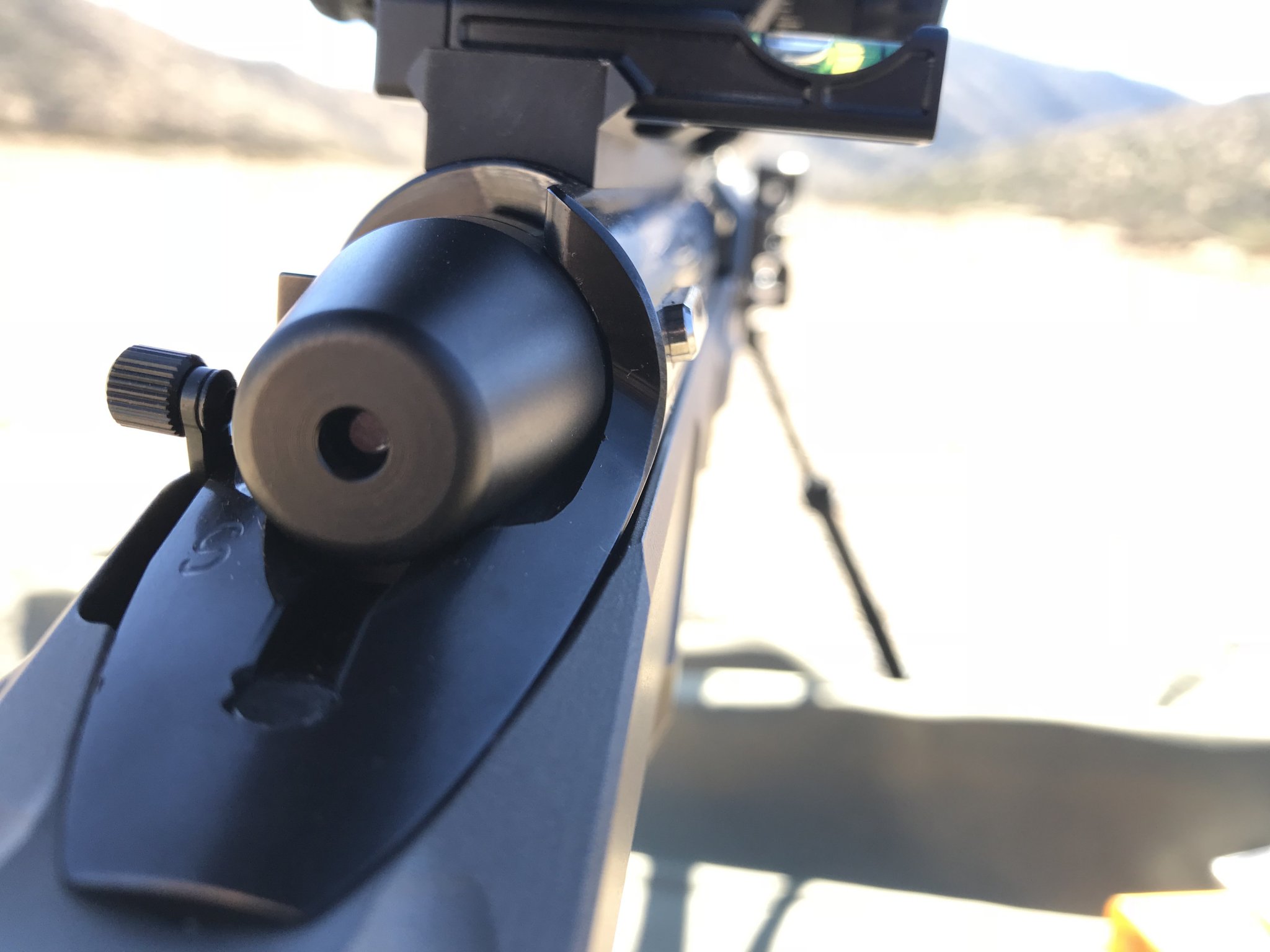

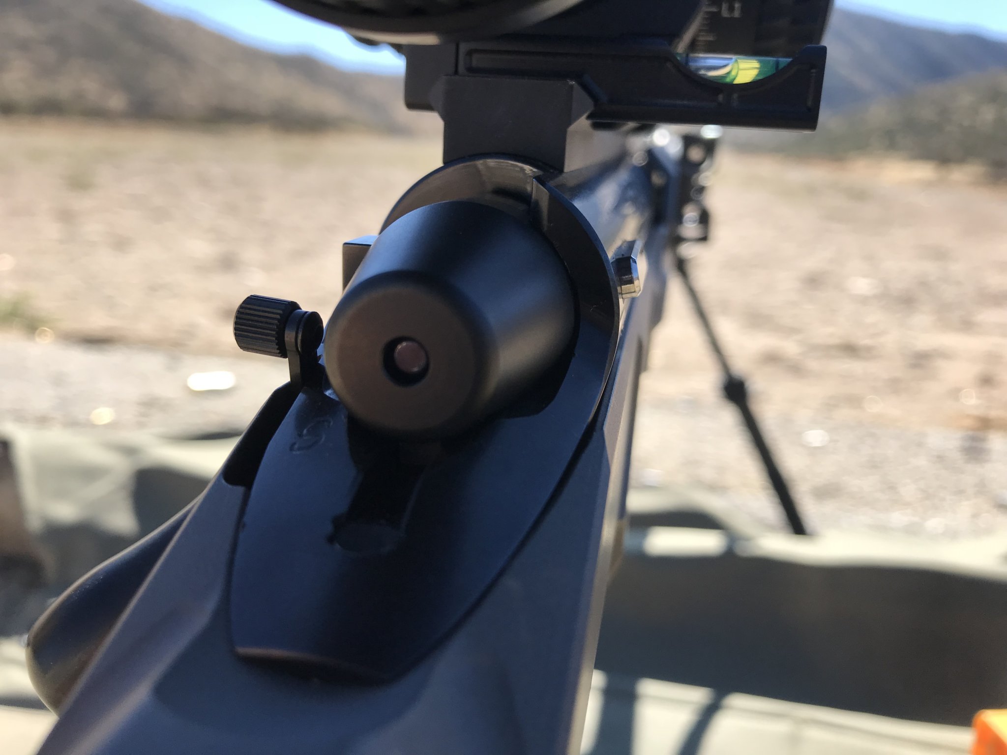

This is what mine looks like when closed
There is something really wrong with how your trigger is interacting with the cocking piece. The firing pin is falling almost completely when you close the bolt. Do you have a different trigger to replace that with? Have you made adjustments to the trigger sear position?
Reactions: kriller134
I don’t have any other trigger. The only adjustment on the triggertech special is for pull weight. I tried adjusting that a bit, but it didn’t change anything.
