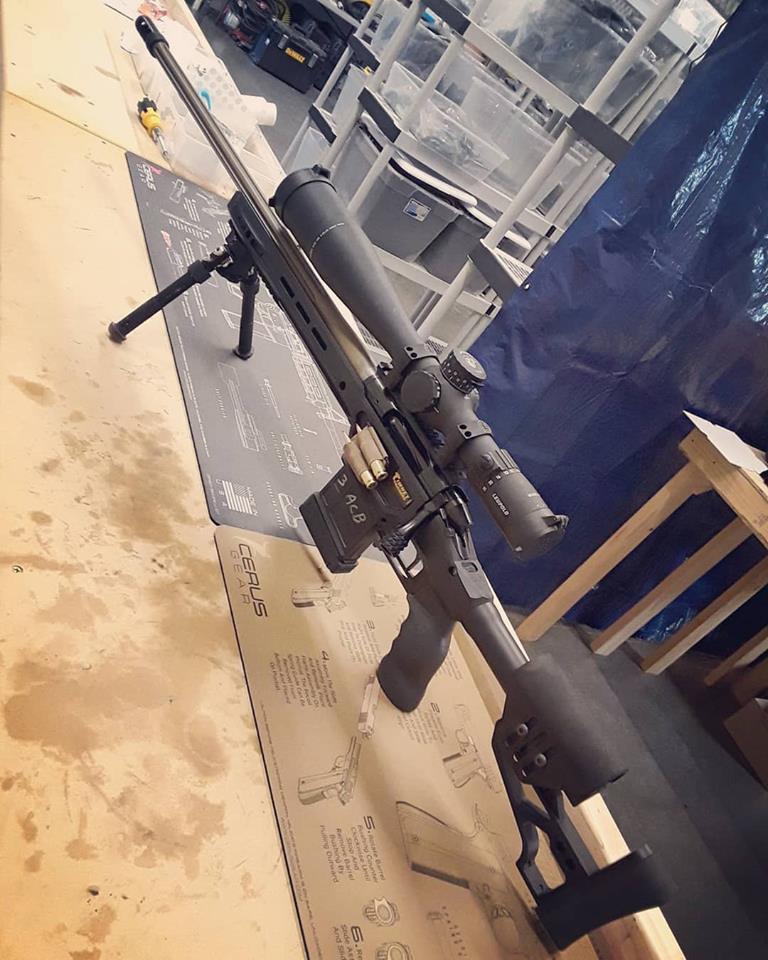

Figured I could add my build in here now since its complete.
Bighorn Arms Origin Action
6.5 Creed
26.5" Benchmark medium palma
Area 419 Hellfire Brake
XLR Industries Envy Chassis
Timney Calvin Elite flat shoe
Leupold Mark 5HD Tremor3
Leupold Mark 4 High Rings

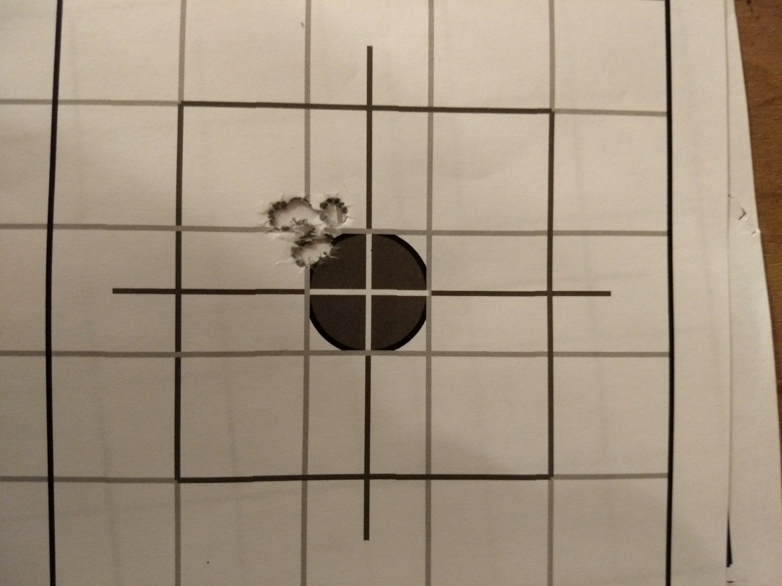

Range report:
Sorry! No photos. Took a few but my phone dumped them when it CRASHED.... Oh well. Time for a new phone anyway..,
Anyway, my son and i have Identical Origin;s with PVA 24" .223 Wylde barrels. His is in an XLR envy and mine is in the above KMW Sentinel stock.
He shot an easy 3/8" group at 100. He has about 200 rounds through his barrel. I fired 50 today for my first range trip.
Dope to 500 was 2.9 mils for me he needed 3.1. My MV was slightly higher than his after 10 rounds over the magneetospeed.
We shoot with TBAC Ultra-7, recoil is very very light.
He has been having a few light primer strikes. This is with Factory Black Hills 77gr OTM. Email to Big Horn to try to get it answered. No issues in mine. I took his light primer strike round and it fired fine in my gun...
Both have Timney 510.
Fun range day, got gun zeroed and solid dope to 500.

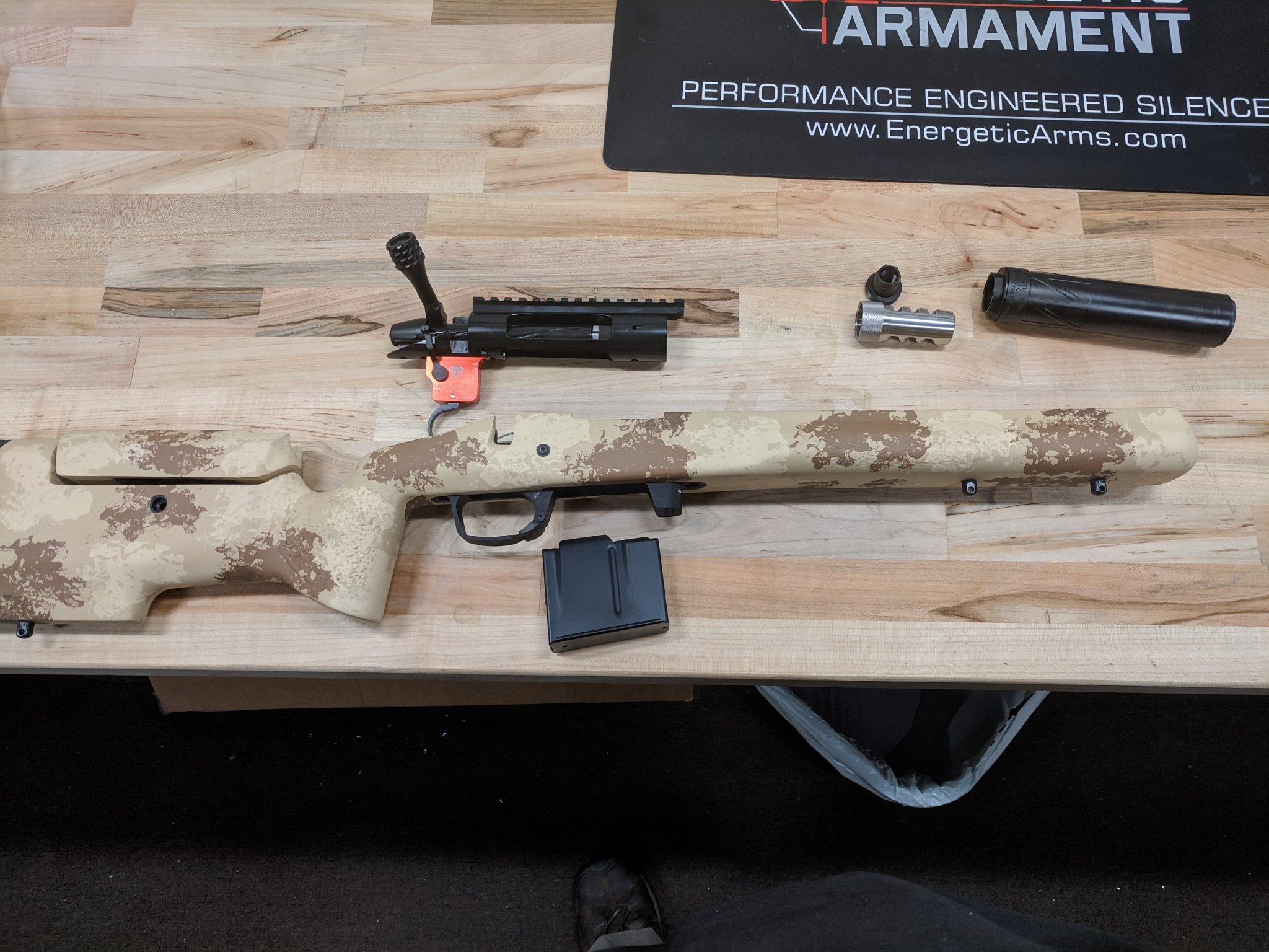

My Origin arrived yesterday. All the bits and pieces are starting to come together.
Waiting on my barrel from Keystone Accuracy, ordered a 24" heavy palma in 6mm creedmoor.
Also need to decide on an optic/mount. May go with a cronus BTR as I can get a fairly good price on one thru distribution.
I am getting a bit of cock-on-close with the TT Diamond, but will probably send out to get timed before next shooting season.
Fit and finish on the action are fantastic. Can't wait to shoot it!

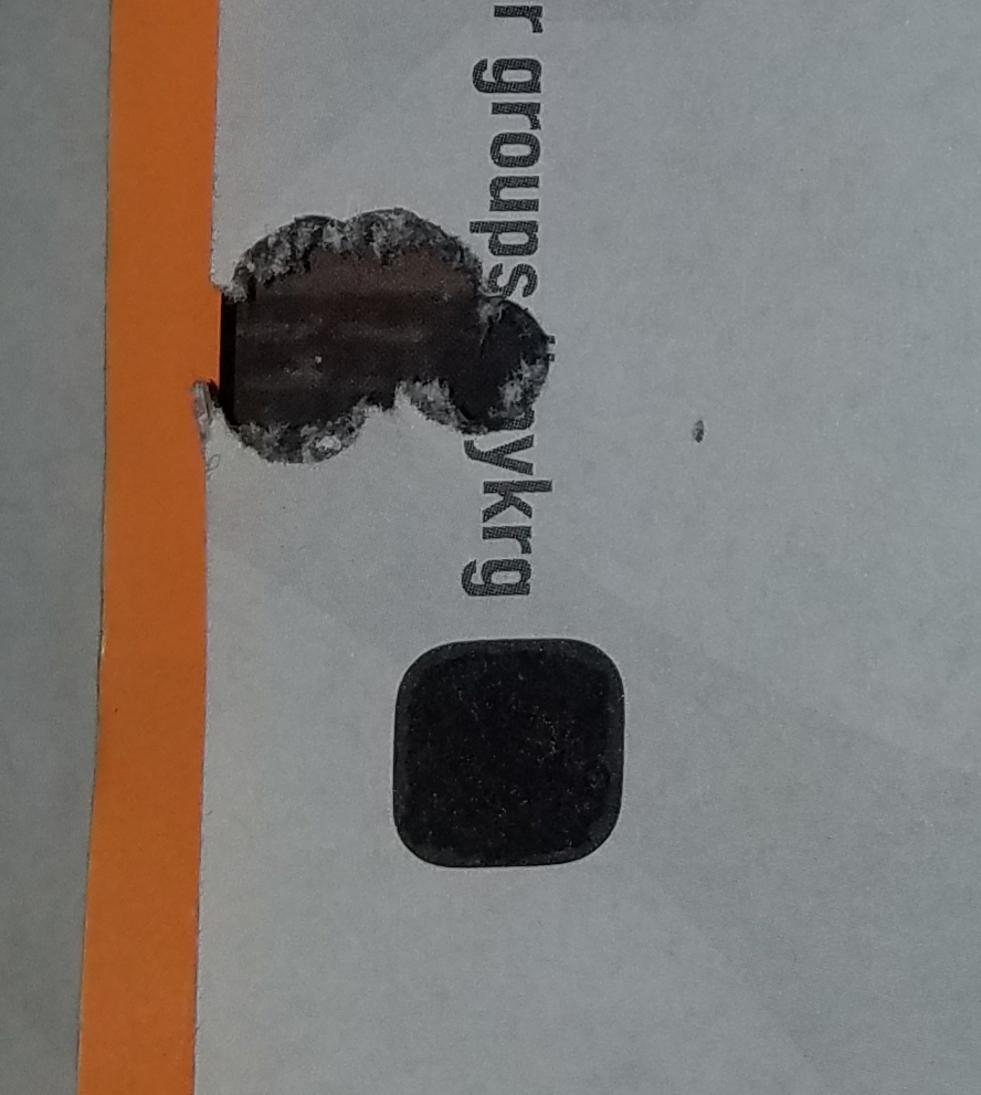

I told someone I would post pics of my final build completed last week. Here she is.
I've been running 140gr ELD-M's to fireform and break in the bbl, I plan to load with these going forward for my match loads.
I was getting just a tad over 2900 fps with them in my 25" bbl running 44.9 grains of H4350, but that was just my fire form load. Now that I have my first 100 pieces of brass fireformed for my 260 AI chamber, it's time to start the real load workup.
