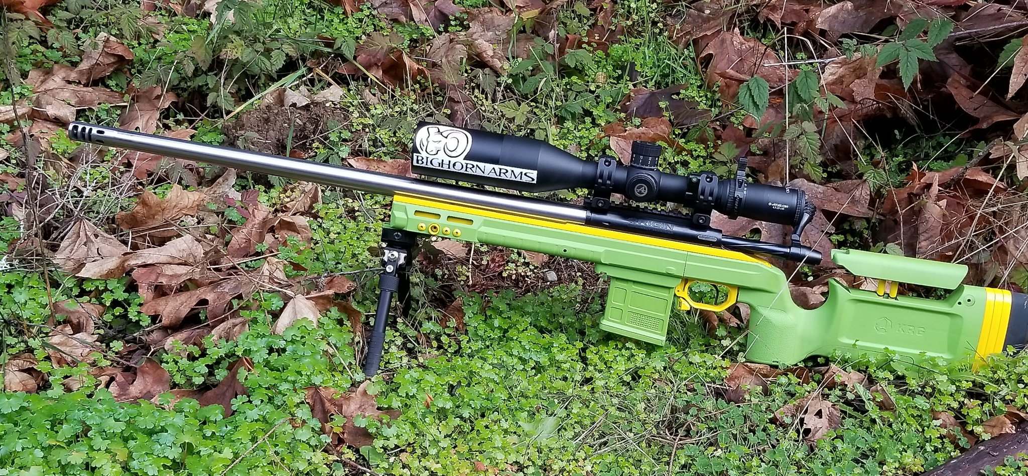

Enjoying my Origin got it out to the range yesterday. Athlon Cronus, Origin Action, 6br custom barrel, KRG Bravo chassis. Barrel and cerakote were done by Greysteel.
Reubenski has it right, it ain’t gonna change much other than feel... but damn is one finger open and close such a f’n pleasure to run.
BTW: looks like a sexy lil rifle u got there partner.

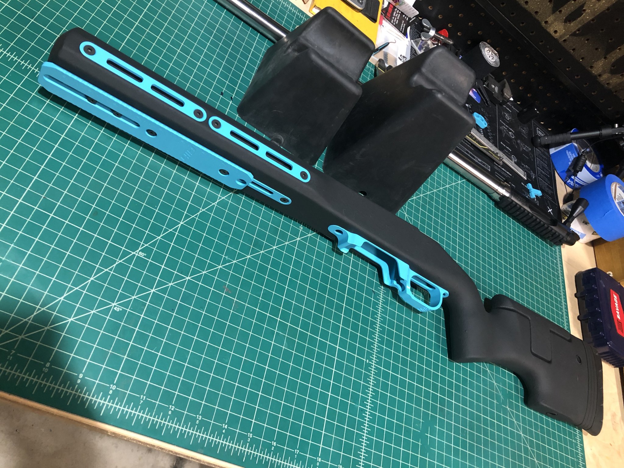

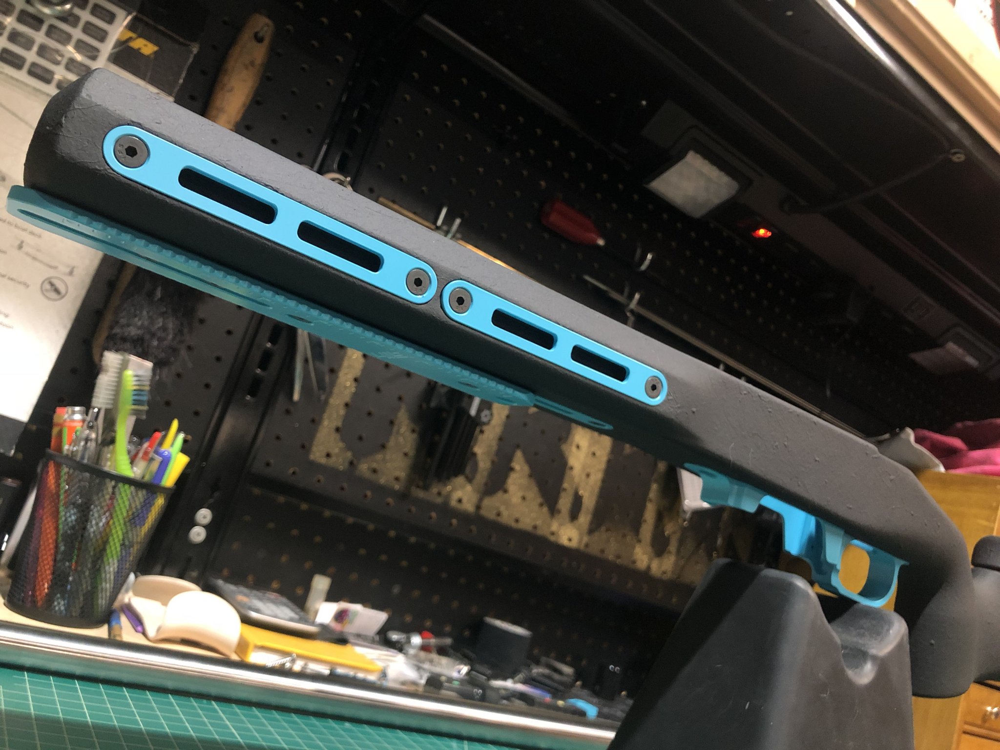

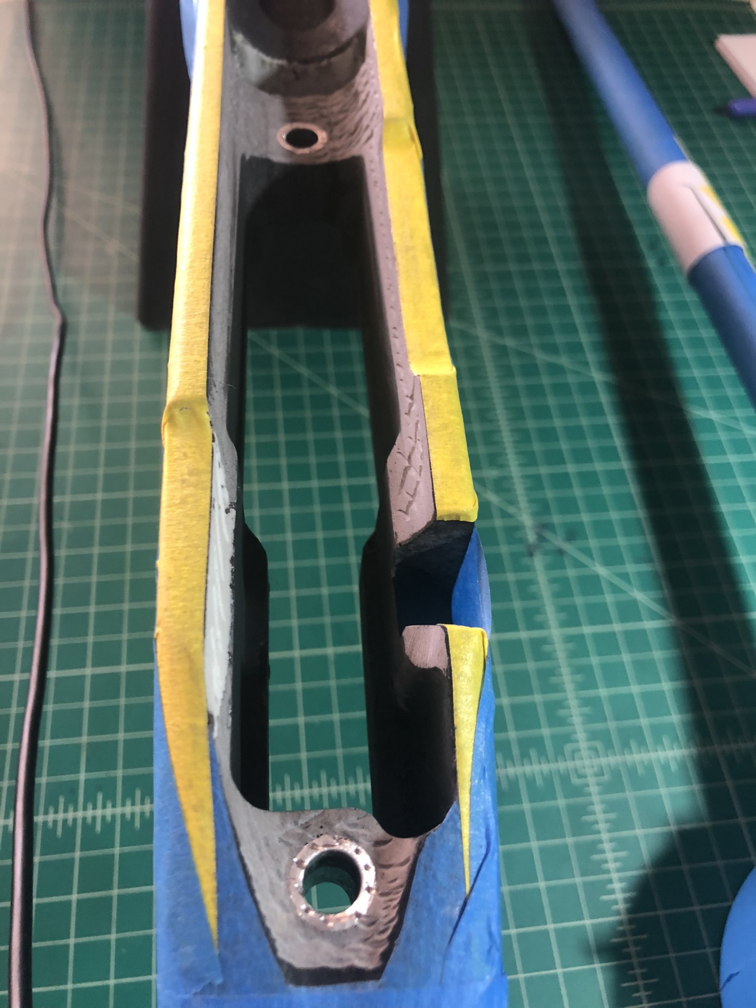

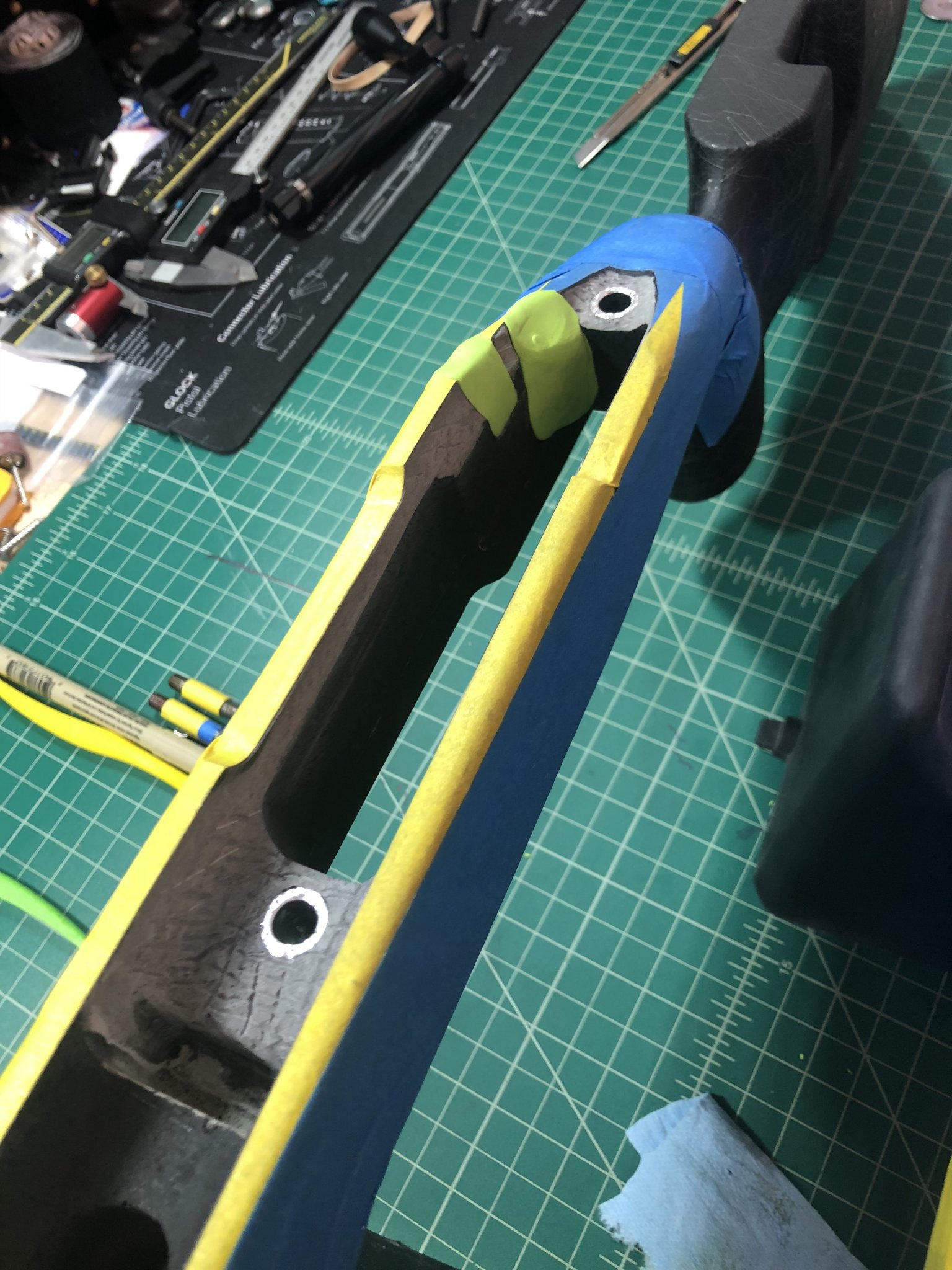

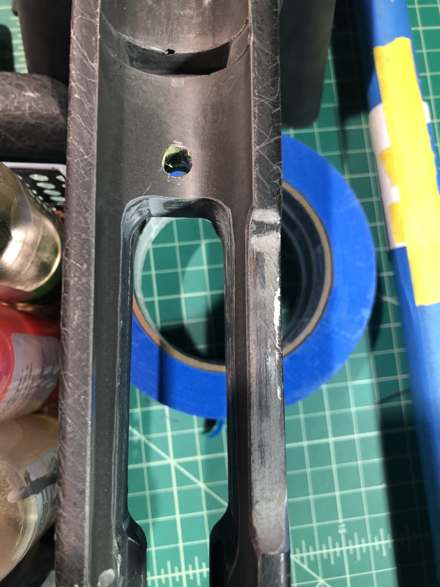

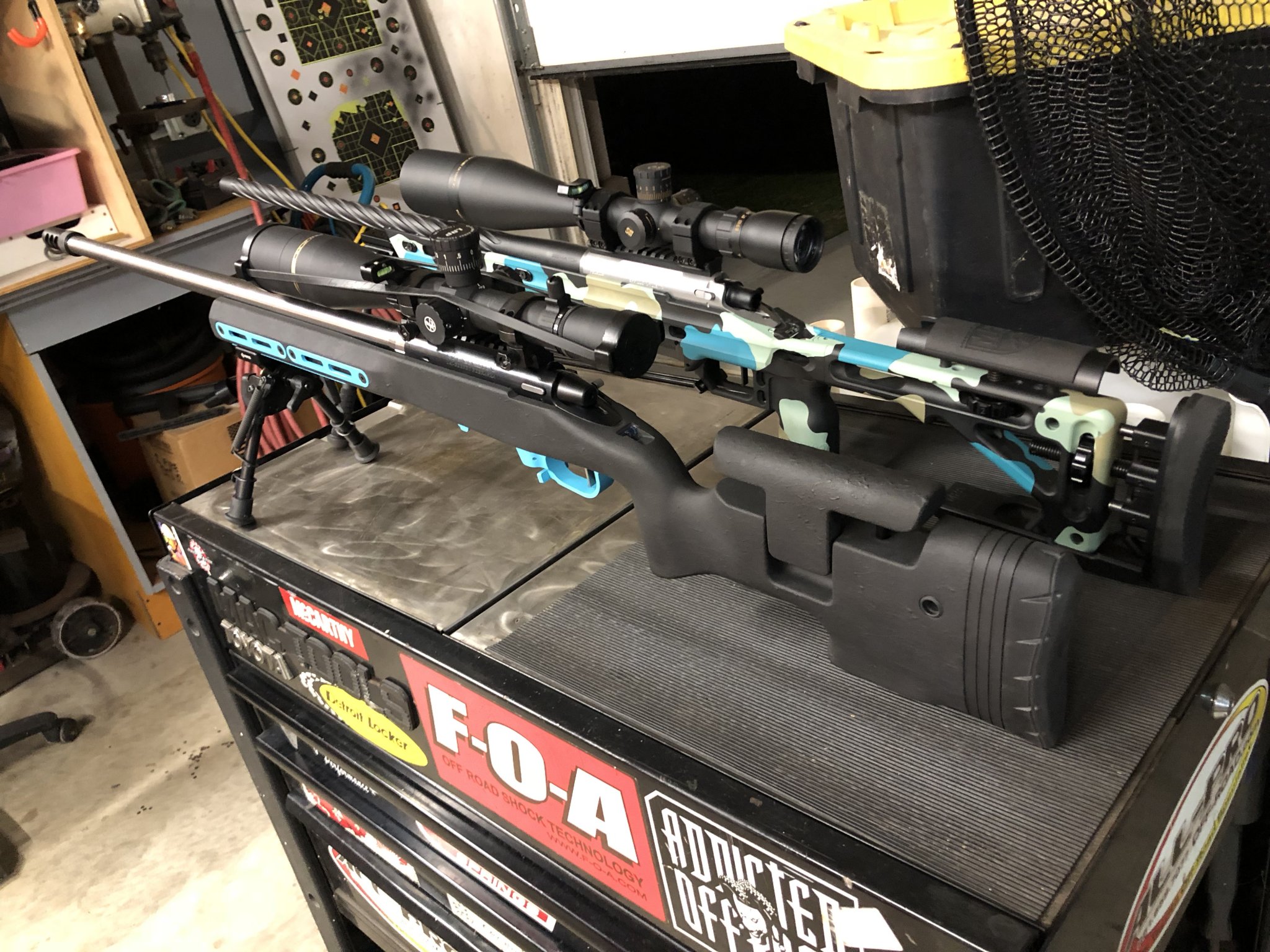

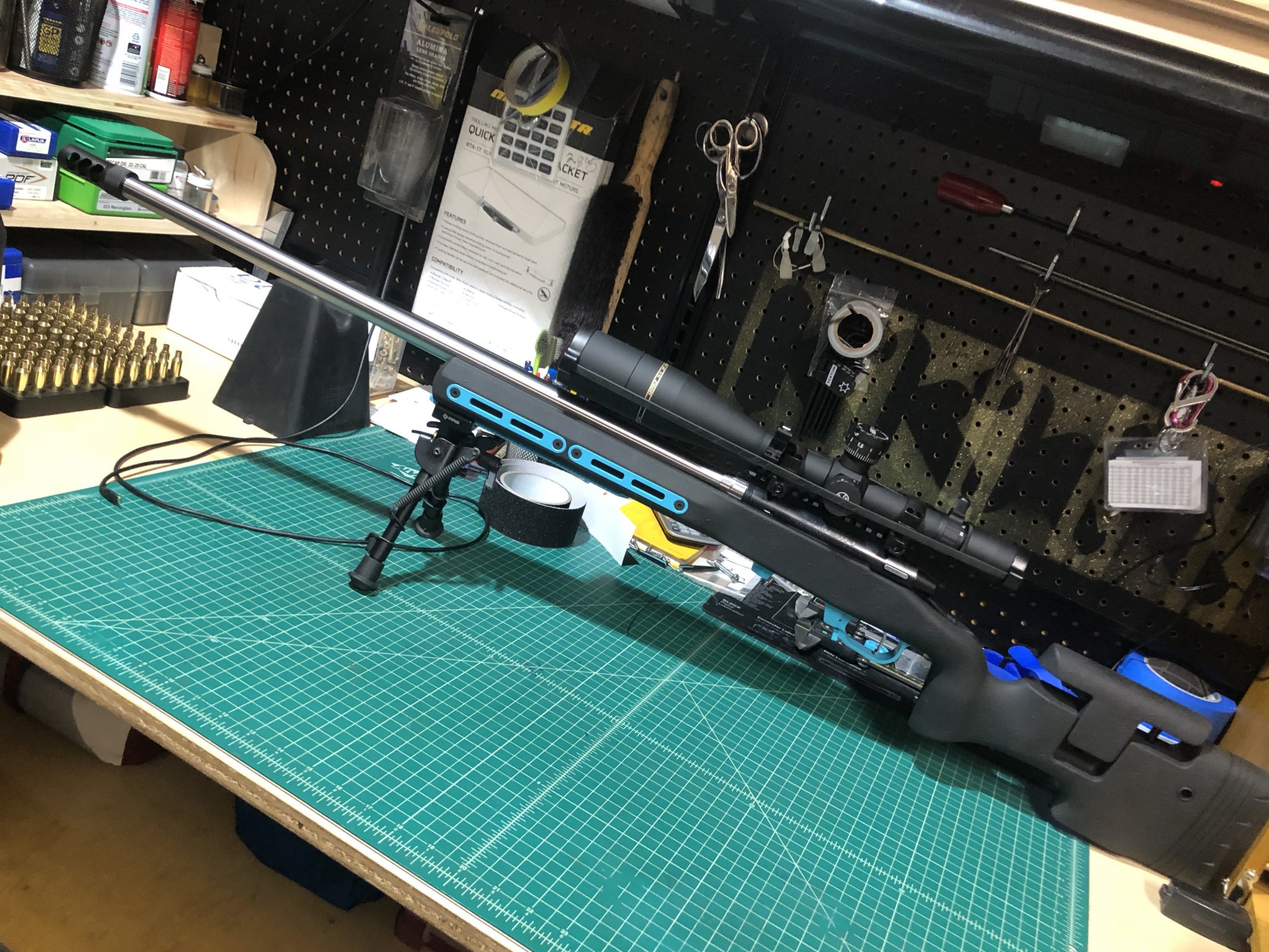

Here’s mine.View attachment 6981485View attachment 6981488
What inlet did you go with from Grayboe? I've been talking with their CS who says they'll have an Origin-specific inlet soon. Until then, I'm holding off on ordering a terrain.
700 off the shelf inlet. Relieved and Devcon bedded. Only needed to extend the ejection port reward a tad bit.

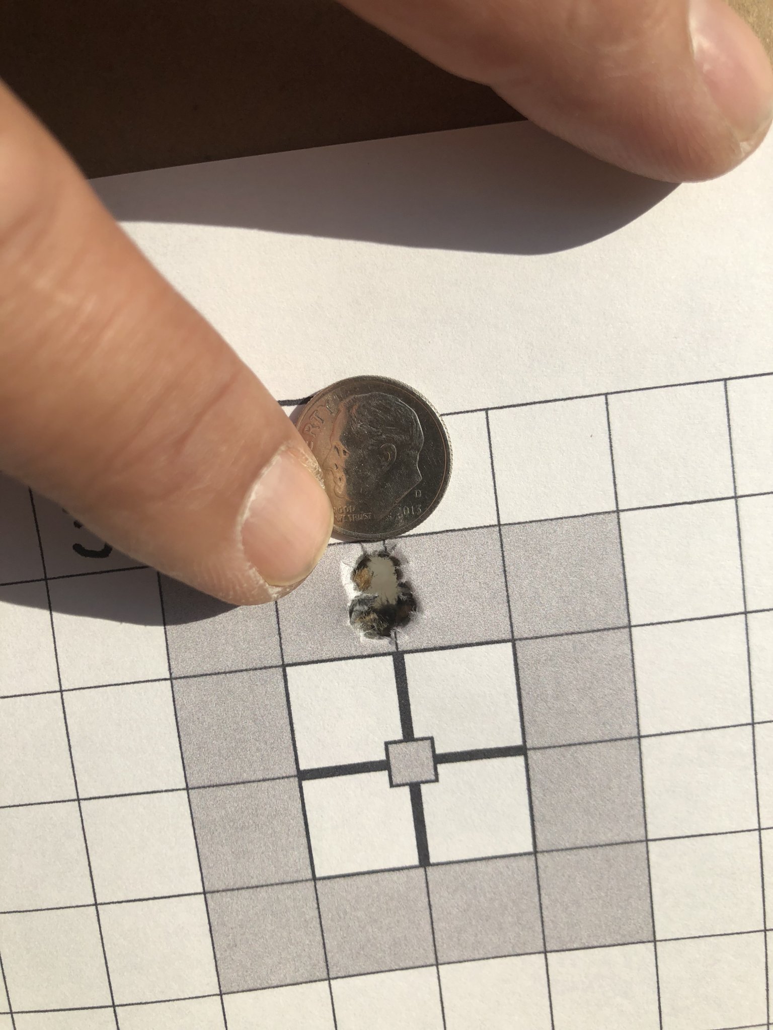

As of today, I have approximately 300 rounds through my Bighorn Origin/6br build. For reference I have two other Bighorn Actions: a TL-3 in 300 WM, and my son's lefty SR-3 in 6x45. All built by Aaron Roberts, all tack drivers.
The Bighorn Origin is a pleasure to shoot. They hit a homerun here. Aaron built my Origin/6br with a 22" Broughton 8 twist, a Timney 510, in an XLR Envy Chassis. The trigger functions as is should with no issues as noted above. The action is smooth, and "feels" much more expensive than what I paid for it. The 6br shoots 3/8's with 107 SMK's at 2810 behind 30.2 grains of varget, cci 450's, and a .020 jump. The gun shoots the same with 95 nosler ballistic tips at 2900, and my son took his first buck with it this weekend at 150 yards...devastating performance to say the least.
Likewise, my other TL-3 runs perfectly well with a trigger tech, and shoots consistently .5 with Factory hornady precision hunter 200 eld-x loads. My sons SR-3 runs just fine with a jewell, and holds consistent .5 moa with hastily loaded 95 smk's and 95 Nosler BT's .
I'll be ordering another Origin action if I decide to build a lightweight "mountain" gun. I am very impressed with what they've done.
Edited to add: If anyone is on the fence for 6BR due to magazine issues, do yourself a favor and buy the Primal Rights mag kits...they perform flawlessly. I was pleasantly surprised.
