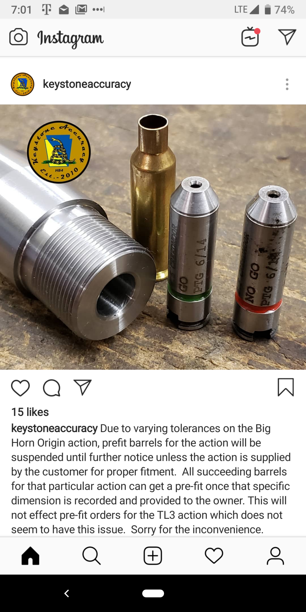

Just saw it as well. Shot John an email to see if my Origin that he did last year still has the specs for any future barrels or if I'll need to send the action back.Anyone else see this?
I know mine was a smidge short of closing on a go Gage. I wonder if other vendors are having issues too.
Definitely agreed. He spun up my first barrel in less than 2 weeks.I just sent my origin in to John. I have no problem sending the action in to ensure proper fitment. Then he will have my specs and can spin up another perfect fitting barrel.
