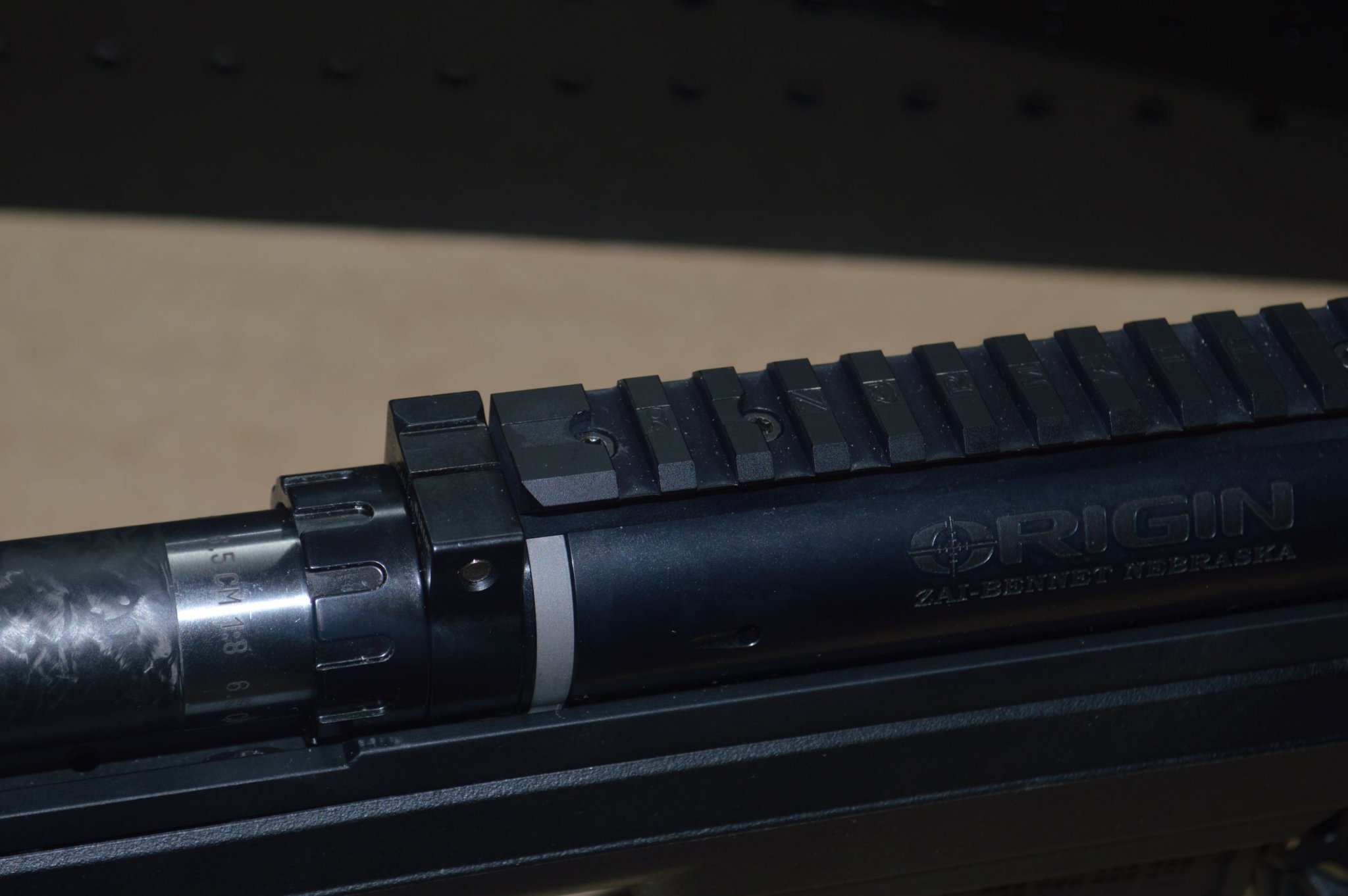

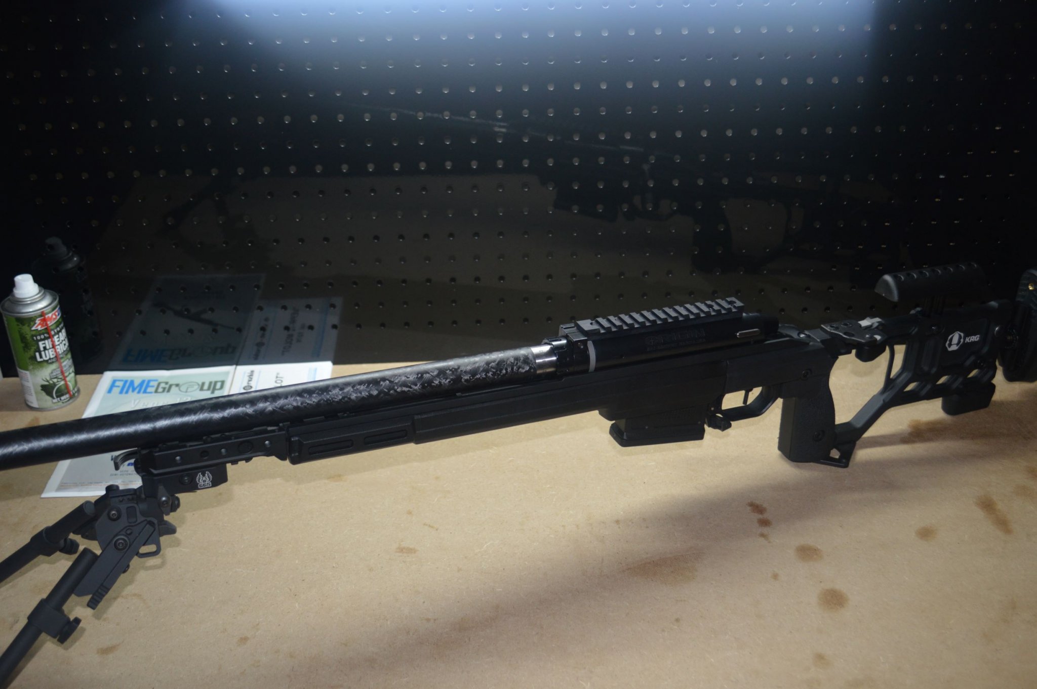

I don't think it is physicsly possible to use barloc nut version with origin recoil lug - there is only one picture in 19 pages - and its not in a stock or been shot

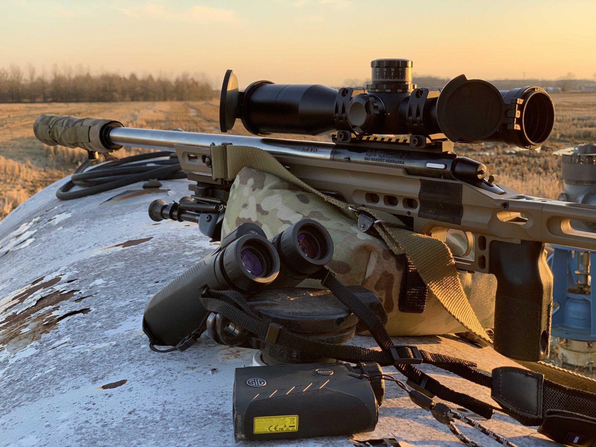

It is possible it's just that not all barrels are the same. That was my rifle. Updated picture in a XLR Envy chassis and I have shot it. No issues so far.

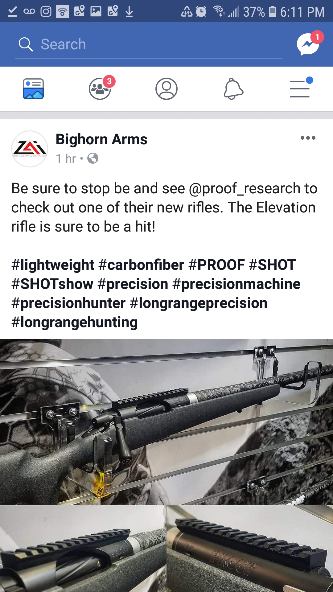

Proof Bighorn Prefits are listed on ExpertVoice. I ordered a blank on Black Friday and now see that they're doing prefits! Caliber list looks pretty extensive. The image posted appears to show SR3/TL3.
Proof's new rifle is exactly what I was trying to build. I have an Origin, Proof Sendero Light, and was going to throw it in an AG Composites Sportsman.
