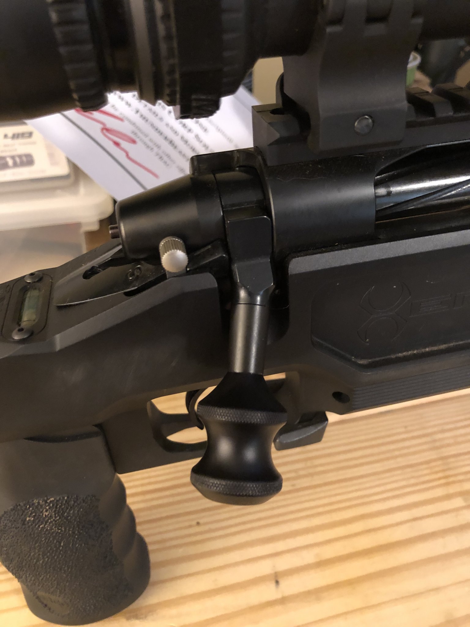

My Area419 knob and adaptor arrive today. Feels different working the action but I like it. I definitely have a more positive grip on it. Your thumbs always finds its way into the groove and that helps pushing the bolt forward.
Jeesus guy..... What does your chamber look like?
Chambers fine, I shot the rest of the match with out a hiccup. The issue seemed to be the piece of brass I attempted to chamber was swollen just above the web causing it to go in until it jammed the action solid. I might of also used a dead blow hammer to get it unstuck
Reactions: Codiekfx400
Got mine this morning and it definitely feels different but should be easy to adapt to
