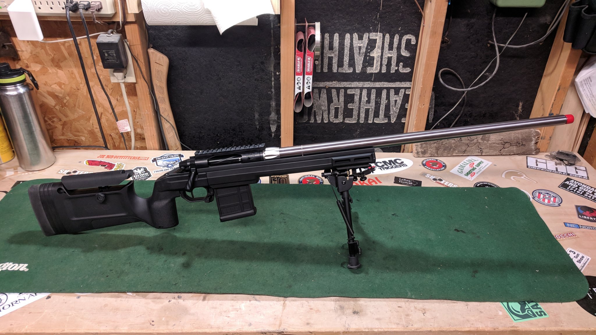

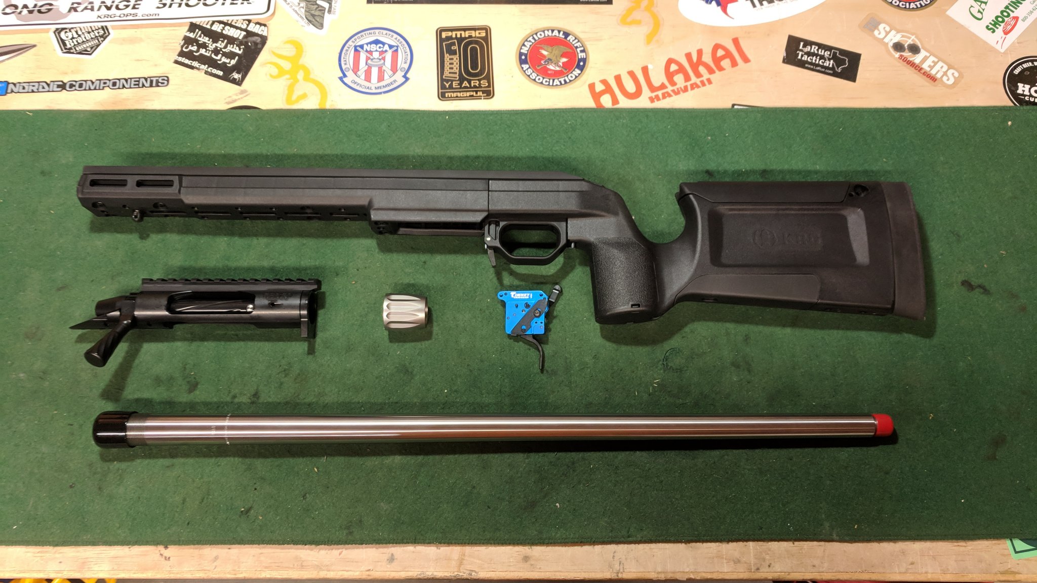

Just waiting on a scope mount and TBAC brake and I can finally shoot this. Awesome action!
