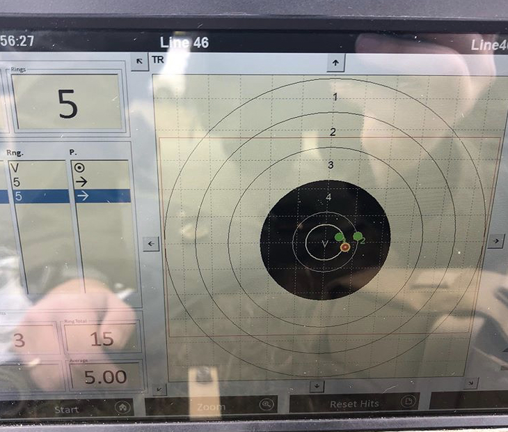

    This is my 1000 yard group with Hornady AG from a Tac A1 (24 inch)

    You definitely do not need to handload or build a custom rifle to reach 1000 yards consistently. American gunner is good stuff. When it was 70 cents a round shipped it was a no brainer. Now it seems like it is near $1 as everything gun related went sky high lately.
    That’s some damn fine shooting.
