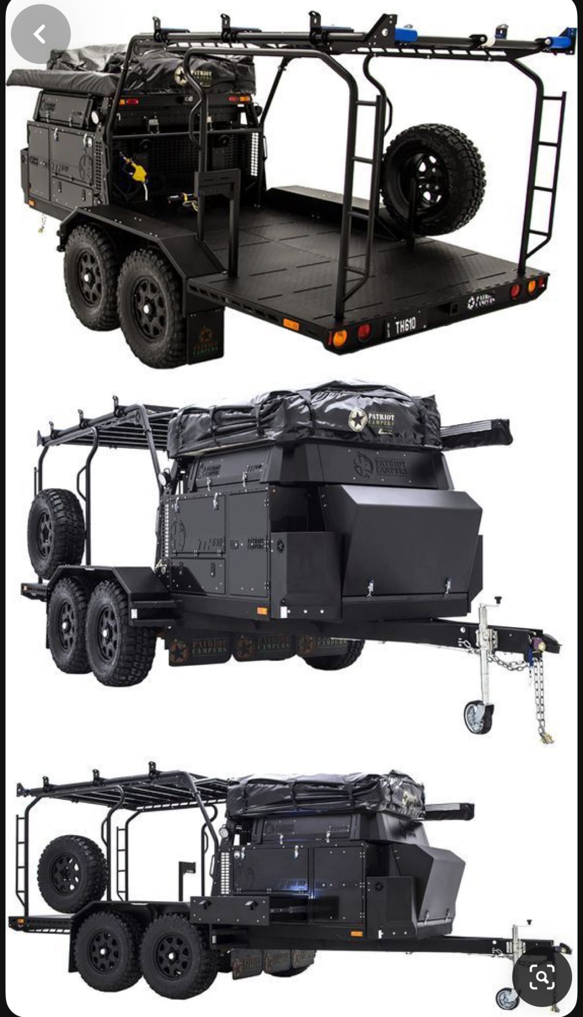

Preston
Can be outfitted like this
Not a gooseneck tho but maybe they can make it one.

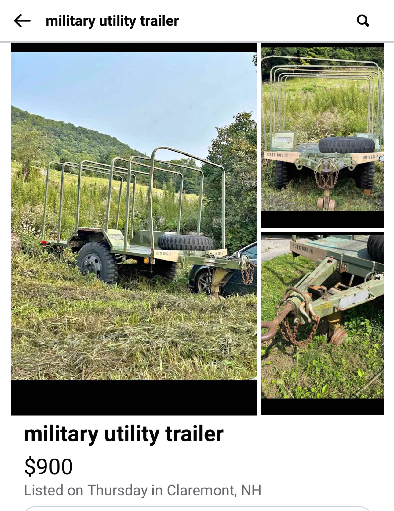

If you can buy a surplus Hmmwv trailer… it’s a great start!

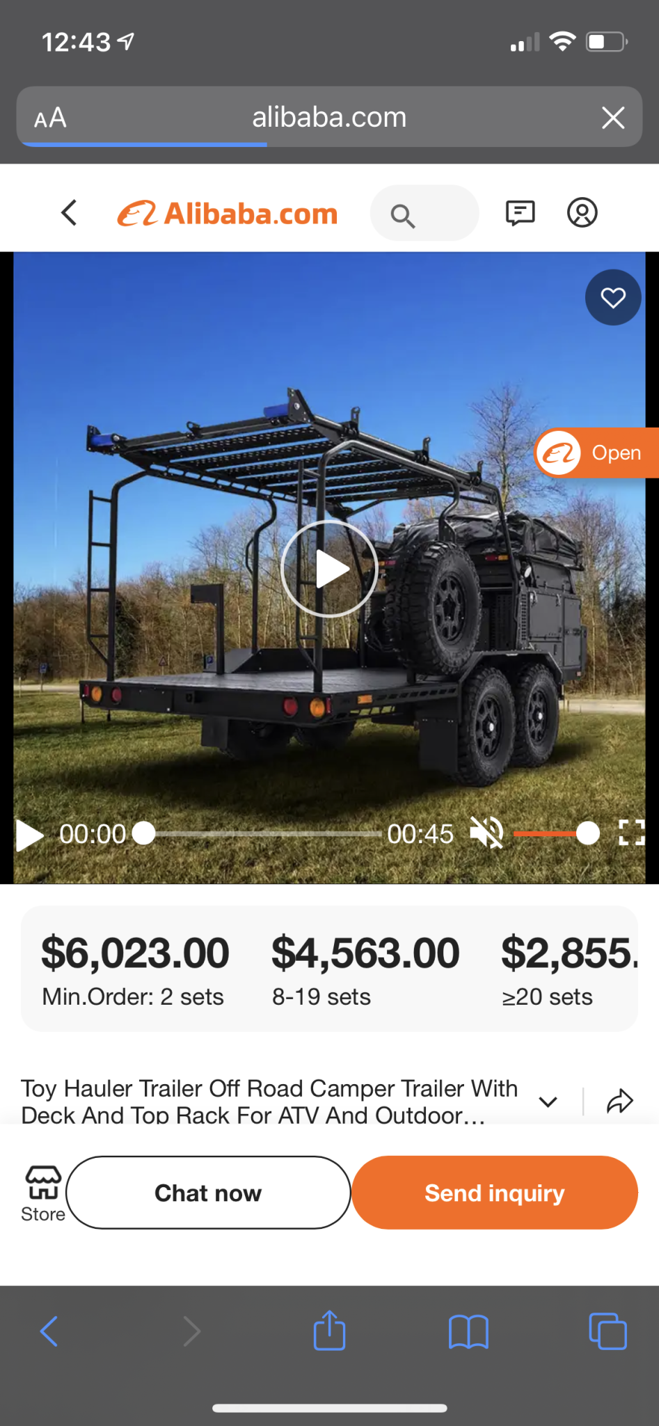

Looks like the chynese got ya covered
You gotta love their audacity. I mean literally using the patriot campers website too.
