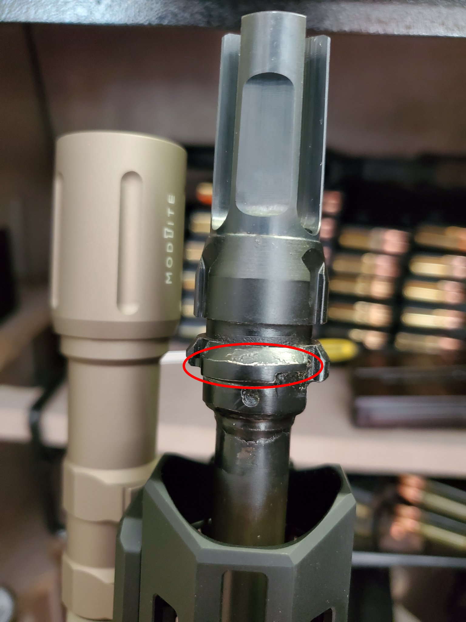

Pin and Weld Question
Ugh I know I would get this reaction. I already feel like dog shit. I tried to do everything right, and fucked up. I just hope it doesn't impact suppresor lock or anything else.
Is this a one man shop? Maybe the Smith doesn't know the job was done so poorly. If he has a junior Smith working under him, maybe he thought it's such a simple process, he could give the job to the other guy.
You have to stand up and let this shop know that people won't stand for this type of work.
Exactly. This is what I was expecting, a simple weld over the pin hole. I was shocked when inspected. Like I don't know how this was miscommunicated.
It looks flame welded. I would be a little concerned about how hot they got the actual barrel to weld all that.
I braze and solder pipe for a living. metal needs to get extremely hot to flame weld.
Jesus, that's fucked. You should be pissed the hell off with that kind of abortion.
As above, the amount of heat input it took to do this and any warpage it might've caused to your bore.
Throw that shit back at bubba and demand a full refund of his "work" plus purchase cost of your butchered components, fucking hatchet job.
And what the fuck is up with that strange non-shoulder? Almost looks like he started a parting cut, then said fuck it and turned a radius instead. Either way, it's ugly as sin and a totally unacceptable job.
Definitely looks brazed or silver soldered around the base. He got it so hot it blistered the finish which is what makes it look like crap.

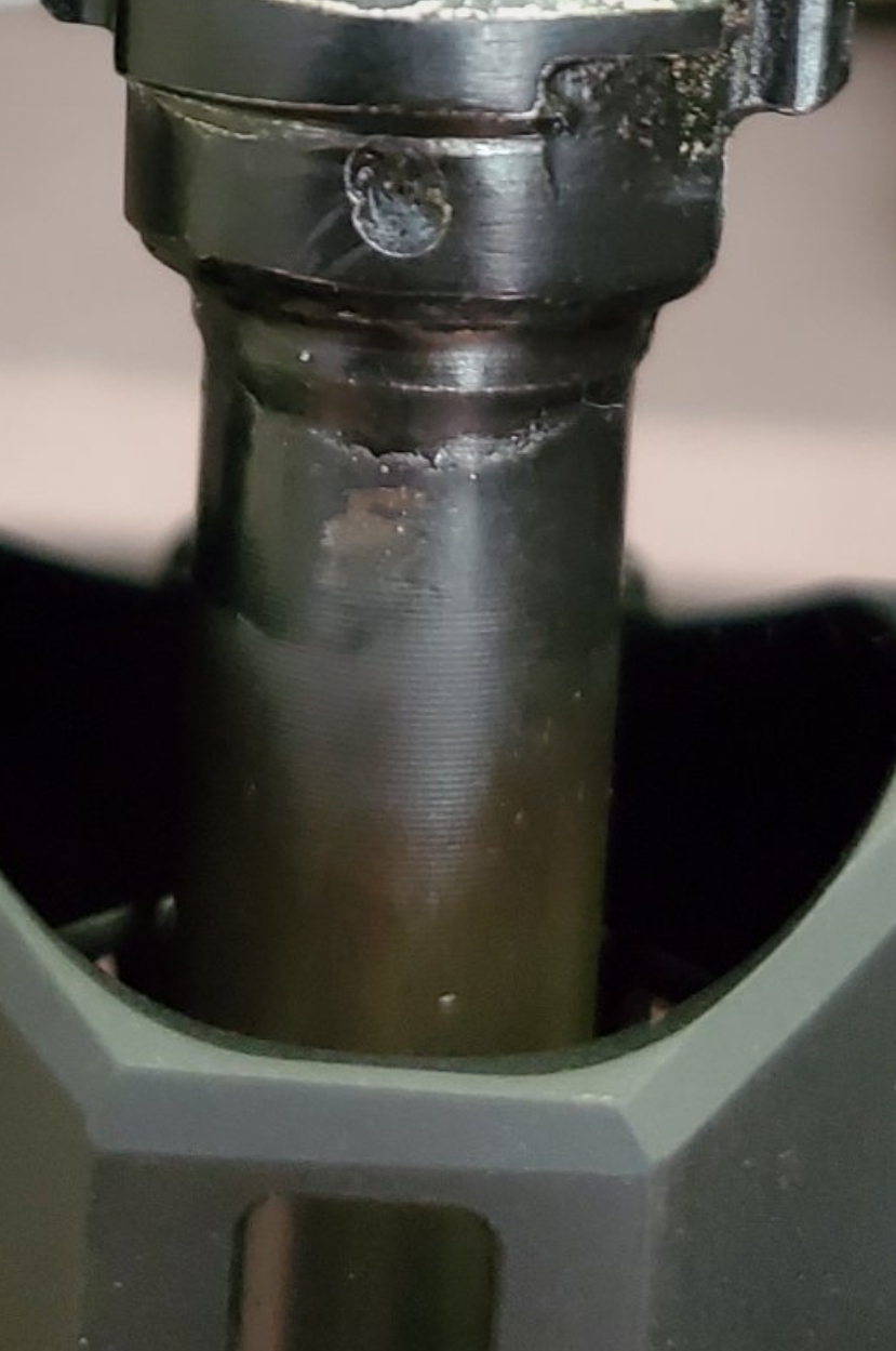

Hello, professional welder here. I’d be a Little concerned with how hot that barrel/muzzle device got. Looks like it was brazed to me. Tig welding would have melted away the threads where you are seeing filler metal. Meaning this dufus probably took an oxy acy torch to the end of your barrel/muzzle device and got the thing red hot. Any temper that was in any of those parts Was definitely affected. Temps were definitely high enough to burn off the coatings that were on the barrel/MD. A quick tig weld would have had a very small Heat affected zone.
Or did they try to cover it with paint and bondo??
Never seen an AR barrel without a shoulder behind the threads.
My concern is the discoloration on the barrel itself.
Looks like an annealed piece of brass and totally burnt off the Manganese Phosphate Barrel Finish.

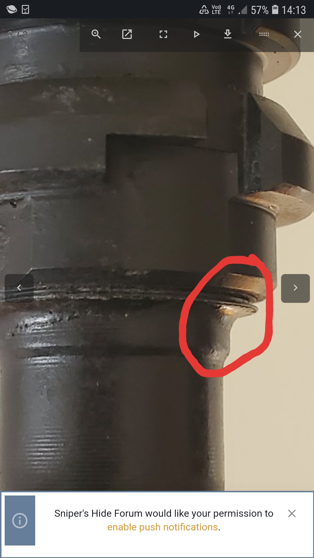

I figured I was spying some hi temp bbq grill spray paint.
Reactions: 2aBaC̶a̶
I have no idea... I tried to do everything right .. get referrals, get a professional to do it, etc... I still don't understand what happened, but I don't want to ask unless there's something that is functionally going to hurt the performance or reliability. I've learned my lesson but it's not something that matters to me, bc it's not noticeable on the full rifle.
There is no way to until you have a can on it and use a no go / alignment tool on it. The way the shop tried to weld a ring around bottom can put stress on the threads.
post the shop so no one else try’s to use them.
it also looks like he burnt through the shims, I’m surprised there isn't any spatter
If I get it checked for Go-No Go and for the suppressor to fit, which is doubtful, and for the unlikely chance the bore is not deformed, is it potentially usable or am I still F-d?

This is what I worry about. Looks like the chicken shit on the taper and he tried to clean it up with a file. Make him pay for a barrel and adapter. Get a 16" barrel. An inch and a half OAL isn't worth the hassle created by a P&W job even if done correctly.
