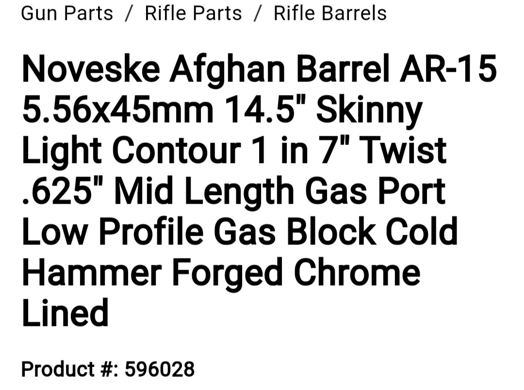

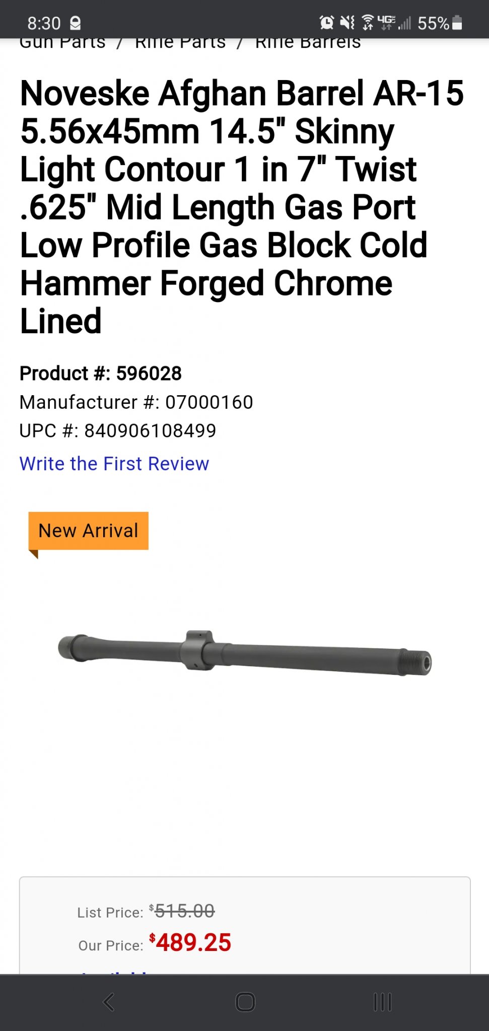

Thoughts on this barrel? Stock is low everwhere...
Hammer forged rifle barrels were developed for two reasons... To make them faster and cheaper to produce. All the other perceived reasons are just smoke being blown up you ass.
Reactions: TimC in KY
I would not pay 500 for that barrel.

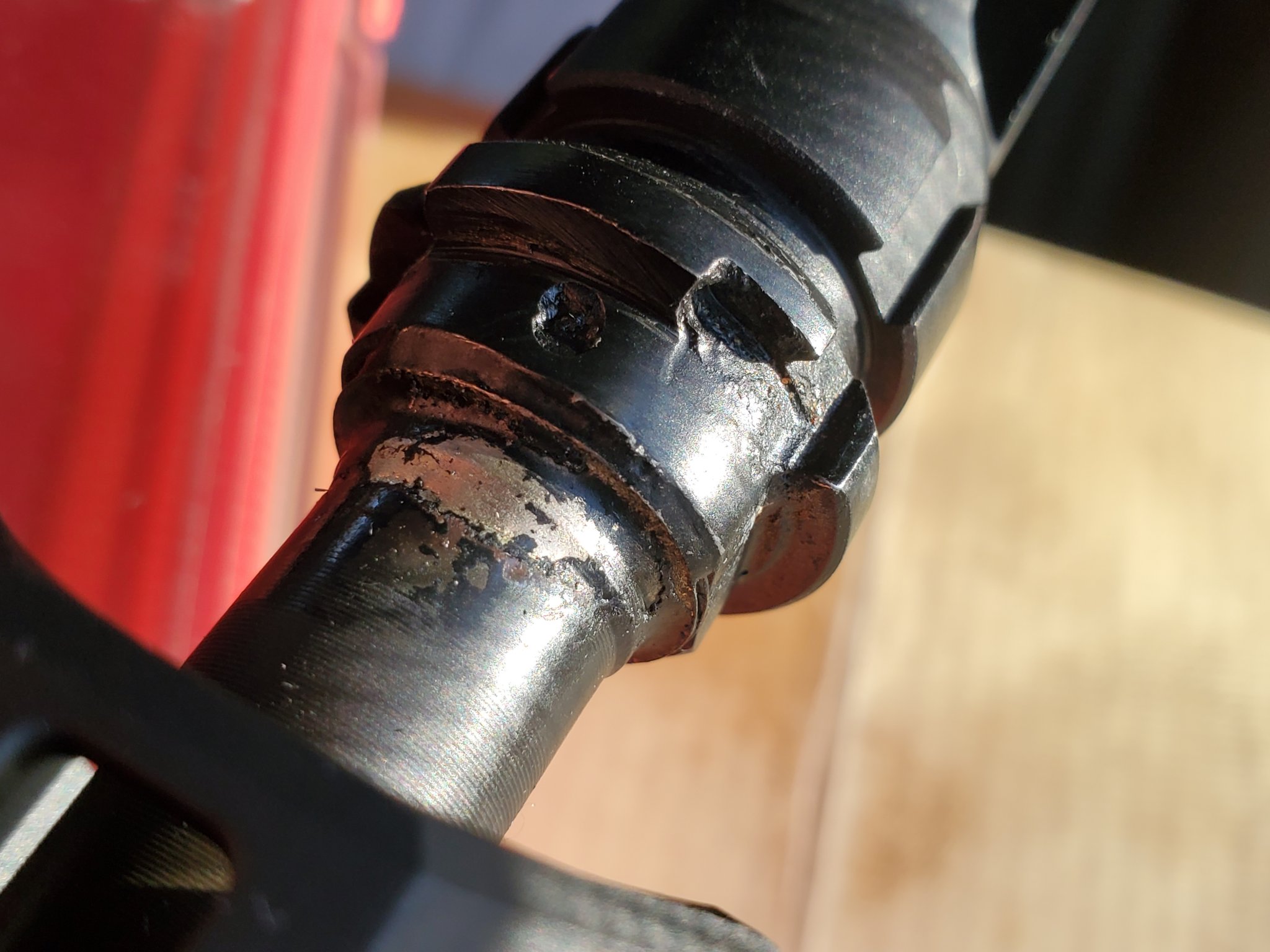

So I had to reschedule, got stuck in the office later than I thought, and it's a decent haul 20 mins past my house. I am going to shoot for tomorrow, or at worst, Wednesday after work. I did have several good exchanges back and forth, very nice and accommodating to fixing this... Going to target at a minimum getting comped $324 for the barrel (BCM price for same barrel) and $100 for the deadair Hider... Not sure if he will want to take the barrel or not, and I'm not sure what to do about that part or should I expect compensation and I keep it? That part is stressing me out a little, because I'm just not sure how this works.. I'd honestly be happy with enough to source my own quality barrel and parts and be able to get someone else to do it, even if I eat $100 or something..
I used my finger to scrape off the paint or whatever was applied, so it's clearly F'd up... Plus I'm going to say, I can't use my suppressor safely with this, which was the intent from the beginning. I wish I knew more about this stuff to use more facts, but you all have helped much. Here's the picture after using finger to remove paint. Makes me sick.. but maybe I can make it better than it was, because I know BCMs barrels are not the best for what they cost.

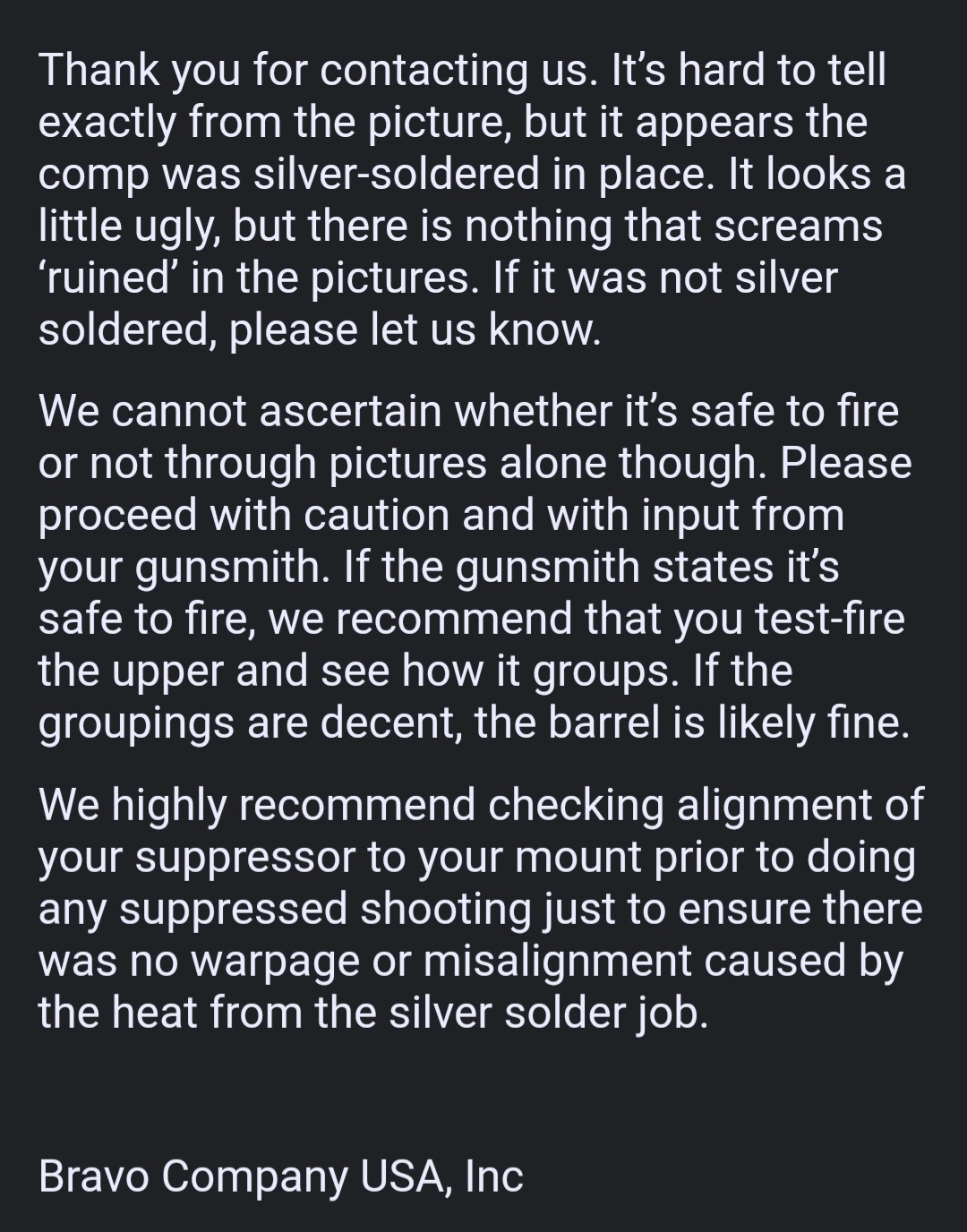

I sent them a note this morning, with pictures.... And great point, worth a shot... Unfortunately, they shut off their phones and only do emails... (which is pretty annoying). From my experience, they will maybe get back to me within 3-6 weeks, but agreed worth a shot.
Still havent made it to the smith, however I did hear back from BCM... Interesting that if it was silver solder, they think it might be ok... I'm curious thought, if it say did group fine, would it still have some sort of other long-term risk due to the heat it hit? As much as it sucks, I am dreading have to go through the process of finding another barrel, another smith, etc, IF it's functionally OK and unaffected (assuming Suppressor works).
Then again, I never asked for a silver soldered MD.... I asked for Pinned and Welded.. which I think is much less heat spread all over the place down the barrel, etc, vs this method. So I'm still going to pursue something. Just such a shitty situation, and lesson learned.
That's just a lawyer written response. They will never tell you one way or the other if a modified barrel is safe. If they said it was good and you blew it apart with the first round, they're looking at a lawsuit. If they tell you no, it's unsafe and someone else, after personally inspecting the barrel says there's nothing wrong with the barrel, social media could rip the a new one.
I wouldn't use their email as any basis for determining the safety of this barrel. There Smiths on this forum, I'd listen to them before I'd listen to anyone else.

Lol, regardless if it functions or not it still looks like hammered dogshit coated in BBQ paint so theres that.
If the smith gave it a green light and your suppressor fits and the barrel shoots well. IF the smith was then willing to clean it up and and have it professionally coated. I would maybe consider keeping it ...maybe.

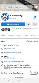

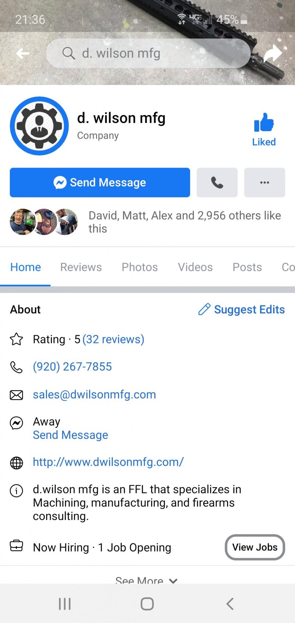

Bite the bullet and send it to Dave. If work left this other guy's "shop" looking like that, I wouldn't trust him to fix anything...
The reason they asked if it was silver soldered is because there is minimal heat used in the process and the low temperatures will not affect the steals forging process or the factory finish.
in the ar pic thread this upper had a p&w bcm bird cage flash hider, so it is safe to assume the the smith tried to burn off the old one. During that process the smith damaged the barrel. i am surprised that BCM thought the welds where silver soldered. Soldering welds flow and are smooth.
Hi I've looked at the photographs and these welds are terrible take your rifle back and complain tell him if this work is not put right you will take it to another gunsmith and bill him for the work, these welds are not suitable and if you attach your moderator there could be an accident where either you and / or other people are injured resulting in claims against you find a better gunsmith one that doesn't wear a Stetson.
My take on this is that you paid for a professional service and got a hack job. NOT okay with that. I'm currently dealing with a GIANT mistake by a smith but at this point no reason to think they won't make it right --but it'll probably eat a month's worth of profit in order to do so, it's gonna require a chassis replacement. It's sickening all around really but it's not my fault.
But at least my fuckup LOOKS okay --just way out of spec (for a company that doesn't do out of spec!). You think YOU have bad luck... You obviously have never met me.
So at the end of the day, the value on that rifle has been tanked. Even if all else is kosher, I wouldn't pay you anywhere close to what you've got in it. In addition, since it's so fucked up looking, I'd be VERY concerned if a can would line up. I'm not familiar with that mount but from the looks of it, I'd be worried about it locking up and mating properly too.
There is NO reason it should look like that. To pin and weld all you gotta do is (take some initial measurements) install the fucking thing like normal and then sink a 1/8" or so drill w/drill stop so it just penetrates the barrel. Drop a hardened pin in there and weld over. It should look like a little 3/16" flat "button", maybe a bit discolored, and some places even buff that down and refinish it so you can't tell at all. That's it, and all it really takes is a drill press and a weld. Shit, you could do it with a hand drill.
Whatever the fuck they did I have no idea, but they ruined the value of the rifle.
Guessing SBR isn't a thing where you are? I pinned and welded two LMT rack M4's --then a month later WA approved SBR's almost overnight with no fanfare or warning. Would have been nice for a heads up... Anyway, one fell out of the safe one time and took a bit of a hit near the muzzle, nothing spectacular but it managed to break the weld and had to be redone at no cost. FWIW, Rainier Arms uses or used a Boeing machinist to do their work and he did phenomenal work.
I'd want a replacement and at their cost.
