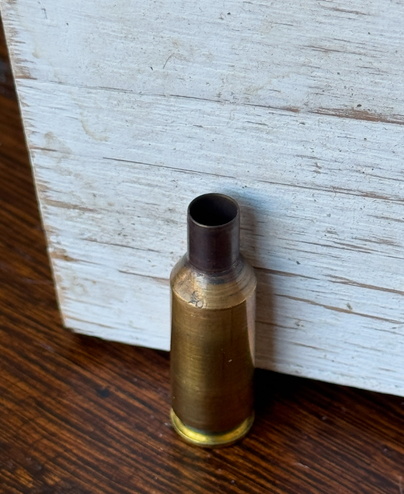

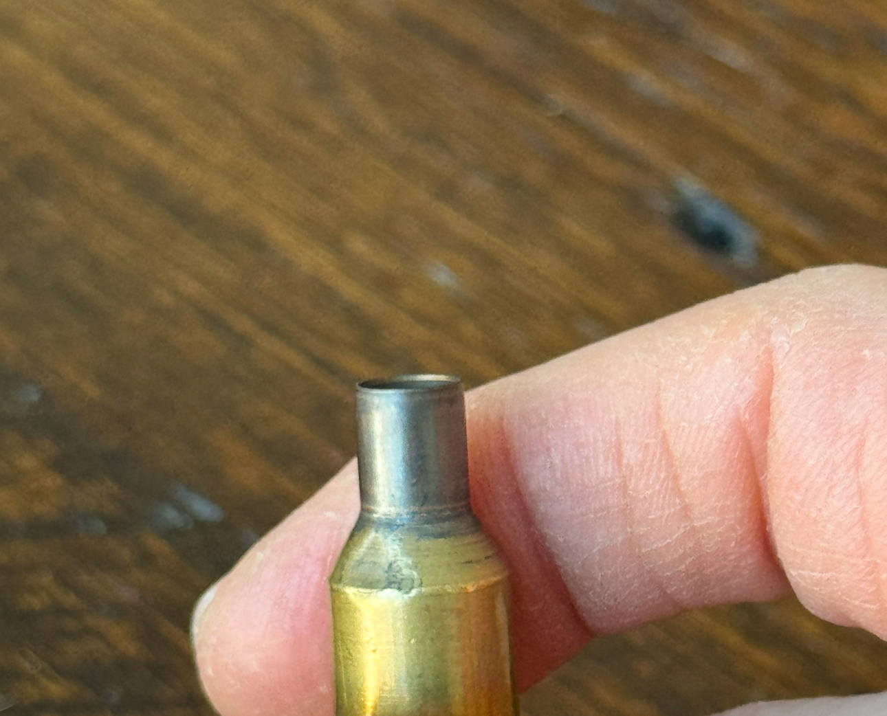

I found the piece of brass that was shot right after the hard bolt close. Retrospectively seemed like there was a physical piece of debris in the chamber. I thought maybe the damaged steel in the chamber flaked a piece off and that’s what the blockage was.
The damaged shoulder appears to line up with the chamber.
I fired one shot more shot before discovering the chamber damage that brass didn’t have anything wrong with it. After I saw the damage I cleaned lightly with patch out to ensure physical debris was removed. Those 4 pieces of brass all looked fine. There was a piece of debris caught in the gap of my hellfire adapter roughly the size of a kernel of powder that I found after removing my Maverick. Thinking that may have been pushed through on one of the cleaning patches. Didn’t look like a kernel more like a chunk of carbon.
Brass is Lapua 6BR, 6 BR chamber.
Likely just a piece of carbon in your chamber that fell down the bore from the suppressor. It's very common. I don't think it's corrosion pitting. It is very hard to tell the difference between something raised and something below the surface with a borescope.
Your brass tells the story. It's appears to be a raised feature indenting the brass and not pitting. Deep pitting allows the brass to flow in and makes for hard extraction, but not hard bolt close.
Get it out and you'll be back in business.
