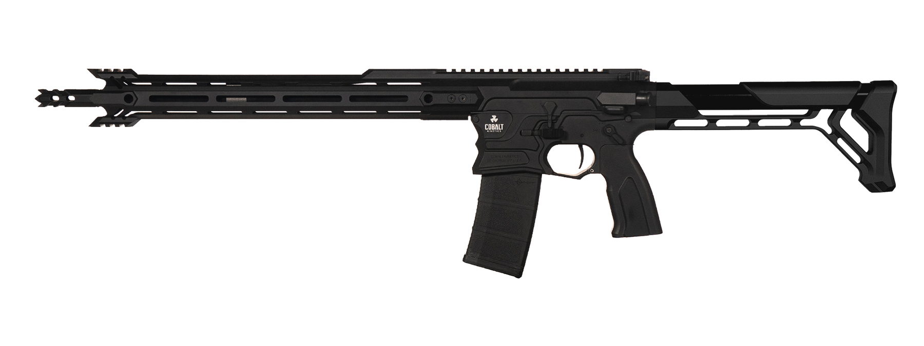

Id like to buy a Cobalt Kinetics EDGE 5.56 (priced $3,240.00 as seen in the pic) with billet stock being a precision type OR id simply custom build my own. Likely, id build my own. The EDGE is a spectacular model though.
