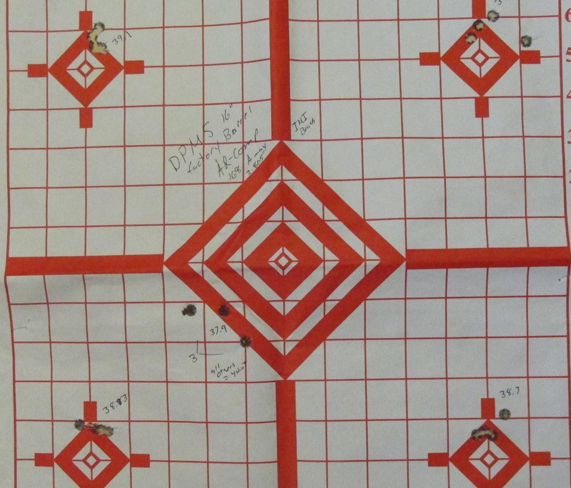

Maybe it’s my rifle or whatever but in my 16” gas gun AR Comp is smoking fast. I’m loaded up for tomorrow to verify my loads but with a load of 40.7 gn’s with 175 smk’s I’m getting a mv of 2512 (5 shots) with low single digit sd’s with easy sub MOA groups. Probably an average of .5-.6 moa. And zero signs of any pressure. Varget is close with speeds but around 15 FPS slower. Es / Sd’s and groups size is about the same though. I just want a few more range days to really be comfortable with what I’m seeing.
Reactions: NFAJohn
Thank you everyone for the input. 8208 and AR Comp AR both available at my LGS.
Hornady 10th edition has loads listed for 8208, but not AR Comp. I pulled the Alliant website and it just shows 41.4 with a 175smk and 40.6 with a hornady 178bthp. If memory serves me correctly the 178gr eldx has more bearing surface than both of those projectiles.....where would you AR Comp fans suggest I start at? I was thinking 38.5 and work up in .3s looking for pressure. I may be ugly, but I’d like to keep my face in its current state of not being blown up.
Keep in mind this is a 16" chrome lined factory DPMS barrel with carbine gas... because of that I started real low and was looking for a load that would not trash my brass. I didn't care how fast it would shoot, I just wanted it to be accurate. I'm using IMI brass that also has a little less case capacity compared to lapua/winchester. 38.6 was turning in about 2400fps with 168's.

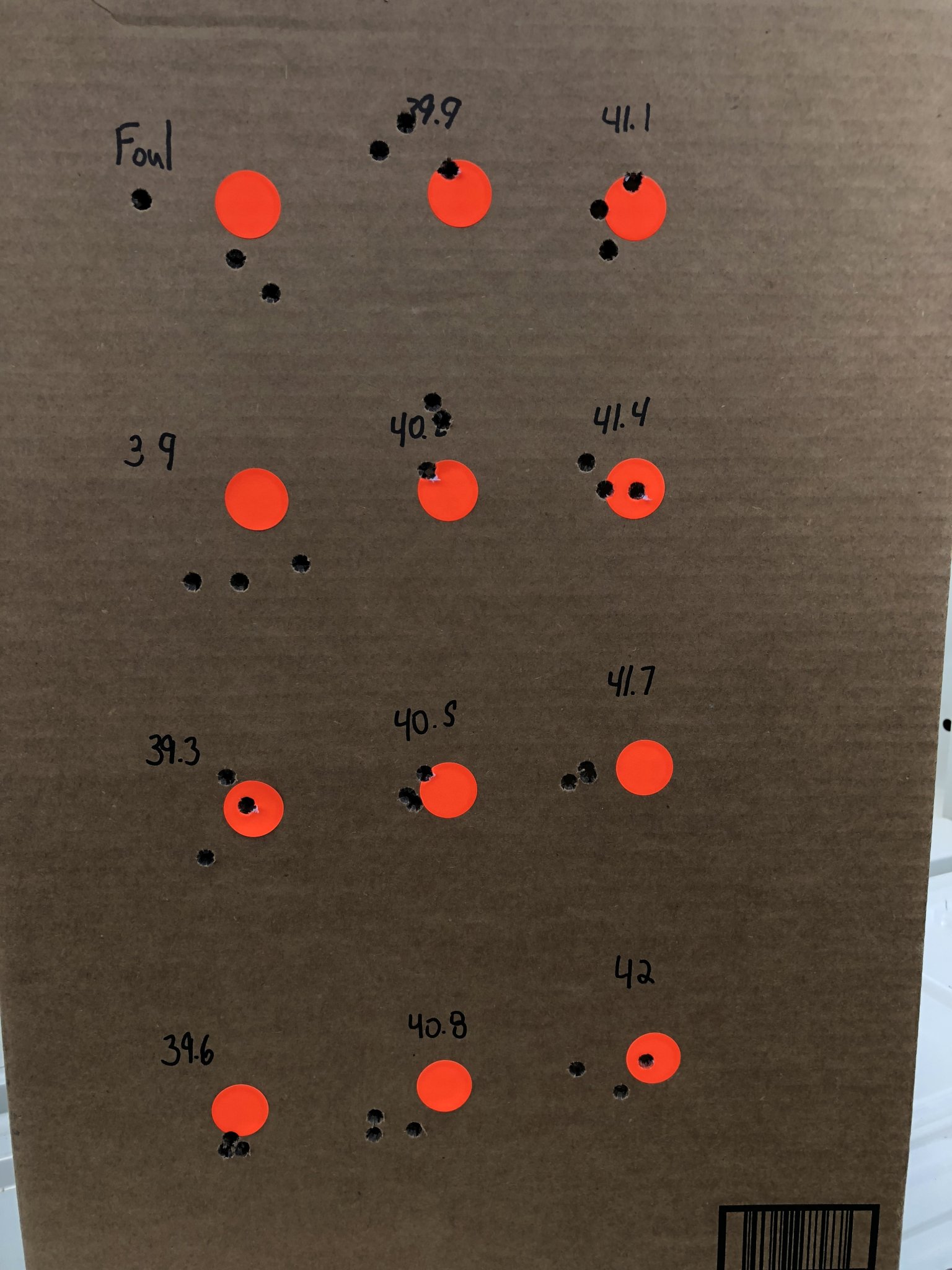

Work has been crazy hectic, but I finally made it to the range. Ran some RL15 while waiting for Ar Comp to come in. Only problem....battery on my chrono was dead when I got to the farm.
I had very faint pressure signs at 42gr, was considering pushing to 43gr to see if I’ll find another node. The 41.7 load is nice though. Running the 178eldx in virgin Nosler brass Loaded to mag length.
Would yal push to 43 or settle? I’ll make it to shoot again this weekend and I’ll collect some chrono data.
Your point of impact stabilized at 41.1 and your vertical started to tighten up at 41.4. I would stay in that area.
Also, the 4895's were the go to powders for 308 gas guns a long time before Varget and RL15 existed.
Reactions: NFAJohn
Ya that is kind of what I was thinking, pretty sure I'll run into pressure before I make the next node. I'm thinking I'll load three each at 41.1-42 in .1 increments and run them over the chrono and for groups.
Appreciate the advice
