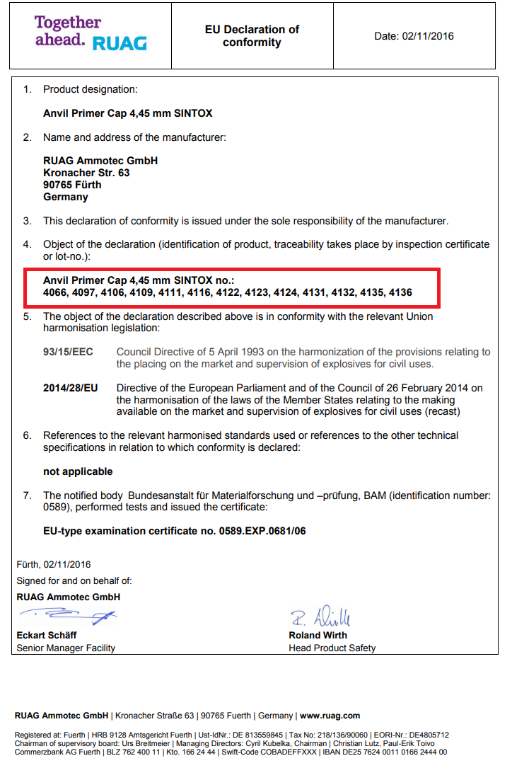

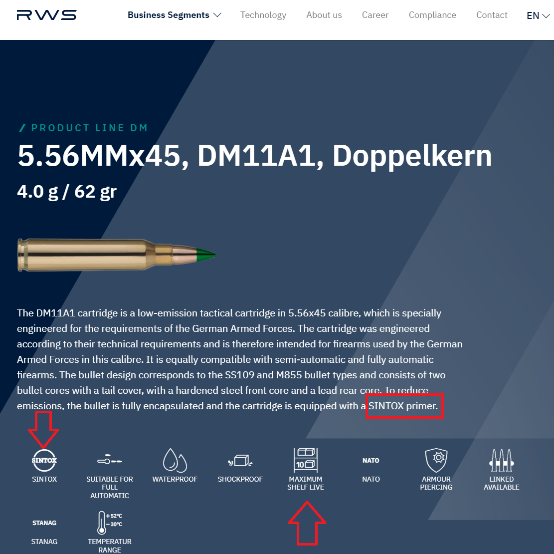

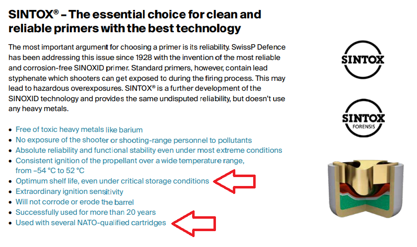

The RUAG 4122 "Greenfire" are SINTOX compound primers. SINTOX, the first low-pollutant and heavy metal-free primer composition, was developed over 40 years ago. To this day, based on customer requirements, the company uses revolutionary energetic components to develop and implement non-toxic concepts that are free of lead and other heavy metals.

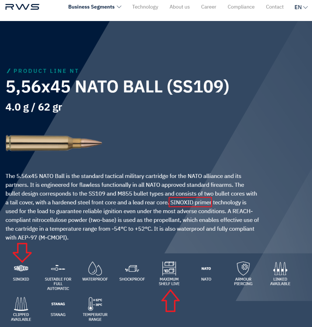

The loaded ammunition that RWS makes (using RUAG primers) that conforms to NATO AEP-97 specifications have a advertised maximum 10 year shelf life. 10 year shelf life is a limit set by NATO AEP-97 and STANAG 4297, AOP 15, STANAG 4620 AOP 48, which is probably where the supposed/perceived shorter shelf life thing came about. Powder degradation for loaded ammunition under various (critical) storage conditions (specified in the NATO standards) also has to be taken into account for shelf life, so more likely than not, the actual effective life of the primer (and ammo) extends well beyond the 10 year "maximum" shelf life time span if stored under optimal conditions.
Edit - Even ammo with normal non-corrosive lead styphenate based primers (RAUG's version is branded SINOXID) that conform to NATO AEP-97 specs have an advertised 10 year shelf life, but real world results show that the ammo is good for well beyond 10 years if stored well.
RWS DM11A1 5.56x45 with SINTOX (lead and heavy metal free) primers
RWS SS109 with SINOXID (lead styphnate) primers
EU Declaration of Conformity - RUAG Anvil Primer Cap 4,45mm SINTOX
