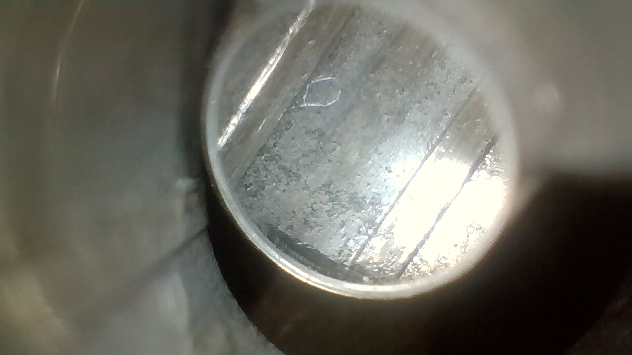

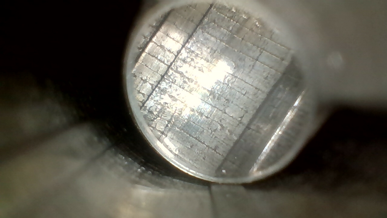

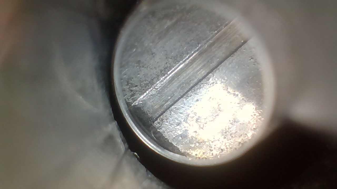

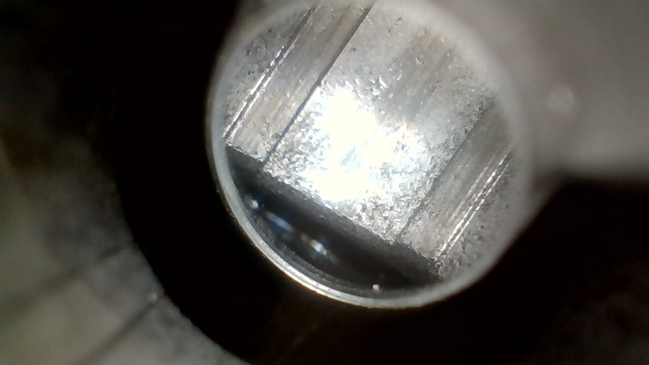

I’ve got three barrels in the shop. One is a 308win. Has only 500 rounds on it. Cleaned it with an abrasive and a brush. Shooter took or should I say changed the bore and groove size by a full .001”. Accuracy is junk.I just want to see somebody repeat this process on a relatively new (<500 rounds) benchrest or f-class rig...with before and after groups at a moderate distance.

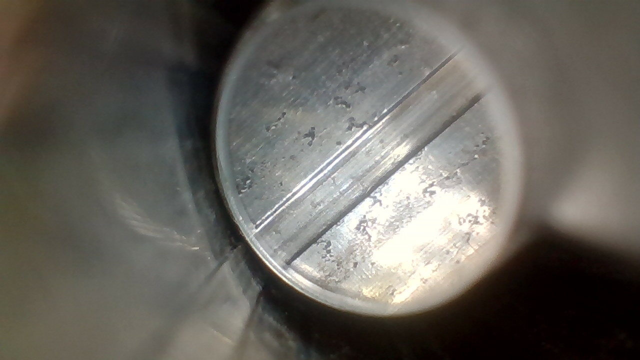

Another barrel with 110 rounds fired on it. It’s a 260AI. This guy didn’t wreck one but wrecked three barrels in a row!
The pic I post a lot is a 284win with 800 rounds on it. The barrel started having accuracy issues at 100 rounds! Right now the bore measures .279” and the grooves are at .2855”. When we made that barrel it was at .277” x .284”. So the shooter basically polished out a full .002” out of the bore (tops of the lands) and at least a full .001“ out of the grooves.
I’ve also got data on another 308 barrel. Barrel shot 1/2” groups at 200 yards. If I recall the barrel only has 250 rounds on it. He cleaned it once with Flitz and a brush. Then it went to shooting 2” groups at a 200 yards.

Also, take a gander at the link below for example damage. It’s not as hard to wreck your barrel as you think. Especially if you have OCD.
How and when to utilize abrasive bore cleaners
After reading @Frank Green talk about cleaning and carbon ring removal I decided it’s time I take care of my neglected barrels. Some of my barrels are getting up there in round count, and cleaning carbon is getting harder and harder. Jb bore paste is what Iv seen some recommend as a mild...www.snipershide.com

This is exactly what happened to my 308. I was sick when I dug it out and cleaned it before I was about ti start shooting it again. Pushed a patch through it and it came out orange!Same thing when you hear.... I don't clean it for a long time! I'll guarantee you that if you put it away dirty for x amount of time and the environment you are in....the barrel and the fouling will react with the air itself and the barrel will corrode it will pit.
I really didn't intend for this to happen. Just wanted to see if anybody had done it and what their experiences were. I'm going to do it then post the results.Classic barrel cleaning thread where everyone's opinion is right and other people are stupid.
