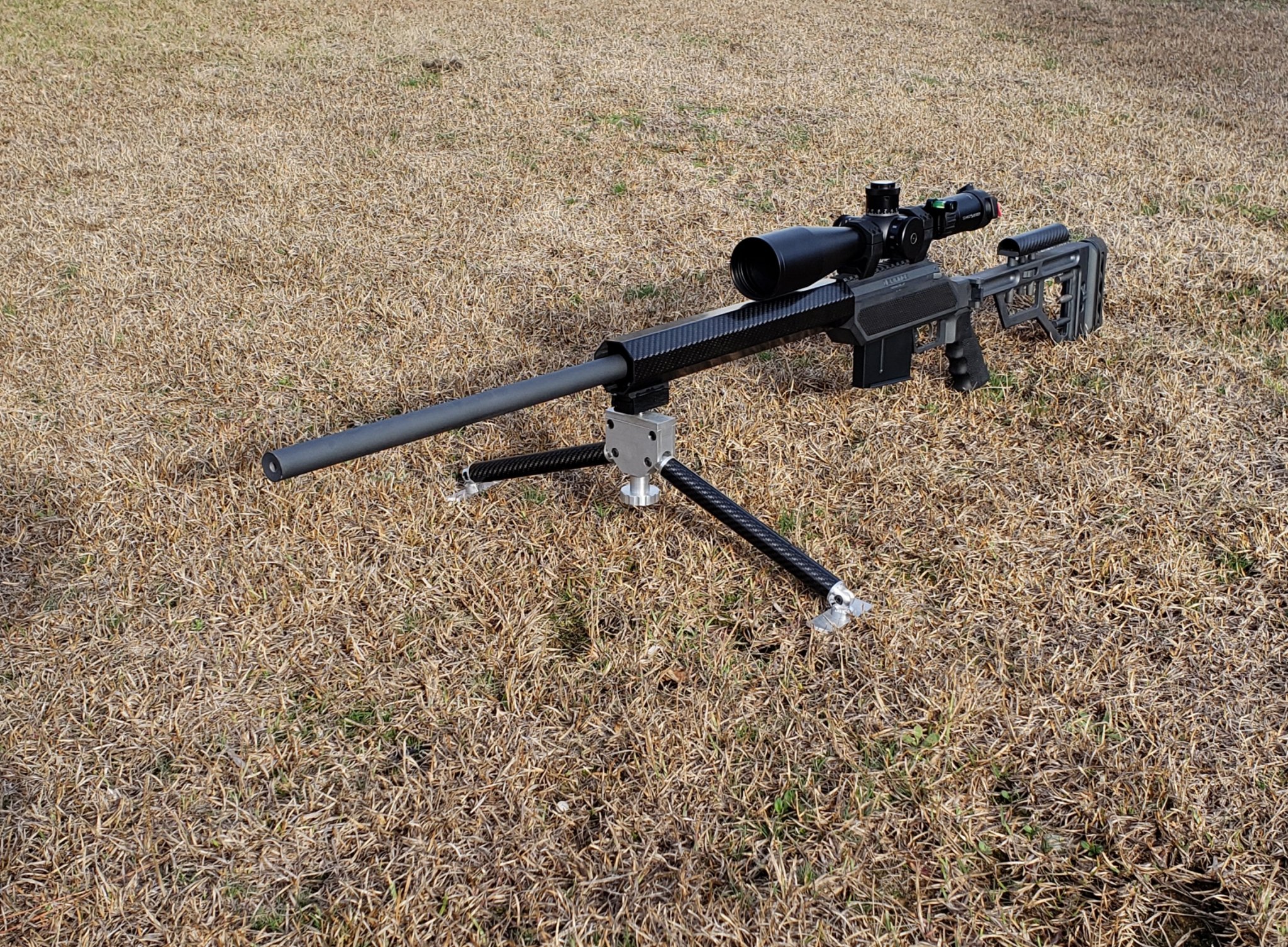

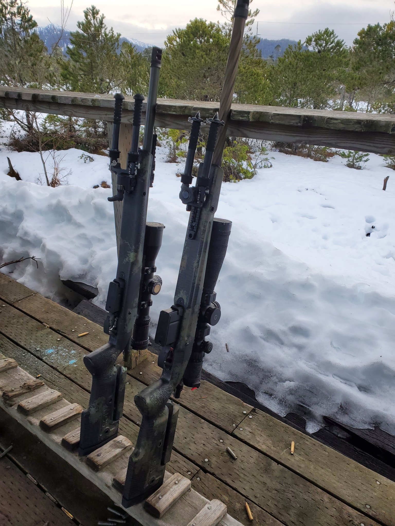

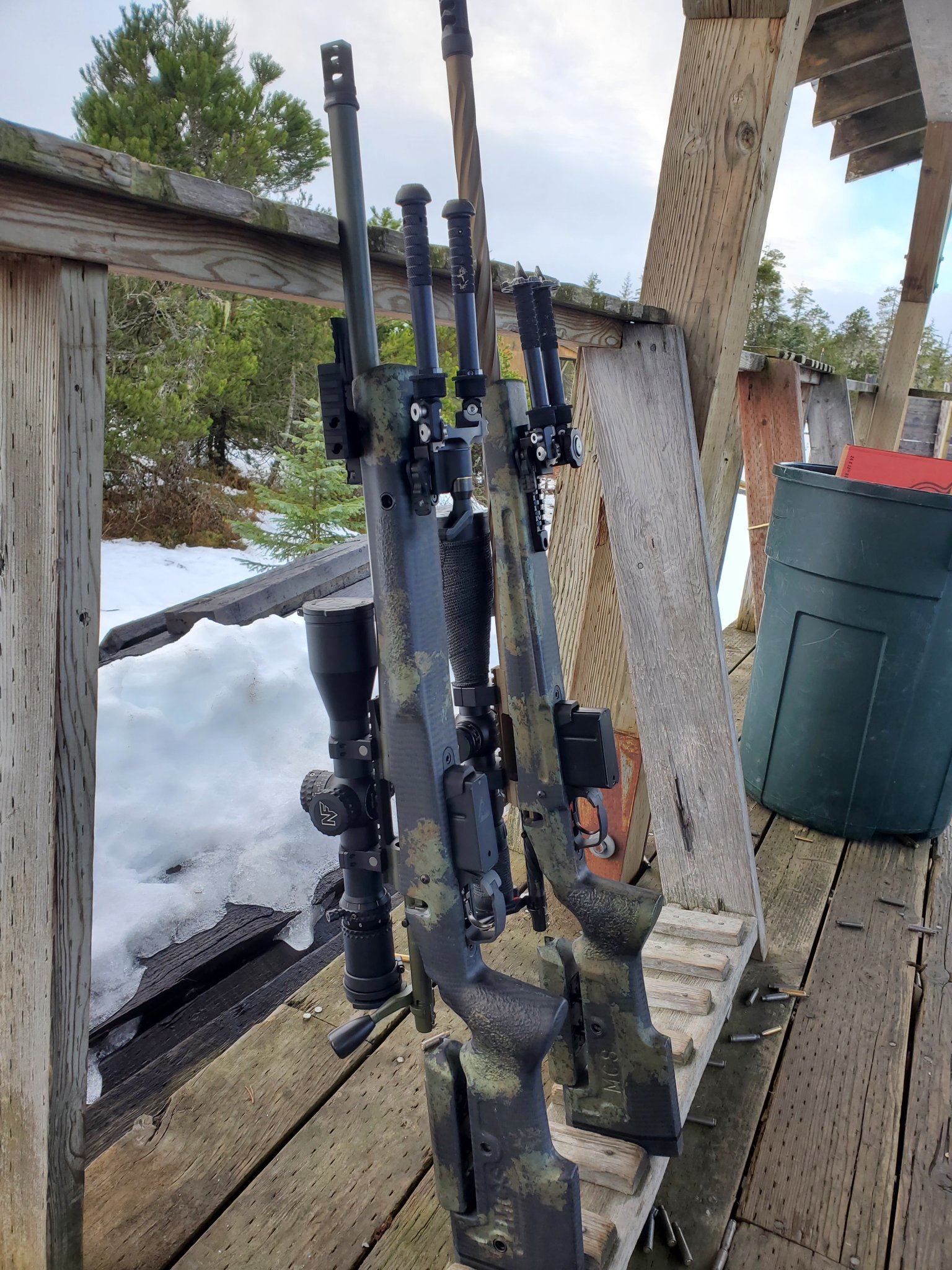

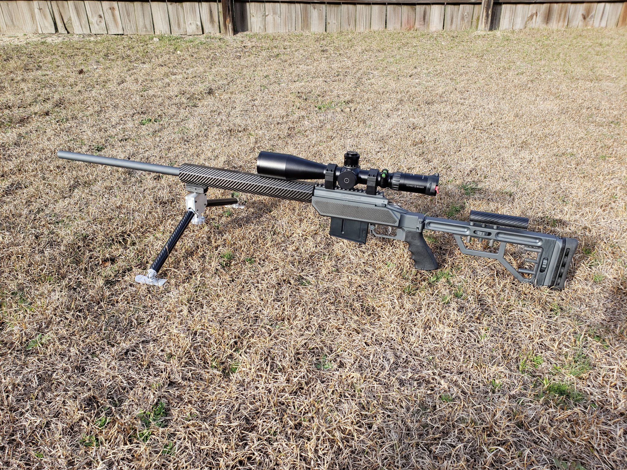

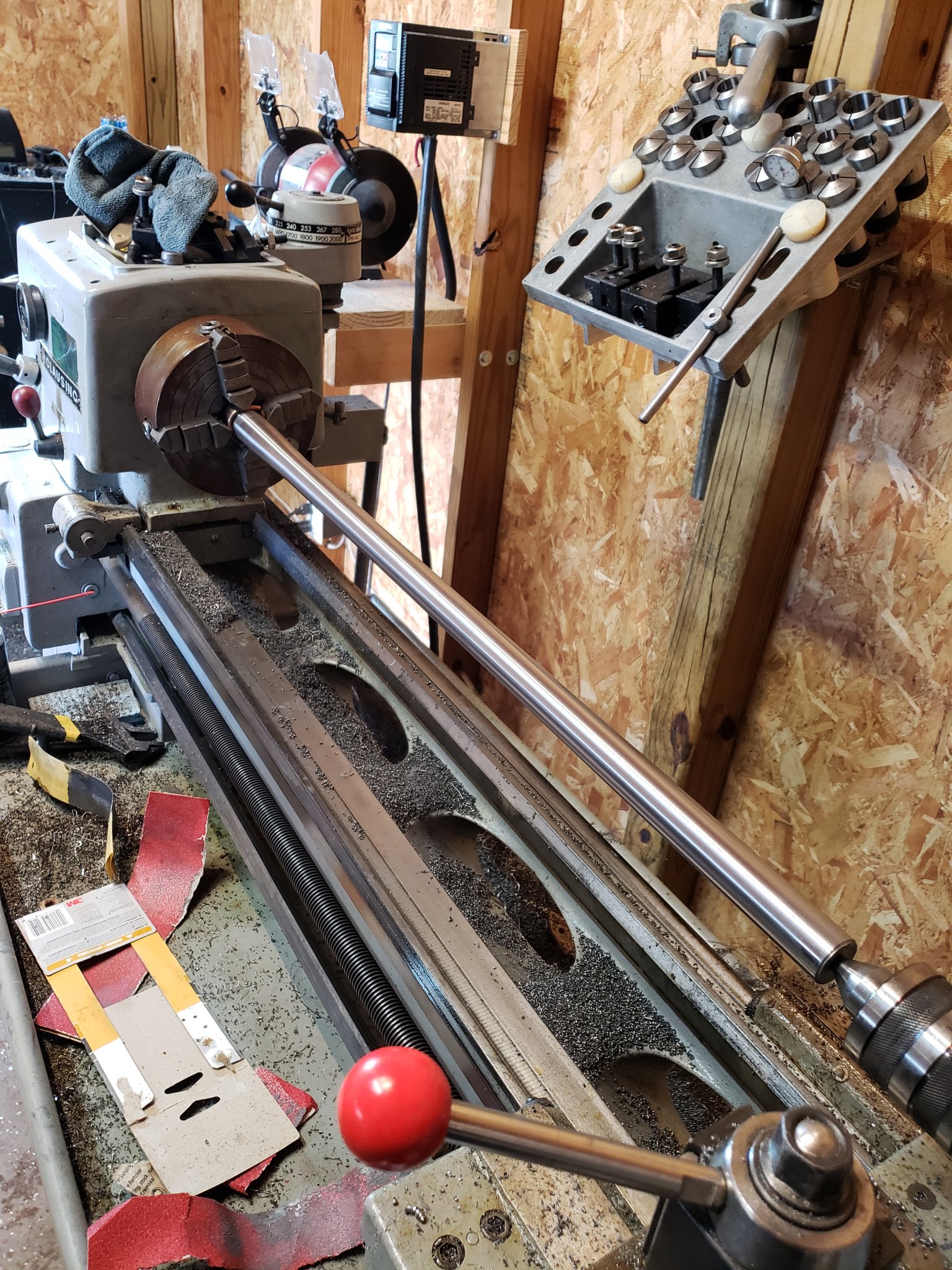

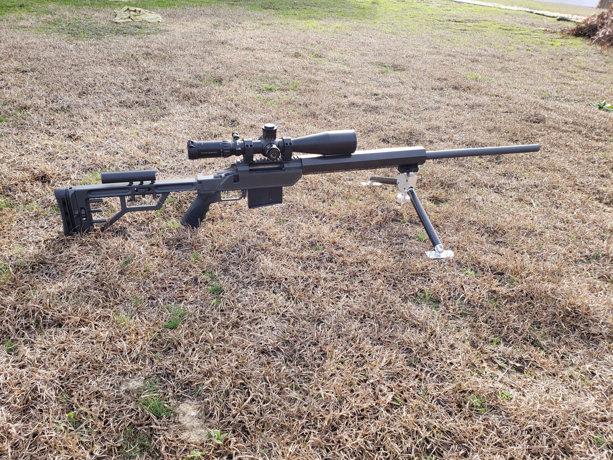

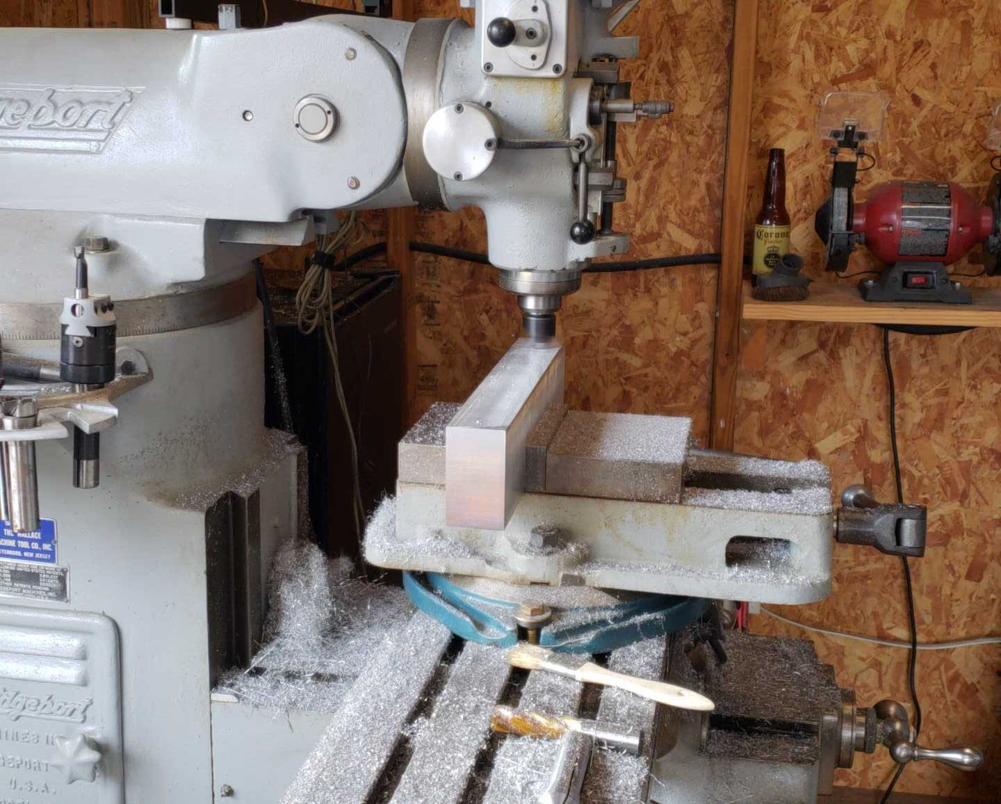

Well since the snow is disappearing I decided to get out and shoot one of my work guns and my Alpha Omega 6.5 Creedmoor. Beautiful day out today for shooting.
Rifle chassis, chambering, crowning, etc 100 % done by me in my little home shop/shed.
Barrel - Brux 28" 1×9 twist .284
Action - Defiance 700 long action
Trigger - Jewell Adjustable
Stock - Custom Made Alum/Carbon
Bipod - Custom Made Alum/Carbon
Hand Rail - CF 16"
Scope - Schmidt Bender 12-50×56 PF4 1/8 MOA
Shooting .284 win 184 berger 53.4gr bullets. Using H4831SC or H4350 powder. Bullet 3.330" OAL / 2.505" To ogive.
Thanks for watching!

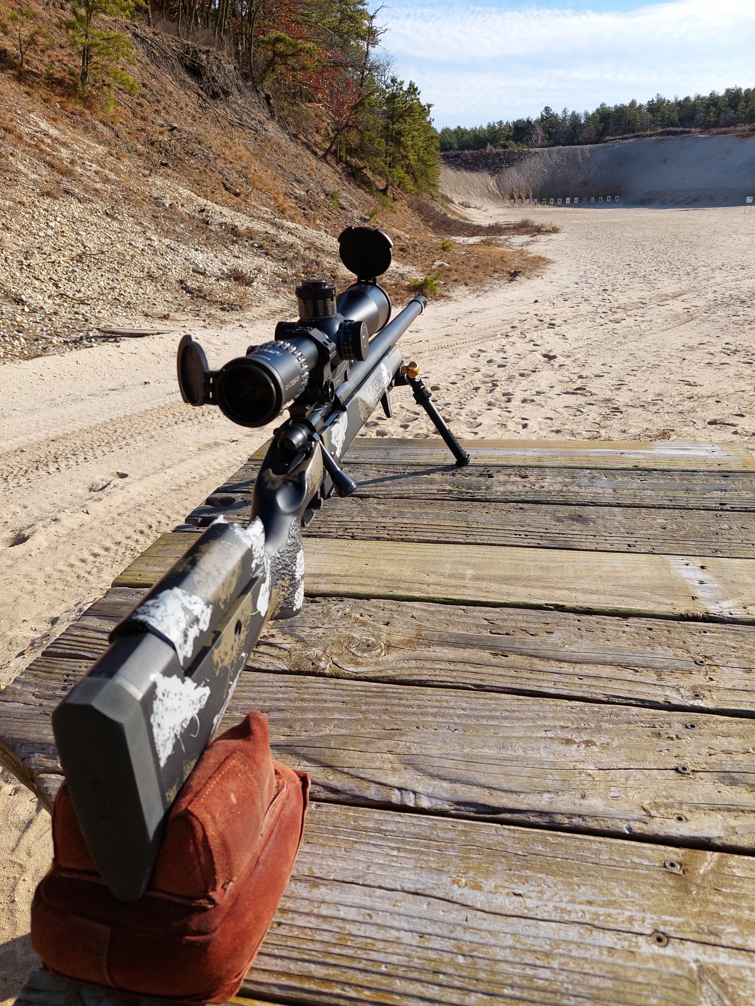

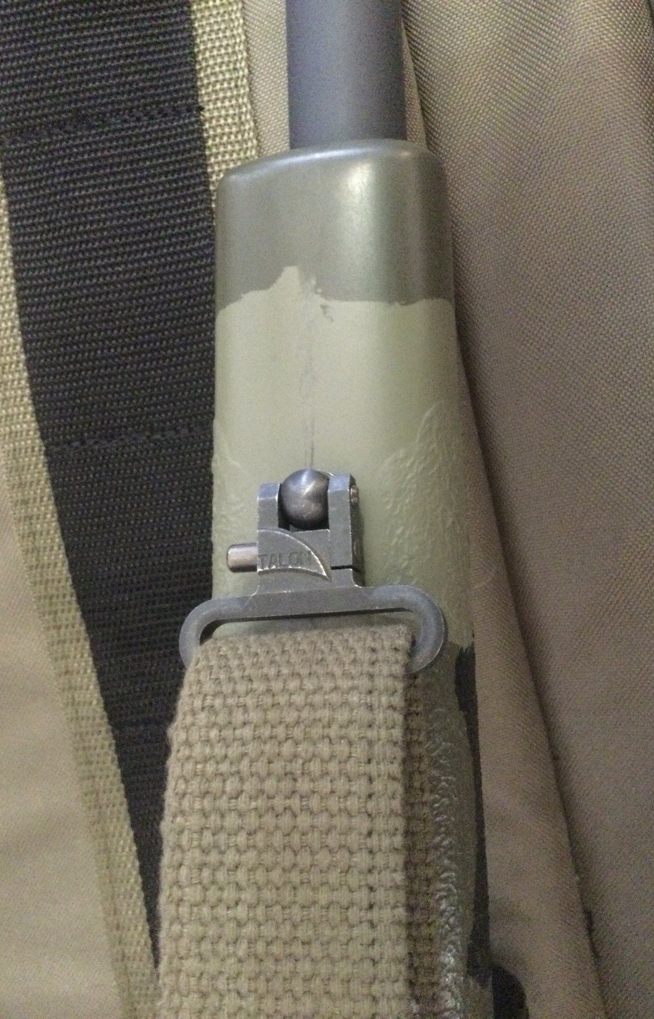

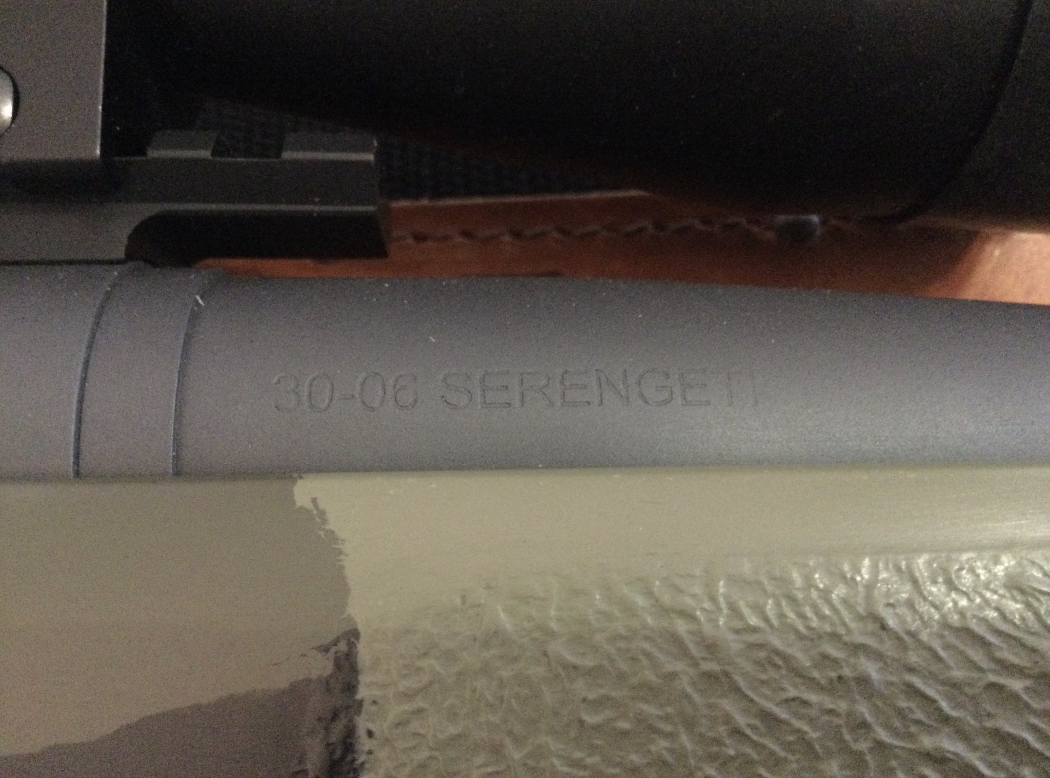

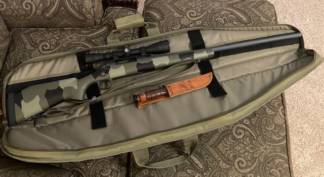

New 700 action (never made into a rifle), RR prefix. PT&G .250” recoil lug, Timney Calvin Elite trigger set to 1.5 lbs. Krieger 26” stainless 1-10” twist Remington Varmint contour (Krieger makes these over sized), chambered with new PT&G .30-06 Serengeti reamer. It uses standard .30-06 reloading dies. 11 degree crown. McMillan M40/HTG stock with pillars by McMillan and black 1” Pachmayer Decelerator pad. Scope is a Leupold Mark AR 3-9x40 which is mil/mil. I changed the elevation turret knob to no bdc (the one that came on it is for M193 ball). The rail is an EGW heavy duty 20 moa. The rings are Weaver tactical 4 hole. The barreled action is ceracoated in Gunmetal black (H277). Looks like park, but it‘s not. The rifle weighs 9.4 lbs. empty.
All metal work done by https://www.selousgunandrifle.com/

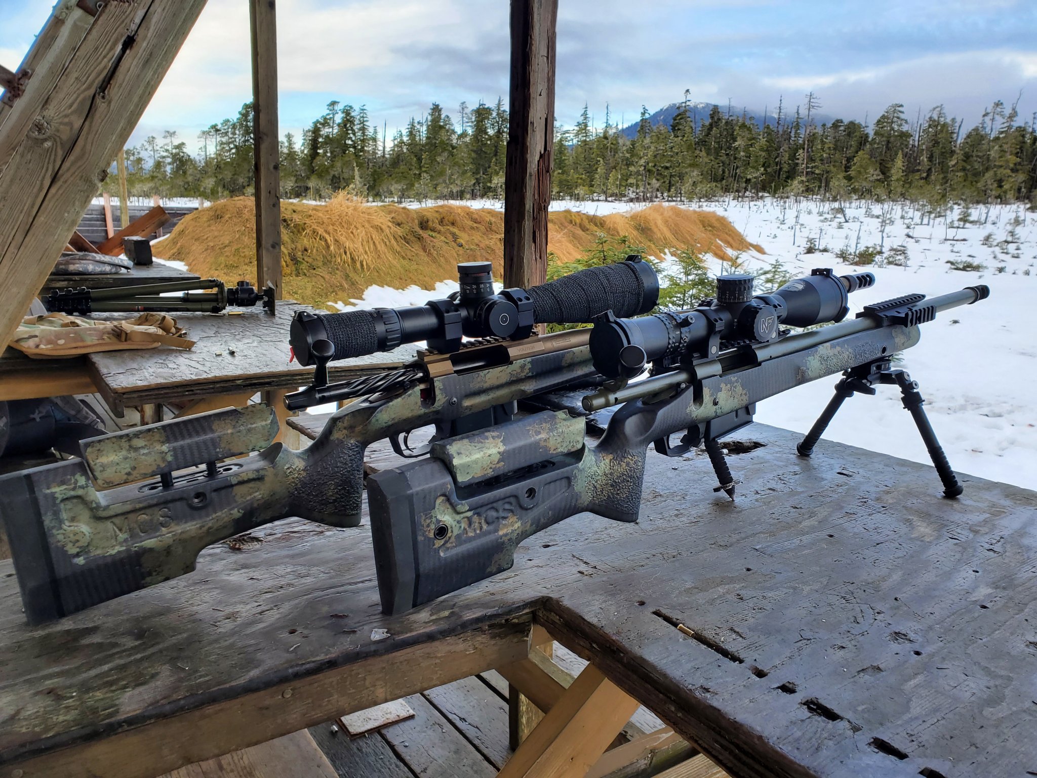

Both of these weigh 22 pounds; gun carriage not included.

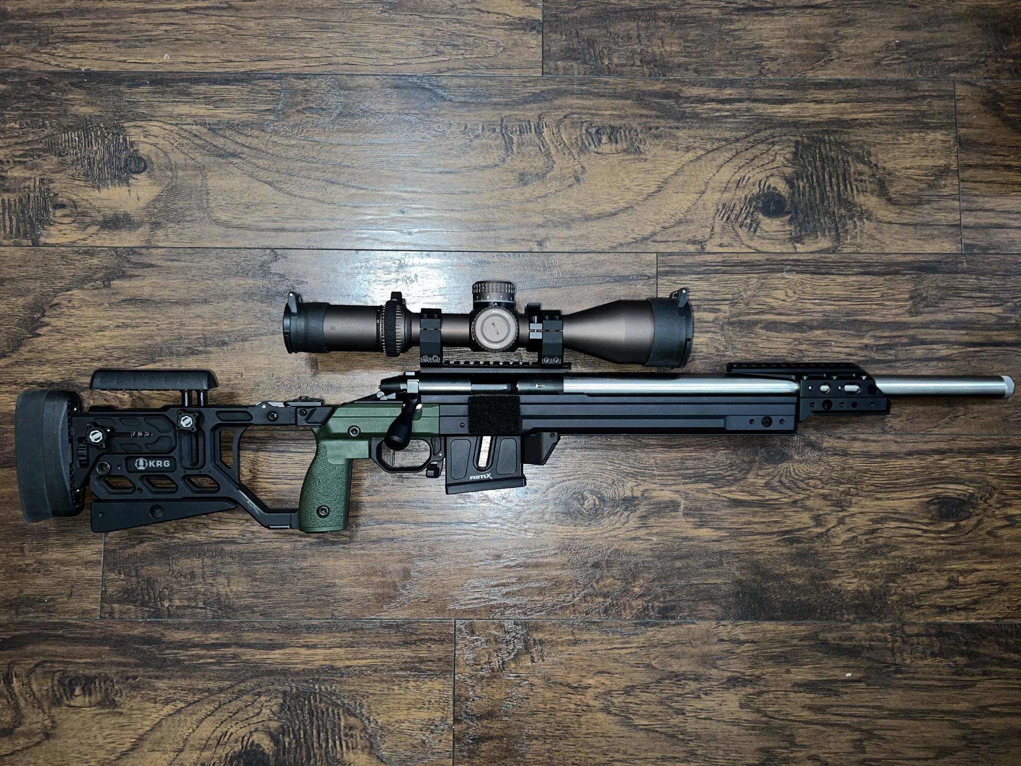

Nice, I like those KRG chassis. I get that heavy rifles are good for recoil reduction and competition, but I really just want a light/mid-weight precision rifle that is easy to carry that I can hike around with and shoot, hunt with, etc and not be a burden. I’m thinking of doing one up with the A3-5 or Game Warden and target a 10-12 pound total weight. The A5 is just a fat range toy for me, I want something more mobile on my next go around.

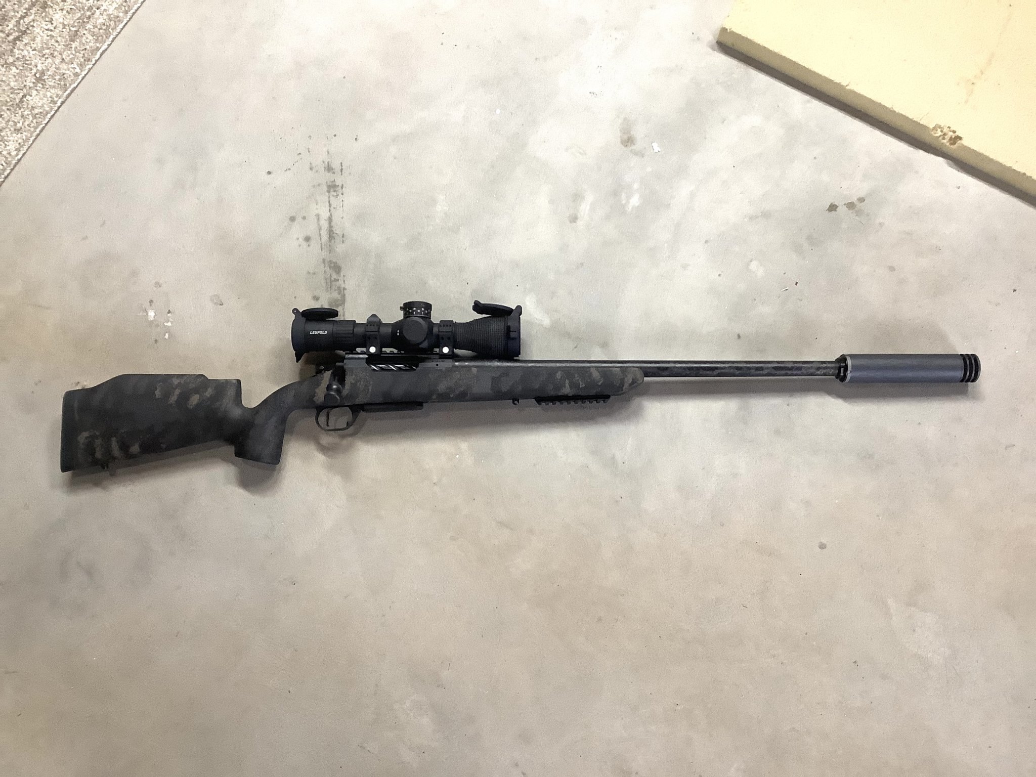

Re did my hunting set up. Used to have a manners PRS1 with a 24” hawk hill barrel in 6.5prc. Weighed 14lbs without a suppressor.
New setup is an ag composites Visigoth, proof 22” carbon barrel in 6.5prc chambered by fritz ahlquist, Hawkins hunter dbm, and my omega 300 that’s out of jail finally. 10lbs even as it sits now
View attachment 7806084Re did my hunting set up. Used to have a manners PRS1 with a 24” hawk hill barrel in 6.5prc. Weighed 14lbs without a suppressor.
Waiting on a call from Fritz any day now.:D
I really like the black multi cam stock w/ CF barrel. Nice rifle!

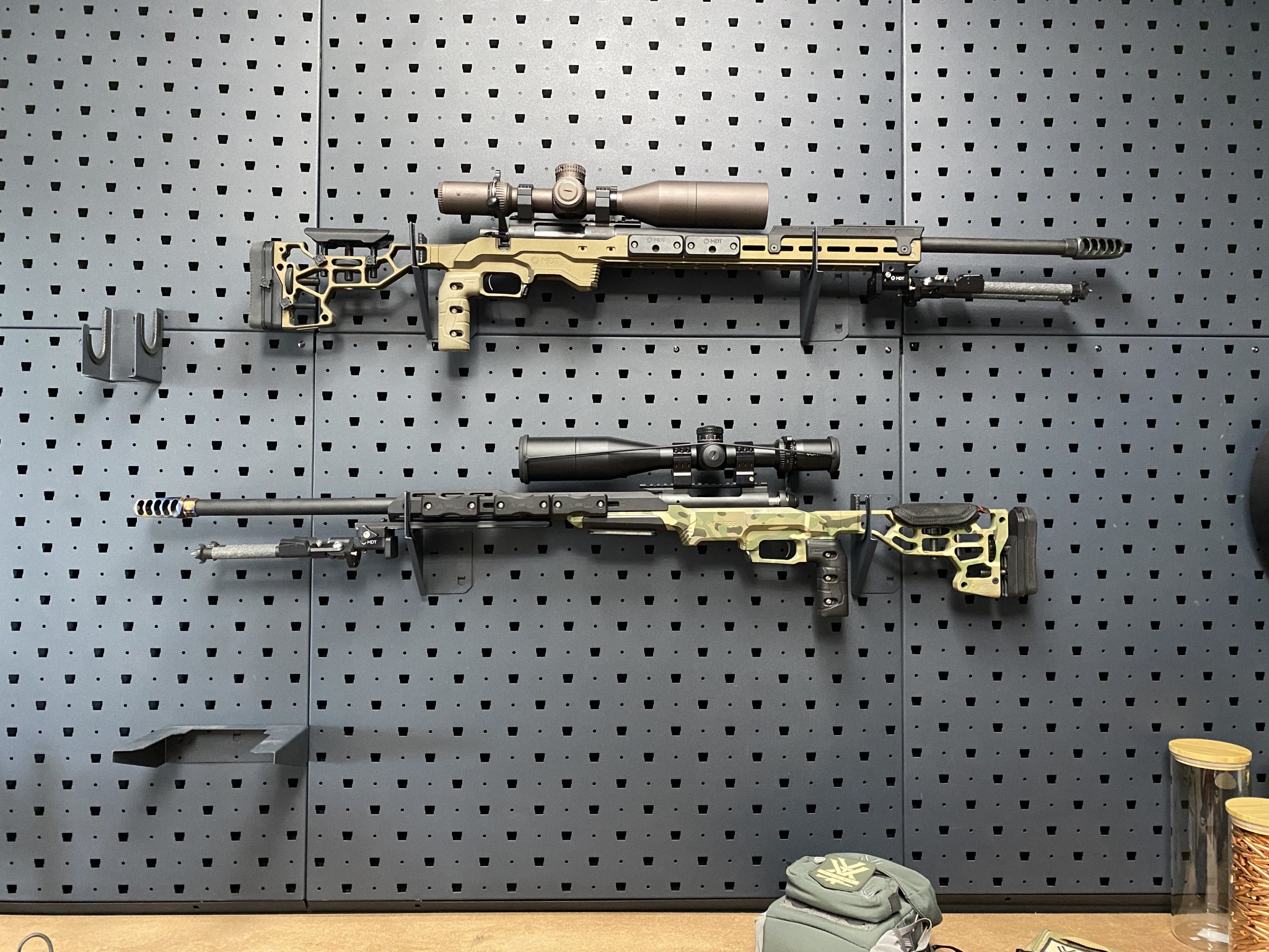

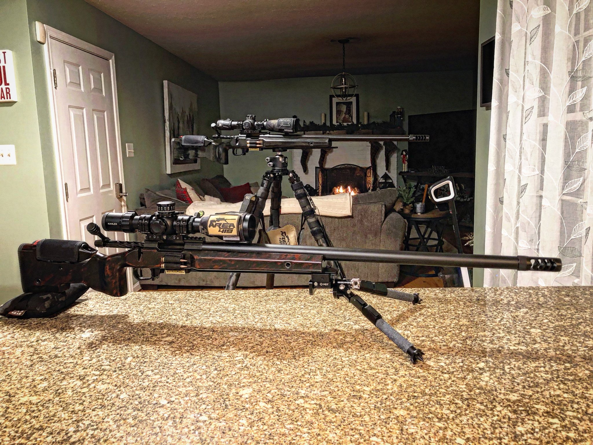

About time I posted here.
Top rifle:
Howa 223Rem
MDT ACC
Vortex Gen2 4.5-27 Razor MRAD
APW Raptor Brake
Ckyepod
Bottom rifle:
Savage 260Rem
MDT ESS
Vortex Strike Eagle 5-25 MRAD
APW Raptor Brake
Ckyepod

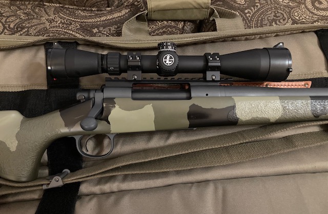

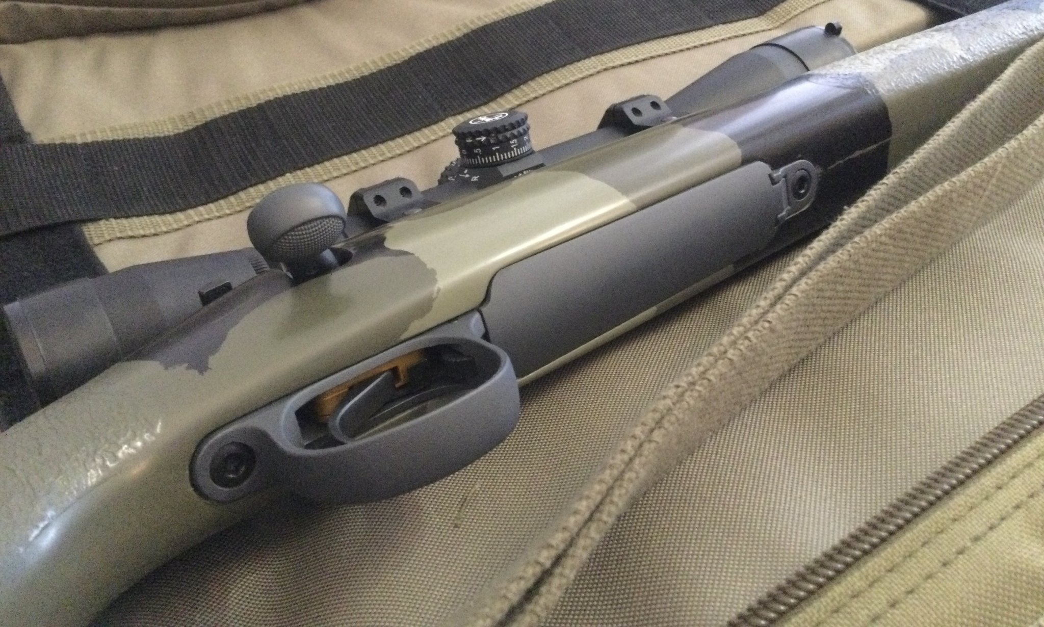

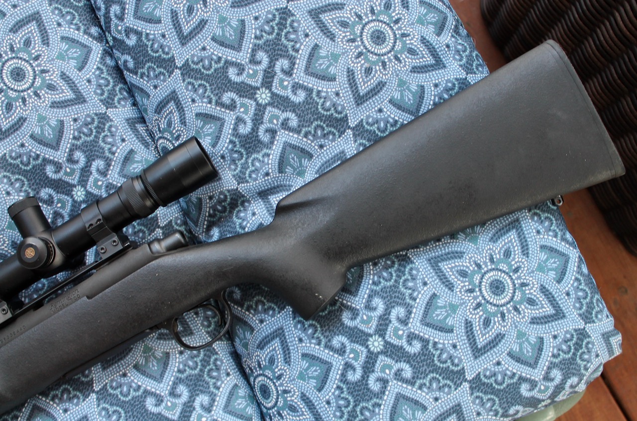

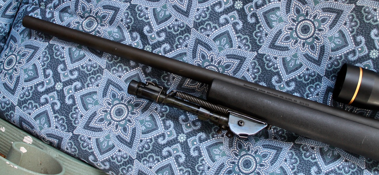

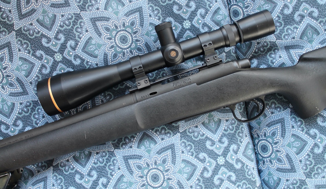

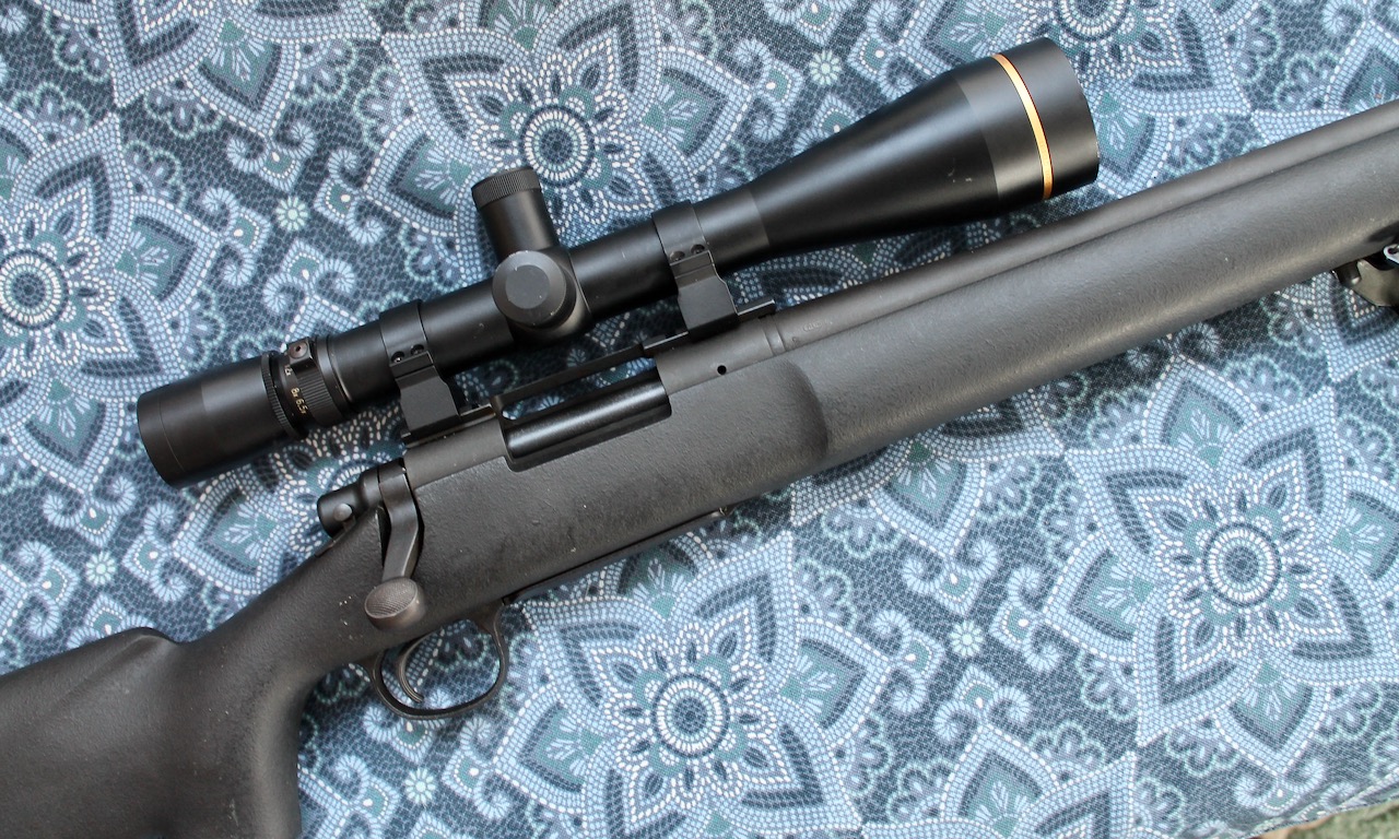

Bored so decided to go to my favorite local gun shop to see what they had, shelves were pretty bare, due to the times they are having a hard time getting any firearms.
I spied one lonely used rifle sitting in the rack, took a look at it and turned out to be a Remington 700 Police .308 26" barrel with a very nice Leupold VariXIII 6.5- 20 Long Range with simple mil dot reticle sitting on it and a Harris bipod, has parkerized finish and a HS Precision stock with the aluminum bedding block. Seemed to be a reasonable price considering the cost of the scope so whipped out the credit card.
Got it home and checked barrel codes and Leupold date codes, both the rifle and scope date from 2003.
Really was just looking for a cheap 700 to use the action for a custom build but looks like will need to see how this thing shoots first.
Really was just looking for a cheap 700 to use the action for a custom build but looks like will need to see how this thing shoots first.View attachment 7807744View attachment 7807745View attachment 7807746View attachment 7807747
Great find! It probably has a low round count too. Not that .308 wears out barrels like the 6mm Creedmoor. Congrats!
