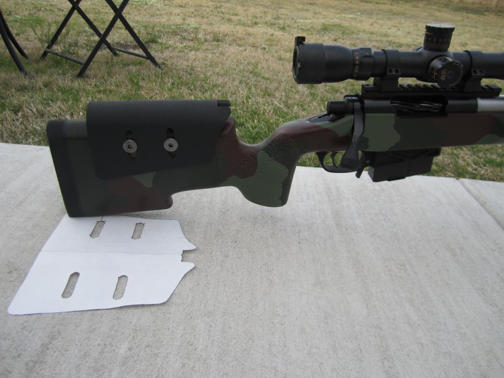

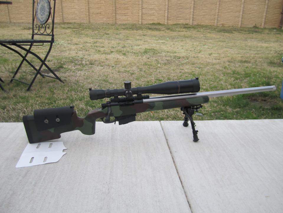

Here is a project that I am just finishing up.
It started out as a Savage Model 16 FHSS in .243
I bought the stock from a FCP-K off of ebay, then I modified it some by changing the grip angle, adding texture with Marine Tex, adding flush cups, and a Karsten cheek rest.
The gun originally had a hinged floorplate magazine, so I ordered the stock Savage bottom metal for the DBM. I also purchased a couple 10 round magazines from Darkeagle Customs.
The stock bolt knob is replaced by the Savage tactical version.
Painted with Duracoat in GAP Camo using a Bulldog Arms stencil kit - the colors are Marsh, ACU Grey Green, and Desert Brown
Bolt fluting by Sharp Shooter Supply
24" Stainless Criterion barrel in 22-250 with 1-9" twist - Light Varmint Contour
TPS 0 MOA base
Duracoated in Tactical Black
Most of the parts were ordered through Jim at Northland Shooter Supply; a really great guy to work with.
Now I am just waiting on the optics, which will be a Vortex Viper PST 6-24x50 SFP MOA

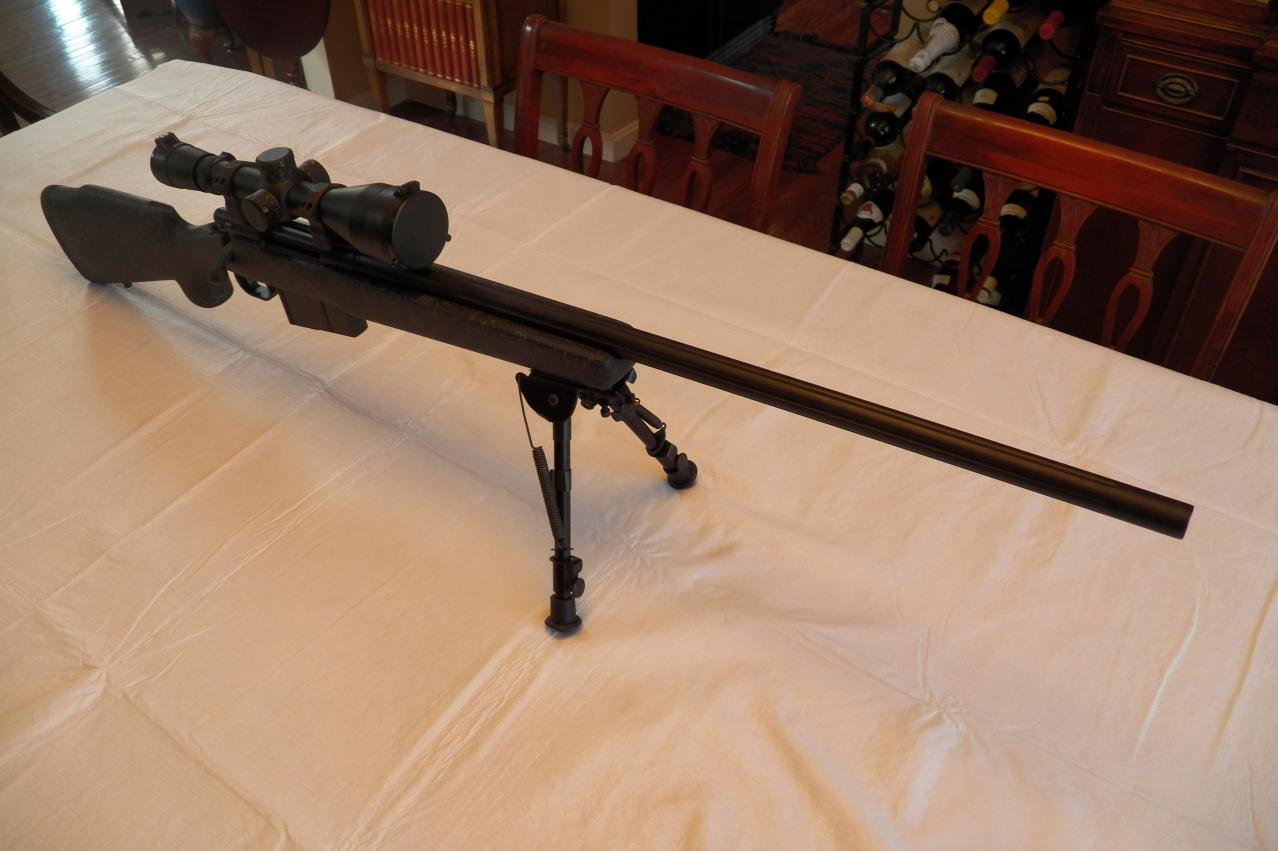

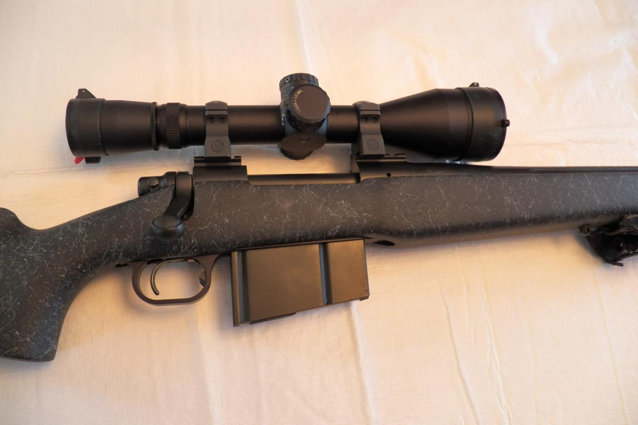

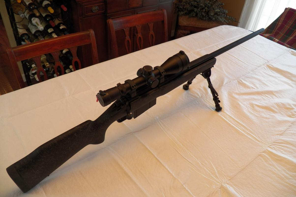

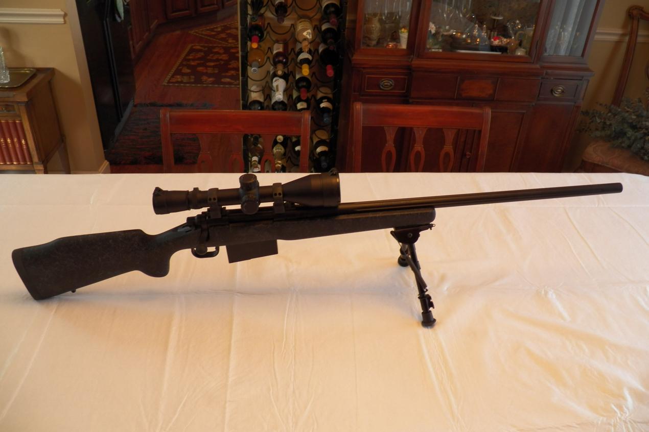

Just received and "dressed" my new Remington 700 Cerakote Tactical 300WM 26". It's a goofy name for a rifle but it rings all my bells and toots me whistles. It is so new from Rem. that it's not in the online catalogue yet. I immediately installed a Wyatt removable box floorplate and mag, my ages old bi-pod (brand name long forgotten) Pic rail action mounts and Leupold M4 4.5-14X50 Tactical scope on Leupold rings.
Whole rig weighs in at 11.5 pounds unloaded. I must admit, the B&C copy of a M40A1 stock fits me much better than the B&C Medalist on my other rifle. Doesn't look as gnarly but to me fit is everything. Looks follow way down the line after.
Forgot to mention, the action and fluted SS barrel are Cerakoted black, hence the rather odd name.

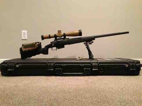

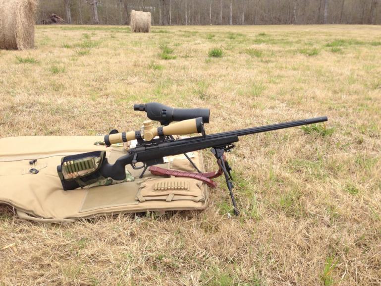

Here is my baby, I named him JR
This is my best three shot group at 100 yards, yes three shots, one hole, one amazing rifle....
Remington 700 .308 action, trued, lapped lugs, bolt face squared
Barltien Barrel M24 contour 1:11.25 5R rifling
Timeny 510 trigger 1.5 lbs
Badger M5 bottum metal
Badger tac knob
Holland muzzle brake
Manners T4A midnight camo stock
Leupold Mark 4 ER/T 6.5-20X50MM FFP M5 turrets TMR reticle

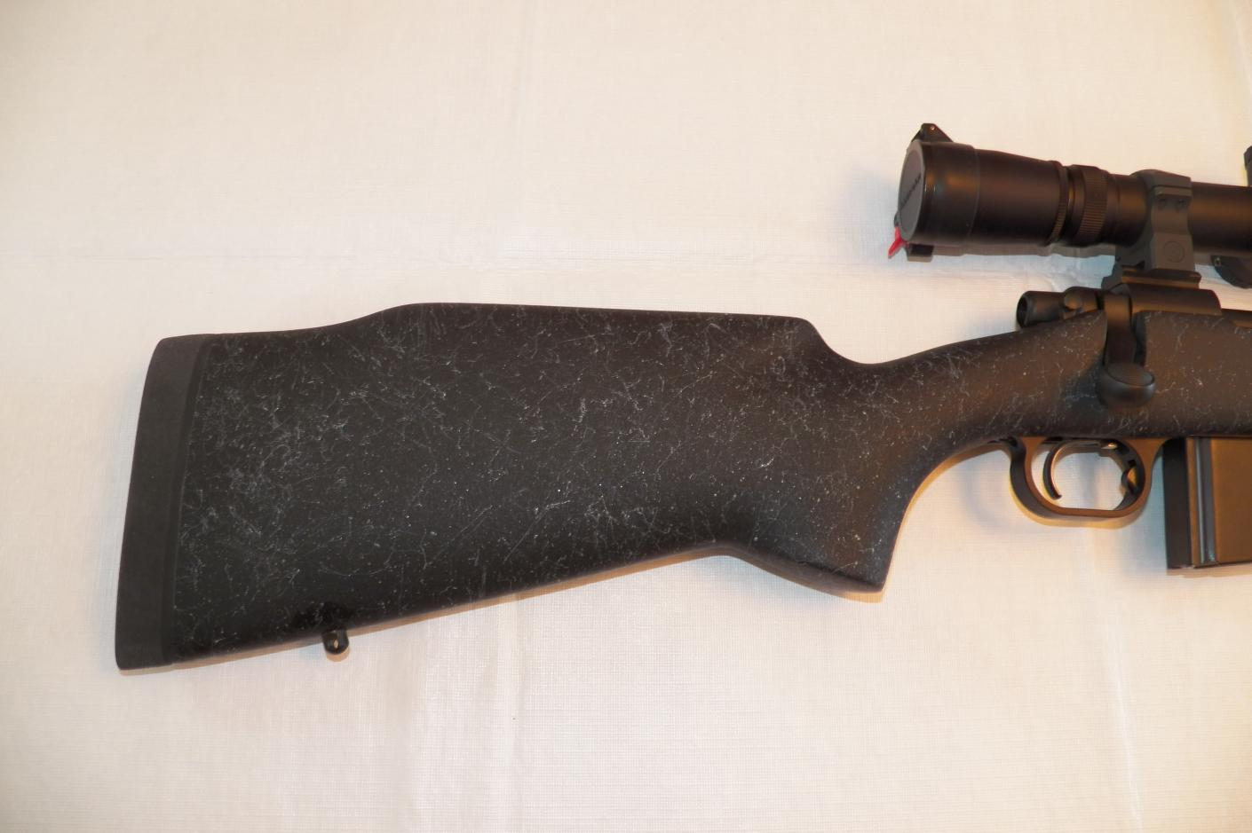

Mine is not nearly as fancy as some in here, but it shoots better than I can. Still working on consistency, but it is at least a 3/4 MOA gun when I do my part. Too bad I can not find enough ammo to keep it fed unless I feed it cheap 147gr surplus. Remington 700 AAC in .308 in an HS Precision stock with a Mod-22 two stage trigger.

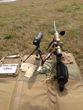

Specs:
Savage 10 SA (4.4 spacing) - AccuTrigger
- PTG fluted body (cerakoted in Graphite Black) and PTG milled 308 bolt head
- Bolt handle done by Phoenix Custom Rifles
Criterion Barrel 26" 260 Rem Match (longer freebore) Varmint Profile 1/8 twist
- JP Enterprise Bennie Cooley Muzzle Brake installed by Titan Weapons in Benbrook, TX)
- Barreled action Cerakoted in Graphite Black
XLR Chassis - Corvette Yellow (cerakoting done by Titan Weapons)
Vortex Viper PST 6-24x50 FFP MIL/MIL
Vortex rings (Seekins)
sorry for the crappy cell phone pics - it is raining outside and camera batteries are dead

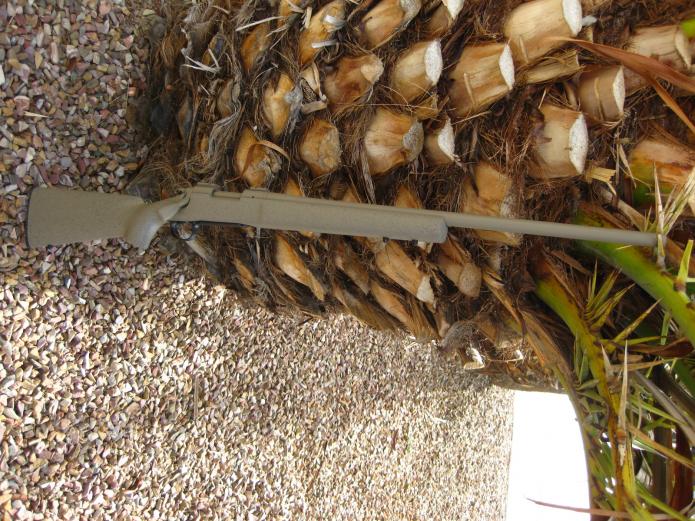

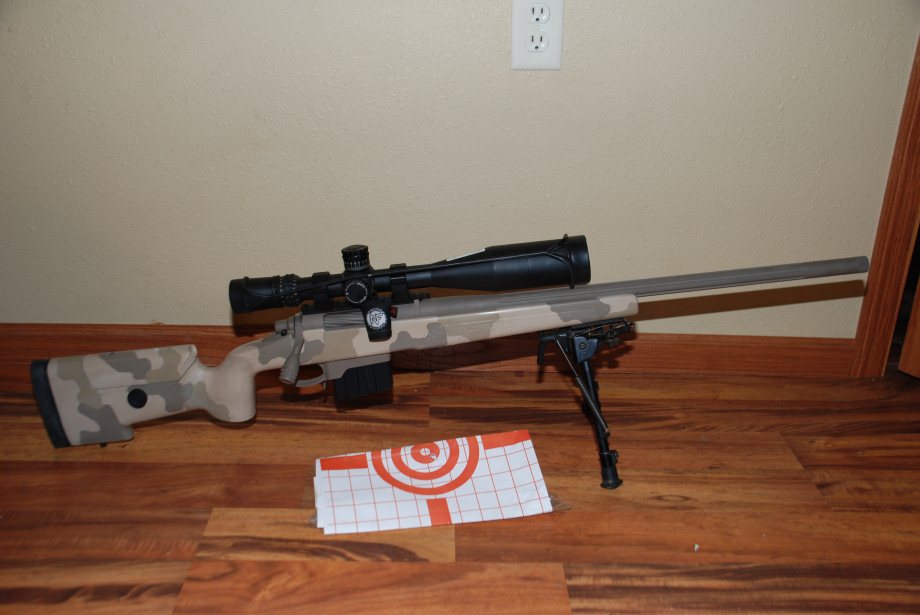

Zephyr - Remington 700 .300 WinMag with Bell and Carlson Medalist stock, Accurate Mag bottom metal conversion, Timney trigger, bedded, lower height rings next and heavy barrel
Full size image link
For some reason the paint insists on photgraphing as blue tints but it is actually tans/greens/browns

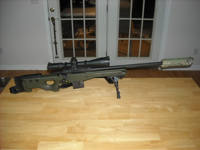

I have already posted my rifle on here, but I recently changed the skins from FDE to O.D. green. I have also put on a new scope. The rifle is a custom Remington 700 built by Alberta Tactical Rifles out of Calgary Alberta. It sits in an AI chassis and has a Rock Creek barrel chambered in 308. The scope is a Sightron SIII 8-32x56.
