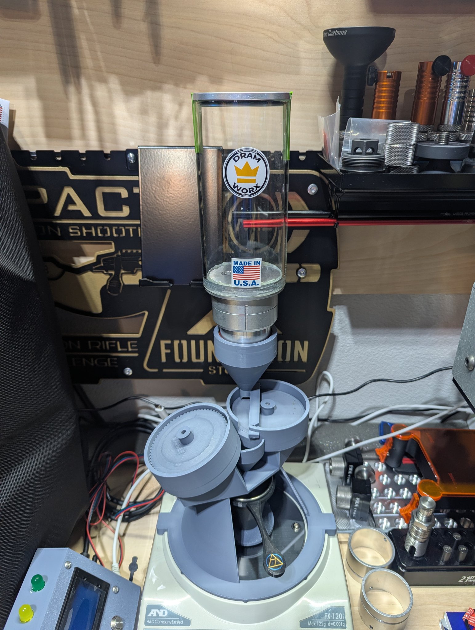

Here's 107gr of Retumbo, shows big charges, with chunky kernels, and the feed tube.
Here's 86gr of Retumbo, my standard 300 Norma load, showing the control box, status lights, autozero, and a bulk/trickle cycle.
Here's a more typical load for most people, 32gr of H4350. Shows several throws, single kernel dispensing, and even an over.
And one more, a slomo of the system in operation.
Here's what I think so far: It's pretty damn good. Still a few things they are working out, but so far they have been really cool about listening to feedback and making changes. Over the course of a few loading sessions of both 6 creed and 300 Norma, I'm sitting at about 94% successful throw at -0 +1kernel tolerance. Average time for a 6 creed throw at 39gr is about 8 seconds, 86gr 300 Norma throw is about 11 seconds.

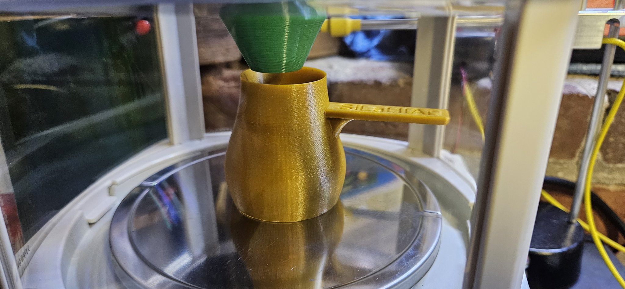

It comes with a platen, and I believe will be coming with a glass shot glass at retail. I'm using a steel shotglass I found on amazon and a 3d printed handle I found for it.What are you using for a pan/cup? Does it come with a cup with a handle or is it just like a shot glass?

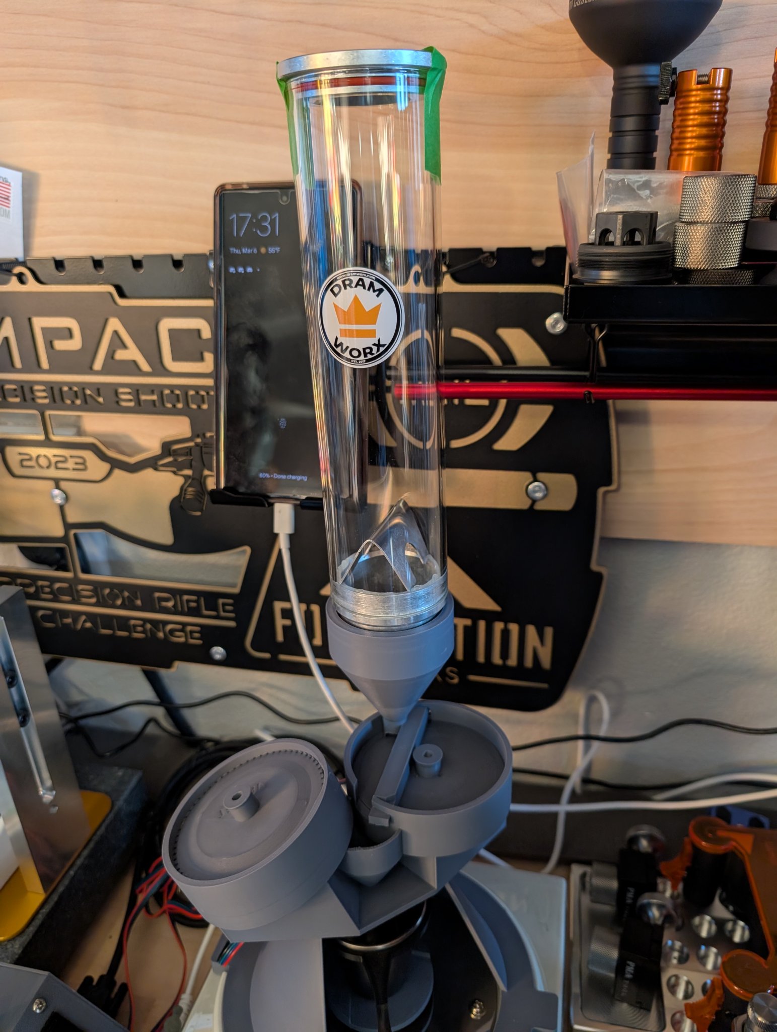

Why does the disk on the trickler in this picture look so close to the top of the trickler part? Looks like it wouldn’t hold much powder or it would spill?It's a work in progress still but we are working it out...
This will be an additional option... Not standard.
I put the spare disc on top of the main one.Why does the disk on the trickler in this picture look so close to the top of the trickler part? Looks like it wouldn’t hold much powder or it would spill?
