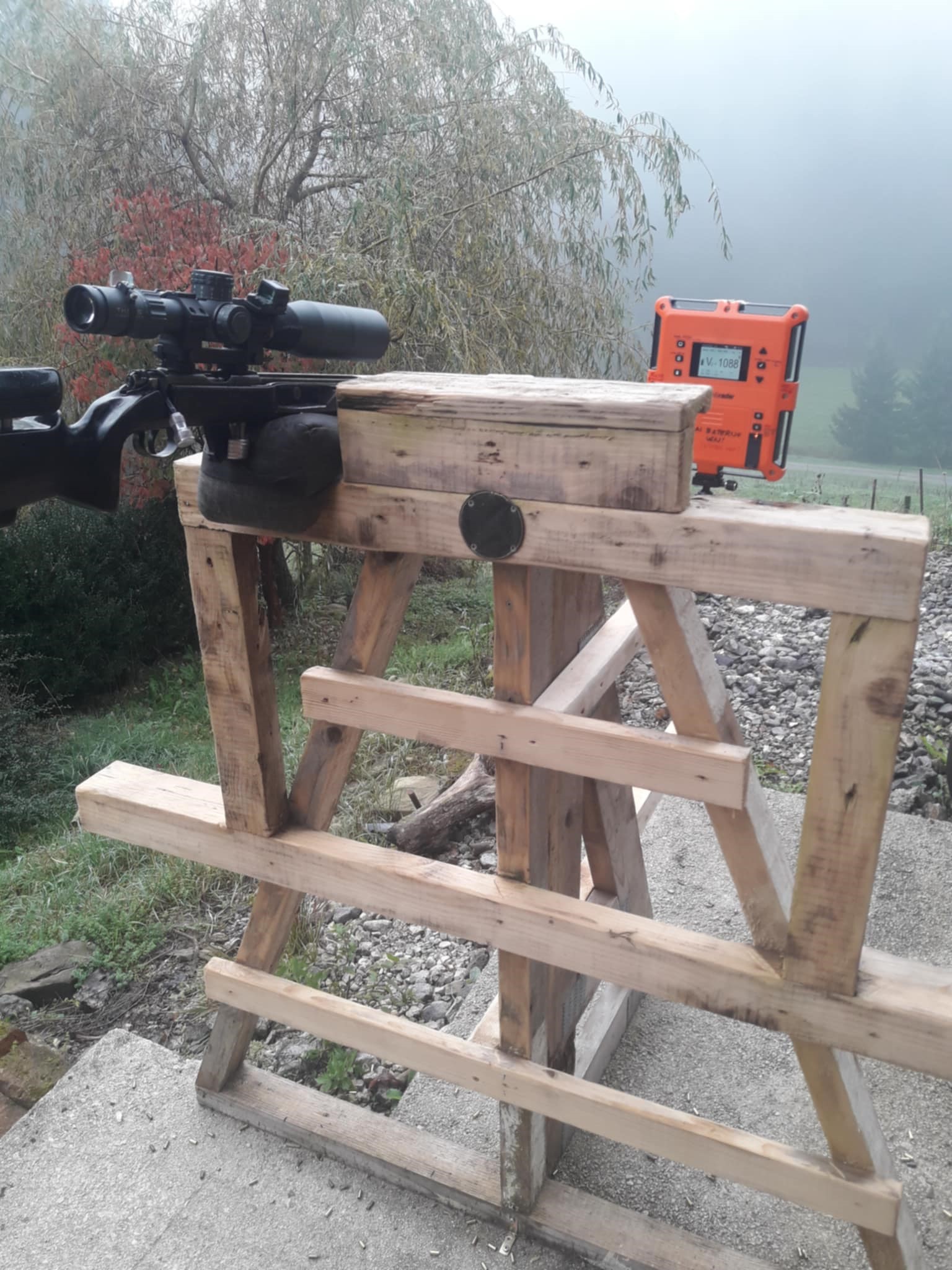

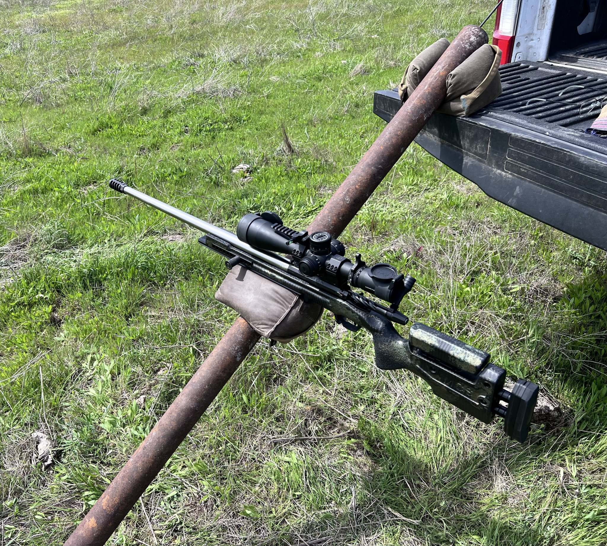

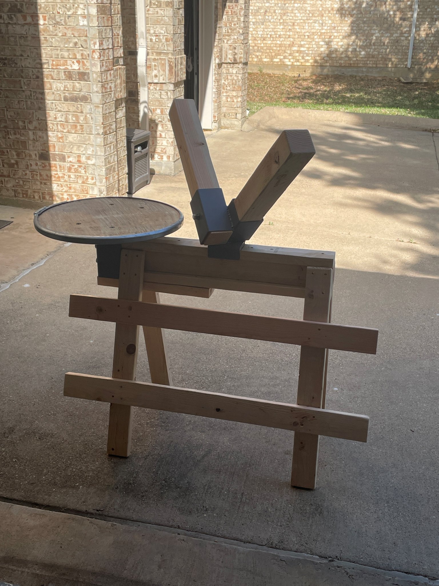

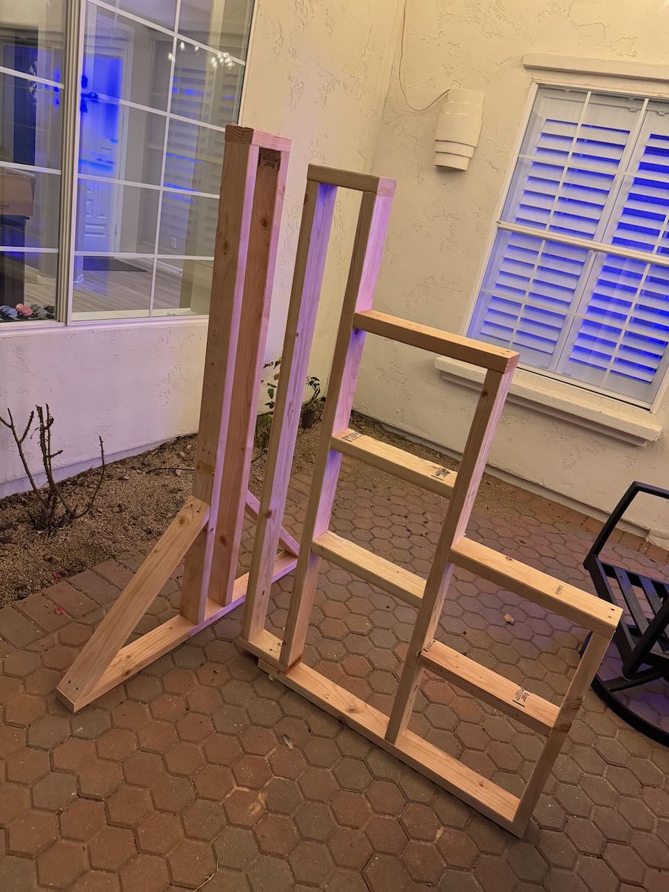

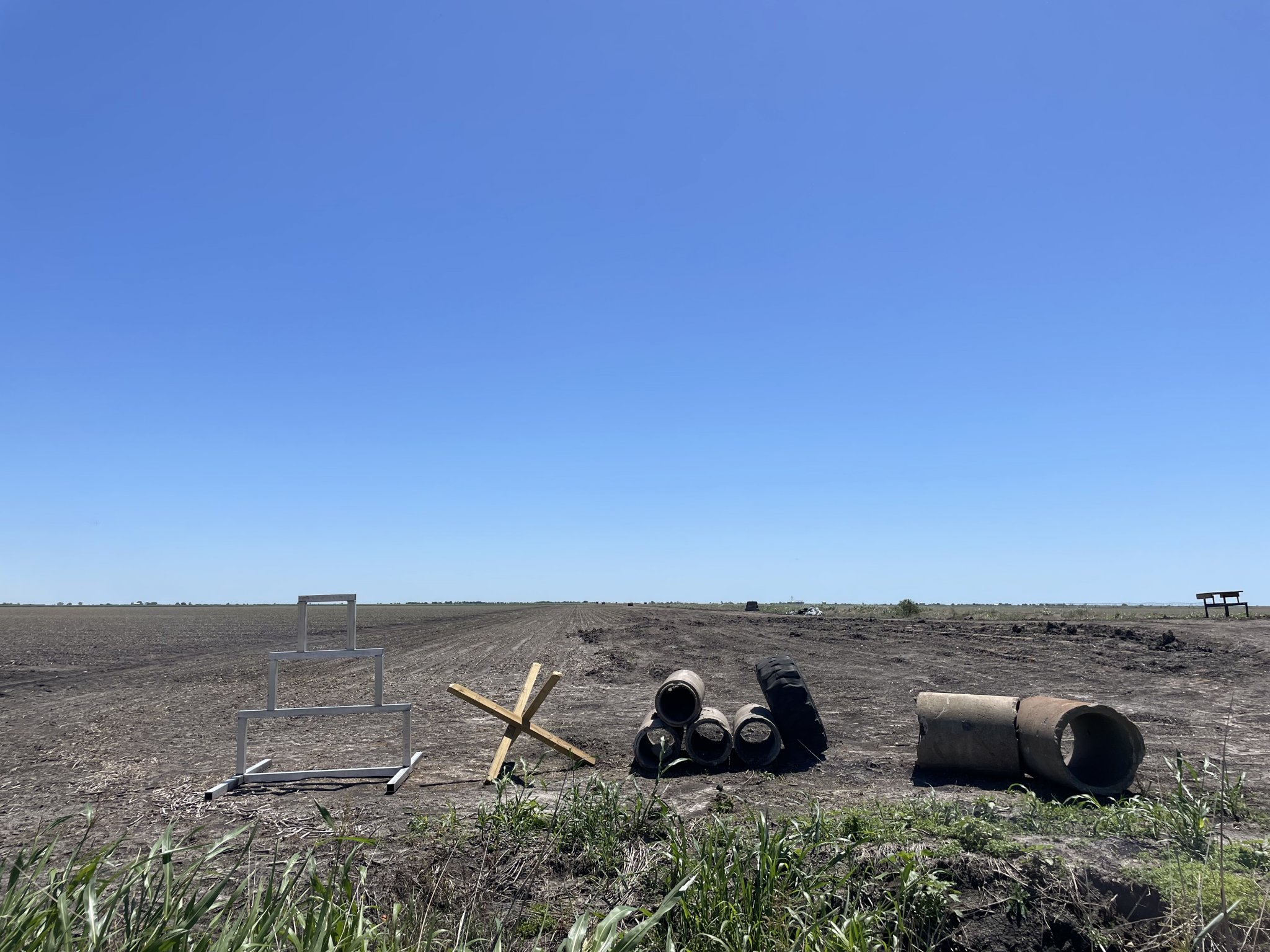

Started out with this. Using a metal target stand. Way too wobbly to be of any use

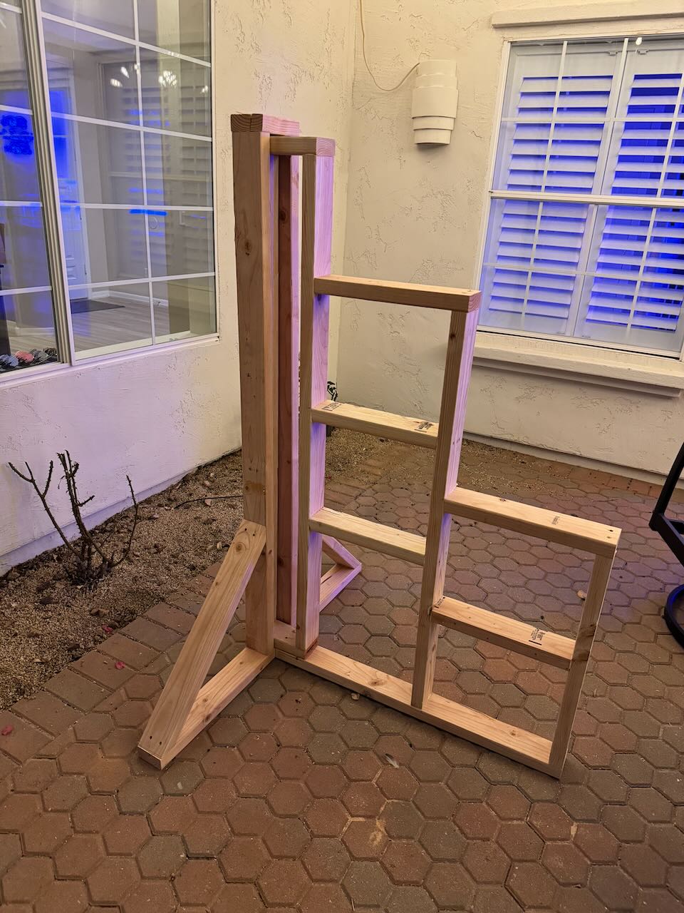

So, I rebuilt to this. Unfortunately the interior props are too small to fit a rifle with a scope. And the top is too tall for a standard sized bench. But at least it works

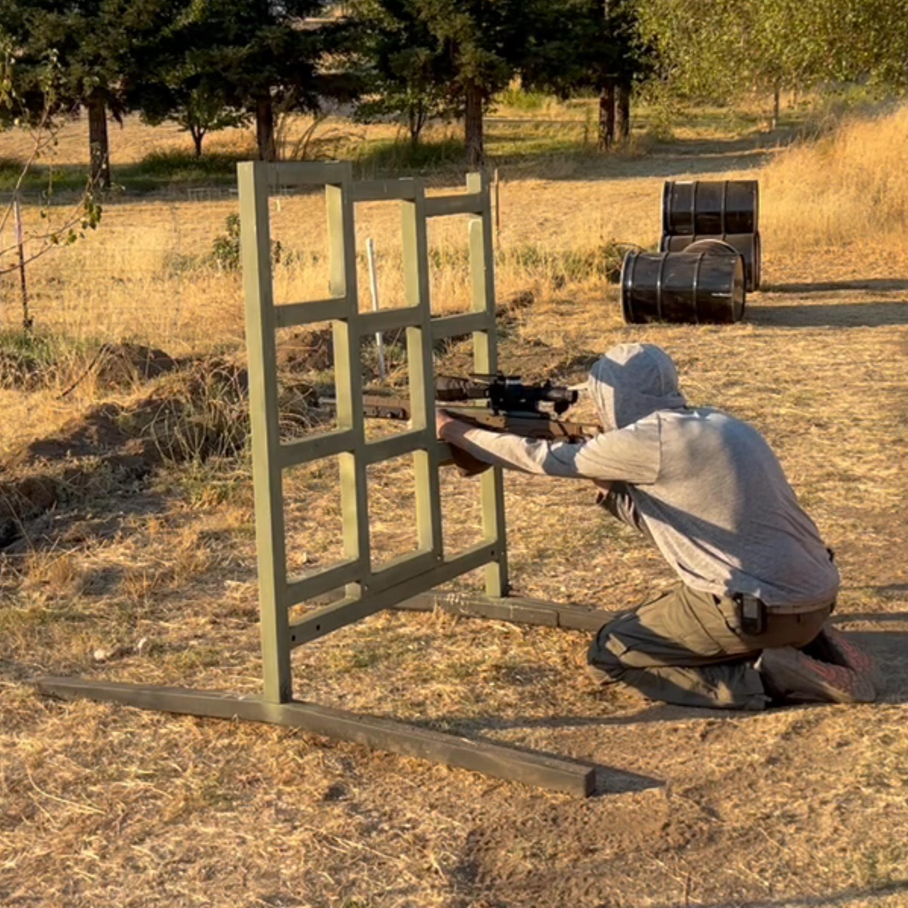

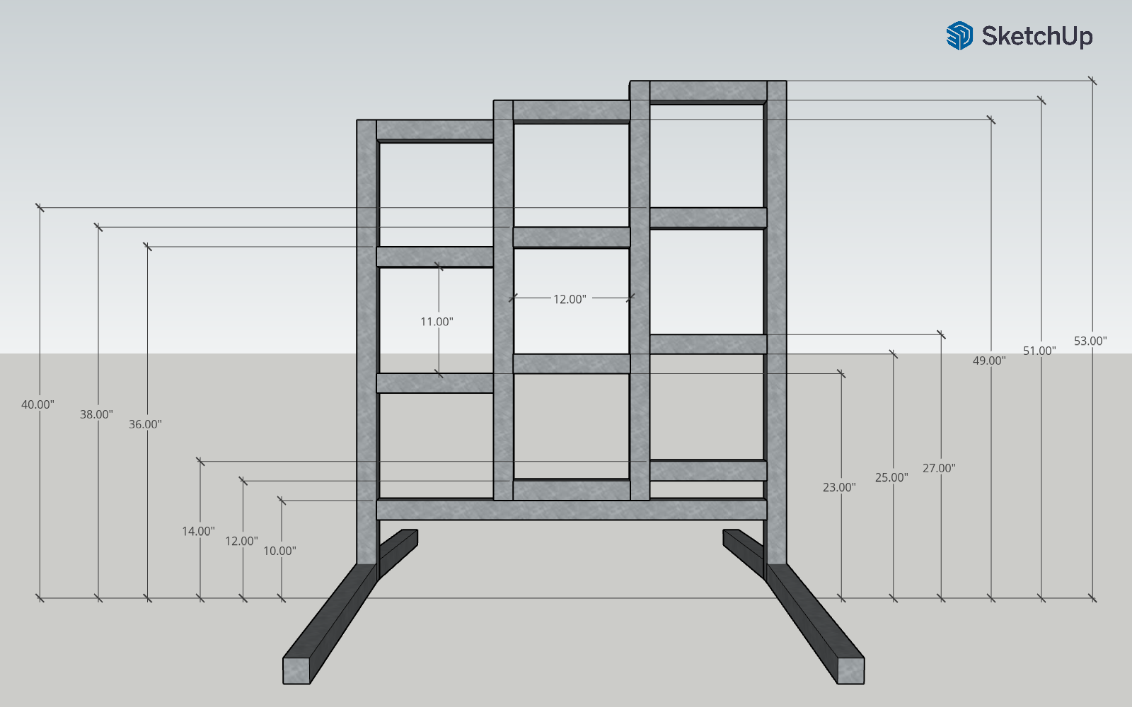

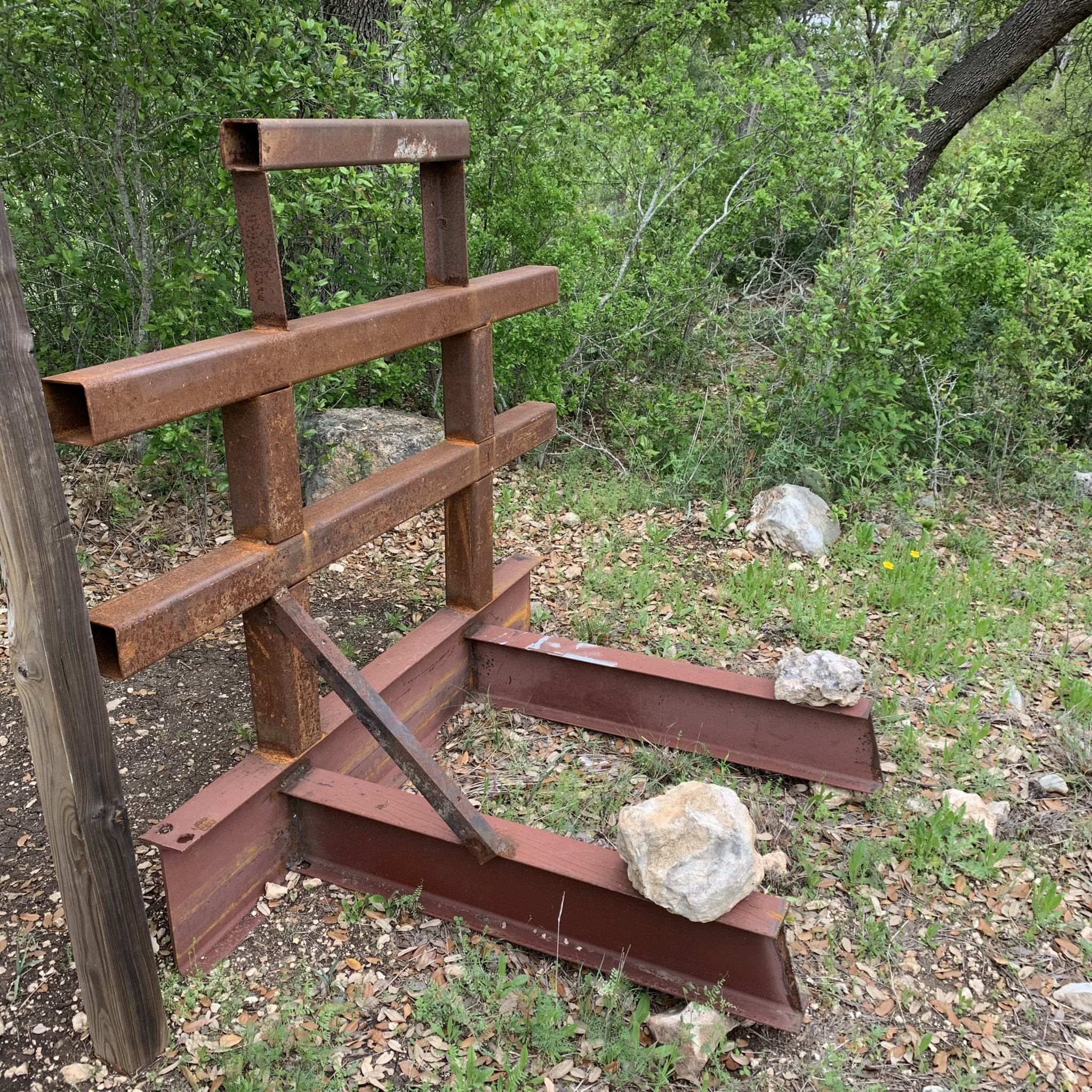

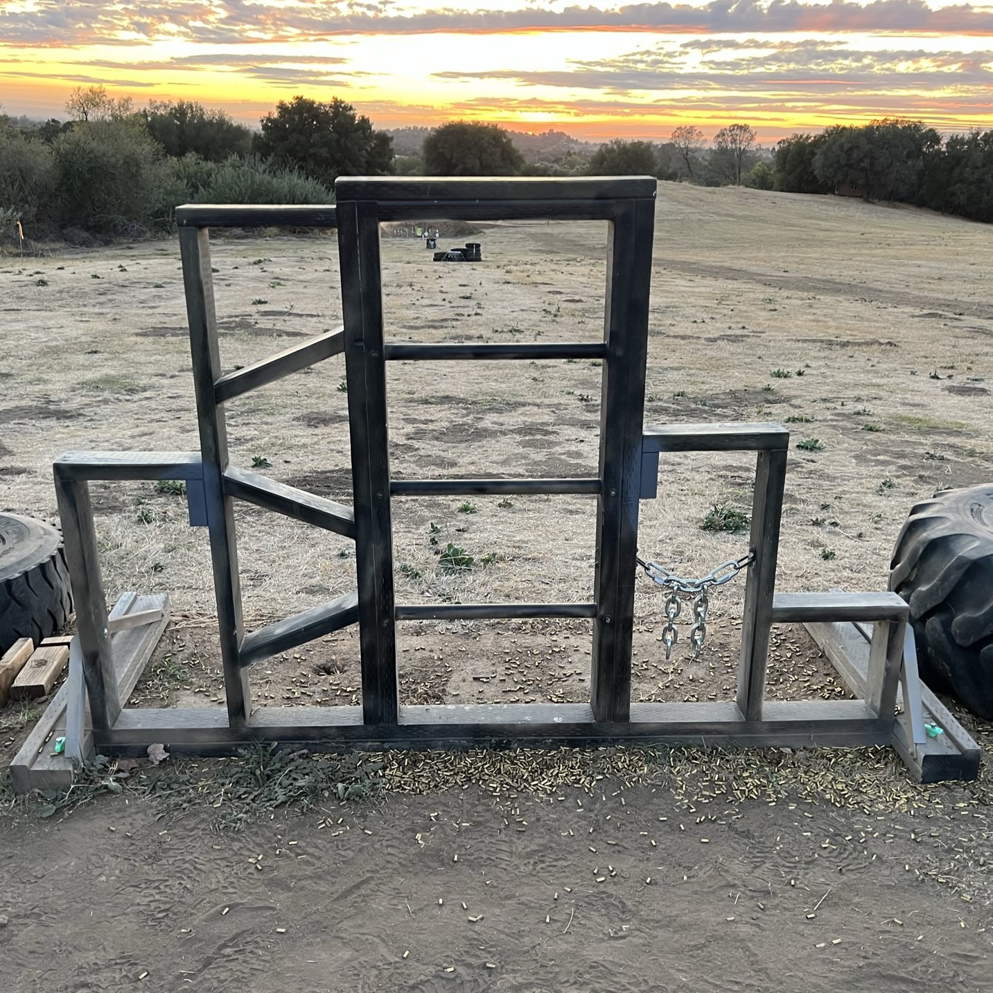

Just picked up some 4x4x.25 steel tube to start fabbing a barricade. What I can't decide is the base. I want this to be very solid and stable while also being outside on the ground. Ideally I don't want a piece of 4x4 where the shooter may kneel. Thinking of doing 2 steets of 24x36x1/8" on each end with 1ft on shooter side and 2 ft on target side and welding to bottoms. Could even drill holes and drive stakes through. Any other ideas? It's going to weigh about 400lbs all said and done.

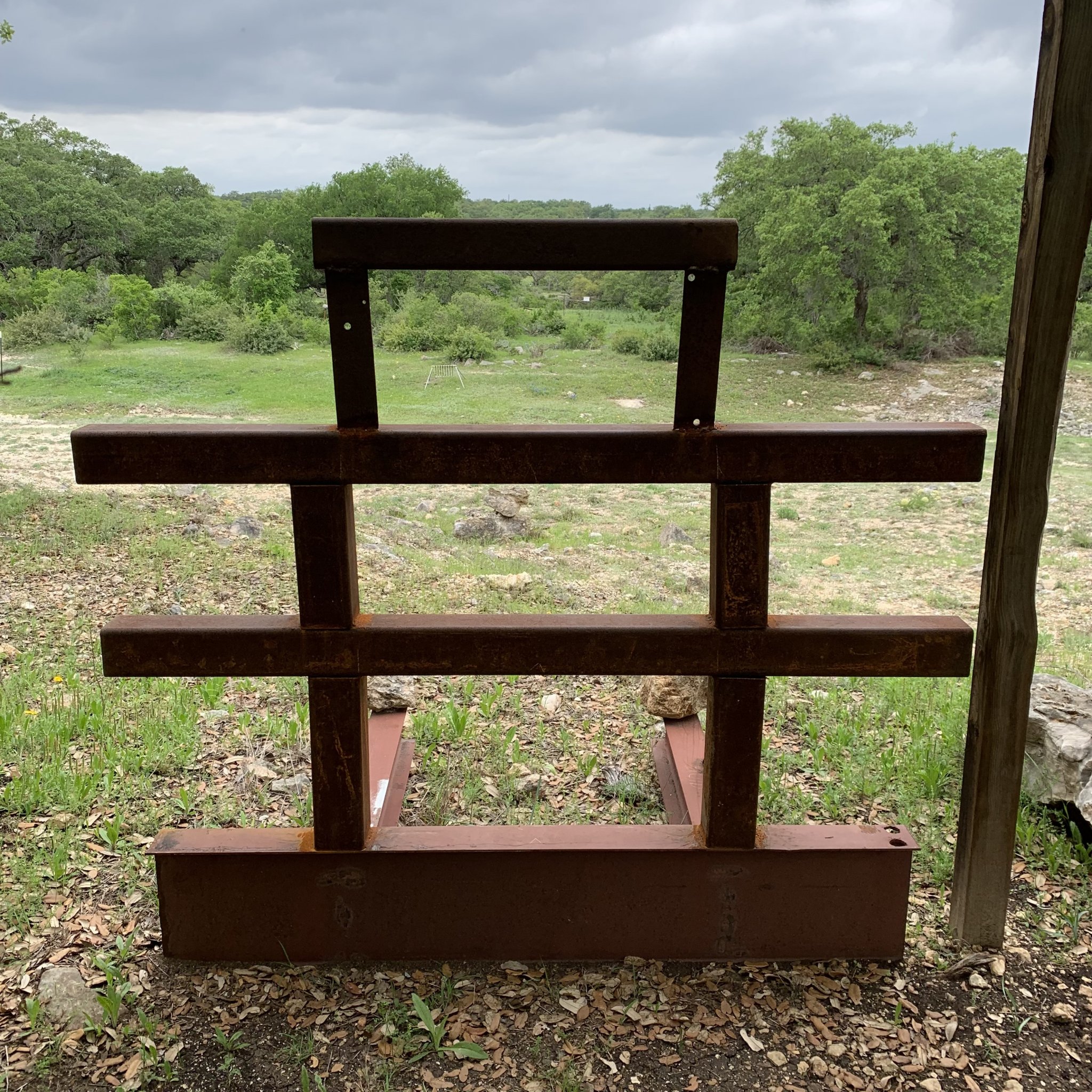

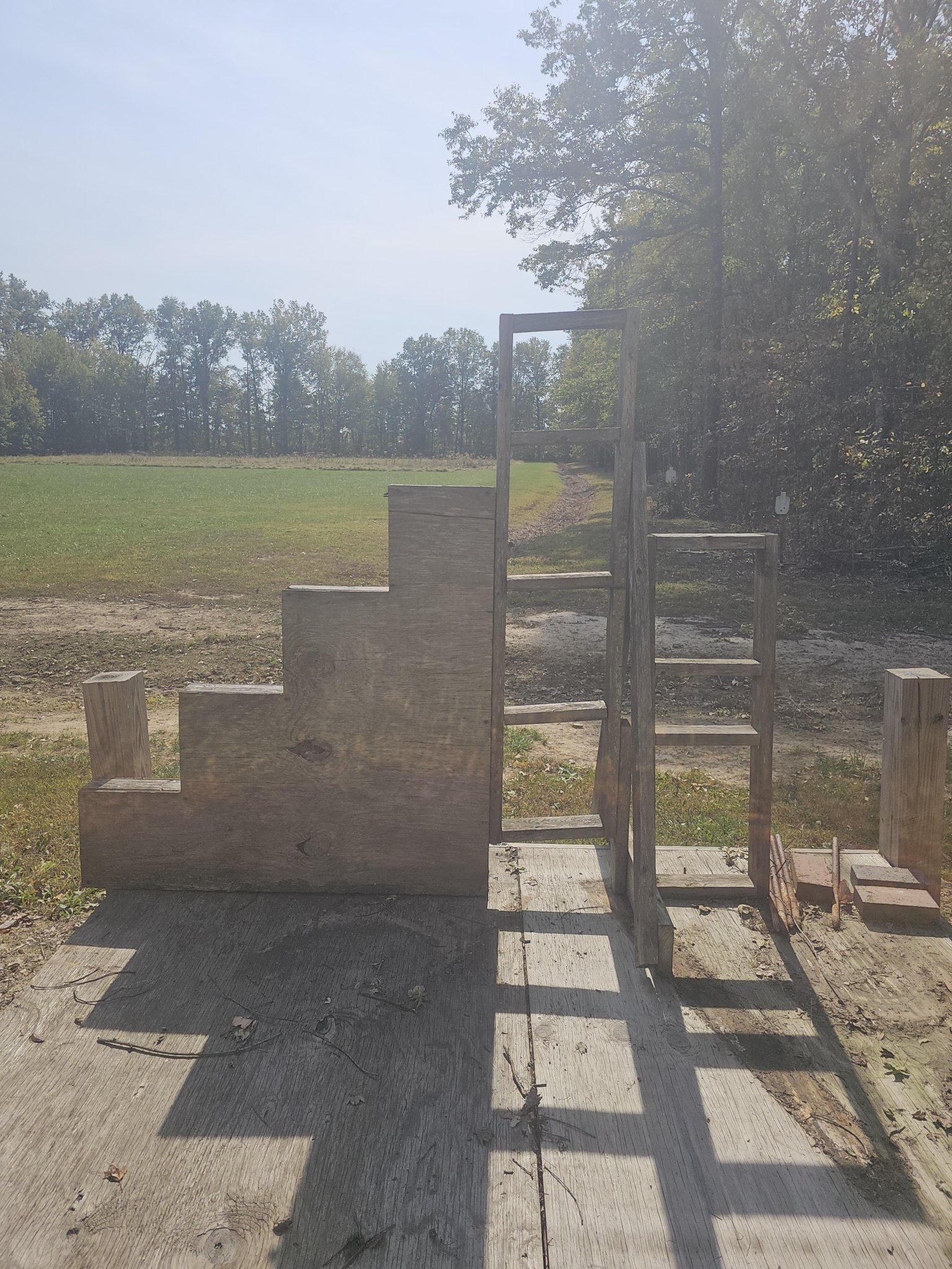

I used some i beams and just had them stick out the front so it’s entirely clear in the shooters side and it serves as a counter balance as well so it doesn’t tilt back towards the shooter without putting some intentional effort into doing so. One little cross brace between the two stiffened it up and took any wobble out.
Rocks are just on it for the hell of it, they don’t do anything

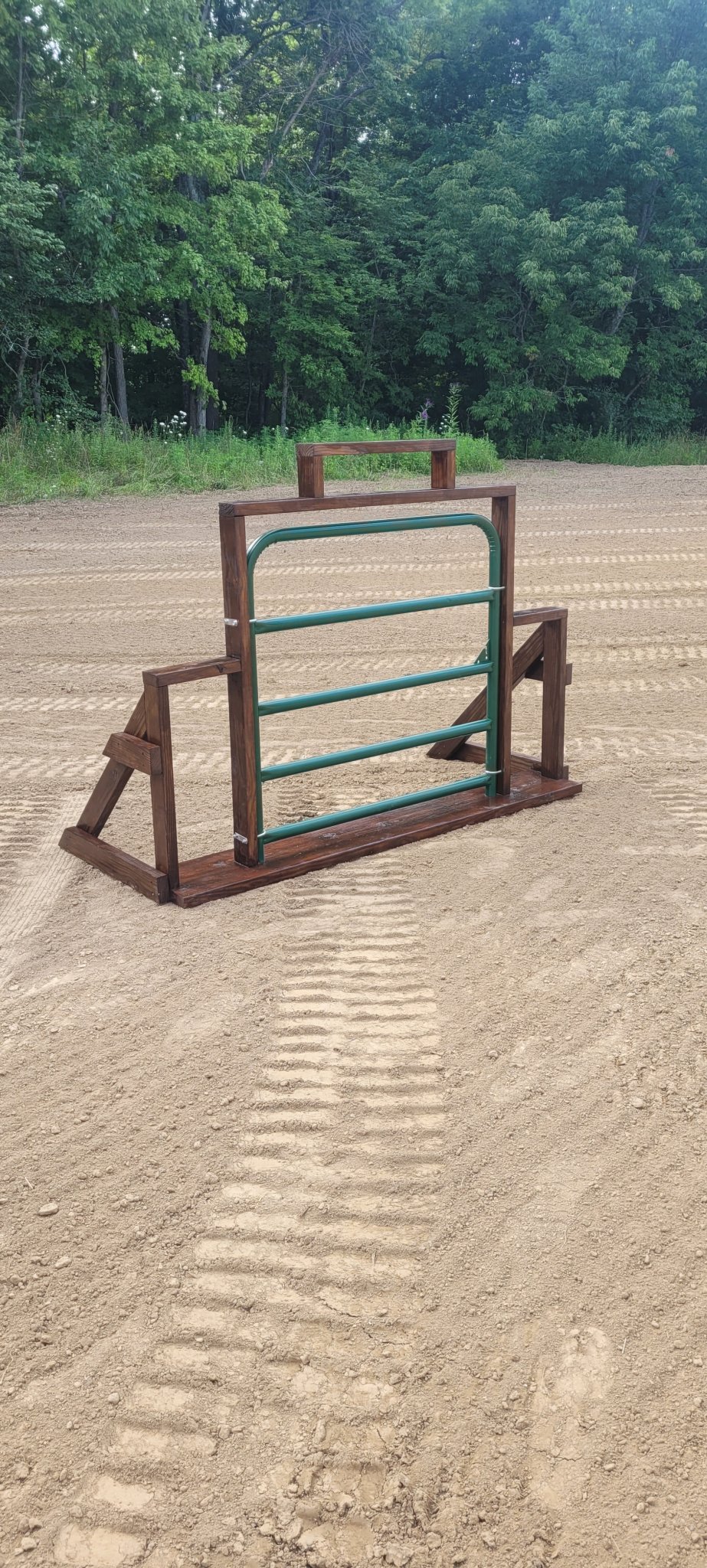

For example, Something like a cattle gate can be welded solid and concreted into the ground, and its still not going to be like shooting prone. Shooter skill will determine how stable someone can shoot off of it. Now take that same prop and let it swing free now you introduced unnecessary wobble and instability that even the best shooter will not be able to over come without something like rear tripod. Not saying rear tripod stages are bad , but there is no reason the prop needs to be wobbly/unstable.

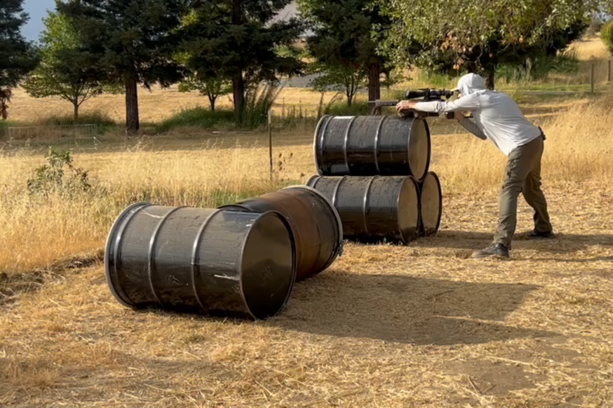

Tires are great to shoot off of but they do present a problem. When shooting off tires that had been in the sun for several years, a very nice and favorite vest as well as the pants I was wearing were covered with black worn rubber. They do get old and consideration should be given to replacing them.
(I know, at times we all get in the dirt and mud when shooting matches and getting down and dirty is fun, but covered in black junk, maybe not so much fun.)

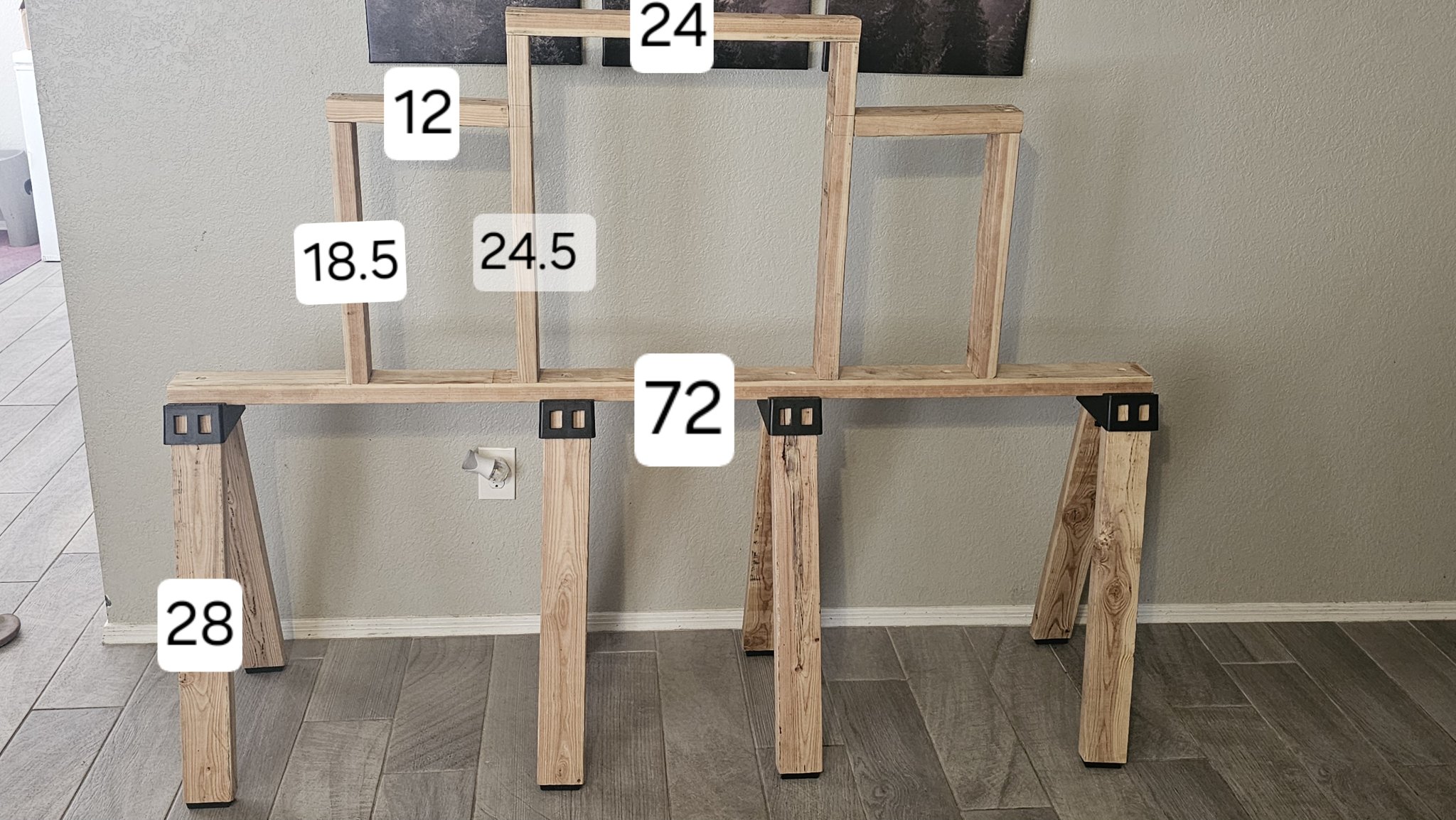

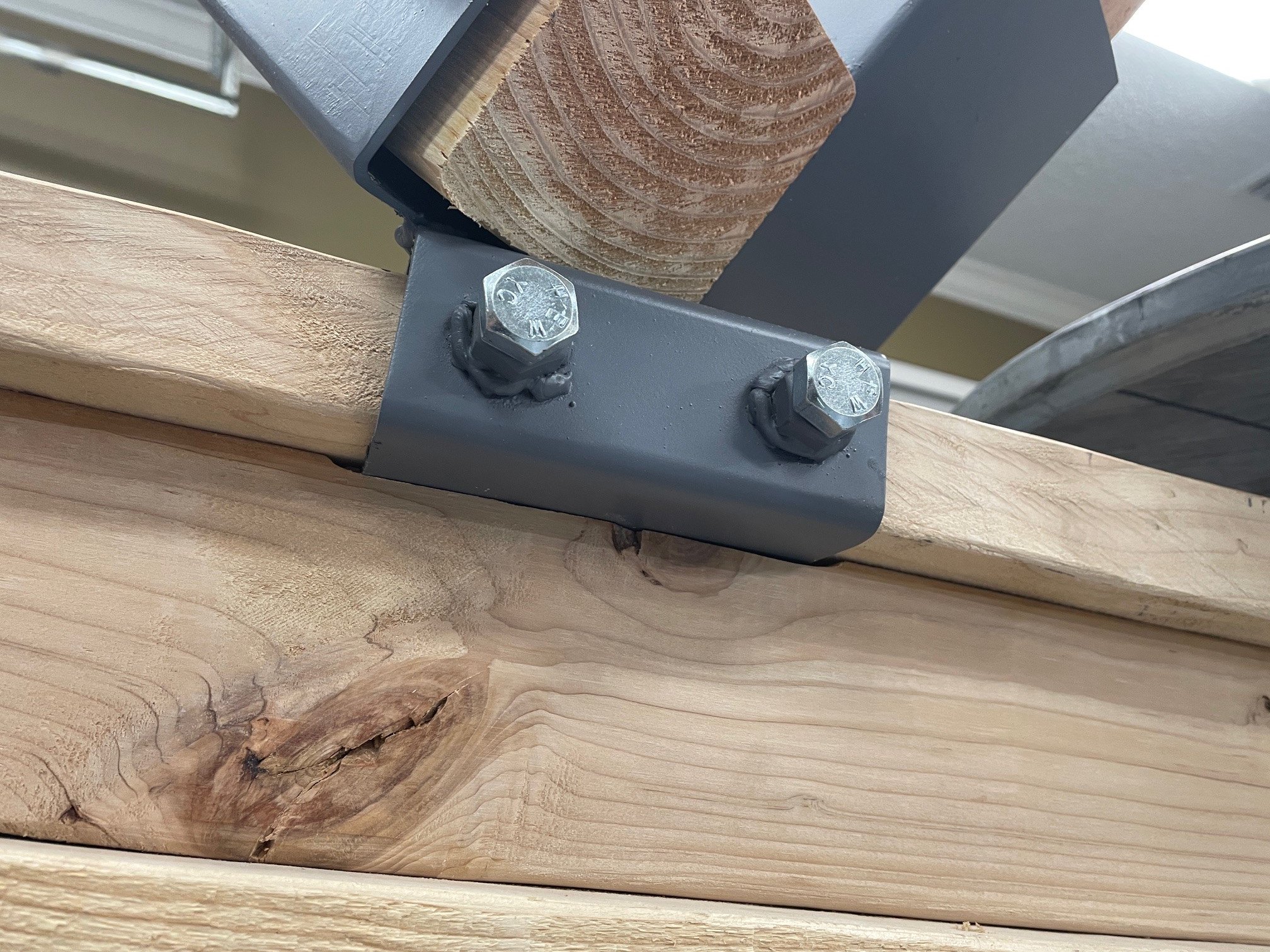

Hopefully, this helps someone else get a regulation, sturdy, transportable (truck bed), PRS Skills barricade to practice with.
NOTE: I'm a shite carpenter, if you see a way to improve, have at it.
2024 PRS Rules - Skills Barricade dimensions p.31
TOOLS
Tape measure/ruler
Compound Miter Saw (OR Circular Saw with guide OR Hand saw)
Square
Drill
Drill bit(s) of choice for wood screws (e.g phillips, torx, square, etc)
5/16" drill bit for leg bracket bolts
Spade bit(s) (for countersinking screw heads)
MATERIALS
QTY: 02 - Set PowerTec sawhorse leg brackets (4 total)
QTY: 03 - Wood-of-choice 2"x4"x14'
QTY: 08 - 3"x1.5"x0.6" rubber feet
QTY: 16 - #14 1" wood screws (for rubber feet)
QTY: 30 - #16 3" wood screws (for joints)
CUT DIMENSIONS
*** IN PHOTO****
Legs - 28" (15° cut for feet)
Main Cross member - 72"
Outside vertical supports - 18.5"
Inside vertical supports - 24.5"
Shooting position cross member - 12"
Top cross member - 24"

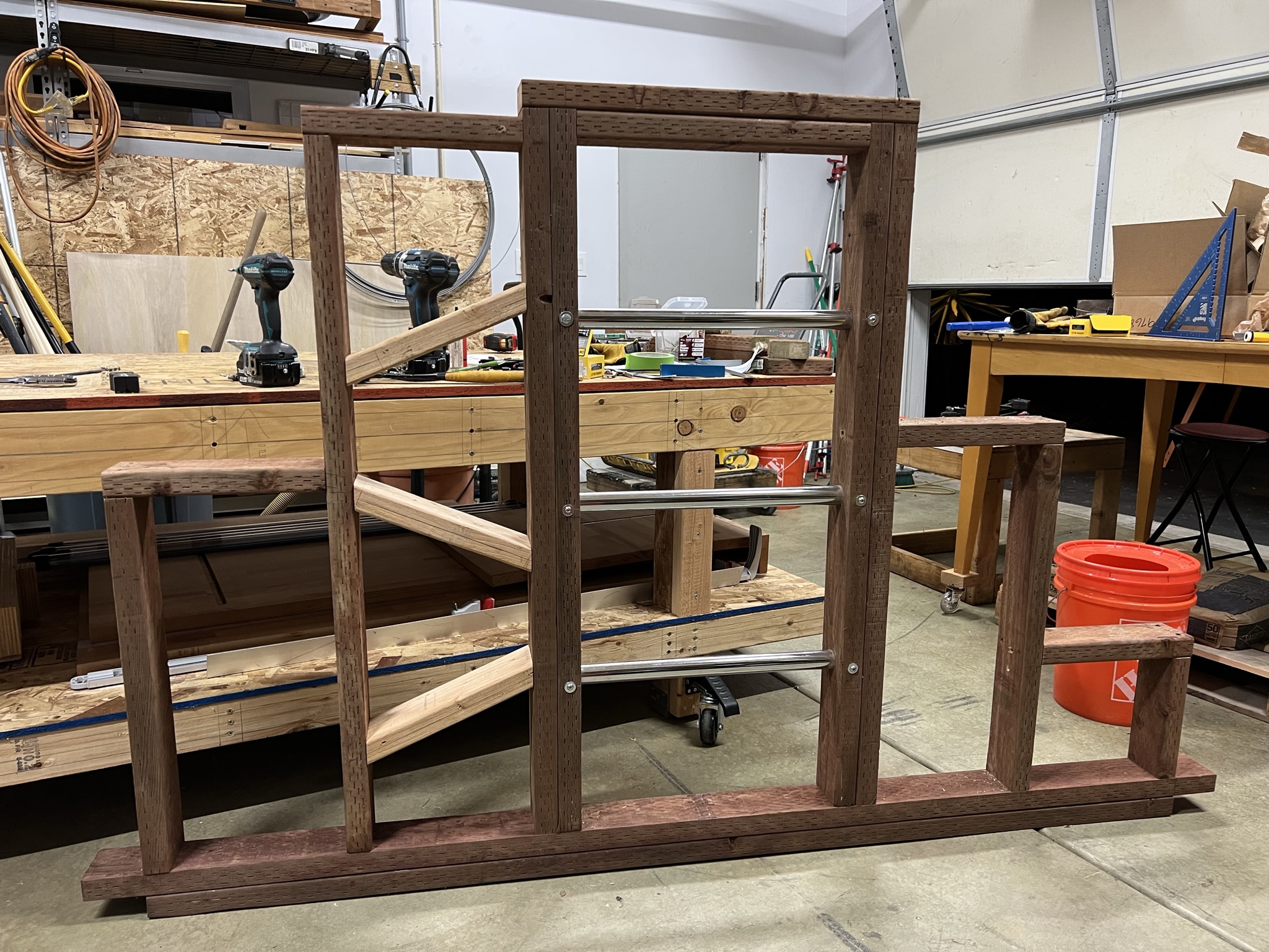

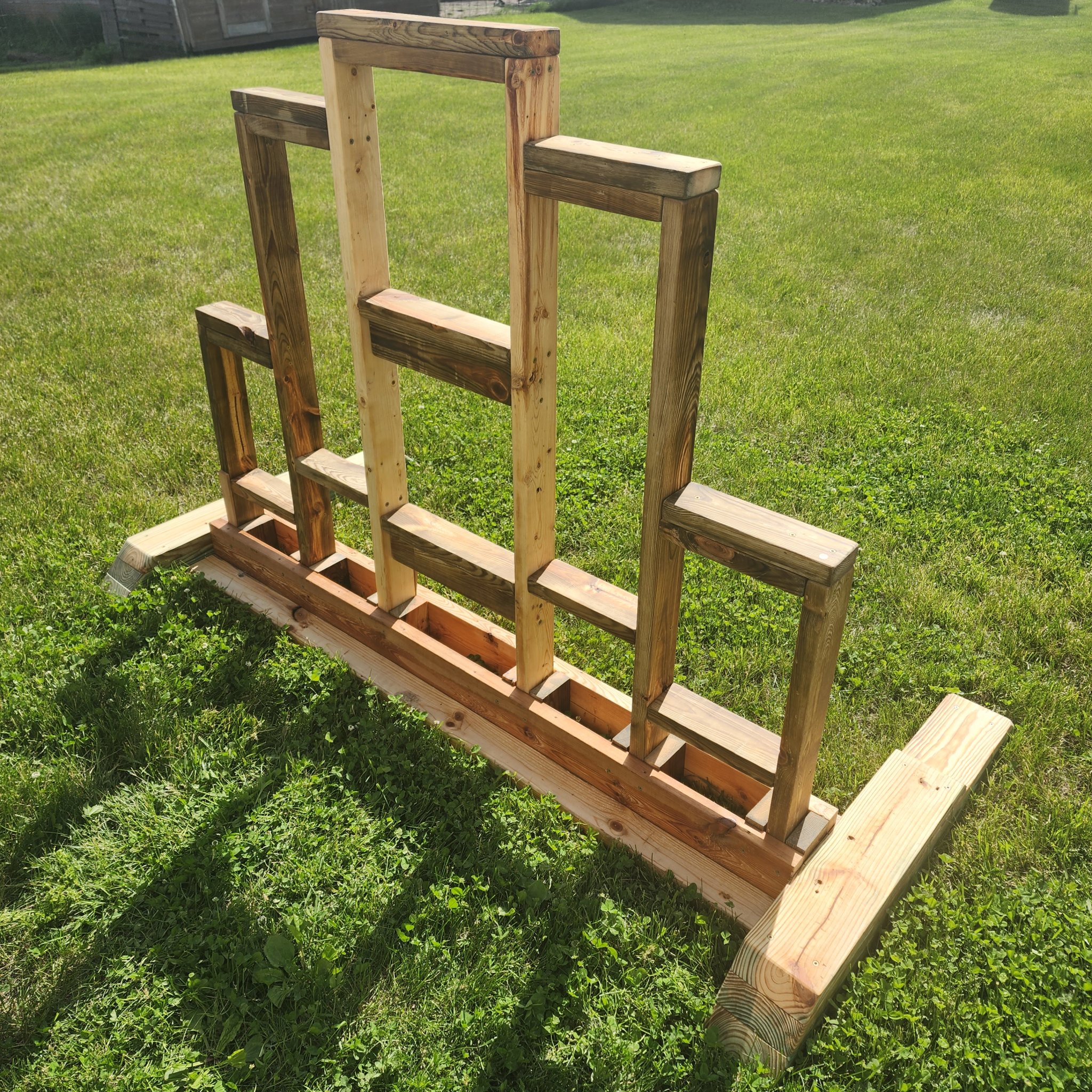

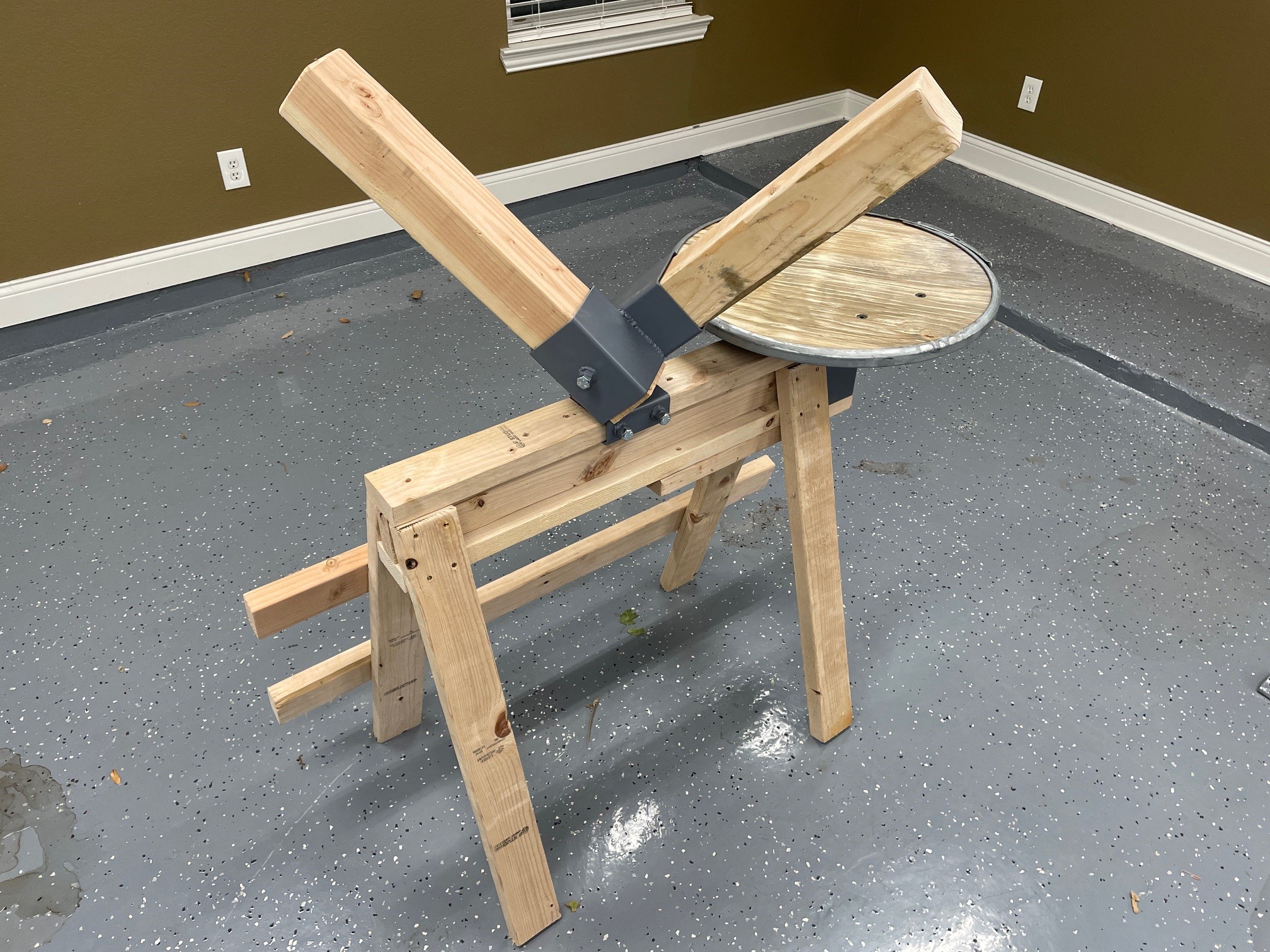

They don't have to be fancy. A few boards and you can build something solid to work basics and then just throw crap together to learn how to approach positions and actually use position building. Those pics above are mine that are still used. Can be used for pistol carbine or rifle. Keep it simple and build basics first.

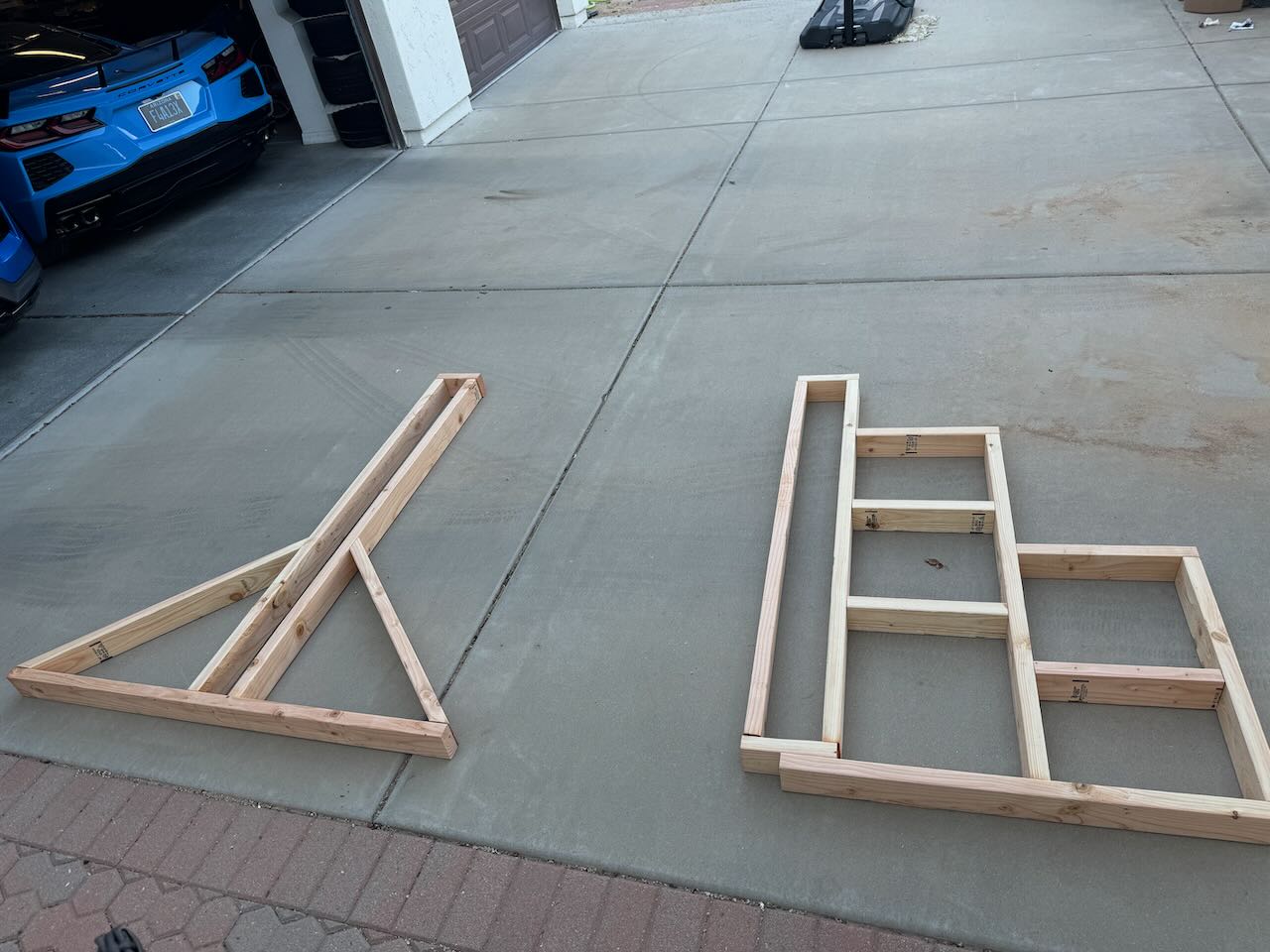

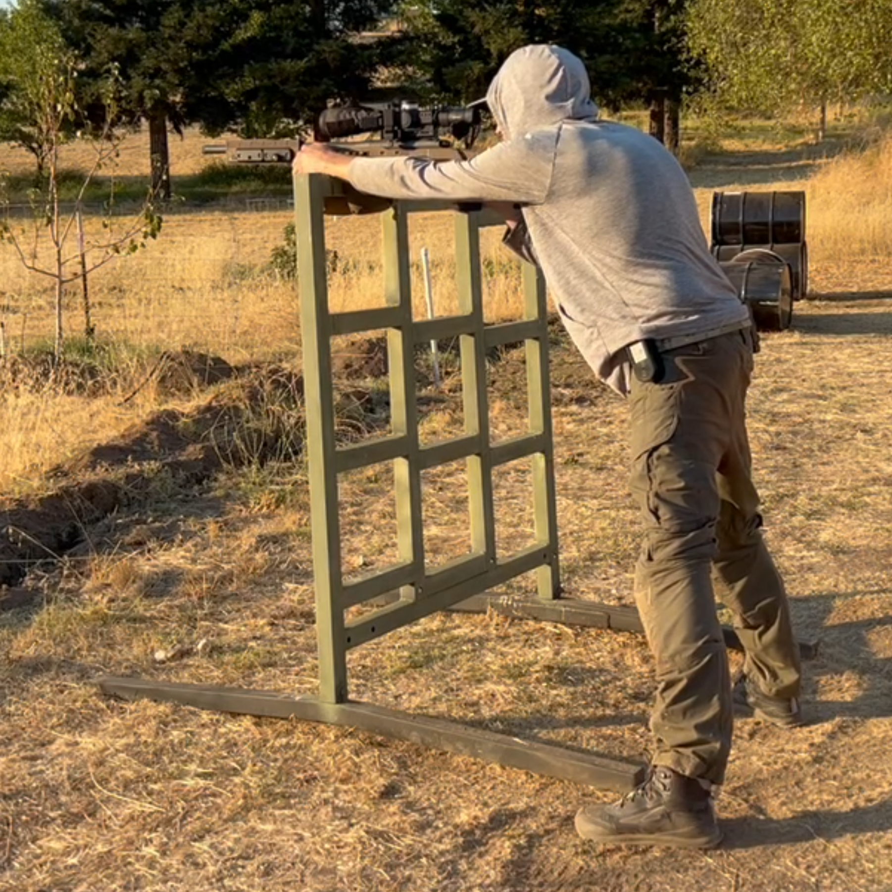

I built mine based on inspiration from this thread. I limited the width to what would fit in the back of the SUV, and I made the two pieces so they could lay flat in the back. I set the two ledge heights based on the PRS barricade heights, and then I added some random height cross pieces to work on other shooting heights.
Made mostly from pressure-treated 2x4s, round bars in the middle section are steel. All joints are glued and screwed. Wood primed and painted. Barricade is pinned to the ground with spikes. It was rock solid for about 6 months outside, after 12 months outside it was not rock solid, 18 months outside had a good amount of wobble. I like the layout of the prop, but recommend 4x4s or steel instead if 2x4s.
