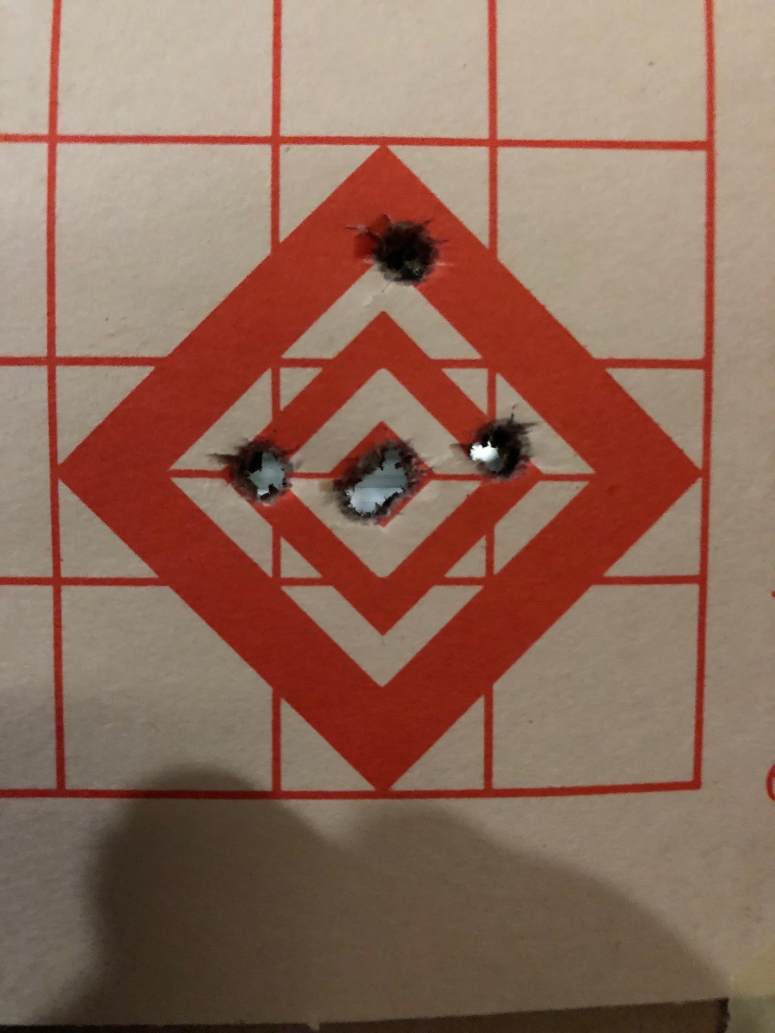

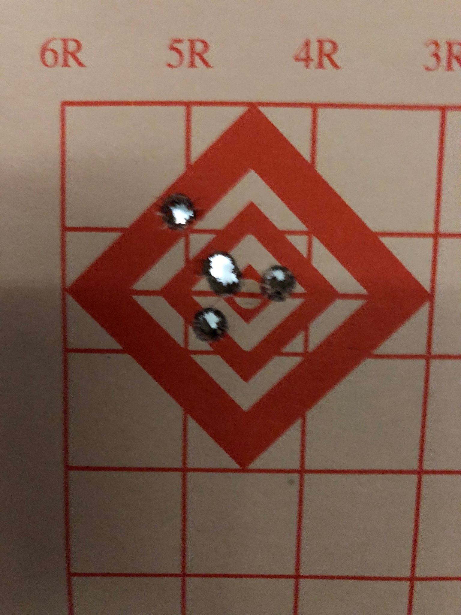

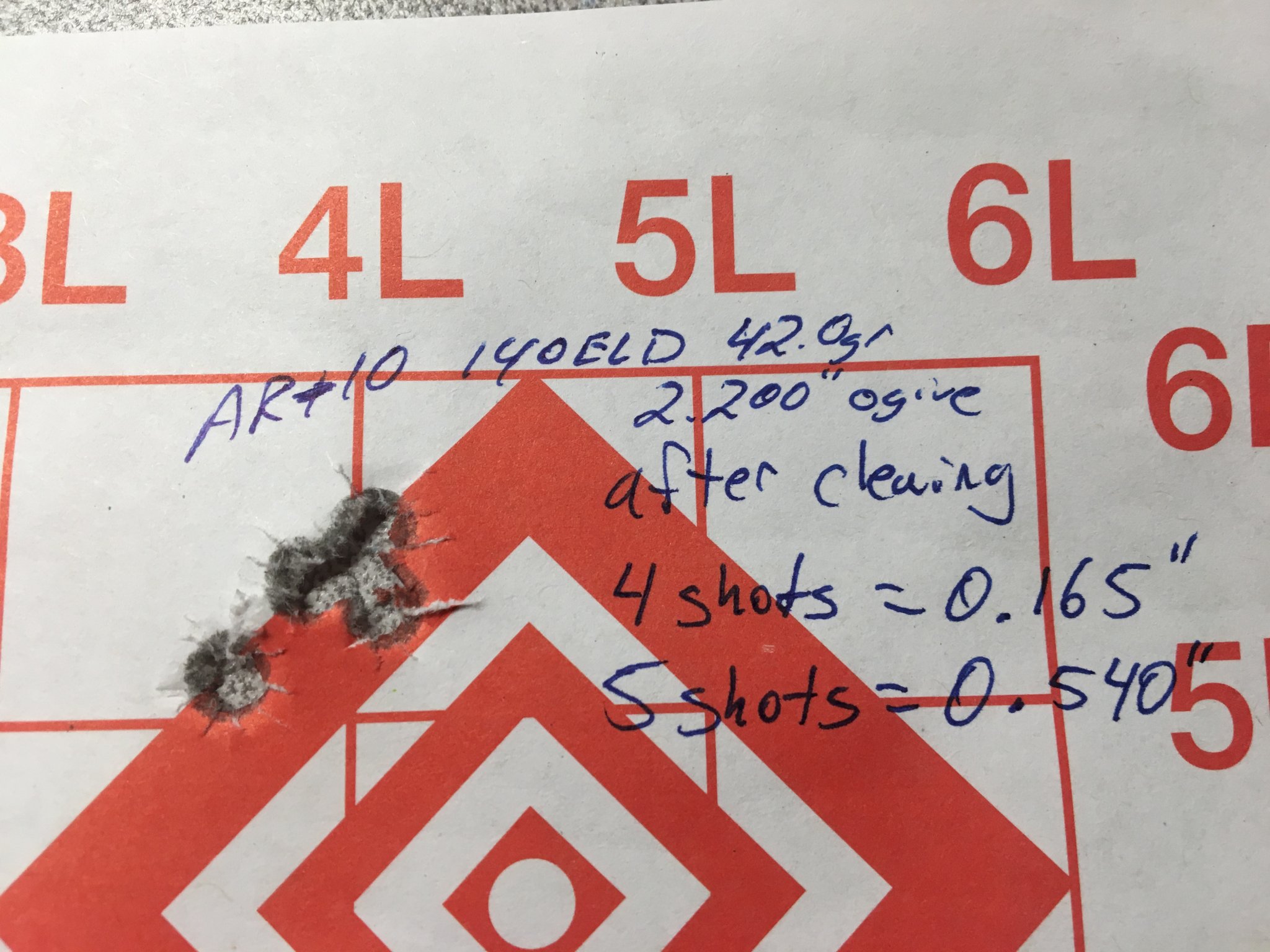

I went the same route and picked up the lower one month and the 20” upper another month from PSA. Mine actually shoot very well for my expectations form a semi auto. I mostly shoot bolt actions. It had a few hiccups on double feeding but ended up being a gas adjustment. Below is a target before and after trueing and glueing. As you can see there isn’t much difference so it seems to be a keeper for the most part. I bought my PSA because I witnessed two other PSA rifles shooting sub MOA groups at my range. The 12” groups you are getting are very odd. I would absolutely mount another optic and verify nothing is touching the barrel. I don’t think it is the ammo but try something else too.
After cleaning my barrel for the first time I’m now getting very surprising smaller groups. Anything is possible but definitely give the PSA a fair shake.

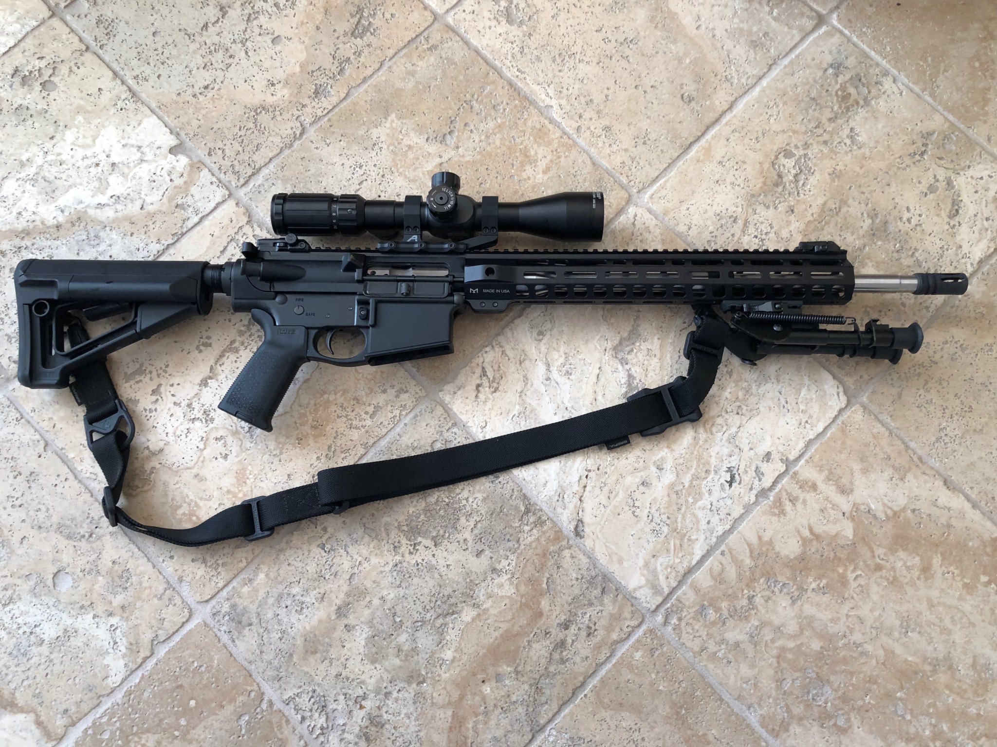

I was building THIS in 223 as a budget AR. I had gotten a cheapie, lightweight AR Stoner barrel (Midway USA) and was getting near 5" groups with bulk ammo.
7097149
Replaced the barrel and now getting 1-2" groups @ 100y with bulk ammo. Sometime "cheap" can be expensive. The barrel is not a good place to "save money."

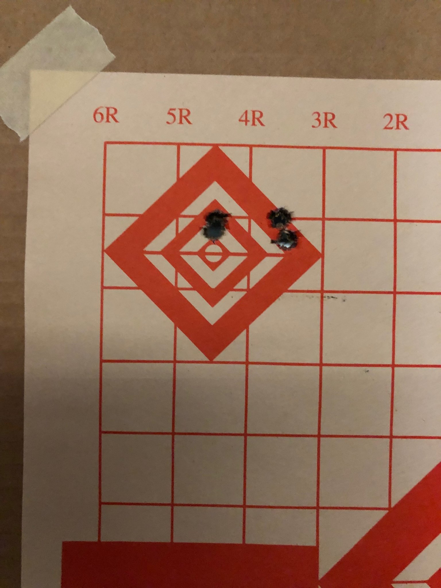

Went to take the scope off to swap out for another and noticed that there were scratch marks on the bottom. I guess that the ball area of the scope, under the turrets, was binding on the Leupold scope mount arm as it comes up into the ring. It's not flat but kind of diagonal and it was making contact enough to scratch and move the scope around on every shot is my guess. I moved it so it has more clearance and took it to the range and it was shooting 1/4 moa at 25yds. I did use some Aguila 150g BTHP's instead of the FMJ's but I really think that it was the scope binding in the mount. I'm just glad it wasn't anything super serious or expensive. When I can get back out to our big outdoor range I'll try it at farther distances. I appreciate all the help and suggestions!

View attachment 7096912View attachment 7096913I went the same route and picked up the lower one month and the 20” upper another month from PSA. Mine actually shoot very well for my expectations form a semi auto. I mostly shoot bolt actions. It had a few hiccups on double feeding but ended up being a gas adjustment. Below is a target before and after trueing and glueing. As you can see there isn’t much difference so it seems to be a keeper for the most part. I bought my PSA because I witnessed two other PSA rifles shooting sub MOA groups at my range. The 12” groups you are getting are very odd. I would absolutely mount another optic and verify nothing is touching the barrel. I don’t think it is the ammo but try something else too.
After cleaning my barrel for the first time I’m now getting very surprising smaller groups. Anything is possible but definitely give the PSA a fair shake. View attachment 7096912
awesome groups sir. i have the Gen 2 308 with 18 inch barrel. Its a 1 moa rifle with handloads mainly 165 soft points for hogs. Could you tell me what truing and gluing you did? Ty in advance
