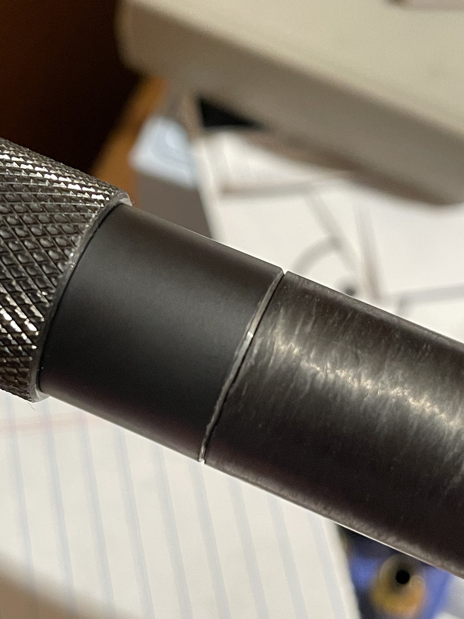

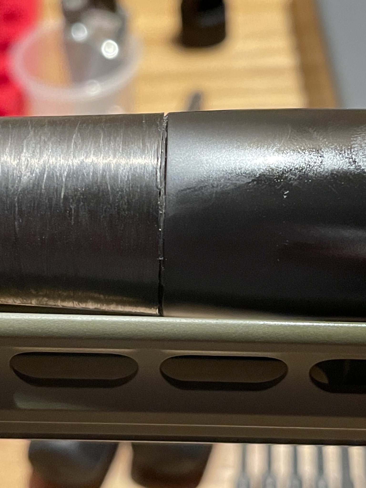

My Dudes,
if you cerakote your brand new Barty CF barrel, MAKE SURE your gunsmith knows that it needs to be low heat (170F or less).
Barty recommends short, low heat or even air dry.
Otherwise the CF will separate from the barrel (see pics)
Im not here to throw anyone under the bus, just want to make sure you guys dont have to go through what I did.
As usual, Bartlein took care of me and re-wrapped the barrel at no charge.
Anyone have recommendations for decent black rattle can paint? Cerakote was ground off in the process.
