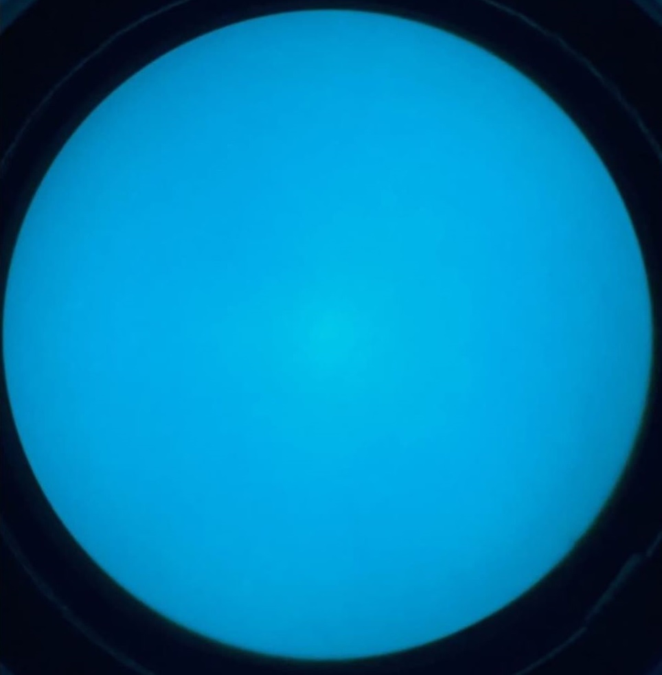

Spec sheet shows one blem .003-.006” in the outside of zone 3.
Here is a photo through the device. I think I saw the blem, dunno.

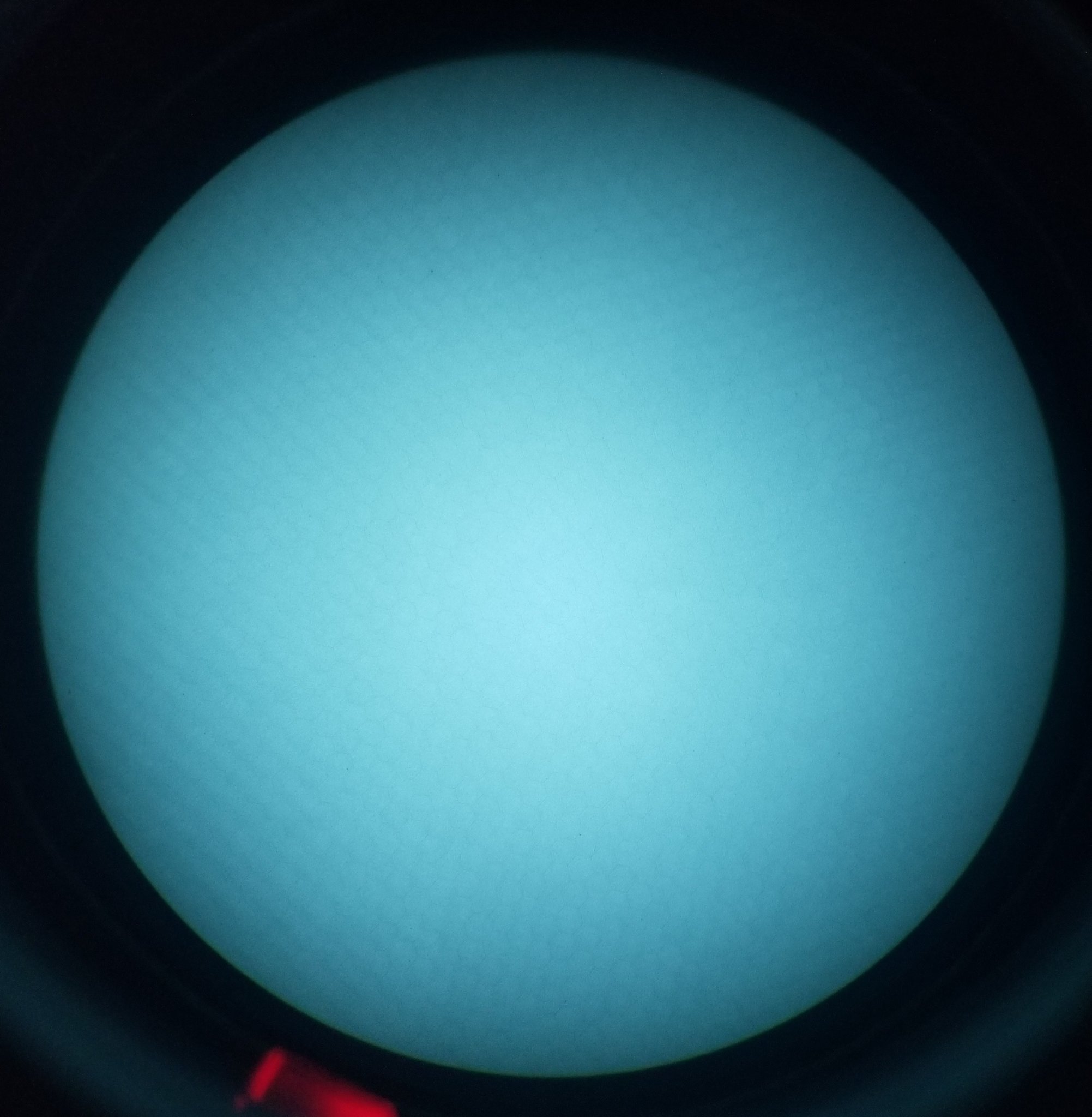

Well she arrived! Carson lenses, Vyper-C body, L3 UF WP 1701 tube. Thoughts/ideas/how is this?
photocathode 2856k: 2203
EBI: 0.1
Luminescence gain: 64,204
SNR: 34.1
Center Res: 64
Center Res (high light): 36
Halo: 0.7
Zone 1: Clean, Zone 2, Clean, Zone 3 (One) blem, 0.003-0.006
(X) Dark Spots </=0.003 are acceptable
oddly, there was only 1 blem on the L3 sheet, but I've found a couple, lol! Overall I'm very pleased as the only one I really notice is the one at around 8:30, and I'm assured it's okay and won't enlarge or anything bad/isn't a sign of air at the tube or anything funky.
Tonight was a very dark night. Cloud cover, no stars, and I live in the middle of nowhere (taken sometime after midnight with full cloud cover).
This thing soaks up light! It was EXTREMELY dark with no moon, no stars, no artificial light sources.
This was taken a bit earlier, around 10pm, when the clouds still had a bit more glow to them:
