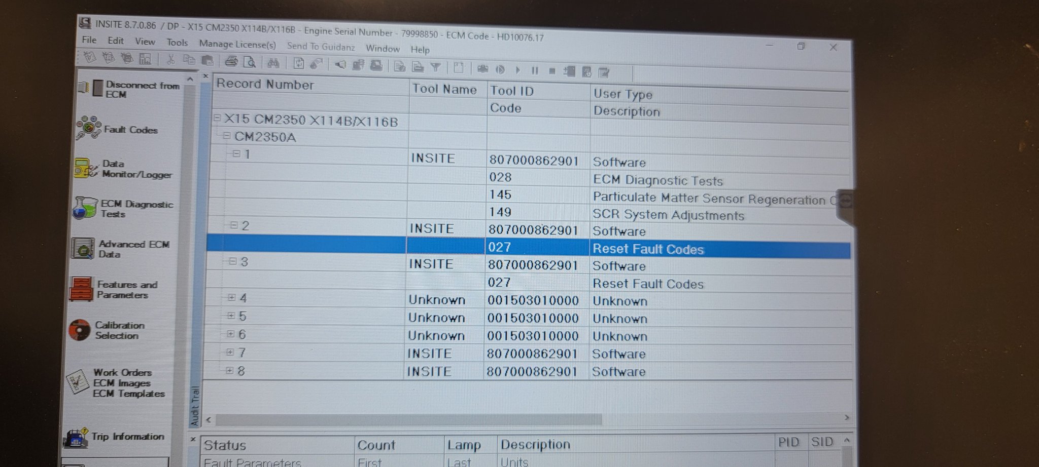

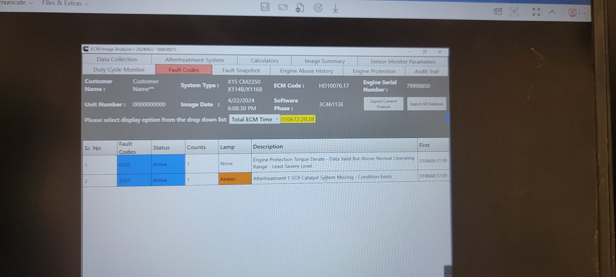

I've been doing remote diagnostics using TeamViewer on trucks and equipment to help our other mechanics troubleshoot aftertreatment issues. Some guys don't have the software like Cummins insite on their laptops because management doesn't think you need anything to troubleshoot newer trucks and equipment.
If they have the adapter to communicate to the trucks or equipment, is it possible to use software on my laptop to be able remote in or am I limited to using what is installed on their laptops? IT has the company laptops locked down with admin passwords that we can't even update software so I don't have the ability to remotely install software or even activate a license for the program if the company did want to spend the money.
Reactions: TxLabRat
Sounds like a place I used to work at. It sounds like if they’re locked down that much, and you can’t even install team viewer, you’re SOL. If the guys can’t even use Insite they should be walking off together. This isn’t the days of blink codes, you need the computer and software to troubleshoot and diagnose. If you can’t do that all you’re doing is guessing and throwing parts at it.
We have TeamViewer already so that's not an issue. The mechanics and management still don't understand all they are doing is loading the parts cannon without having software and testing equipment. A lot of the aftertreatment faults I deal with can be dealt with by walking the guy through the troubleshooting steps over the phone once I'm able to look at faults and different parameters.
They are over $10k in parts and dealer visits on one mechanics truck and still have the same fault they've been fucking with since mid December. Most of the fuel system parts were replaced without any testing done at all. The guy doesn't like me after the last time I fixed his truck because he ran him mouth the whole time telling me what I was doing wouldn't fix the problem. Apparently, asking him if he is so smart, why am I fixing his truck while he was power washing equipment pissed him off. They would rather send it to the dealer and let it sit for weeks at a time now.
Yesterday was an x15 and a 3251 fault. Problem with this is the dipshit thought he could clear faults and just move onto the other state we are working in. Called the boss saying he only had derate faults so I was able to remote in and see he deleted the actual fault saving a trip to the dealer. All that was wrong was bad batteries after he messed with it Monday night and half the day yesterday.
Reactions: 101st
Some of our guys don't have the software and aren't capable of using what they do have. I am trying to find a way to avoid driving across the country for stupid shit like this.
Reactions: Hobo Hilton
Quick google says that’s DPF pressure out of range high. Ohm out the sensor and disassemble the DPF and see if it’s clogged.
Truck is already fixed. Days of using ohms to test sensors are pretty much over with smart sensors. That fault has nothing to do with the dpf. Scr is a completely different component of the aftertreatment system. That's the problem I see everyday, people think aftertreatment is one component instead of breaking it down into individual systems that do separate things.

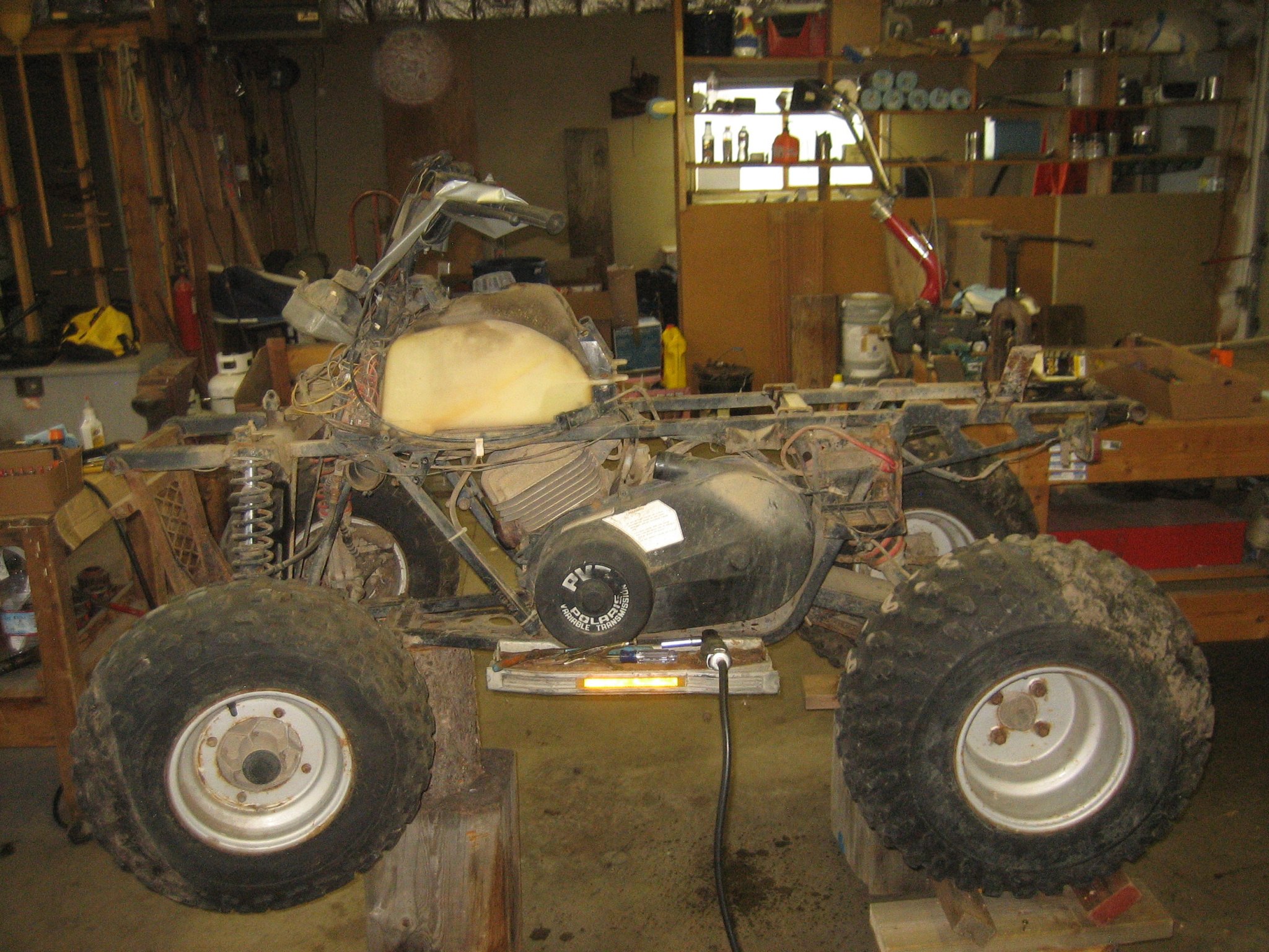

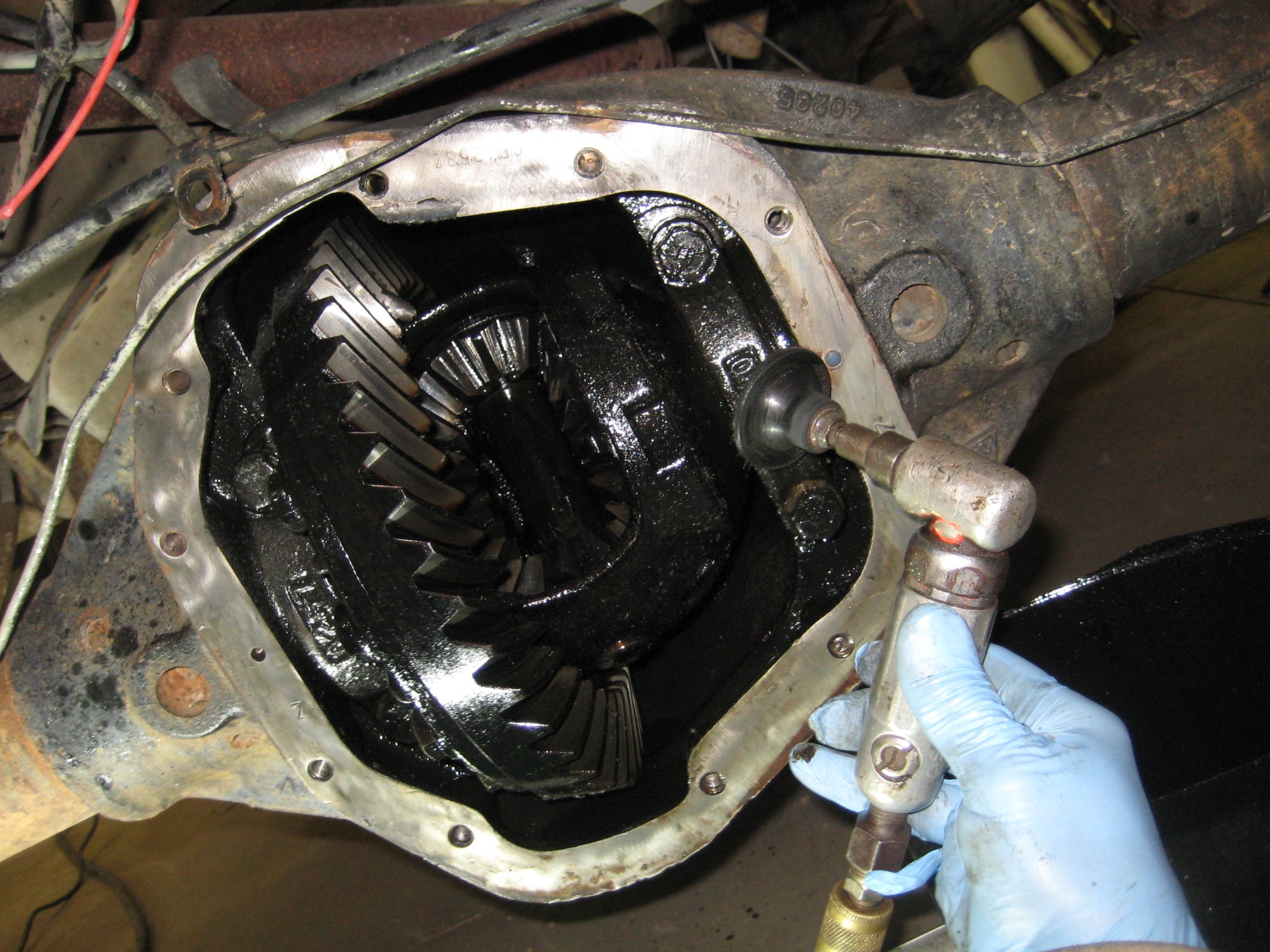

All my life, I have restored old stuff and made it perform dependably. That is the only way I can survive financially on a fixed income.
Rebuilt many Lincoln SA200 welding machines. Many were older than me.
Everything I run is older that the 2007 -2013 range. Man, that stuff is like new to me. I could only wish I had some of that "new" stuff.
