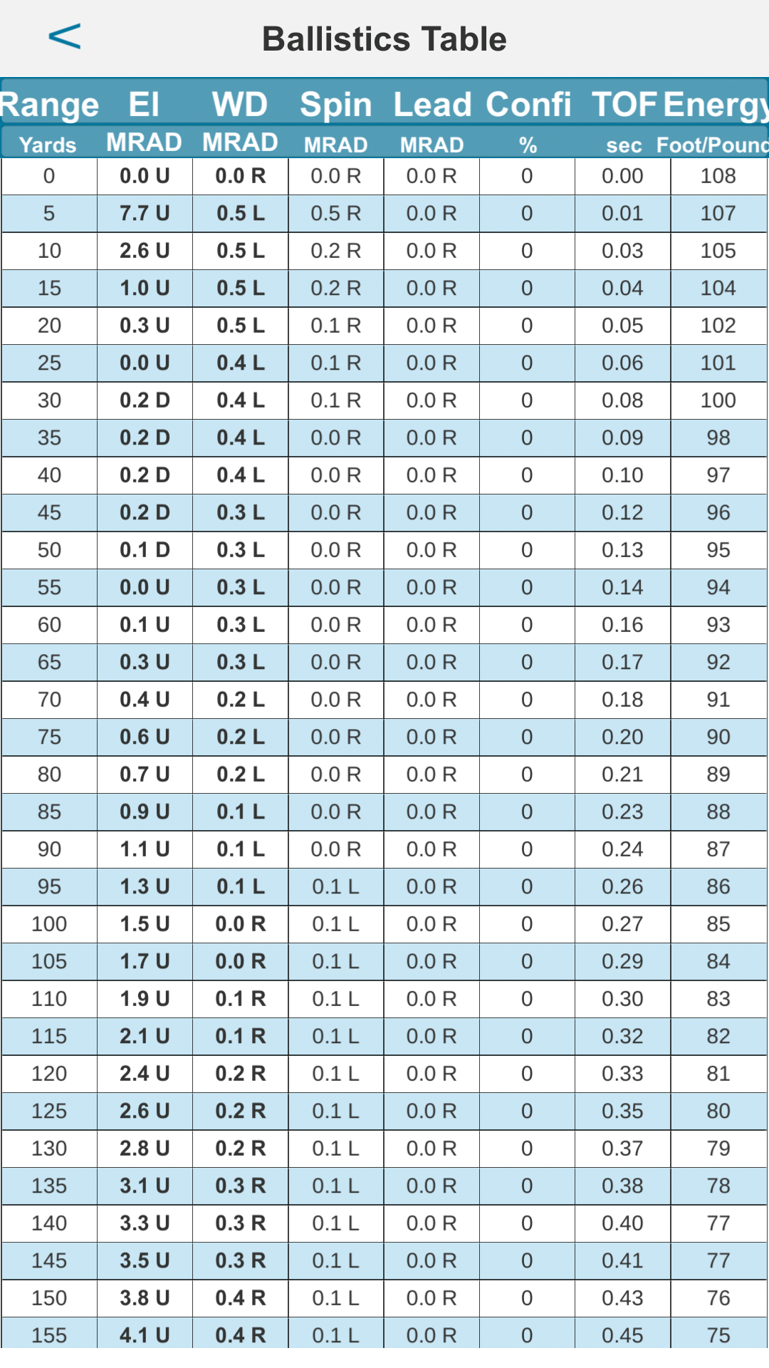

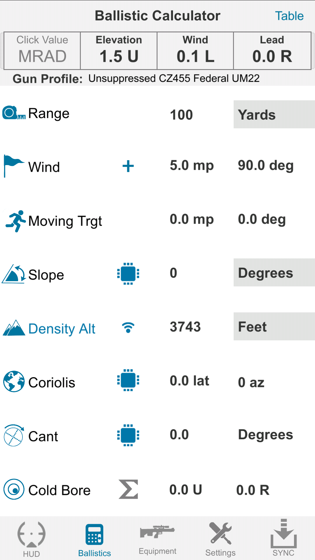

I was doing some truing of my 22LR for NRL22 matches. I am using both Trasol(android version) and CB. I was looking at the wind info after I trued my drops at 100 and 200 yards (thankfully it was a calm day today). I have aero dynamic jump, spin drift and Coriolis turned off. On both apps if I put a 5mph 90 degree wind both solutions have me dialing left out to about 100 yards and then dialing right past 100. This seems counter intuitive to me since the wind is moving from right to left. Why do they provide these solutions?
Screenshots of trasol info if that helps

Unfortunately I am stuck on Android. What was odd to me was that Coldbore shows very similar trajectory. We have a local 22 match that has us shoot to 200 so was working on confirming drop when I saw the odd results. BallisticARC did not have the same odd results.
Ok, so now I did the same in 2.0 and CB - with no wind it looks kinda better but SD on 2.0 has a 1/10L by 100, but when I a 5mph 90 wind, everything is wrong.

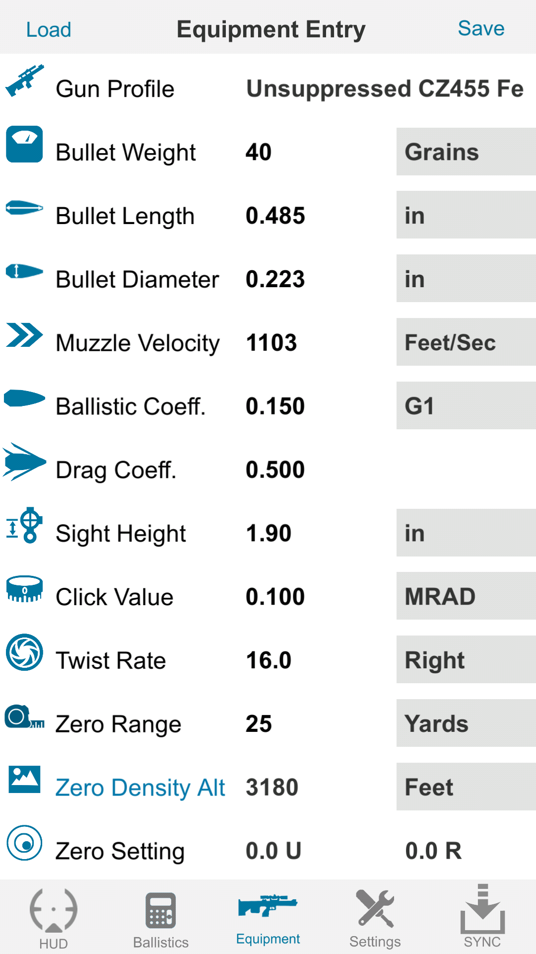

Federal ultra match 22. That is the BC that matches my drop at 100 and 200. Haven't found any 22 that has a much higher BC listed online. BallisticARC lists the Fed at ,147/.149 (can't remember which off the top of my head)
