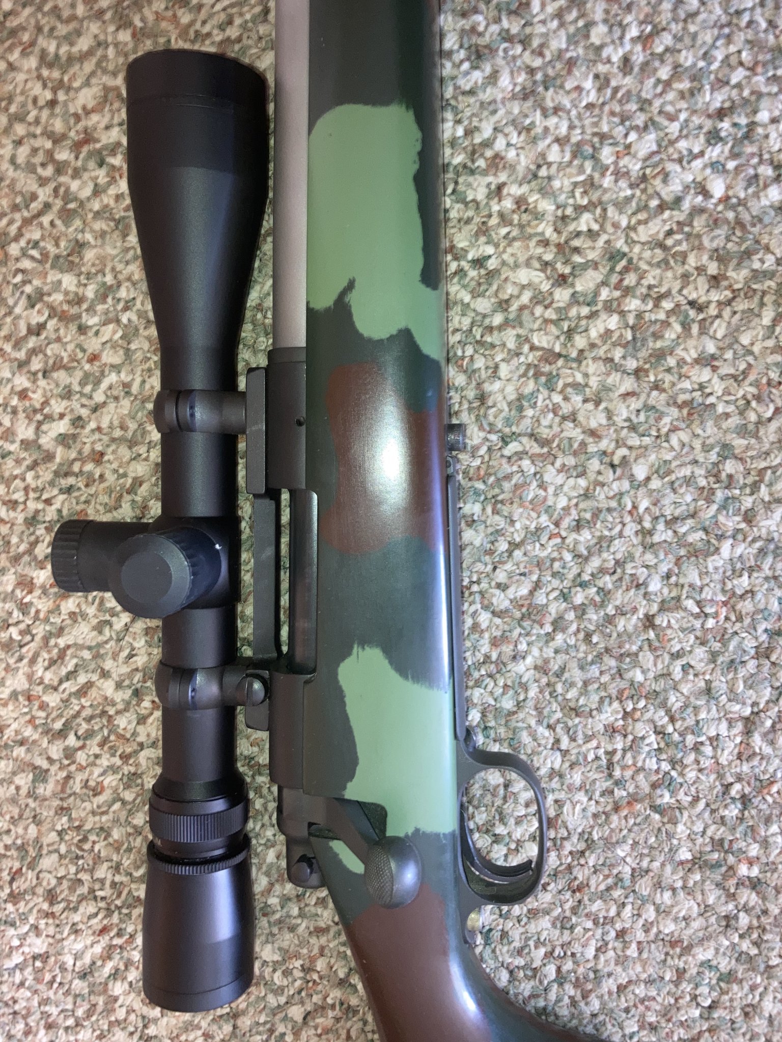

This is my first post but I’ve poked around on here for some time before actually joining. I was lucky enough to be able to purchase a m40a1 off of retired marine major before he passed. He was stationed at Marine base Quantico towards the end of his career and had something to do with the PWS. I know very little about the history of this rifle other than what I was told by him. I was told he had it built by the armors before he retired but that’s all the information I was given as he wasn’t in the best health. The action is a C prefix but the barrel is unfinished with no markings anywhere on it. I’m just curious if anyone on here may have a better idea what I have or what the story of this rifle could be beyond what I was told. Thanks in advance for your help!
Nice looking rifle. A major at Weapons Training Battalion would probably have been the XO or S3 (Operations Officer).
A number of the gunsmith-builders (MOS 2112) moonlight by building guns on the side or at home. Some are exceptionally good to superior. Some need the practice. Most times you'll get a gun that will put a smile on your face without the ignorant long wait times and full retail cost you'll endure when ordering from a commercial shop.

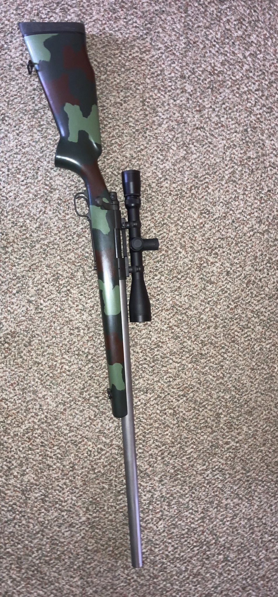

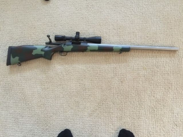

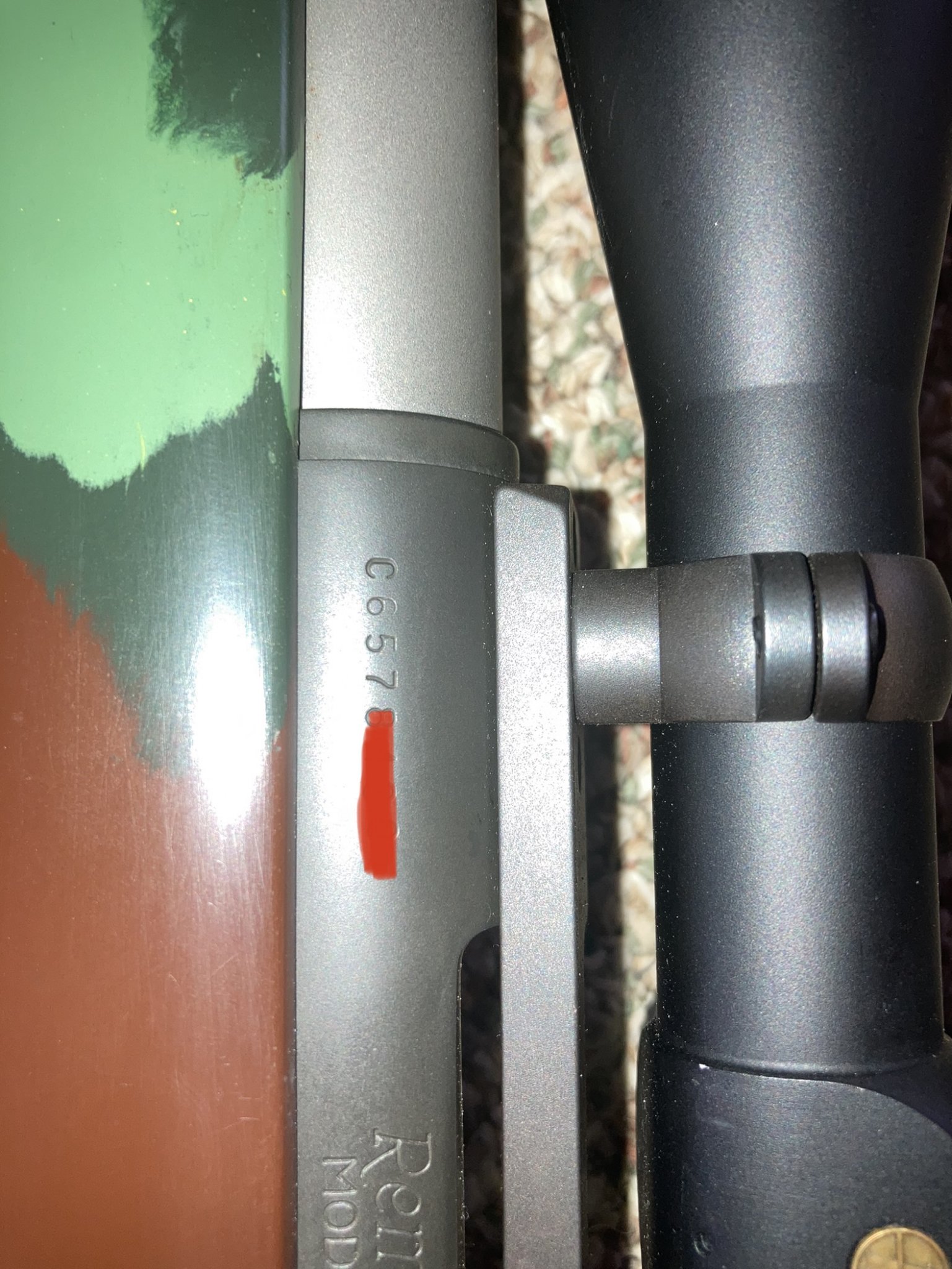

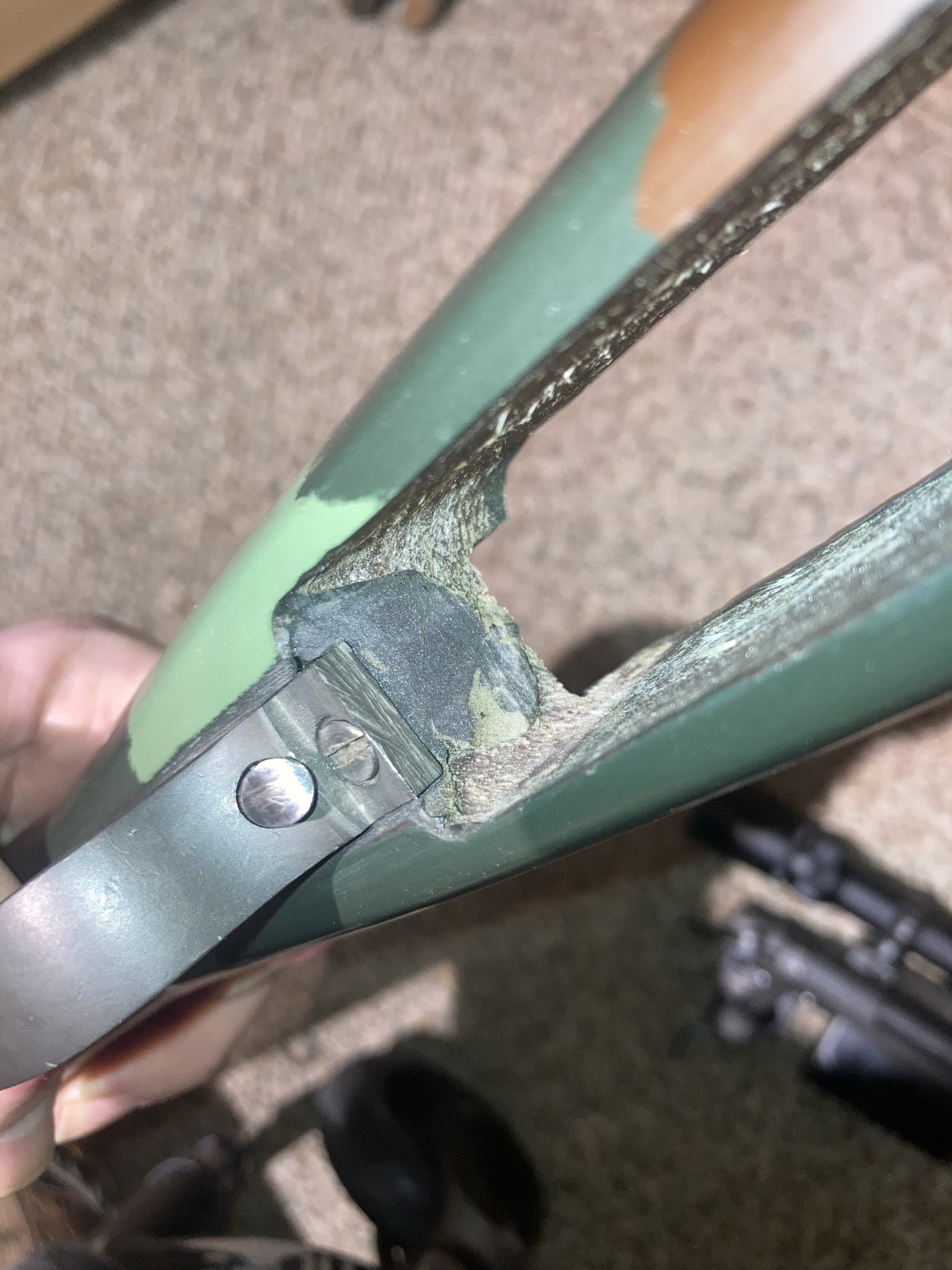

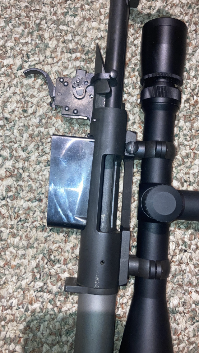

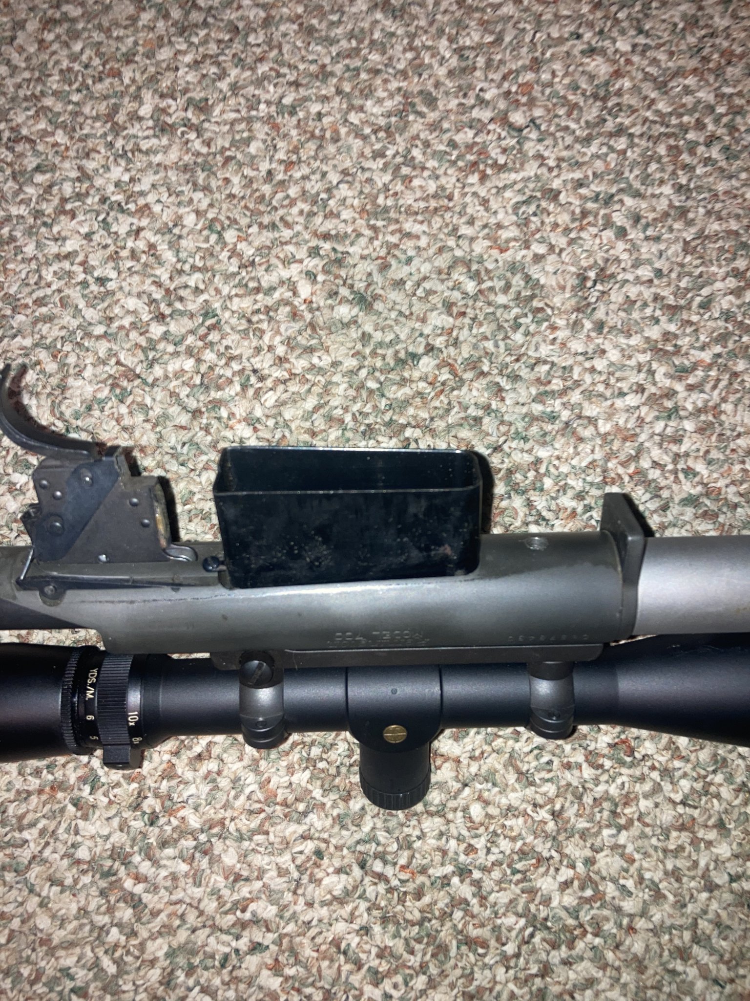

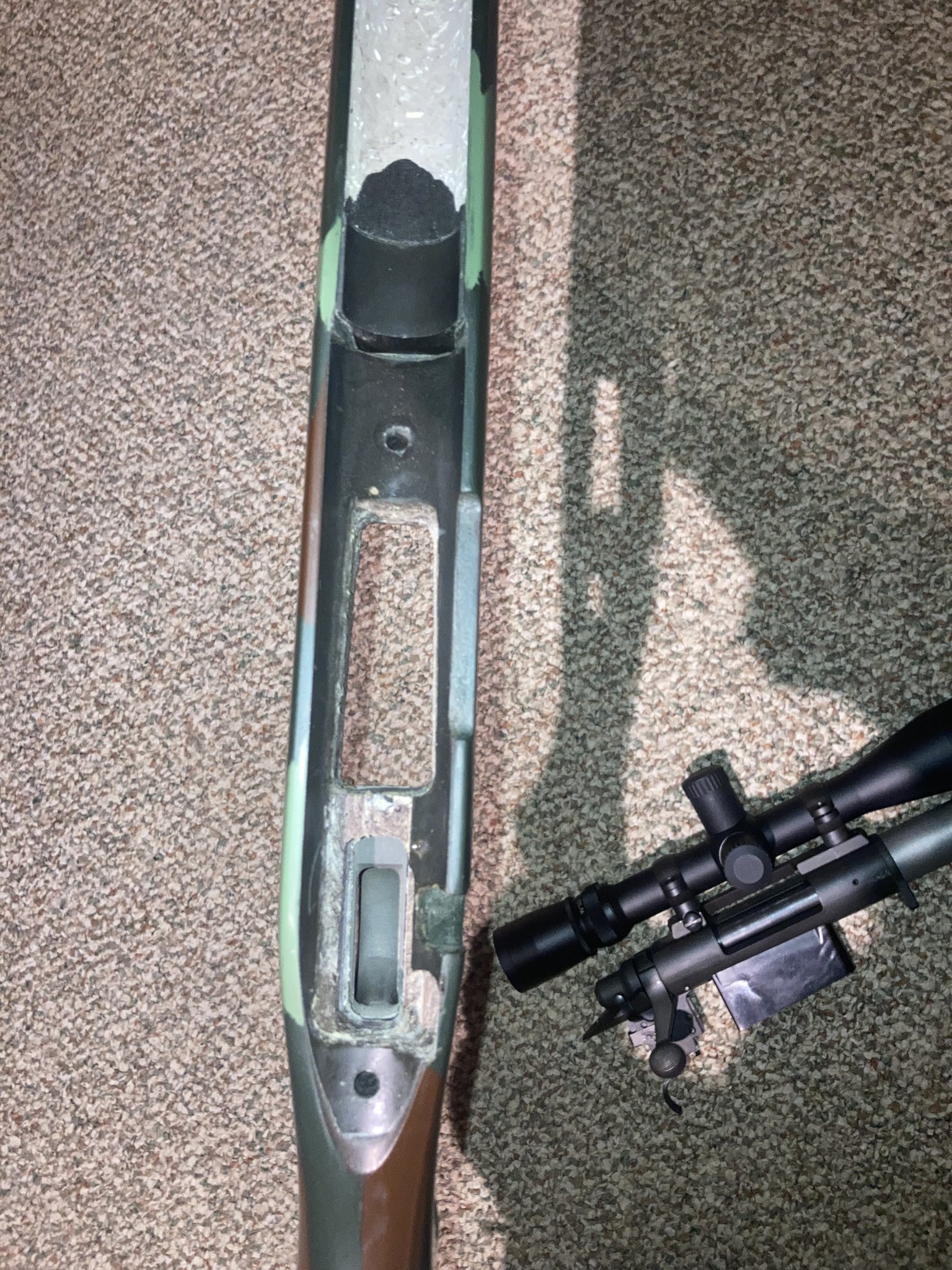

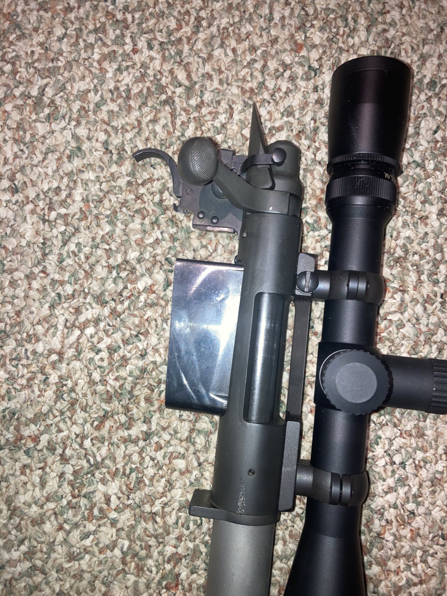

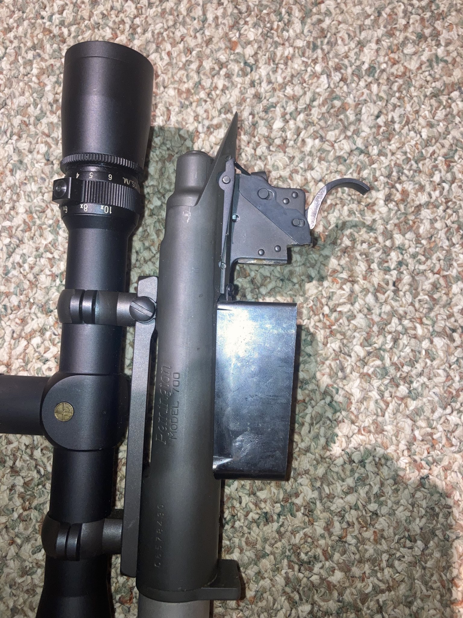

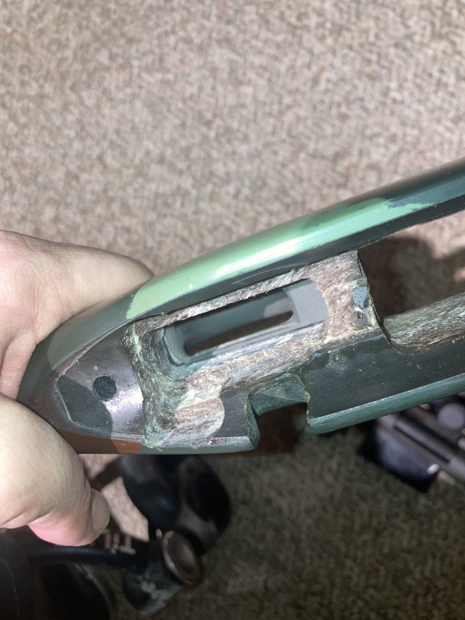

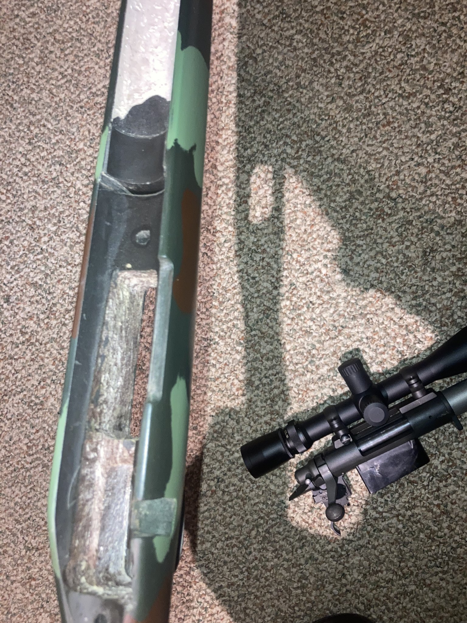

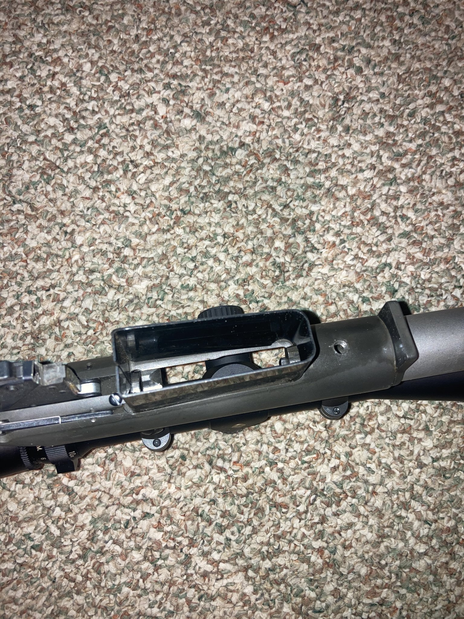

Here are some more pictures of my rifle. There are only the traditional markings on the action and none anywhere on the barrel. A couple questions I have about it are what kind of barrel might it possibly be and why would it have been left stainless or what would be the proper coating? Also I’ve looked around on here in reference to the scope. It’s a leupold vxIII 2.5-10 I know the unertl 10x is traditionally what was on m40a1 rifles but I have seen this scope on other rifles while browsing the forum so I’m curious if it was an issued optic in some situations?
Reactions: camocorvette

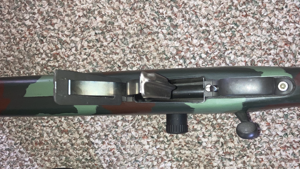

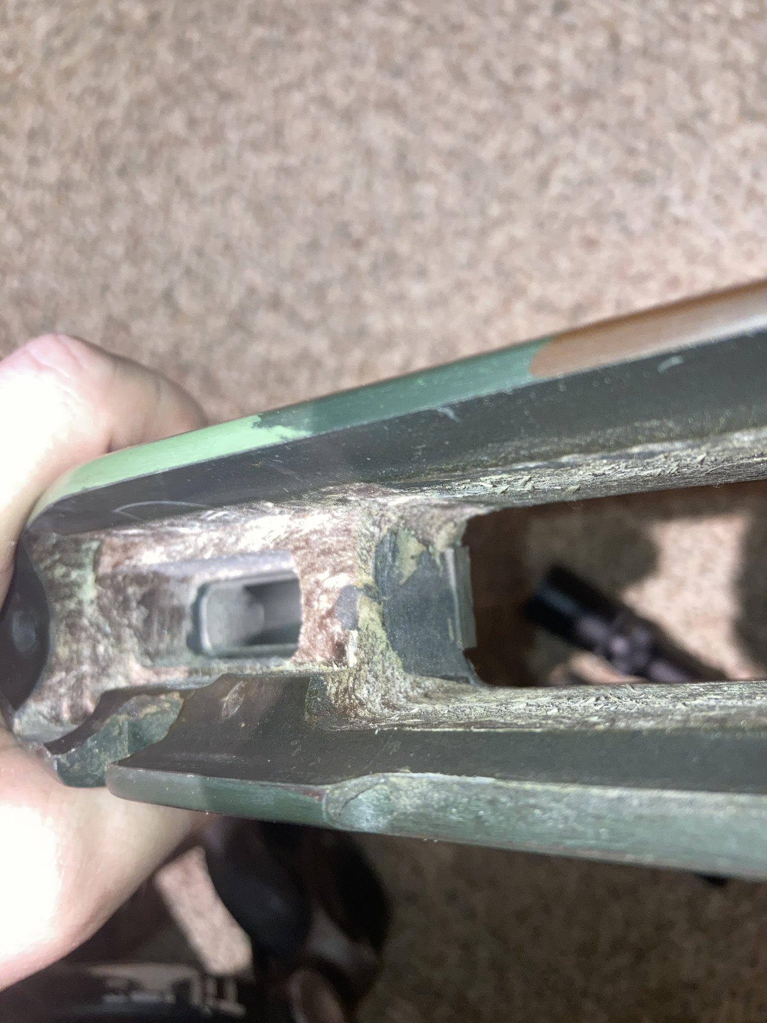

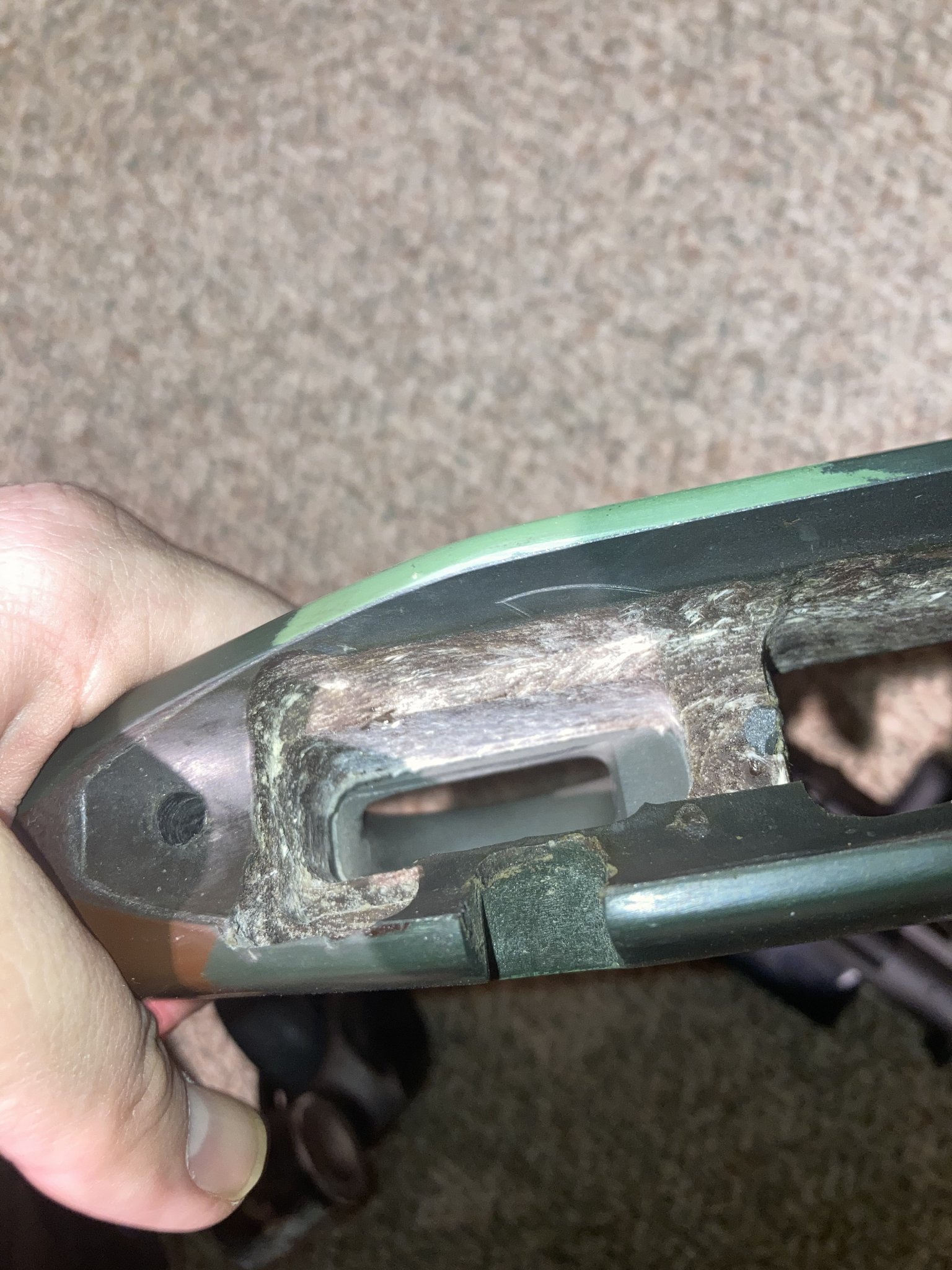

Doesn't look like the action has been clipslotted. The stock inlet around the bottom metal looks big compared to the metal.....is it bedded? These are what I catch without seeing the BA out of the stock to see the trigger cut, welded mag box, modified recoil lug, etc.
Either way it looks like a good rifle with a unique story.
Enjoy it.
Enjoy it.
Ern

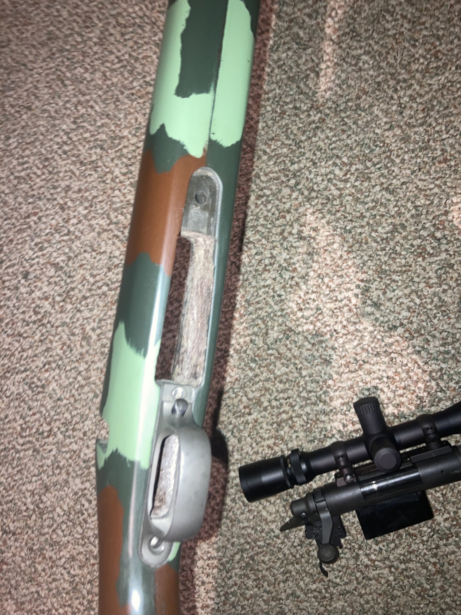

Yes the BA is bedded very tightly I took those pictures on my lunch I can pop it out of the stock later tonight and get more pictures but thank you for your input!

If the rifle was built in the 70s through early 90s black oxidizing stainless wasn't done by a lot of outfits. You had the option of paint before Cerakoting became a thing (although Brownells may have had epoxy coatings).
Being a Marine he may have wanted or preferred the 10X Unertl Marine scope which may have simply been unobtanium. The 10X or variable (topping at 10X) Leupold would have been an acceptable option. Leupold wasn't private-selling many M3s and M3As except to SOTIC grads by arrangement.

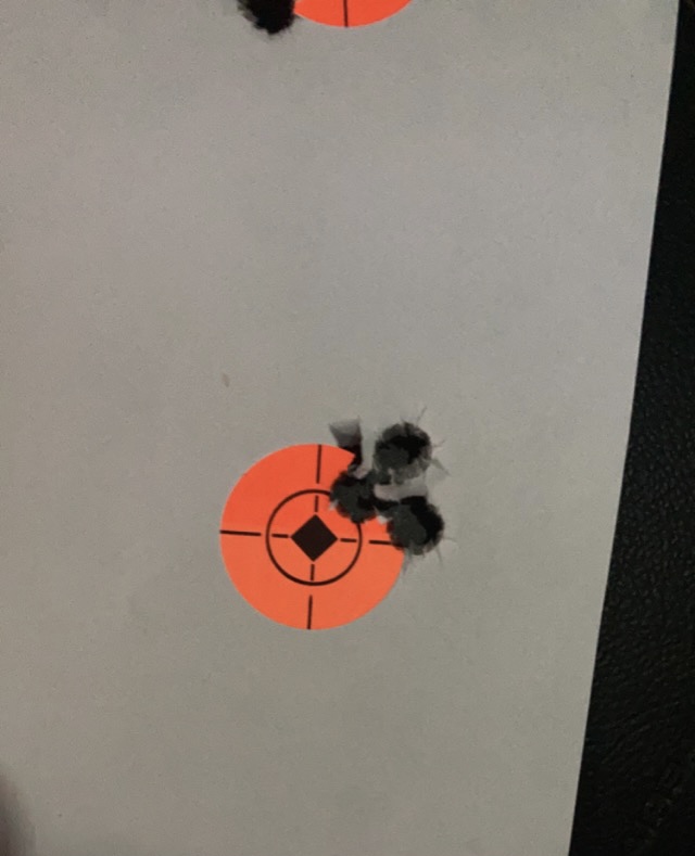

Yes I’ve put about 500 rounds through it since I got it. After load work up I’ve found a few ringers using imr 4064 with 168gr SMK and 155 Barnes match burners. It’s consistently 1/2 moa.

You're shooting half-minute groups as it sits -- you can kill most anything up to elk, and ring steel targets to at least 850 as configured.
Enjoy it.
Ern

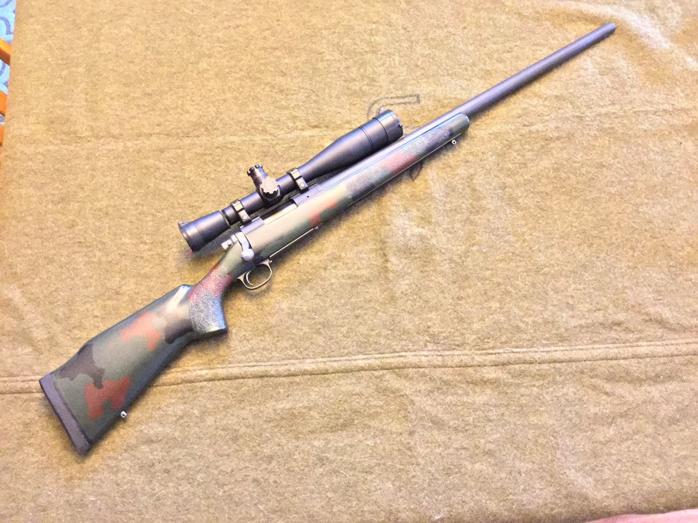

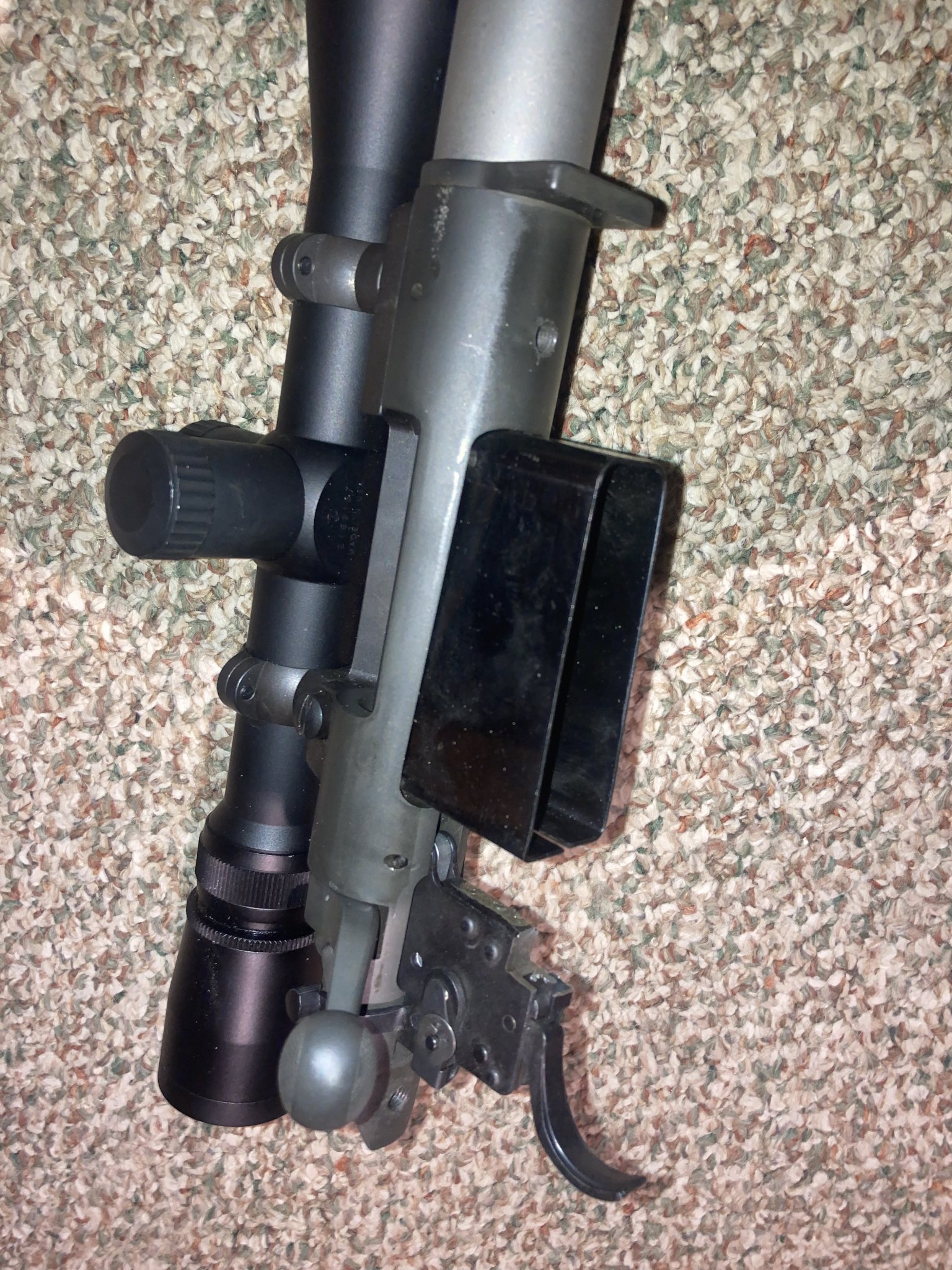

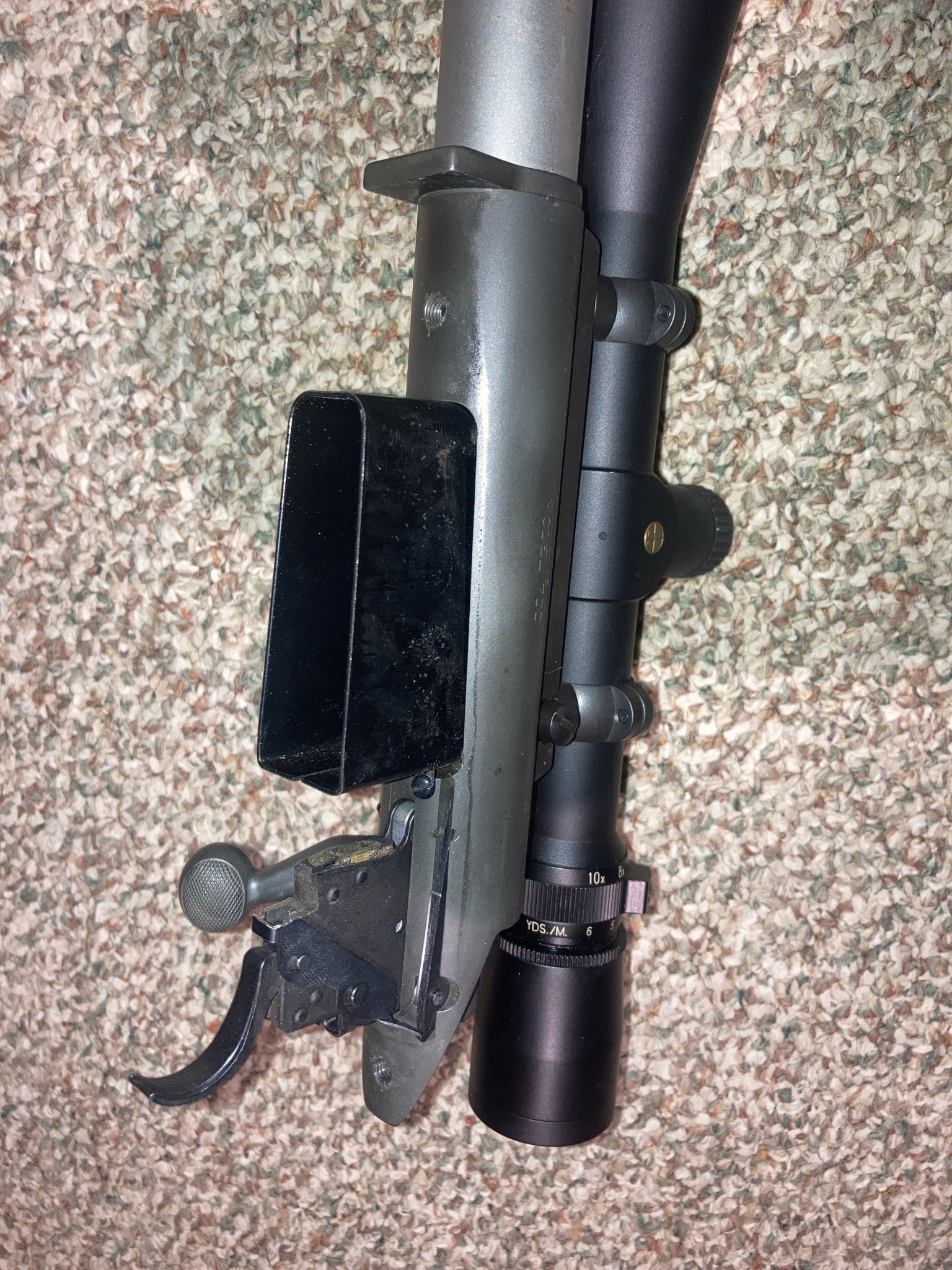

Here are some more pictures of it outside of the stock. It is not clip slotted and as far as I can see the magazine box is not welded but is attached by a screw.

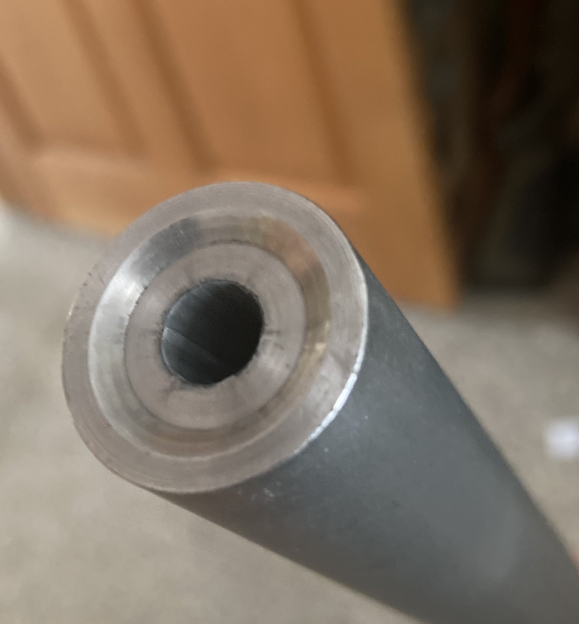

Removing the barrel is required for oxidizing or nitriding. Cerakoting or epoxy can be sprayed-on and either air-seasoned or baked.
Nitriding will extend barrel longevity two or three times normal throat life.
This would appear to be what is sometimes called a "Hobby Lobby" build. In the past, in order to "maintain their gunsmithing skills," some USMC MOS 2112s have had discretion/privilege to build 'gratis'/pro bono rifles or pistols, using civilian parts, provided to them by active duty USMC personnel or retired personnel. (My guess is the Scout-Snipers, and USMC Rifle Team/Pistol Team utilized Hobby Lobby the most, back in the day). Back then they could drop off the box of parts at the lobby of the PWS shop, and a few weeks later they pick up the completed project. Often these projects are built at the home of a 2112, with maybe some machining done at the PWS shop. Given the lack of any finish wear on that rifle and scope, it was built using civilian parts presumably purchased by the deceased Major. (Nothing on that rifle appears to be any issued/USGI parts).
In recent years, USMC PWS leadership has sort-of frowned upon "Hobby Lobby" activities (long story from previous decade about someone abusing their privileges for profit motive). Anyhow, since you asked, I suspect its a Hobby Lobby rifle, likely built 'gratis' for the USMC Major in the 1990s or early 2000s, based on the style of the stock and civilian scope. The 2112 didn't go through the trouble of clip slotting the receiver, but the other build/bedding characteristics are what is seen on M40A1s. No idea what barrel could have been used, but possibly its a 1/12 twist barrel. (Schneider barrels have been used since the early 2000s, but for a Hobby Lobby build, its whatever was provided by the deceased Major back in the day. Hart, Krieger, Schneider, or ?).
It's too bad they didn't do the black oxide coating of the barrel, but it could be done by others if they have the right solution. Stainless steel can not be parkerized/phosphated - but it can be chemically darkened via the black-oxide process. Its somewhat caustic solution, and not all gunsmiths want to mess with that finish. Given it was likely originally built by a 2112 decades ago, I would try to find someone to do the "correct" black-oxide finish on the barrel.
When he got sick the time came and his wife needed help dealing with his collection (she was terrified of guns). She opened the safe and found he had attached a note to the barrel of my rifle telling her to get ahold of me for help and to give me the rifle as payment.
Sounds like that rifle found a good home, and hopefully you will enjoy Bernie's gift to you in the years ahead. Its a keeper.
This would appear to be what is sometimes called a "Hobby Lobby" build. In the past, in order to "maintain their gunsmithing skills," some USMC MOS 2112s have had discretion/privilege to build 'gratis'/pro bono rifles or pistols, using civilian parts, provided to them by active duty USMC personnel or retired personnel. Back then they could drop off the parts at the Lobby of the PWS shop, and a few weeks later they pick up the completed project, often they are built at the home of a 2112, with maybe some machining done at the PWS shop. Given the lack of any finish wear on that rifle and scope, it was built using civilian parts presumably purchased by the deceased Major. (Nothing on that rifle appears to be any issued/USGI parts).
In recent years, USMC PWS leadership has sort-of frowned upon "Hobby Lobby" activities (long story from previous decade about someone abusing their privileges for profit motive). Anyhow, since you asked, I suspect its a Hobby Lobby rifle, likely built 'gratis' for the USMC Major in the 1990s or early 2000s based, on the vintage of the civilian stock and scope. The 2112 didn't go through the trouble of clip slotting the receiver, but the other build/bedding characteristics are what is seen on M40A1s. No idea what barrel could have been used, but possibly its a 1/12 twist barrel. (Schneider barrels have been used since the early 2000s, but for a Hobby Lobby build, its whatever was provided by the deceased Major back in the day. Hart, Krieger, Schneider, or ?).
Thanks a ton that’s the explanation I was looking for!! I will definitely look into finding a competent gunsmith to have it black oxide coated even if it’s a hobby lobby build I would like to stay as true to form as possible. Yes this rifle is one of my prized possession along with a original colt python I was able to purchase from his collection. They will both be handed down when the time comes with the stories of who my friend Bernie was.

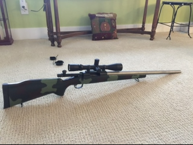

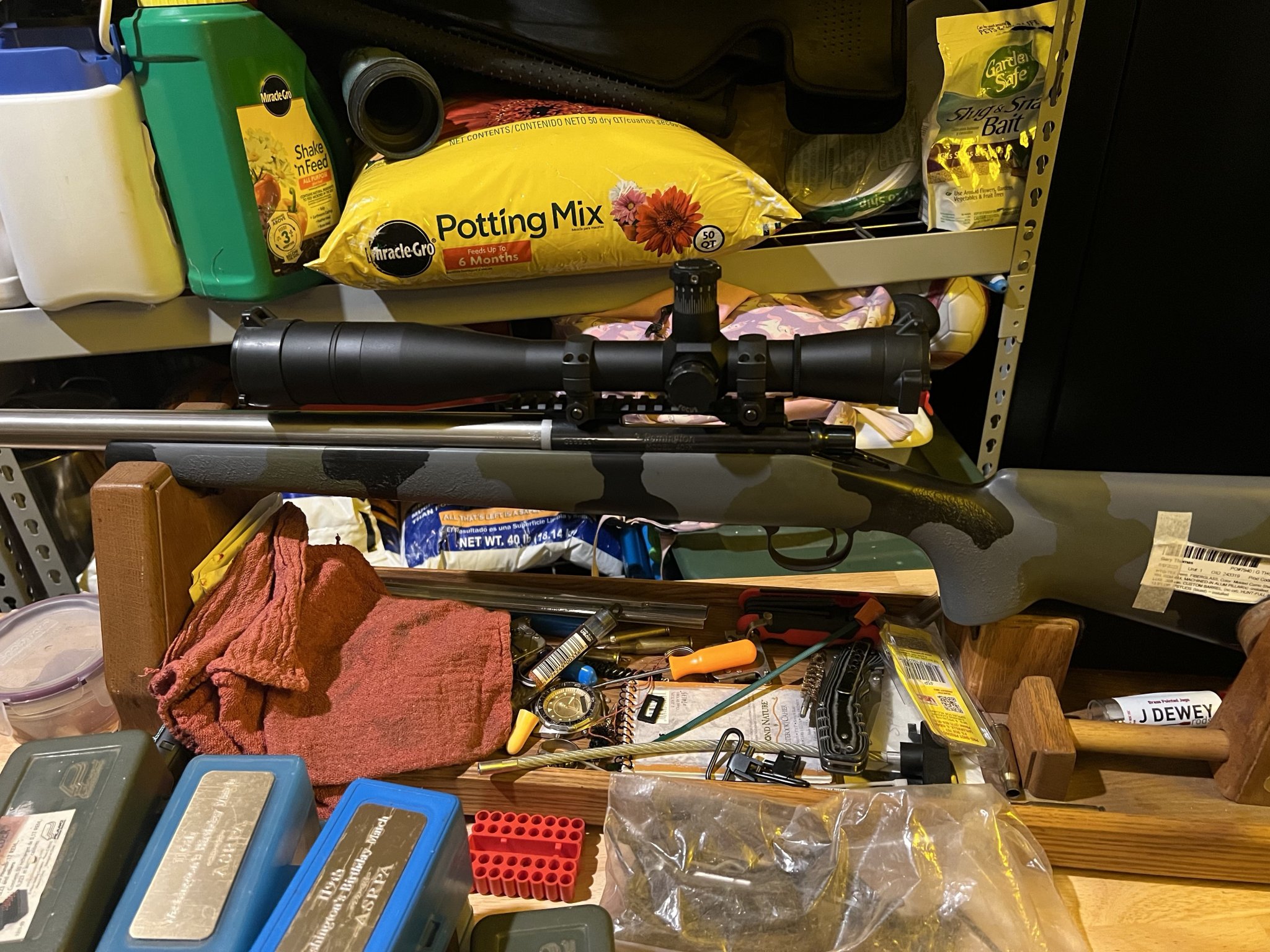

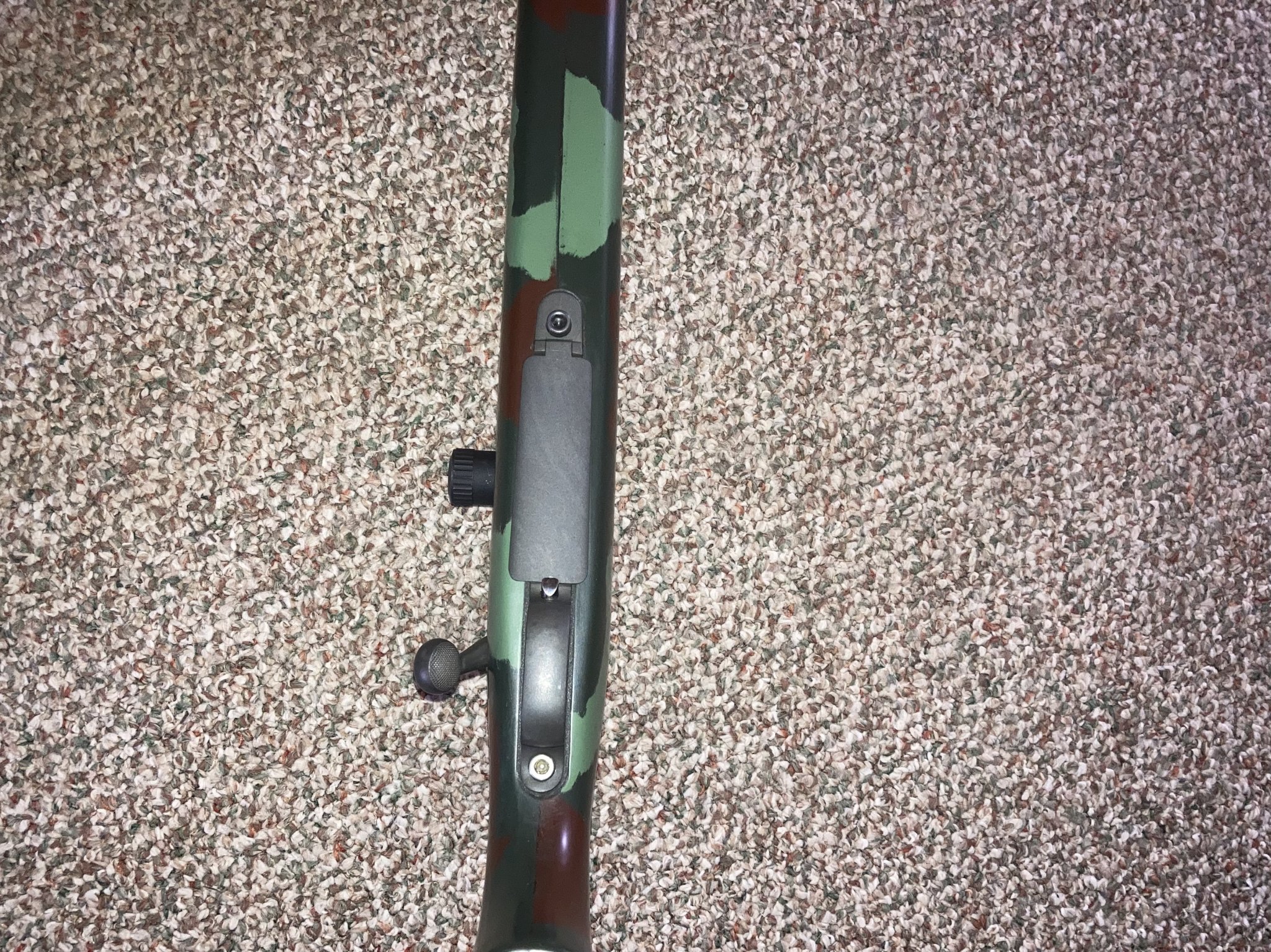

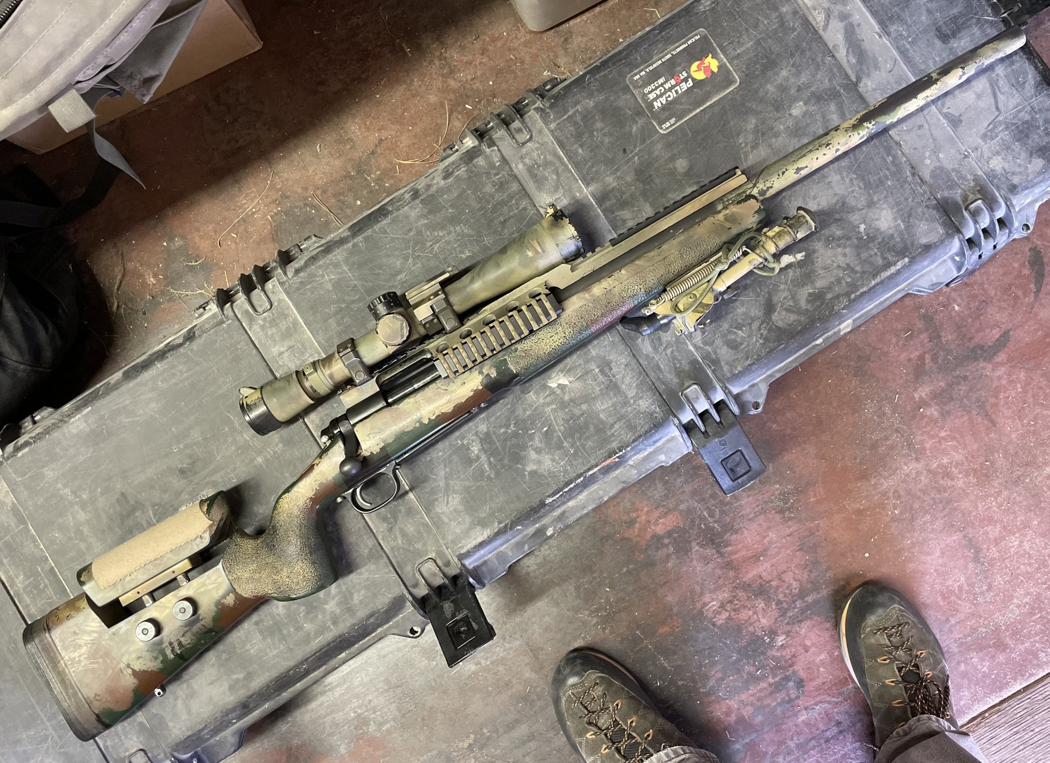

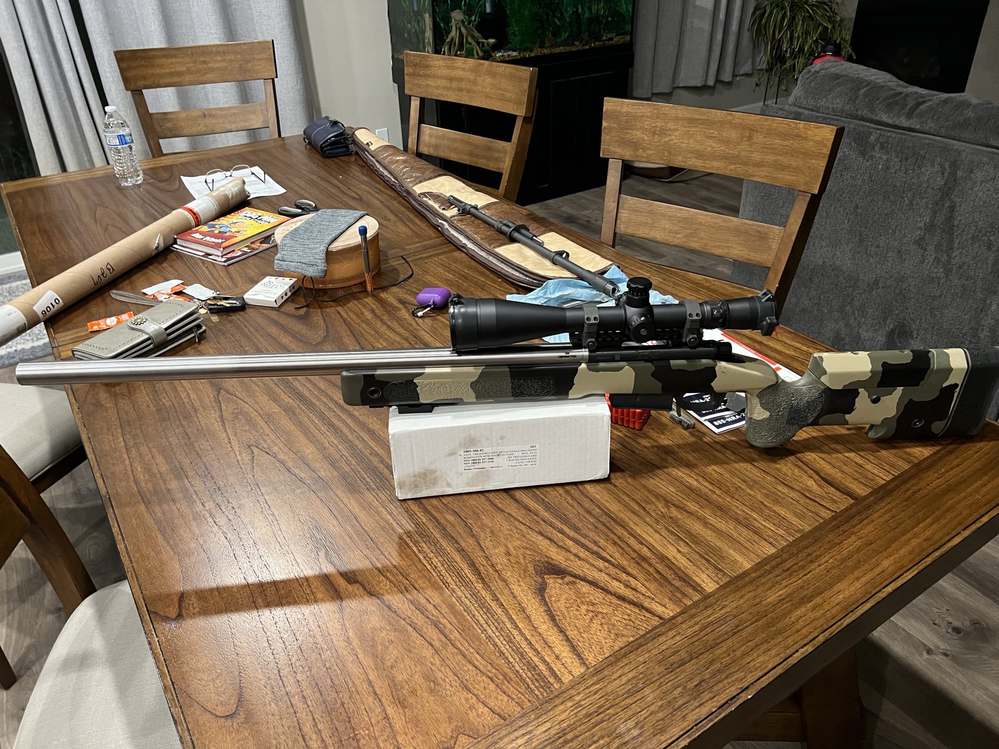

That’s a good looking rifle how’s it shoot?
Shoots well with just about everything I stuff in the chamber 168-175’s doesn’t really matter at all. Best I’ve done off a ruck has been one ragged hole @ 100yds, prone off bipod @ 200yds about 3/4moa. that is when I hold up my end….It will ring steel @ 600 with ease.
But this guy got a new stock, and Im itching to get it out and play with it. The downside is everything in the house is packed up, we sold and are moving to Louisiana.
And this guy needs some time out in the sun as well….
That bottom rifle is sweet! I love the old woodland pattern no matter the colors. I’m a sucker for old school traditional things for example my hunting rifle all through is pillar and glass bed it’s still has a wood stock. My next project will most likely be a 223 trainer I have the donor R700 action but that’s as far as I’ve gotten. It will probably get a 22” heavy contour barrel and a McMillan game hunter stock in woodland camo.
Rifle pic #1, I posted is Dark Camo it’s not really Forest or Woodland, it just is what it is and I don’t remember how McMilian described it.
Rifle pic #2, is the current Shadow I like it as it’s pretty subtle. I had another Dark Camo stock with M5 inlet and hardwear that a buddy just had to have so we worked out a trade. It’s now attached to my 40X.
Rifle pic #3 is just plain old GAP.
