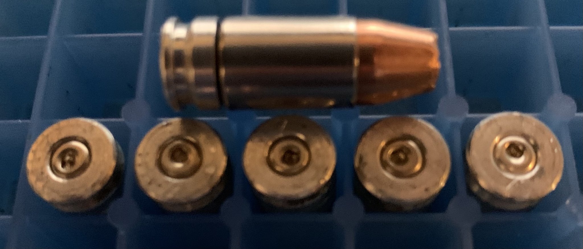

I’ll drop a bonus in the thread: PCC specific load meant to enulate 9mm NATO high pressure subgun ammo without actually being hotter than +p:
NAS3 Shellshock bimetal cases, 90gr sig V-crown over 11gr of accurate No. 7, loaded to about 1.080 coal (v-crown should be sitting on top of the powder, its a 100% volume load)
out of a KP9 barrel it goes about 2020fps, an MP5 barrel a little less, a longer AR9 barrel it tops out about 2350 fps. you will feel recoil
