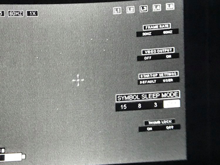

Night Vision reap ir upside down?
jeffl838
Feb 20, 2013
869
379
I want to mount it on my rifle with a wilcox fts via the dovetail. Is there any way to flip the menu so that I'm not upside down?
Additionally, what is "thumb lock" in the expanded menu, and "M" in the quick menu? How do I adjust the presets for the quick menu's "P"? I have rtfm'd, with no mention of answers to these questions.
Edited for ease of reading
Hold the button down (not push once). When the menu comes up, move highlight L3 and go to the bottom and switch to symbol rotation 180 degrees. This will rotate all menus 180 degrees (upside down)
This is all I've got in menu 3
Yes, you can run it "upside down" ... I've done it with all the joystick housing trijicons ... works fine ... with the patrol there is a menu option to flip the menu, but not with the reaps or snipes ... but not to worry ... do it anyway ... you'll get used to it !!! 😁
i barely know how to read as it is, trying to not make it any harder but sucks to suck
wtf is "M", how do I adjust the presets for "P", and wtf is thumb lock?
