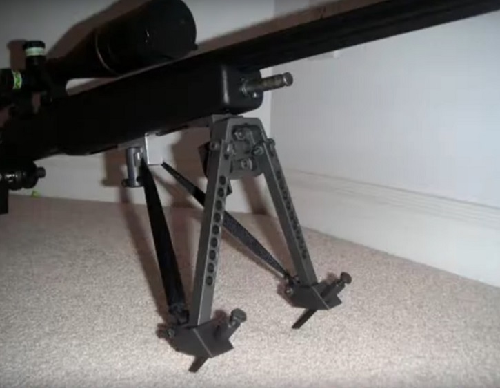

I have also designed a telescopic forend system that achieves the same result. It transfers recoil to a bipod if attached to the barricade.
If it works for you and you’re winning then it’s a winner! Good luck!

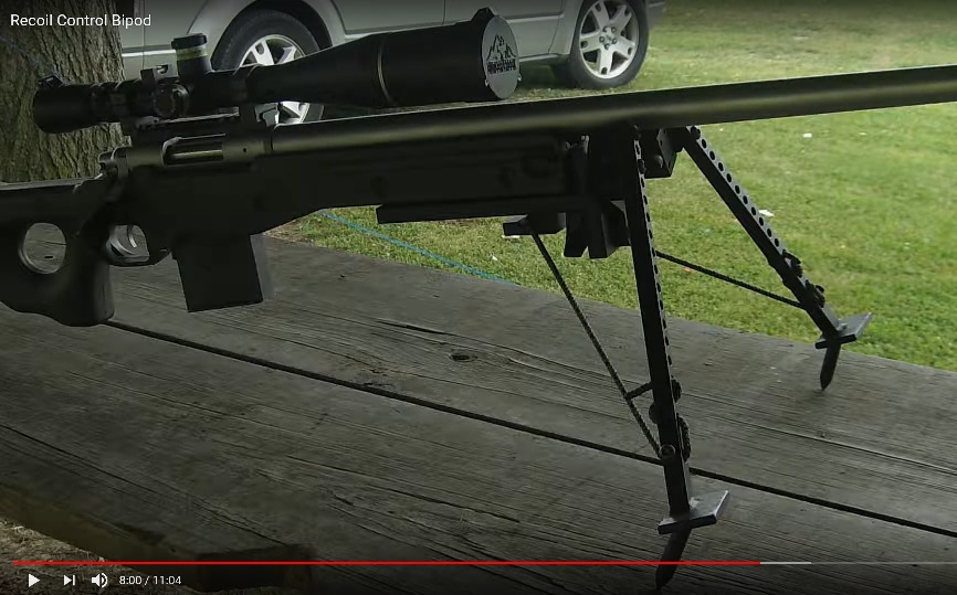

I see another couple applications for this sort of setup, if it really absorbs recoil as well as you suggest:
  • People with shoulder problems, severe arthritis, etc. - for whom shooting is unmanageably painful
  • People with limited mobility - for whom proper positioning is physically arduous/impossible
Reactions: PracticalTactical
you do realize they use "bipods" that slide in the same manner as stock on a rest? not a fucking harris
To this point... when shooting groups of 10 or more, and the feet of the bipod are repositioned after the recoil of each shot, the rifle then tilts left or right based on the terrain.
One of the benefits of spiking the feet with the bipods in the video is to prevent that from happening. The feet stay in the exact same place for the entire string of shots. Nothing changes and the cant is constant.
Sure guys now bring sand bags and boards to the firing line to create a constant shooting plane that they rest the feet of the bipod on, but that's more of a pain than simply pushing the feet of the bipod into the ground 2 inches.
It's pretty simple companies have already addressed this in a similar way, he just pins the strap to the ground.
Others attach it to the shooting mat or in the case of the Larue style they attach it to the sling and you lay on it.
Been done, not new, just a different attachment point but the concept remains, pin the bipod with a nylon strap.
There are others, the Larue was just the first one I can think of, but other companies have done the same thing.

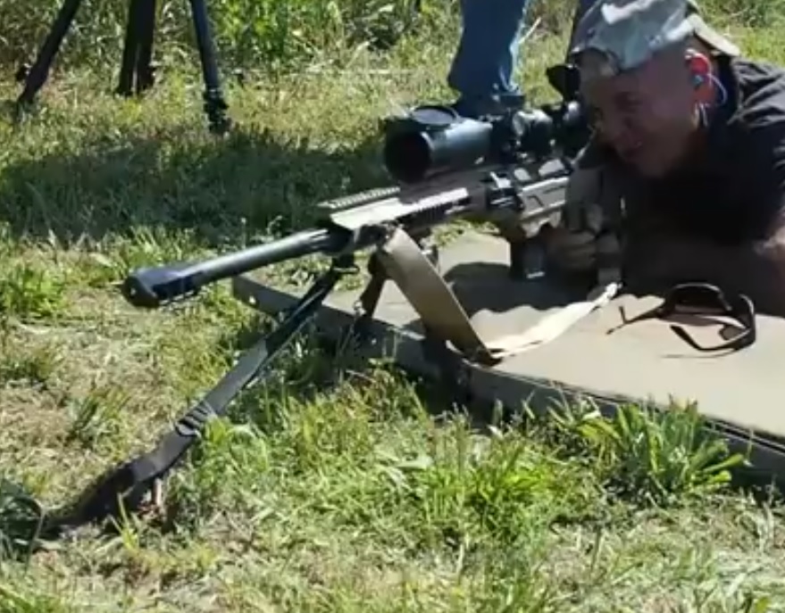

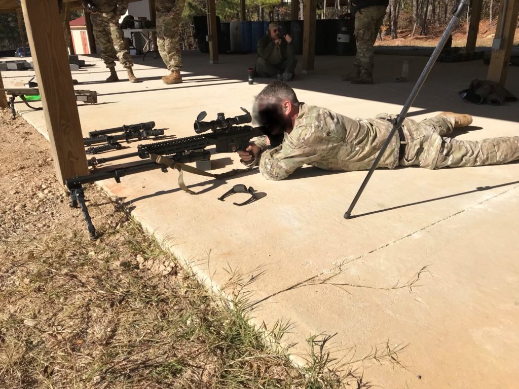

How is that picture the same thing?
When the rifle recoils, the legs move with it so it loses it's footing and induces cant for the next shot if it's not on a flat surface.
In that picture, the bipod plays no role in restricting the rearward movement of the rifle.
The bipods I'm showing stop the rifle from recoiling and stop the feet from moving between shots, therefore no cant is induced.
The bipods I'm showing transfer all recoil energy to the bipod feet and not your shoulder.
Keep in mind the spikes are only 2 inches long as per F Class rules but could be 10 inches long if you want to capture even more recoil energy.
In this image taken from the video, the rifle is attached to a strap to a spike in the ground... Any of you can try this with stuff you have around the house.
All recoil energy goes to that spike and the shooter does not need to brace for that recoil.
I could literally remove the entire butt stock and still shoot 1/2 MOA groups with this.
For what it is worth. Guns work best when they recoil without the shooters input.
For benchrest and now F-class, use rests that allow the gun to free or semi-free recoil. These guys have no ability to see the actual impact on the paper until the spotters are applied, so they don't see/need the benefit of self-spotting .
Field guys, absolutely MUST see their impacts and thus must limit the recoil, but stopping it is not ideal. For devices like the Larue, matts with bipod loading devices and other options that allow the shooter to create drastic differences in the way the recoil is controlled, it is a slippery slope if you ever want to get off your belly. You're just not going to be able to duplicate the same recoil management technique your using with giant spikes or matts with loops when shooting off the hood of a truck, obstacle, tree branch, pack, GC or even tripod. You're going to in almost all cases, create offsets if you artificially allow devices to do the work when prone or crush forward on the bipod, instead of taking a class or otherwise learning good technique.

I did watch the video and enjoyed the out of the box thinking and seeing the proof of concept devices. If your devices work for you, rock on.
I also agree with what others were saying about fundamentals and how this wouldn't work for PRS type or multi positional shooting and see these comments as valid, even if they aren't addressing what you are asking about.
For strictly prone shooting this could serve you well particularly with injured shooters or those who can't tolerate recoil. You've just tried to show your prize pig at a cattle show...:p
FWIW - remembering if you are solely belly-benchrest or benchrest, stopping recoil is NOT what the guys looking for 200-20X, or the world record groups are looking for. At that level, it has turned to free recoil, 1/4 oz triggers for most, to squeak that last 1/10 minute out. (again zero need for spotting). If that device really worked better than what todays benchrest and belly-benchrest shooters are doing, that's where it should be used.
Positional, it is even more important to manage the recoil consistently across a wide range of shooting.. even more so without a brake.
If I push my base weight 5.9lbs non-braked Magnum using long spikes on a bipod with heavy sand, eared rear bag, it is going to have a huge POI shift from when i need to drop down and shoot off the ruck..
Nothing I am saying and I am sure what some others as saying when talking about using fundamentals or a class has to do with reducing recoil, but rather using good fundamentals to be consistent across a wide variety of shooting positions and opportunities. Relying on specialized barricade blocks, a front 50lbs benchrest, tethered bipods or harshly over driven bipods, is going to work well across a wide range of shooting situations.
So ya, for our world, applying fundamentals across variety of shooting situations, is key...
If I was a modern F-classer, I would look to the slick front matt and a joy-pod or rest for open and learn the techniques they are using.
I agree 100%. I’m a fundamentals guy to the bone. Obviously, proper fundamentals are the key and first and foremost. I’m “assuming”, based off of what the OP stated is that he is not new to the F-Class scene and his scores show it. I’ve never met the guy, seen him or seen his scores, so I’m not about to call him a liar or critique his shooting or his knowledge of shooting.
That being said, when proper fundamentals are implace, I don’t see an issue at that point using additional devices to “tame” the recoil or whatever even more. Ie muzzle brakes, Bipod whatever. I’m also not seeing the use of something like this in the type of shooting we’re doing. I’m commenting strictly on “His” specific need for it in F-Class aka Belly Benchresr. I give him props for addressing an issue that he himself was having in his specific type of shooting through product experimentation and development. Can’t fault a guy for that, and regardless if I can use it or not, it works for him, and that’s what matters.

This bipod does similar to what a muzzle brake does just without the noise albeit more limited in use. If it works for your situation then use it.
I appreciate the thought Frank but everything works in reverse when the bipod is taking the recoil. I don't even need to shoulder the rifle. In retrospect I should not have.
Your instruction is based on a normal bipod where you are accepting the recoil.
The rifle is being held so tight when in position that I could kick the trigger and still hit the bull.
Its more important to cheek the butt into the rear bag to keep everything tight.
I was hoping you guys would take some time to understand the idea, but just criticizing before understanding the concept in the first place.
You also have no idea how much work it was to create that dam video in 90 degree heat after a 2 hour drive with broken AC and elbows worn raw from sand sticking to my sweaty arms... Well.. you probably do.
