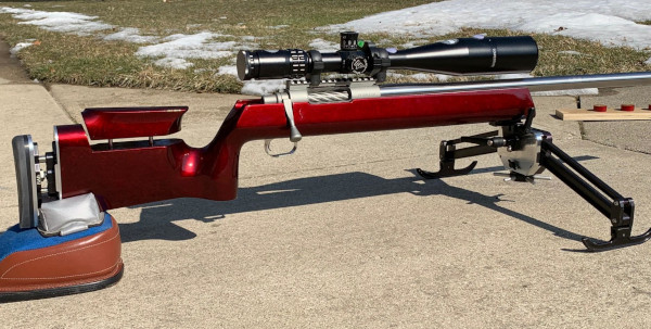

Have any of your fellow F-Class shooters demo’d your Bipods? What were their thoughts?
Thank you HogsLife
Much like how this thread has gone, guys have a hard time getting their heads around it. There's usually some guy quietly making jokes about the rope, because its uncouth.
One the first day of a match there's always one or two guys standing there looking at it while scratching their chins and I can see their wheels turning.
As for how guys like it... The 6 X 47L in the AI chassis that I show in the video sold immediately once I decided to sell it, and the buyer bought the rifle primarily to get the bipod. He could just as well have put his own rifle together, but making one of these bipods is a PITA, so path of least resistance.
To this day, he is just as puzzled as I am that people don't understand the benefits of such a system.
Like I stated in one of my earlier comments, I have no plans to sell these. It's just a thing that works that I wanted to share with the shooting community.
For a production version I have considered replacing the rope with rubber pads to soften the movement.
I've also considered improving the reaction geometry to track directly along the axis of the bore by making the forend telescopic and trapped between opposing pressures... that way the recoil impulse would track perfectly. It would also allow the usual accessories to be added to the rifle so it could be used in PRS and help reduce recoil when shooting from the barricades. An arca rail combined with such a forend would track like a bench gun.
Reactions: HogsLife

I hear you Diver... But let's not to throw the baby out with the bath water just yet... The principle can be utilized in more palatable ways for a more diverse audience... Like PRS.
I'm just kicking this out there as what I think would represent the maximum evolution of the concept.
Consider this picture indicating a barrel in the center with a two piece forend with the green outer sliding along the red inner hull and along the axis of bore via dovetails.
With soft silicone bumpers at the front and back of the dovetail the compressive pressure would hold the inner and outer forend system in place so nothing would rattle, but it would slide in either direction under recoil, but along a controlled axis.
The green outer sleeve attached to an Arca rail grabbing the barricade would slowly transmit the recoil to the barricade but not all at once like an Arca rail will do.
The difference being that such a forened would allow the rifle to track with many common bipods with raptor feet or barricade hooks and contribute to recoil mitigation in a wider variety of applications.
A forend like this could easily be 3D printed to try it out.
Just throwing this out there.

So I have found the fast recovery time and return to point of aim very helpful in spotting the rounds fly and that for me is the payoff, even if I cant see the actual bullet holes.
i think you're talking about trace here. but i'd think someone with your in depth knowledge of shooting would be able to articulate that simple word
