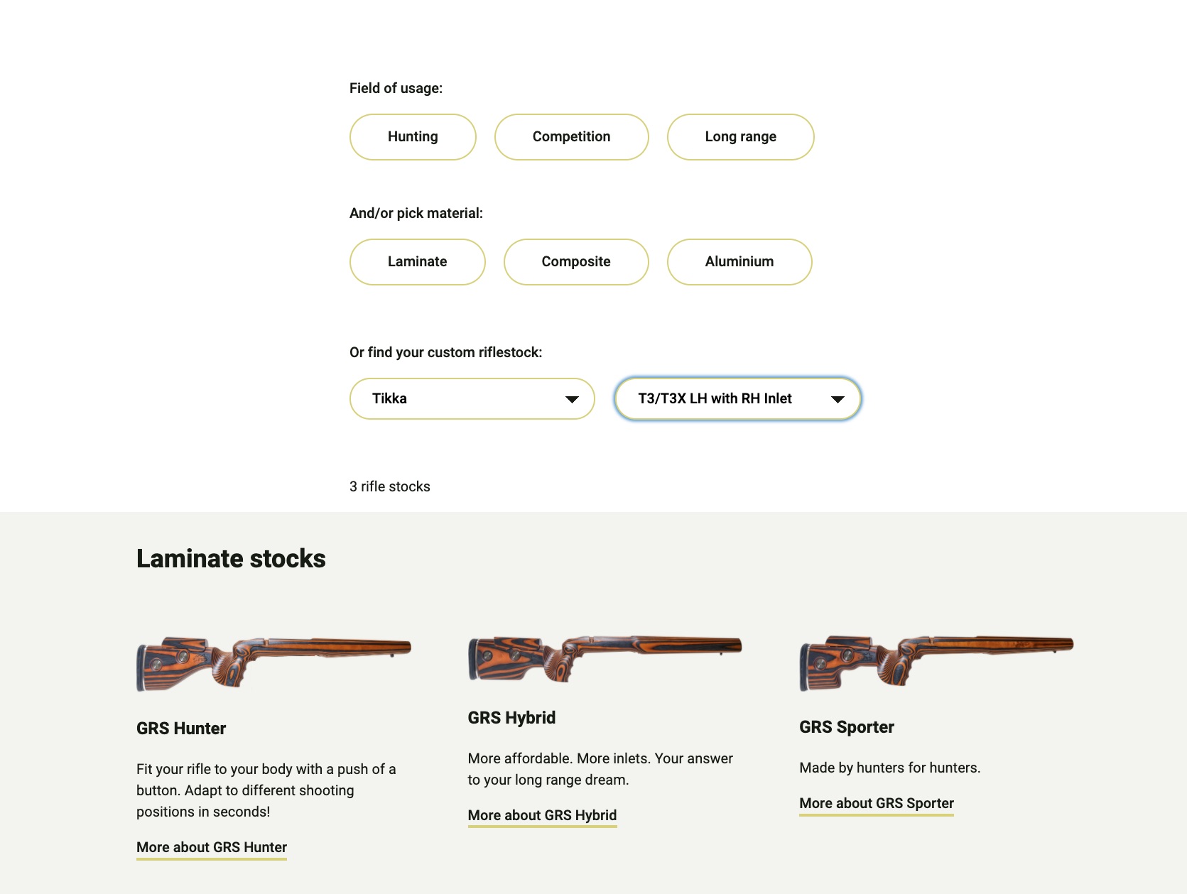

Left hand ctr's aren't available in the US. So far krg doesn't have the left hand cut for a Tikka AFAIK. Can be done with a file though.
The CTR would be RH- and the KRG is ambidextrous I think. According to my reading of ordering options on GRS site (see attachment), a LH GRS laminate stock would be available in their Hunter, Hybrid, and Sporter models for a normal T3/T3X barreled action. I will confirm with them if I proceed on the CTR build path.

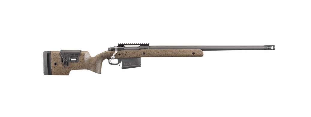

I can use the SSG the way it is- just not wild about the way it looks- and I think I need a height adjustable butt stock for shooting prone. Was looking for something like the stock on my soon-to-arrive Ruger HLRT (see attachment)- may try to hack together something for a height adjustable butt stock for this rifle. Of course, the KRG and GRS do have height adjustable butt stocks.
At this point, I think the GRS would be ideal. I'm not wild about the GRS extreme accented laminate appearance, but I would get used to it- seems very popular. LH GRS Hybrid stock with Tikka T3X 6.5 CM barrelled action and Little Bastard brake seems like it would be a nice set up for me.
