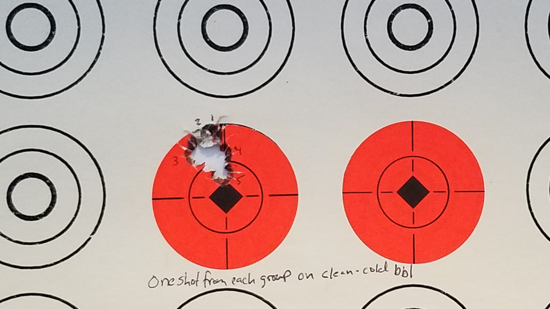

Just to put things into perspective a little, this is a 5 shot group with five different seating depths. I think it's from touching the lands to .015" off with 130 VLD's which are fairly depth sensitive. Also on a cold barrel
I was worried about it too originally, the varying ol, but I came to find out, I don't shoot good enough to tell the difference. Theirs so many variables that a few thousandths of an inch difference isn't one I overly worry about. Between atmospheric conditions and shooter error, for me +/- .003 isn't to big of a deal. To some i'm sure it is, but not to me.

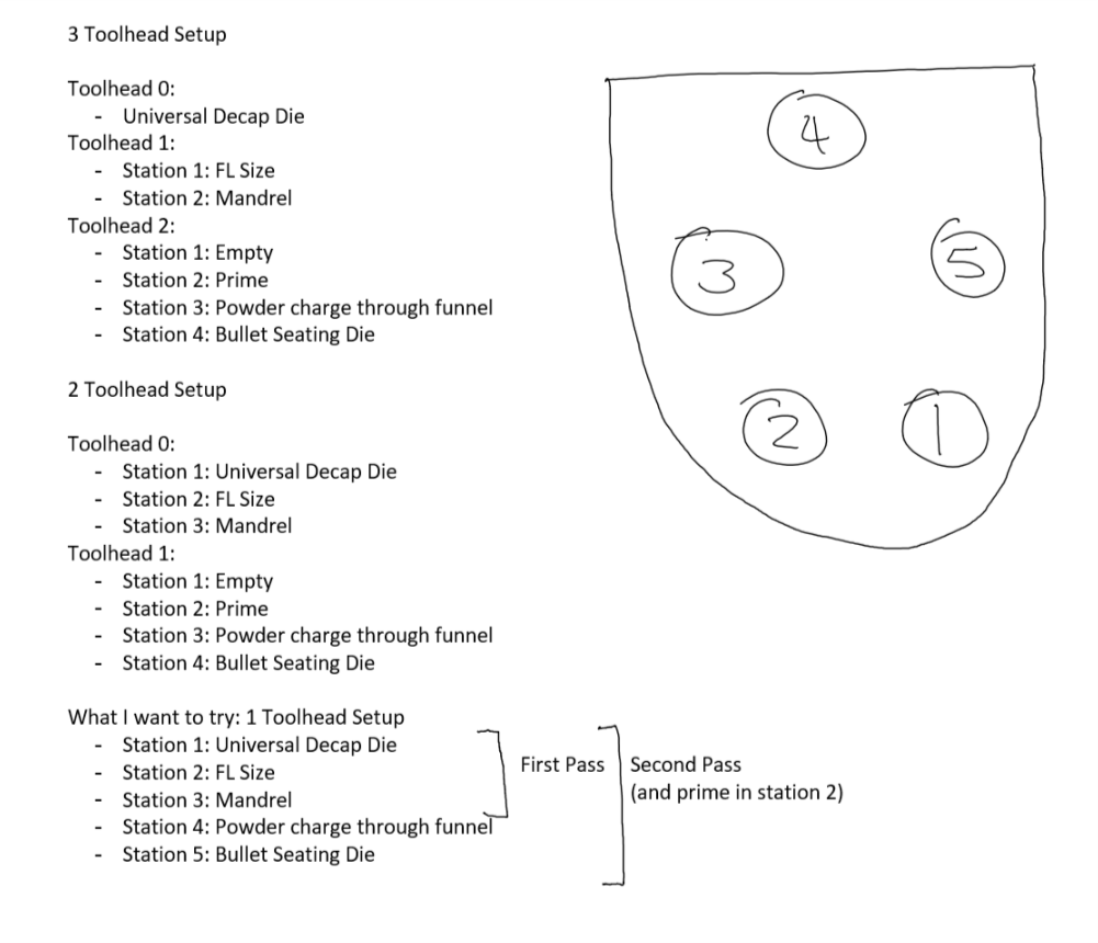

So let's try raising this thread from the dead instead of creating a new one. I've got a question for y'all from a nascent reloader who's about to purchase a Dillon 750XL. I noticed a lot of people use 2, or even 3 toolheads for loading precision rifle on their Dillons. My question to you is, could I just use 1 toolhead but still do multiple passes through it. Here's an image of what is currently done and what I want to do.
7121283
My thinking is on the first pass (brass prepping), the brass being prepped wouldn't be effected by or affect the Dillon Powder die or a Bullet Seating die.
My concern for the second pass is: I will have to lube the cases to get it through the sizing and mandrel die, but then the cases can continue on to be primed, charged with powder manually, and seat a bullet? Will having lube affect a super negative outcome to reloading brass into a cartridge? I was going to use imperial sizing die (and later on try the DIY lanolin solution) to, hopefully, minimize the negative effects.
Skip past the imperial and go straight to alcohol/lanolin. It makes no sense to run a progressive then need to individually hand lube each case. Negates the advantage and might as well do single stage.
Can't run an unlubed case through a sizing die, even if it's already been sized. It will get stuck.
You will not want to run cases with any lube on them through a Giraud trimmer. They need to be clean or you will gum up the works.
You don't really want to powder cases with lube on them. It can be done but often powder kernels can stick to lubed areas. Kinda messy. Then you also need to tumble the lube off live rounds, not my preference.
Answer is a two stage process. Decap, FL, Mandrel on toolhead one. Then tumble brass clean and trim as needed. For toolhead 2 you do prime, powder, seat bullet.
If you want to be even more efficient just do a single pass on one toolhead and tumble the lube off live rounds. Totally viable for 223 ammo. I still do 223 as a two step process though, prefer keeping the lube and powder separate and not tumbling live rounds.
Another tip for efficiency, buy a LOT of brass. Then you can process a pile of like 1k pieces of 223 and load as needed.

I am setting up my 650 with the two toolhead method now.
This is what my workflow/toolhead set is looking to be.
Dillon 650 toolhead set up
Tool head #1 size, trim, mandrel
Station
Lube
1, universal de-cap
2- empty
3 Dillon trim die and trimmer
4-empty
5 Lyman mandrel
Tumble
Debur chamfer if necessary
Toolhead #2 Powder, prime, bullet seating
1-universal de-cap
2 empty/primer seating Mandrel?
3 powder drop or funnel
4 powder check die
5 bullet seater
I did find a couple of add on parts to help. Beyond the better toolheads, the thrust washer to stabilize the case holder plate, the spent primer catch tube. These parts below are really cool!
Along with the quick disconnects from Entirely Crimson.
They make the multi tool head method and set up much better.
