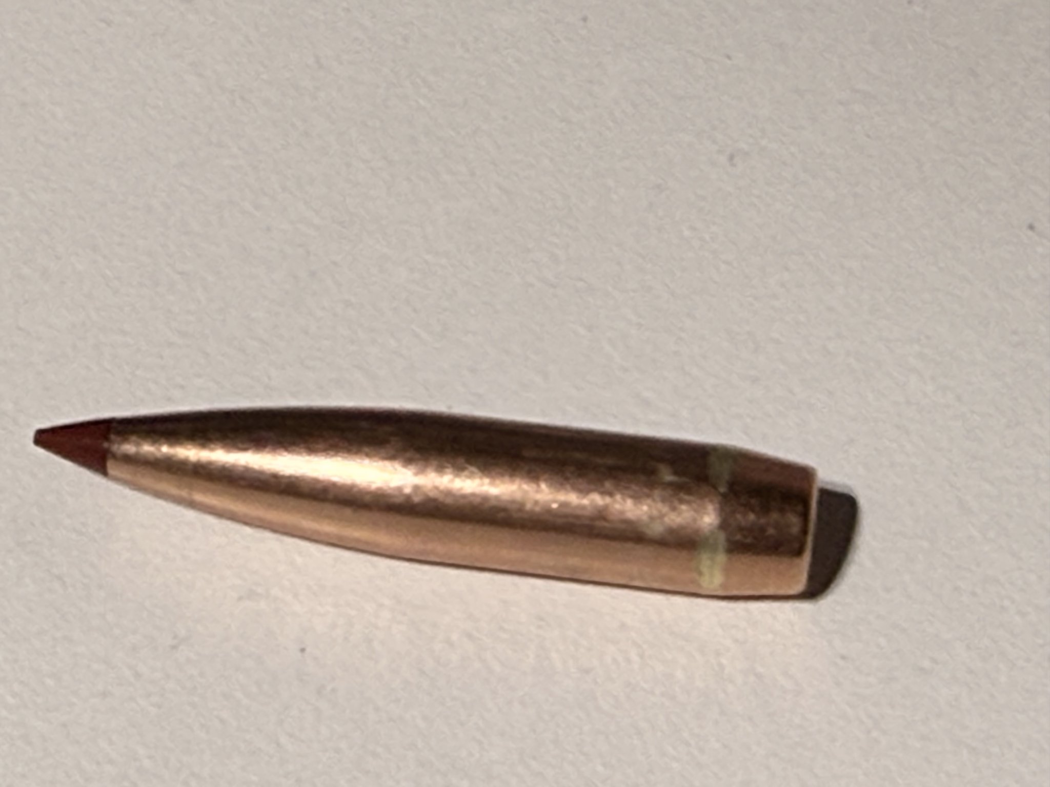

You said one thing that really stood out. I had to pull the bullet from about 150 rounds that I screwed up on. About 60% of them had a little shiny "ring" and round the start of the bearing surface
Example
Depending what your actual neck tension is you can feel a little pressure release as the bullet gets going into the neck. Probably the pop you’re referring to. You do have a decent inside chamfer? Also sounds like you’re over cleaning. Just the wet tumble is all you need.
