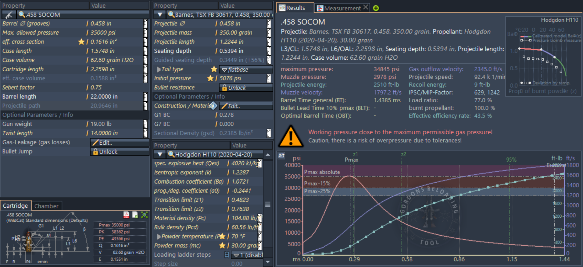

I was graced with some H110 powder recently.. I have a good bit of 350 grain 458 SOCOM Barnes TS bullets and can Not find any 350 grain load data for H110 or
being I cant find anything for any 350 grain.... I was going to start at 26 grains and go from there ..
Does anyone ( I am hoping ) have any kind of load data for H110 and 350s ?
APPRECIATE any help with this and Thank You in advance..
FWIW, GRT has a 458 Socom model loaded, and puts the max at about 30gn, so you're in the ballpark for starting at 26.
I went 50beo instead of 458 (and kinda wish I did socom) and, like in revolvers, H110 seems to do best driven towards the hot side.
ETA image:

THATS IMPRESSIVE !!! yeah I got into the 458 and loving it but even through Black butterfly is great ammo, the ammo gets A bit much plus I really enjoy the reloading But this chart WOW! thank you it really helps .. I figures 26 or 26.5 would be a start with it because till you sent this all I found is 300 and 500 grain loads so I was trying to calculate in my head a good start

My GRT doesnt have any 458 cutting edge bullets listed. I think the latest edition is still available if you'd like to model it yourself.
