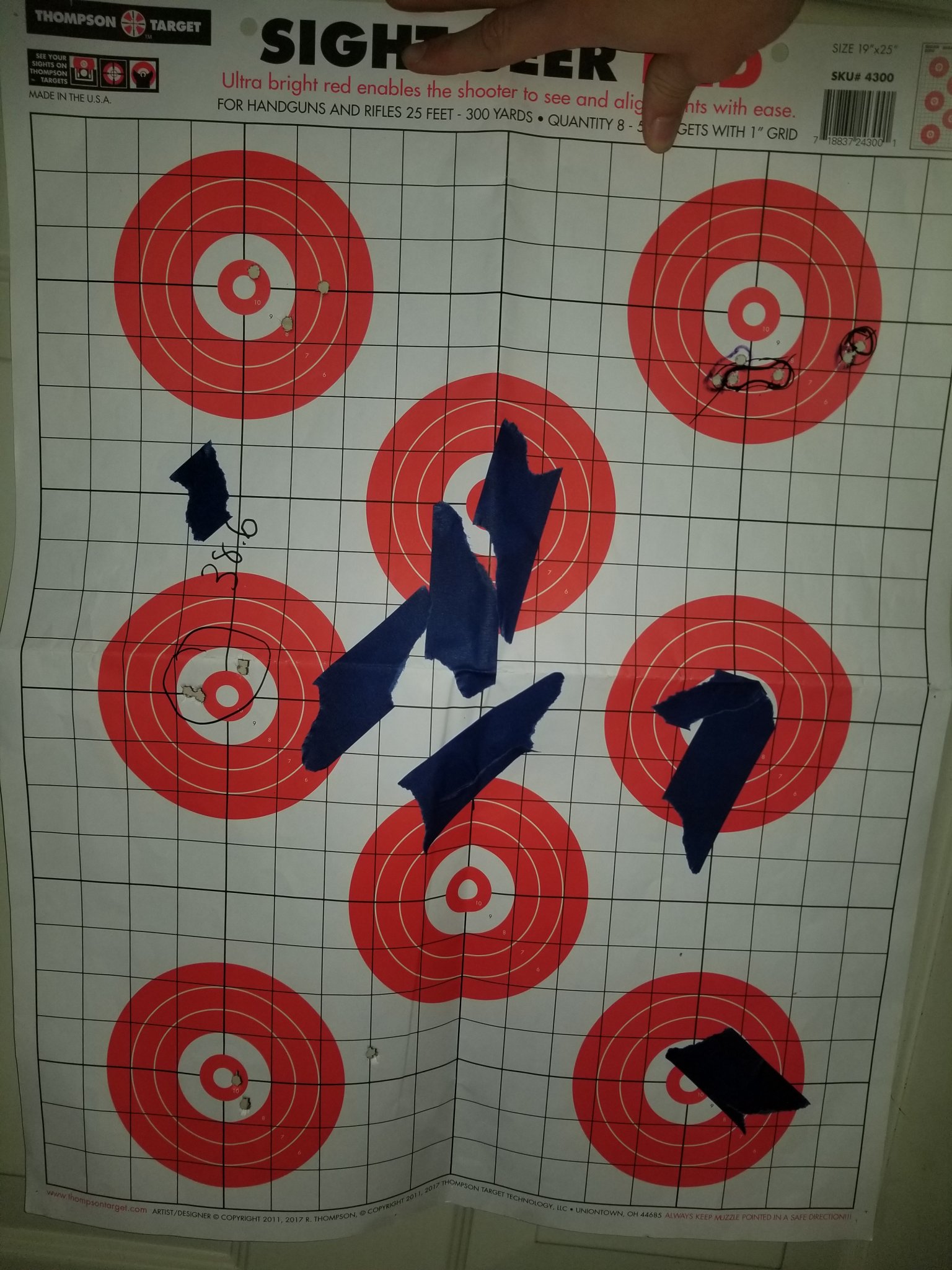

Hey fellas just got back from my 1st range trip, im kinda baffled with the results.
7111379

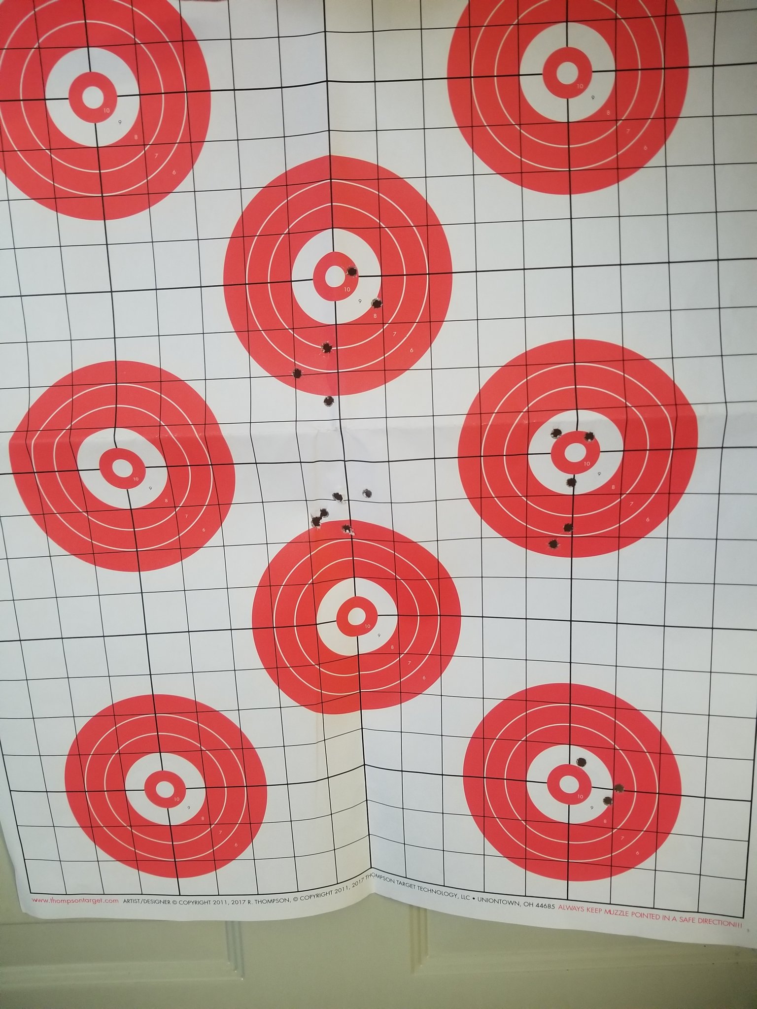

My 1st group was bottom center, then next up was my second group. What could possibly cause groups to open this much? I was taking my time and leaving barrel off between shots also.... i was shooting factory ammo. 1st group was great then the rest sucked. Gun is stock no modifications.
Reactions: Tinker054559
Well its not a free floated barrel but it is a heavy barrel, nothing really makes sense cause the 1st group was decent. My scope is a swfa 10x42 never had any issues before. This is the 1st 20rnds through this barrel.
Free float the barrel. Then clean with Butchs bore shine or equivalent. Then clean with a copper eliminator such as sweets 7.62 solvent. Shoot 20 more clean it again. Keep doing that until when you clean it you see no more blue on the patches. Also I would not shoot for groups until you get 100 or more rounds down range.
Reactions: deltawiskey
I never really seen the need to break in a rifle, i was going to today but i forgot my kit at my house. Never in my lifel have i have a rifle shoot a moa group then open way up right after. I have sneaking suspicion that it has something to do with the stock.
Yes I understand what you are telling me. Remington probably sold you a rough barrel and it needs lapped. Easiest wAy to lap is shoot 20 clean shoot 20 clean. If you don’t get any blue then something else is the problem. Stock touching barrel is not going to help accuracy.
Yea i need to do something about the stock, money is tight so i might just try and redo this one to make it work. Ill try cleaning it be4 i shoot again.
I was using plain 100 gr soft point from local wally world, by reloading supplies wont be here till the end of the week. It was supported with a front and rear bag.
You might just need to lap your bore a bit.

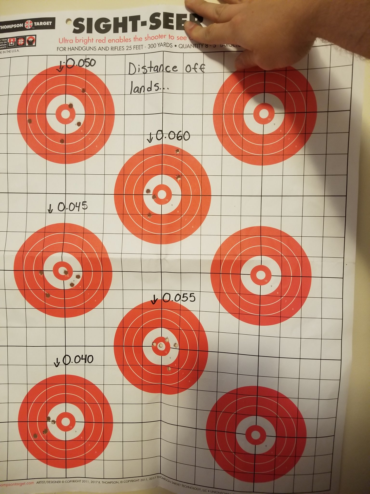

Getting frustrated fellas, i bedded my scope base my action and completely free floated my barrel. Groups were shot .010 off the lands and with h4350 5 3 shot groups. 90 gr eldx bullets with starline brass and federal match grade primers. What now????

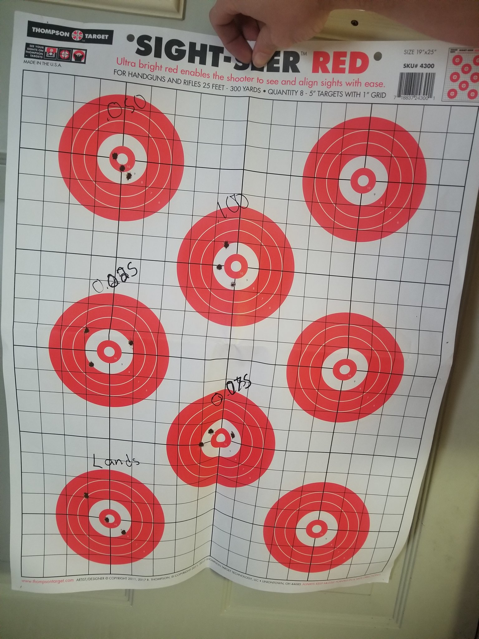

Well have it another shot.... Cleaned the barrel till it was spotless and loaded my ammo to factory length and went through the different powder charges from min to maximum.... Anyone have any suggestions???
90gr eldx
Starline brass
H4350
Federal match primers.

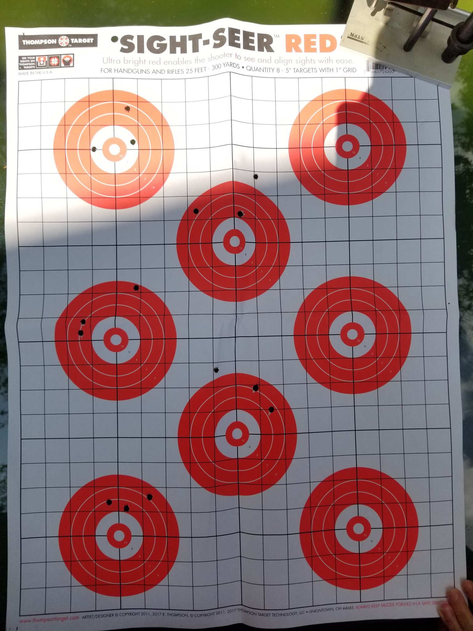

Last ditch effort i tried my lands test to see what would happen if i picked the lowest powder charge and started setting off the lands. Surprisingly there seems to be a node at .050 off the lands. I am gunna try setting the bullet off in both directions alittle more and see what happens. 3 shots are 1 inch at .050 off the lands.
Load some more at .050 and reshoot try at lest 3 x3 the more you shoot the better overall picture you will have of the load. Then if it works consistently move out to distances and see how it holds up.Remember not every barrel will shoot every load accurately. Good luck and keep posting up your results.
loaded a few more from 0.040 to 0.060 off the lands in 5 shot groups. The 2 best groups were 0.040 and 0.055 off the lands. Running tye minimum load for h4350. 0.055 has the least vertical dispersion with 1 flier. Any suggestions on which to do further testing on? Oh maybe there is something i am missing reading the groups that someone more experienced can chime in on....
