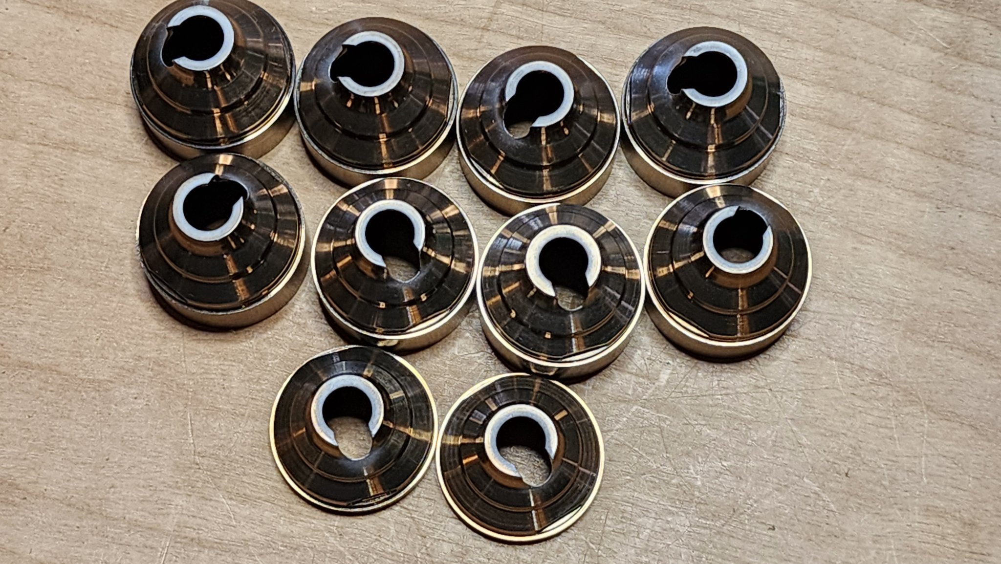

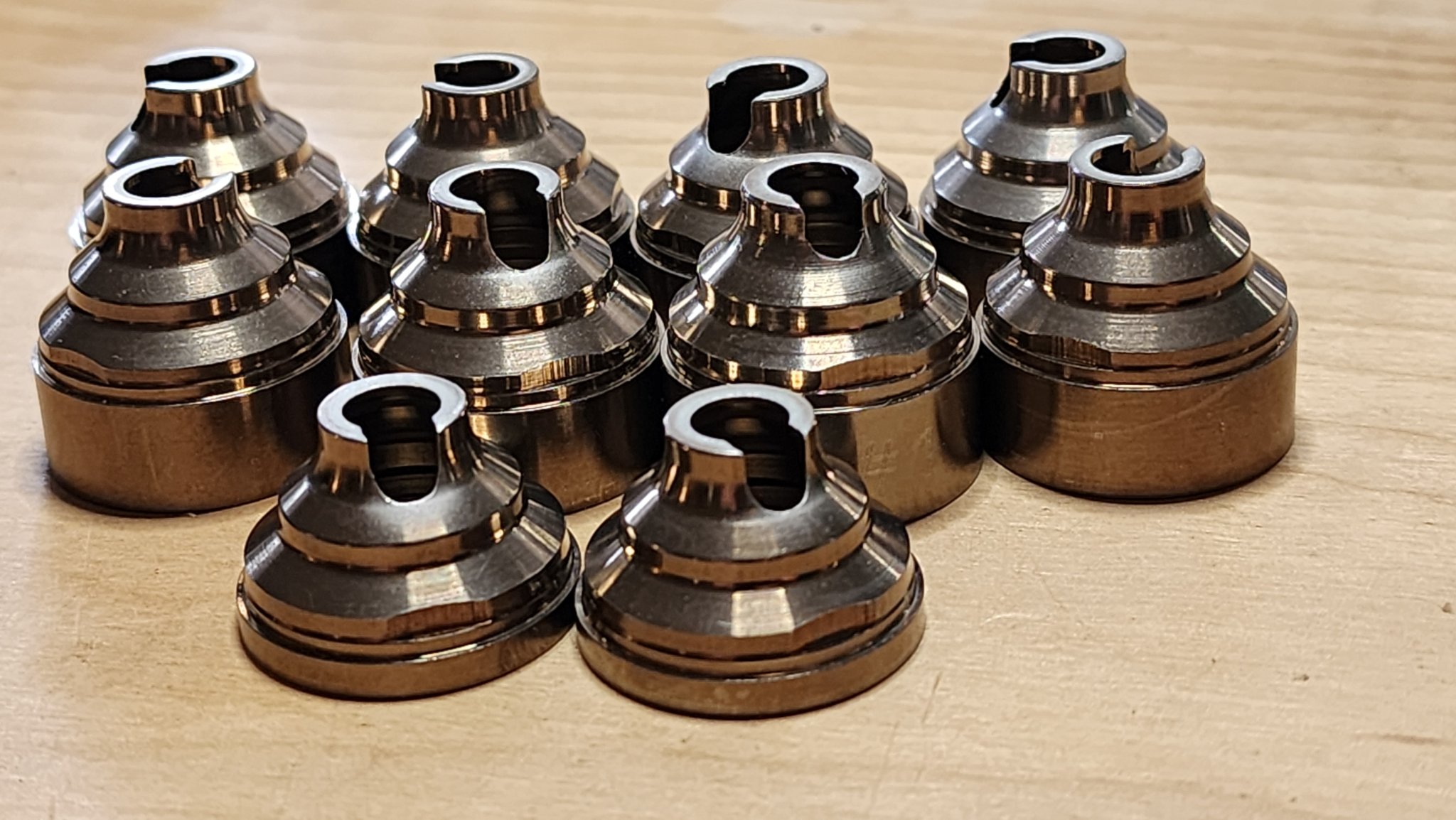

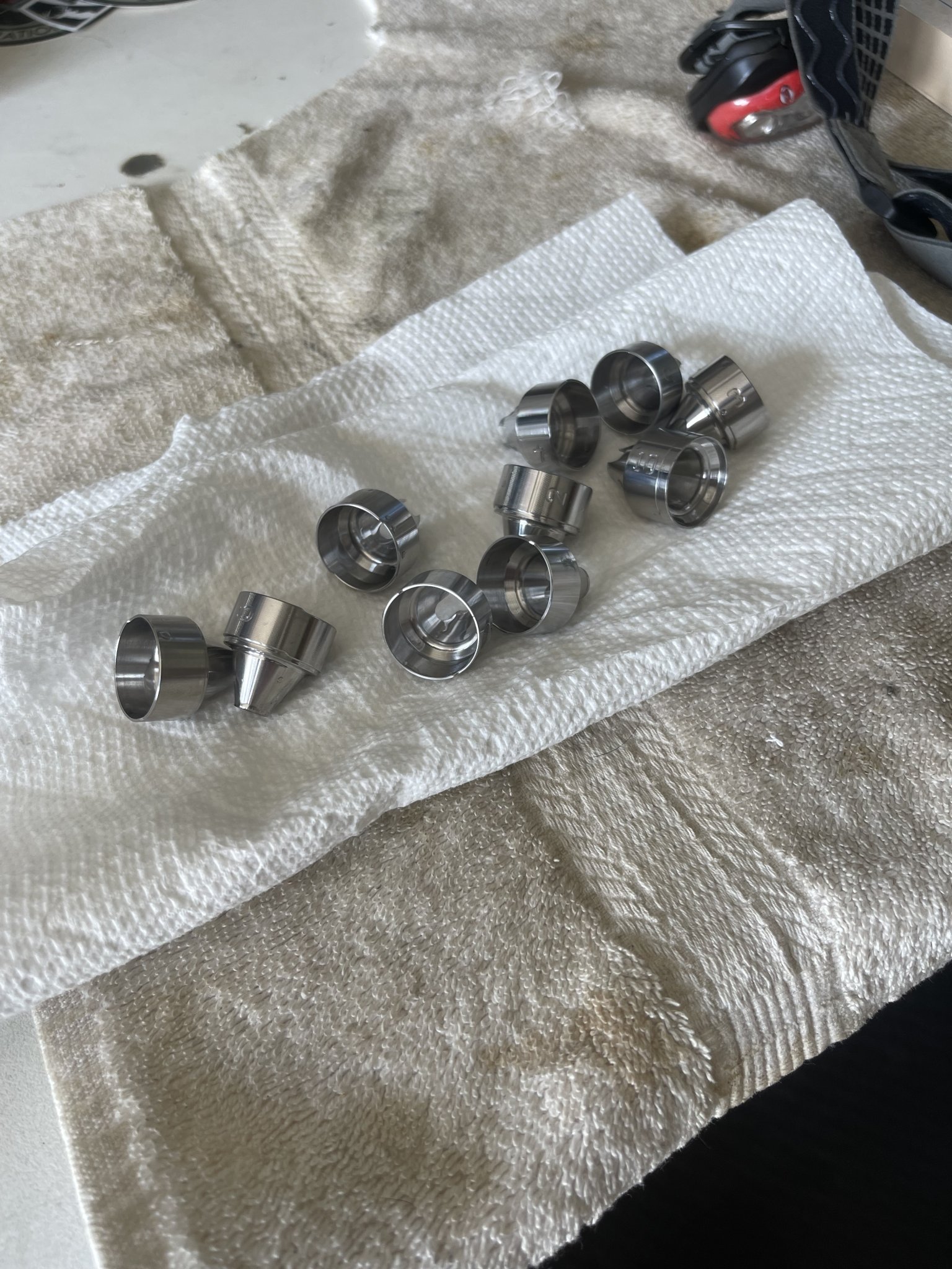

    This is 10 minutes soak in CLR then rinsed under warm water. I clean the tube while it soaks. Takes about 20 minutes to clean the can
    I also have noticed chunks of carbon come out. I’m sure a lot depends on type of ammo used. Some has lube some doesn’t etc if I remove the can and tap against my hand I can get a little pile of carbon bits out of it. Not as bad as my centerfire but still there
    10 minutes in CLR
    10 minutes in CLR

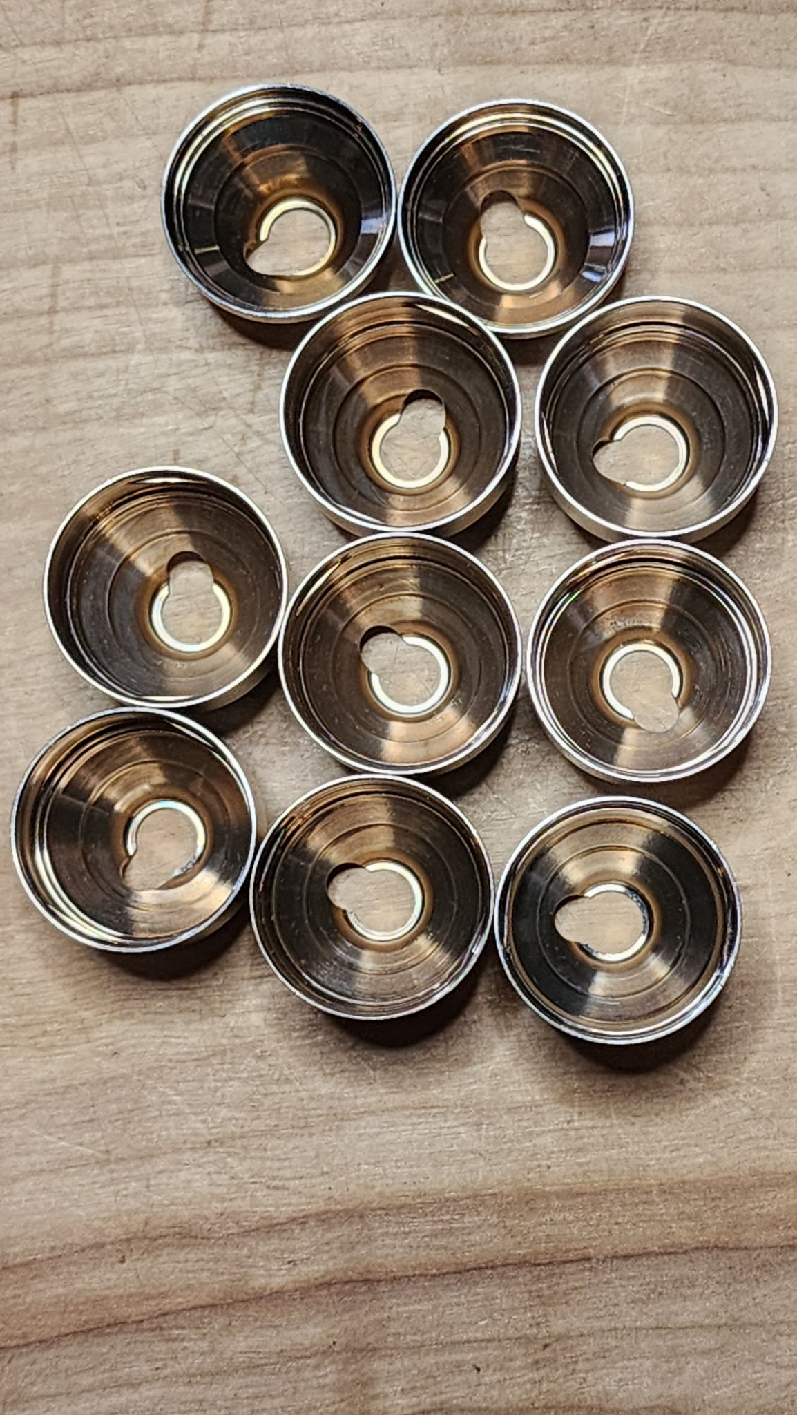

    Hold the phone!!! I thought I had the perfect solution using Hoppes. I wish I had taken before pictures, but since my back was tweaking today, I decided it was "clean the can" day. I have to thank MarinePMI and then hafejd30 for the suggestions. These baffles are from my Rugged Oculus .22 can. It had around 400-600 rounds through it since it was last cleaned, so it wasn't a disaster, but it was dirty. I wiped most of the gunk out of the inside of the baffles and put them in a Mason jar and covered with full strength CLR. So.... I was cleaning my CZ and forgot about the baffles so they soaked for about 40 minutes. I poured off the CLR, squirted some Dawn dish soap in the jar and rinsed in hot water till the soap was gone. Then wiped the baffles dry with paper towels. WOW!!! No scrubbing at all. So easy. This can has about 10,000 rounds through it, albeit I keep it fairly clean, but this was ridiculously easy! Sorry for writing a book, but I'm really jazzed right now.
    Looks good
    I will add a disclaimer for guys using clr. It doesn’t get along with every suppressor. Aluminum vs stainless etc. I keep my soak time to 10 minutes to prevent any damage and I only soak the baffles. I do the same on my griffin Optimus micro.
    Looks good
    Good point hefehd30, this will only work with stainless or titanium baffles. If you put an aluminum baffle or tube in CLR, it will be a disaster.

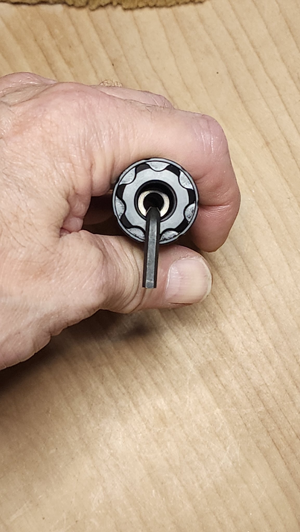

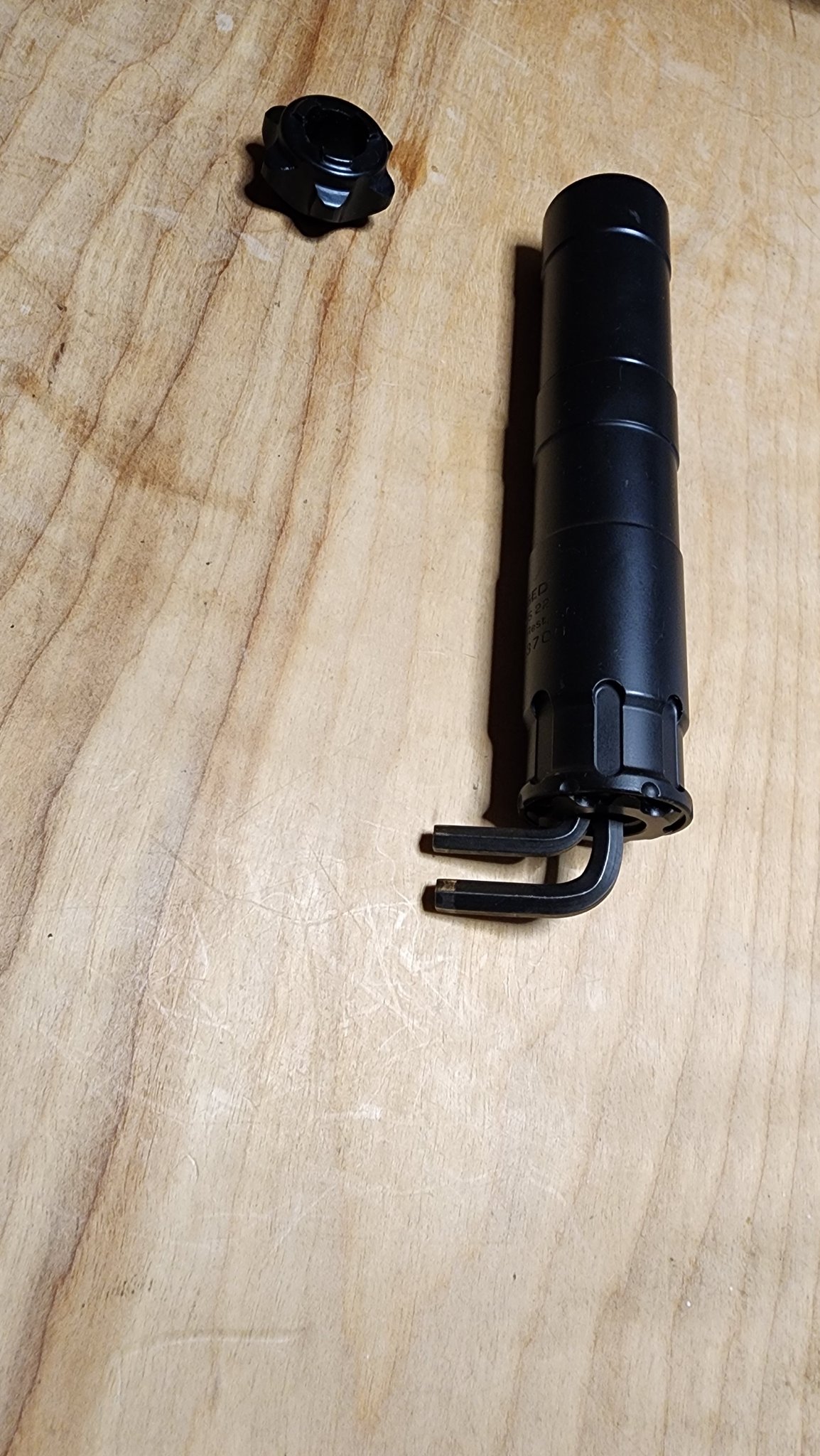

    Anybody had issues with aligning the baffles in the Rugged Oculus? Here is what I do. 5/32" Allen wrench to align the baffles and then a 3/16" Allen wrench to keep the smaller one from jumping out when you tighten the end cap. I thought I was a genius when I figured this out, but just for fun.... throw some darts at me! I've got thick skin, lol.
