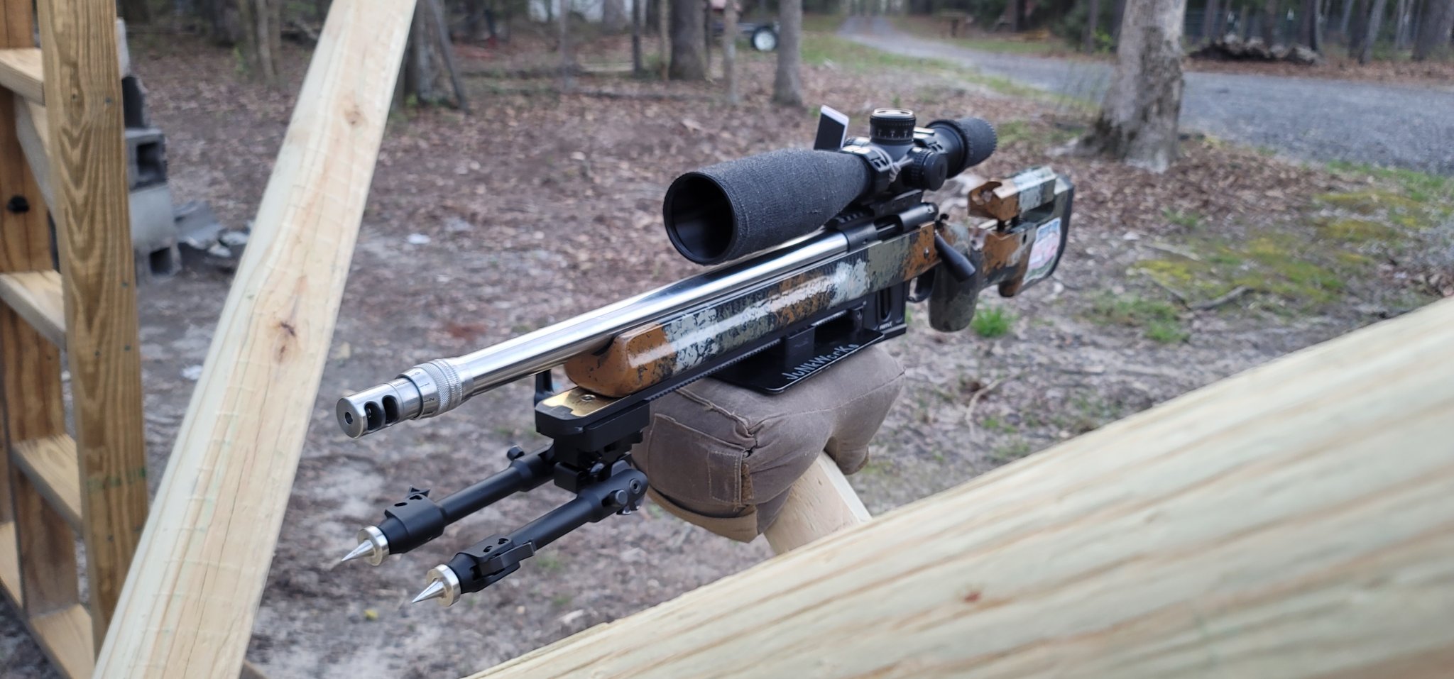

Maybe you need to build a 1/2 O.D. tuner like a taco for the full bed rifle! :) Maybe the harmonics are only traveling along the top of the barrel? That's only partially in jest. You never know with these frustratingly awesome rifles. And yes!, the long distance crowd I believe will push rimfire to new places RFBR just couldn't. SO many guys are asking me about training rifles to match their 1000+ yard PRS/PSL etc. rigs. Well, I have to get to work, our power has been out for 2 days from the storms and I am behind. That's also why I couldn't respond to your post quicker. Have fun!, G.
I'm pretty sure that would defeat the purpose of the tuner by adding additional weight on the end of the barrel.
Actually. . . no. Adding any weight to the end of the barrel changes the harmonics (including breaks), just like a tuner does. A tuner can still change the harmonics, whatever the barrel configuration. And the one referred to in the previous post is one that can work well if one is going to have a can mounted.

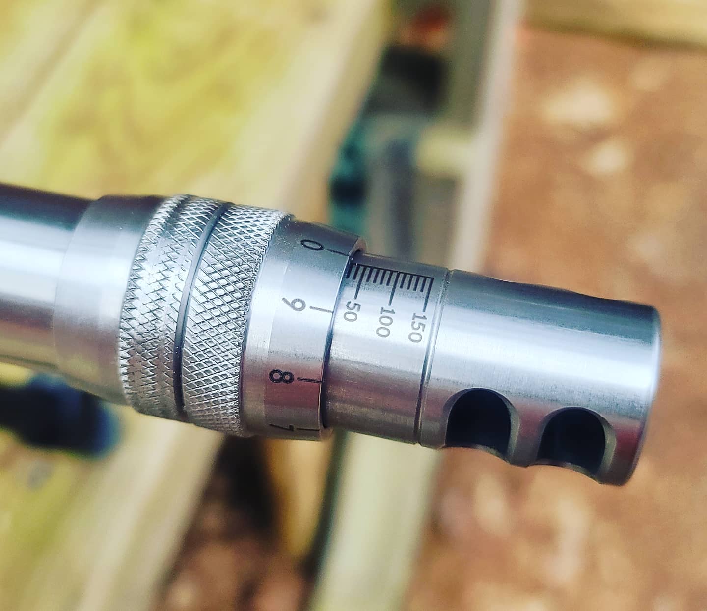

I like my Harrell's!!
Reactions: Ranger007 and STex

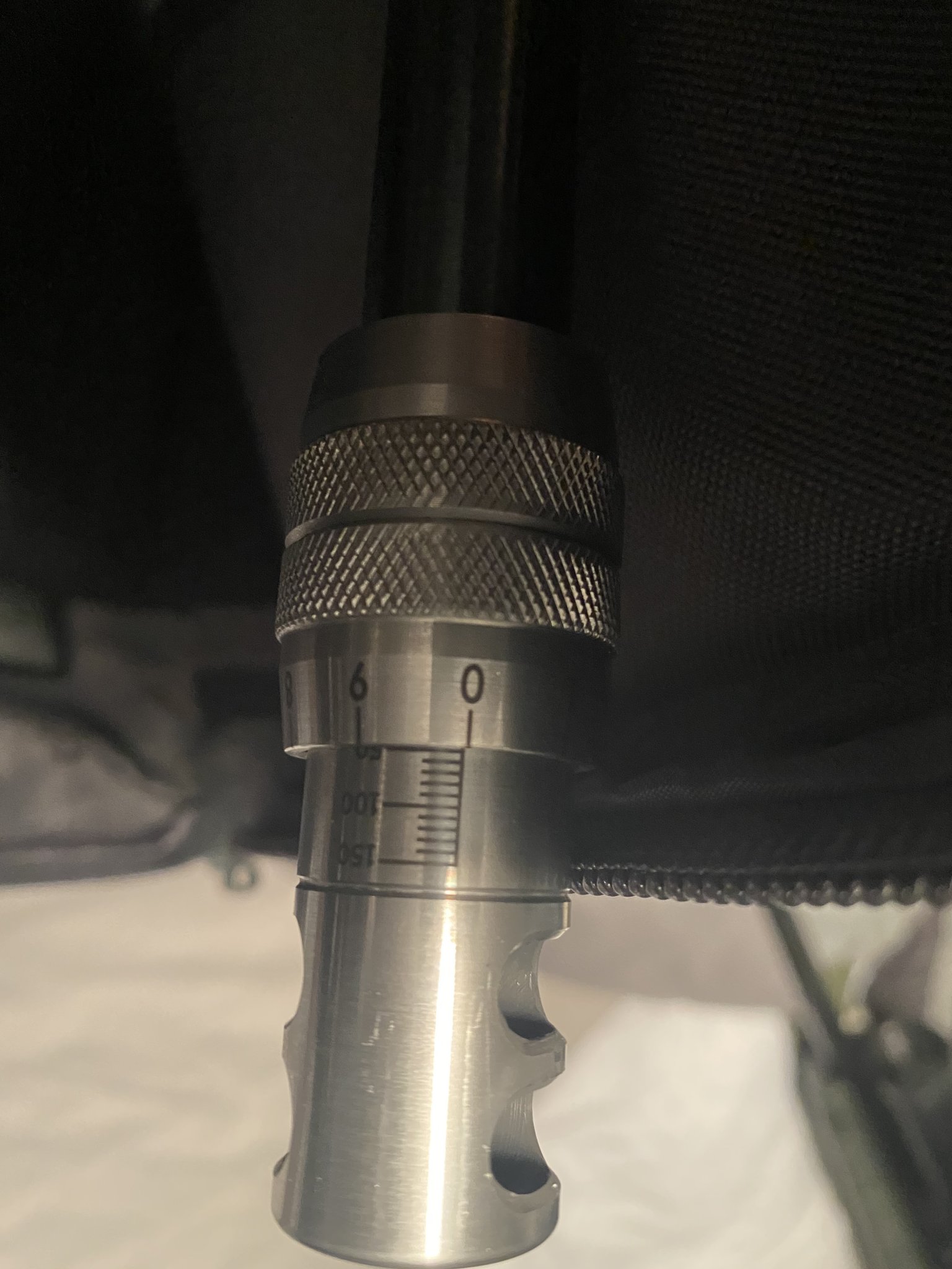

Have you compared the "Harrell Tuner Brake," which appears to be shown in the AR-15 variation on the rifle above, with the "Harrell's Rimfire Tuner," shown below, which is often used by .22LR BR shooters?
I went with the AR tuner brake because my barrel is threaded. These are slip on style tuners (I believe).

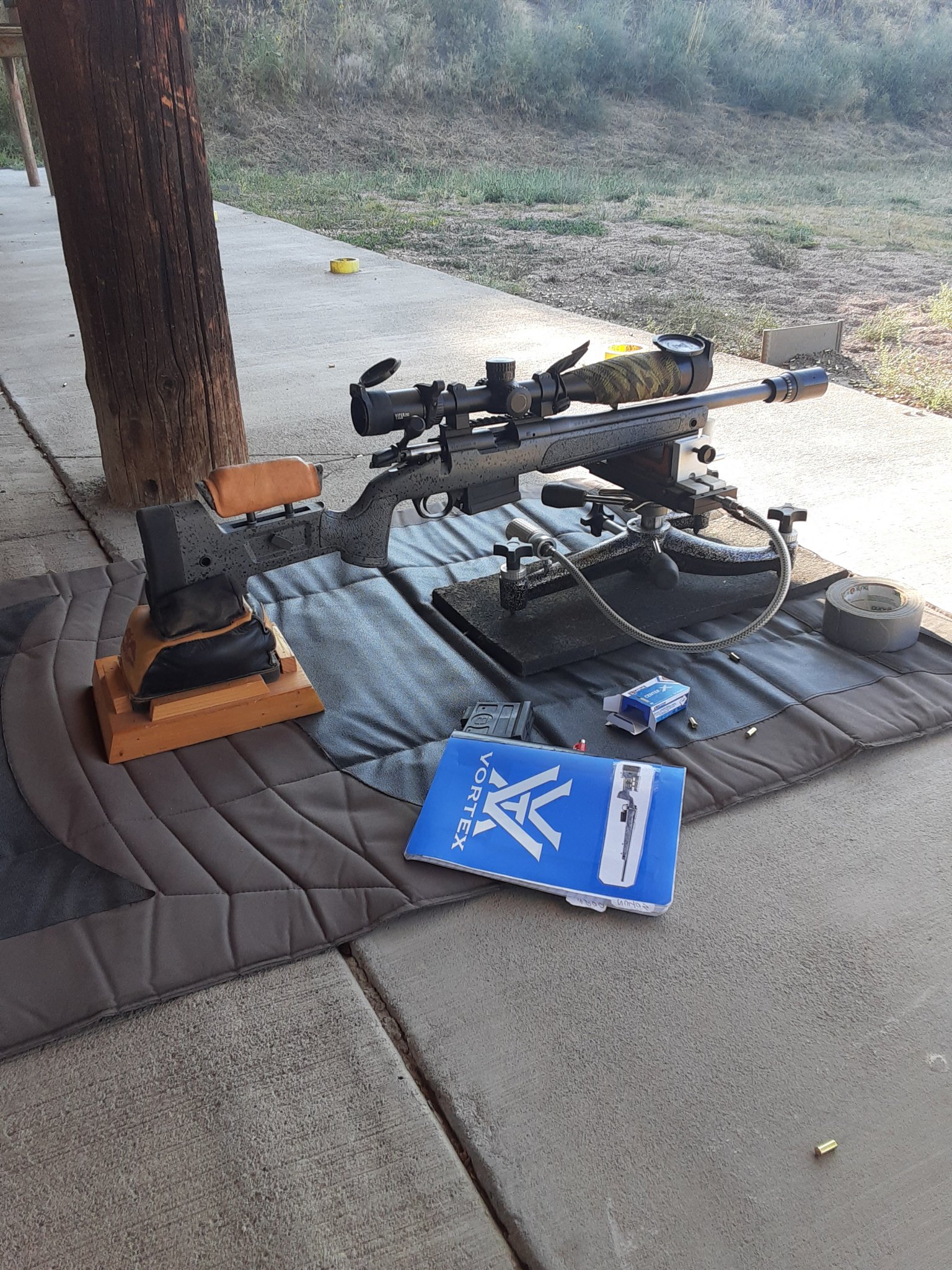

Here's a follow up post on what I did with the Harrell's Tuner. I got the Hopewell method completed this morning and I am very happy with the outcome.
  • Started at 8:00am and shot from 85 yards. 58*F 46% RH at the start - 75*F by finish. No wind.
  • Ammo - Lapua Center X
  • Rifle - Bergara B14 R - stock - except for TT Diamond 2 stage trigger
  • Scope - Vortex PST gen 2, FFP 5-25 mil
  • Shot from prone with Bald Eagle rest and rear bag.
I'm impressed with Harrell's tuner and the way in which an exact setting can be dialed and is then easily repeatable. Good solid clicks that line up well on the numbers.
The results were very much in line with the Hopewell instructions. After the "fine" tune I found the setting of 245 to be optimum - at least at 85 yards. My best 5 shot group at this setting and distance was .447" = .502MOA. Further shooting at various distance will be needed to verify.
I'm trying to get photos loaded but Rise Broad Band service is spotty, so not sure I'll get that added.
Bottom line - this tuner works! Glad I got it.

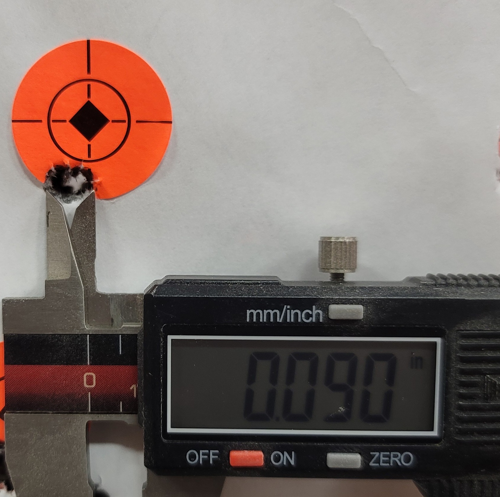

My tuner Harrels tactical tuner break was delivered Friday. Went to the range yesterday for a quick session. Got it shooting really good, but did not have time to do a full Hopewell test. 50 yard groups tightened up to 1 nice hole. Results carried to 100 yards with sub 1” groups with impressively low vertical stringing. Was playing with some crosswind as well. (2” sticker)
A picture of the current setting. I started at 0 and made full revolutions (0 to 0) until I found a group at 50 that looked good. Again, haven’t set it past 50 yet but on my next quiet range day with a few spare hours I’ll do a full test. (20” T1X SK LRM)
Reactions: 6.5SH and BisSilent
Cool, looks like it is working out for you.
Awesome ! Next outing look for 3-4 numbers in a row, all round groups, all same vertical POI. There will be one.
