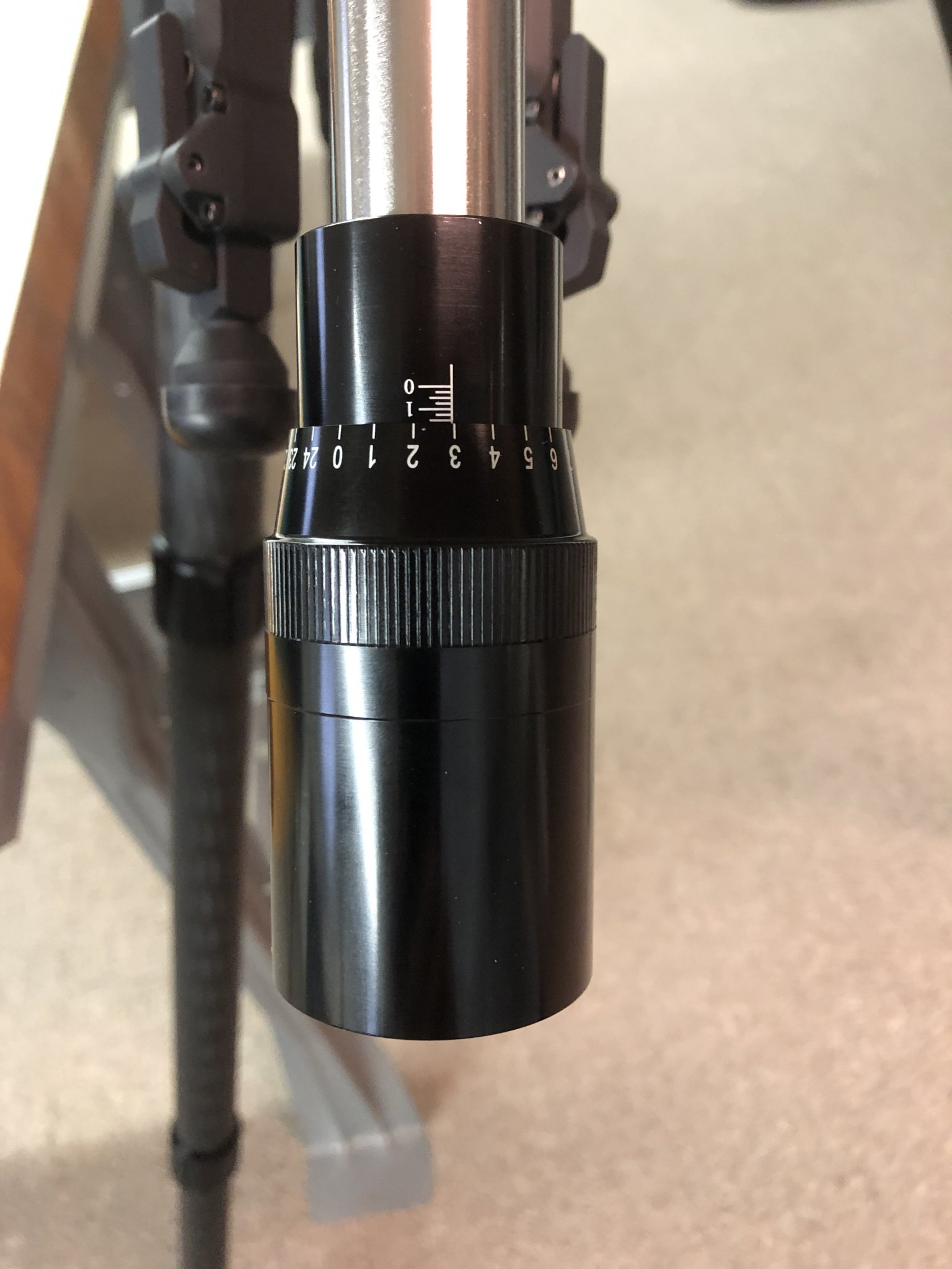

Here is a photo of my tuner at 153.
At 153, is your inner tube close tf flush with the outer? According to Tony's formula, is the outer tube is more than 1/4" beyond the inner tube, you need to multiply the inner tube diameter by .3 and subtract that to get a correct physical length. I have my barrels being shipped and have a CST tuner set up with a 1" bushing for the 24" shilen (bushing for barrels from 23.424" to 26.624" barrels} and have ordered a 1/2" bushing for my Green Mountain barrel which is just under 20" (bushing for barrels from 18.424" to 21.624"}.
