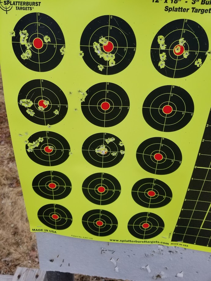

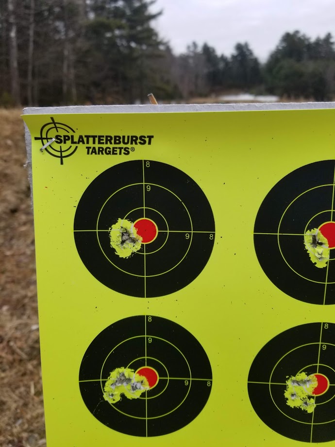

I remembered to take some pictures of groups today, after forgetting the last few times. Shooting at approximately sea level. 44 degrees. 91% relative humidity. Winds 5 gusting 10 and swirling over the range. Tested Center-X; Midas +, and Polar Biathlon (known good ammo for this rifle, but warmer than usual).
First two photos are 10 round groups shot at 50 yards with Polar Biathlon. Third photo is a bunch of crappy groups shooting Midas +. This rifle doesn't love it. The Center X groups from last time were actually better, and the Polar Biathlon groups at 100 are the best I've had yet. Photo four is my sighter target at 300 yards. The last photo is a three round group shooting like I meant it at 300 yards. The 300 yard shots were Polar Biathlon. I would have liked to have kept working at 300, but there were other's at the range and its a long walk for them to wait through while I hang targets.
50 yards - 10 round groups - Polar Biathlon.jpg50 yards - Polar Biathlon - 10 rounds.jpg100 yards - Midas + - 10 round groups.jpg300 yard sighter.jpg300 yard three round group.jpg
View attachment 7052338View attachment 7052339View attachment 7052340View attachment 7052341View attachment 7052342
Tight. I like it. Why 300 yards? Just to see if you could?
300 is the last berm at the range I was shooting at. There is an a steel plate out there I have been shooting at for a while but thats the first effort at precision.
Should have noted that pic three, the Midas groups were at 100.

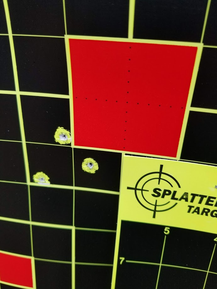

Late entry, but I managed to get to a longer range a few days ago. 50 yard groups were under an inch, but the wind had my target swaying constantly, and I had only bulk ammo, so nothing special to warrant pics.....maybe next time.
What did surprise me was that the 50 yard shots were on the bullseye without adjustment from my 25 yard initial setup work. I guess the general trajectory of the round is such that 25 and 50 yard point of impact work out to be the same from my gun.

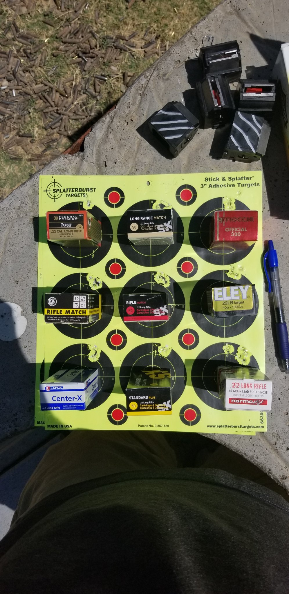

I'm going to put a bunch of photos on here, most are self explanatory. Let me know if you have any questions.
The scope is a Bushnell Engage 2.5-10x44mm that I picked up used in like new condition. It came with the Leupold cantilever mount which I assumed would be too high but it is just about perfect for me so I may leave it like that even though it leaves the scope pretty high above the bore. Really happy with the scope so far. Pretty nice glass for the price.
On the targets RCC=Ruger Competition Custom

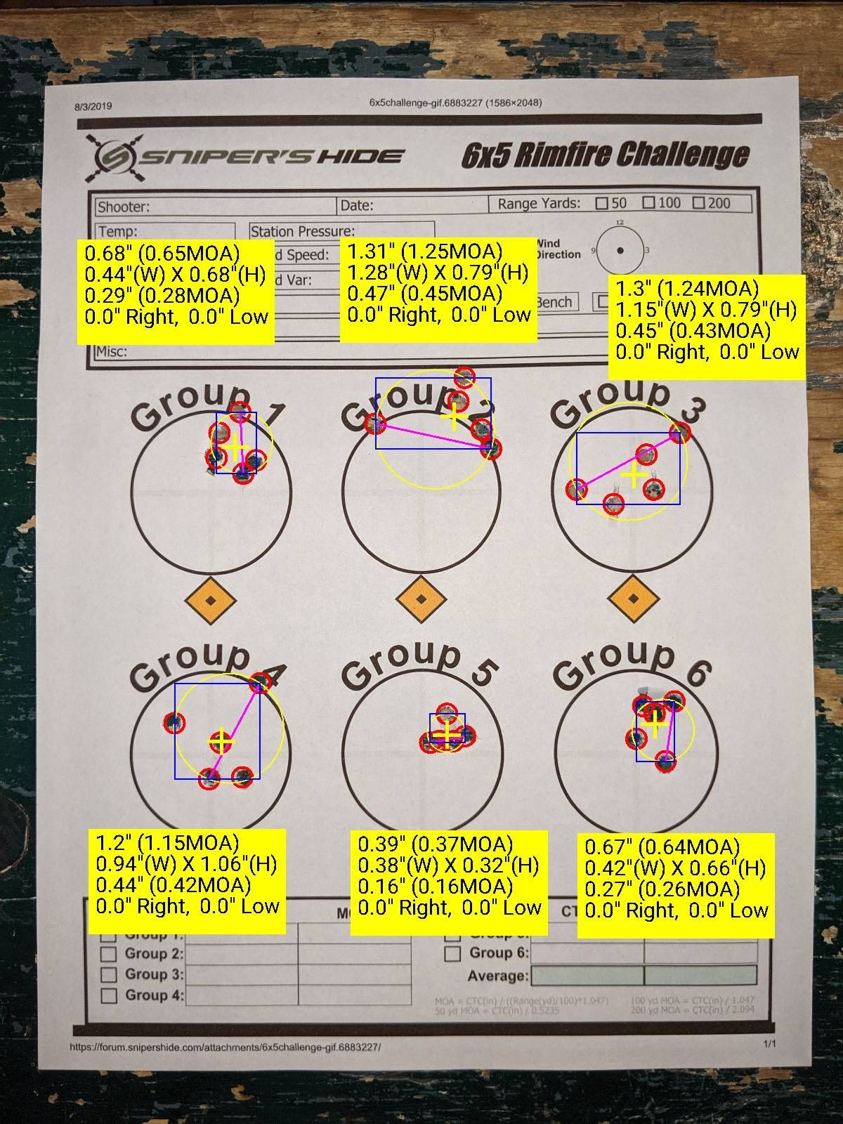

Casually did a 6x5 with Eley Tenex @ 100 yards on the first outing of the rifle. Trigger needs help... mushy, 2.5 lbs. Not the worst trigger, but compared to my Tikka's crisp 1lb trigger, or my Timney 2-stage, either would do a lot better. Gun is pretty darn light as well, and the stock has a rounded/sloped bottom which made riding the bag a little more difficult, but overall this thing can shoot really well.
